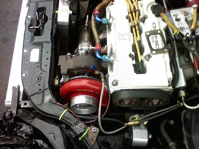

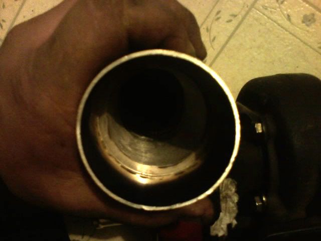

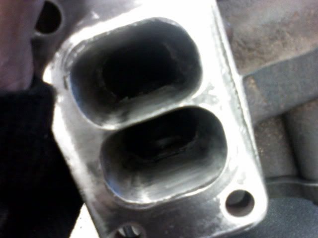

shooting for 10's in the si for 2010 the 60-1 turbo took a shit on me so i got a killer deal on a holset turbo. i had to shave the head n the compressor housing a lil bit to get it to fit  :noel: so now all i got left to do is injectors, get rid of the aebs intake manifold n replace it with the edelbrock intake manifold n get the 74mm tb and a battery relocation in the trunk so i could fit my new catch can set up n get the car tuned on race gas on 30psi
motor
stock rebuilt head 3 angle valve type r valve tran job blah blah
b16a 81.5mm decked
probe forged piston n probe h beam rods
micro polished and balanced crank
all arp main, rod and head bolts
clinic 850cc injectors
aeromotive fpr
255 walbro pump
-6 fuel return line
earls inline fuel filter
gsr cam
aem gears
revhard intake manifold
70mm throttle body
moroso catch can set up
aem wideband
autometer oil n boost n volt
msd blah blah
b16 trans with ls final drive obx lsd
competion stage 5 clutch
turbo set up
top mount turbo manifold
holset hx35/wh1c ported the fuck out
tial 44mm wastegate
tial 50mm bov
big ass egay intercooler 2.5 ic piping all round
3 inch vband open downpipe  :noel:
x mbc
suspension
kyb agx struts
skunk 2 coilovers
19mm rear sway bar
black blox lower control arms
car made 385hp and 250 torque on 16psi on pump tuned by xeno
on old set up
old set up

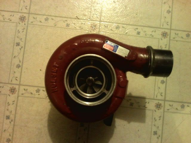

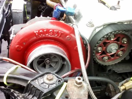

holset turbo

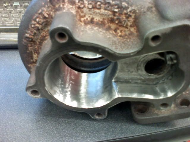

port work done by eric
compressor housing
exhaust housing almost done
done

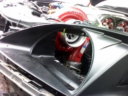

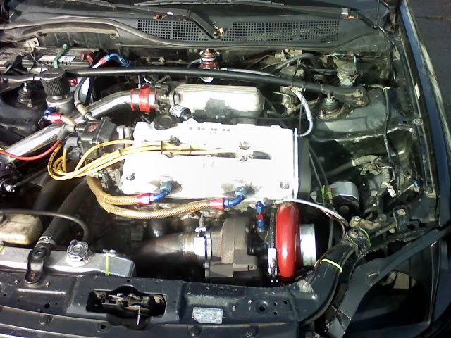

headlight cut out

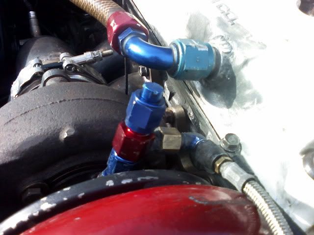

oil feed set up

Oil feed is baller :noel:
boosted 00 black si
  • Posts: 1560
Re: Project 10 second SI
« Reply #2 on: December 01, 2009, 07:18:58 PM »
thats right had to make it work cost 20 bucks to make  :noel:

Yellow zip ties just make it that much better lol, who the fuck buys yellow zipties
boosted 00 black si
  • Posts: 1560
« Reply #4 on: December 01, 2009, 07:36:23 PM »
haha stop hating on my zip ties nig. 6 bucks at home depot for a shit load  :noel:

i do to thats why i did alot of port work to the turbo to hope it will help with flow and spool time i'm also rocking a 3 inch open dp  :noel:
