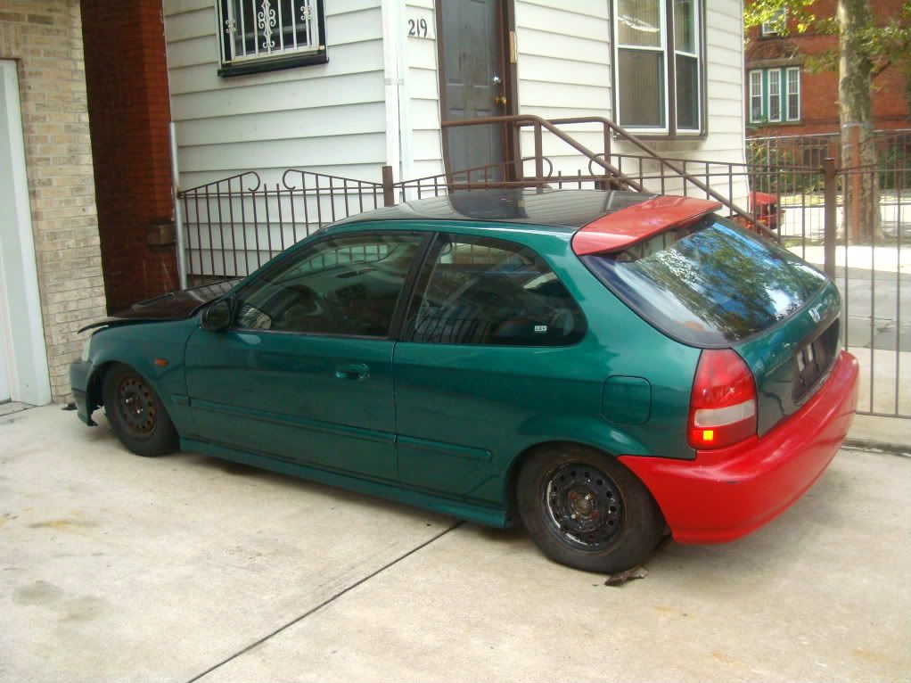

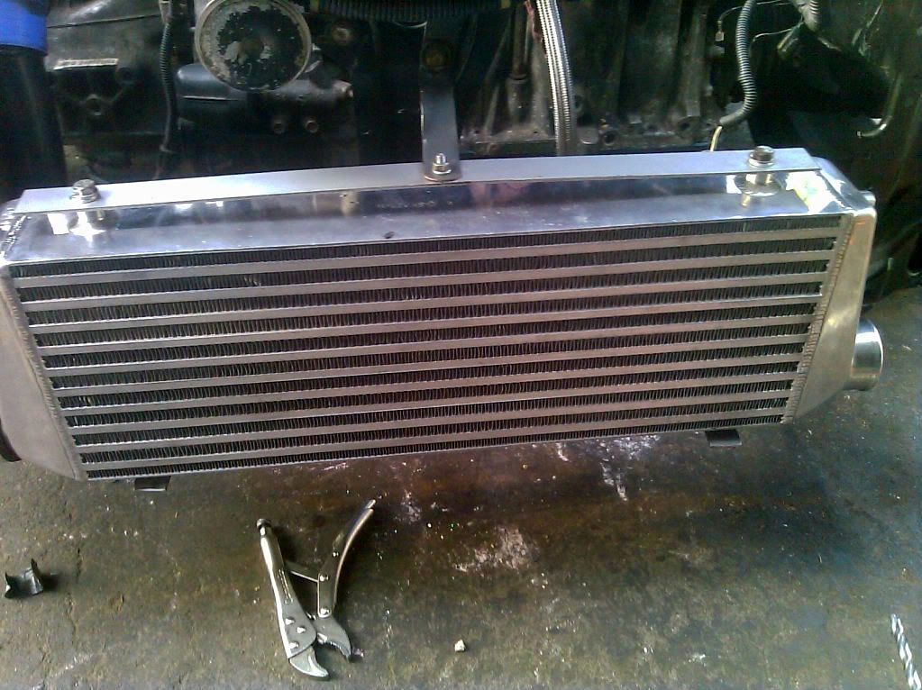

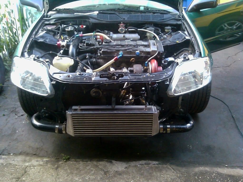

before
after

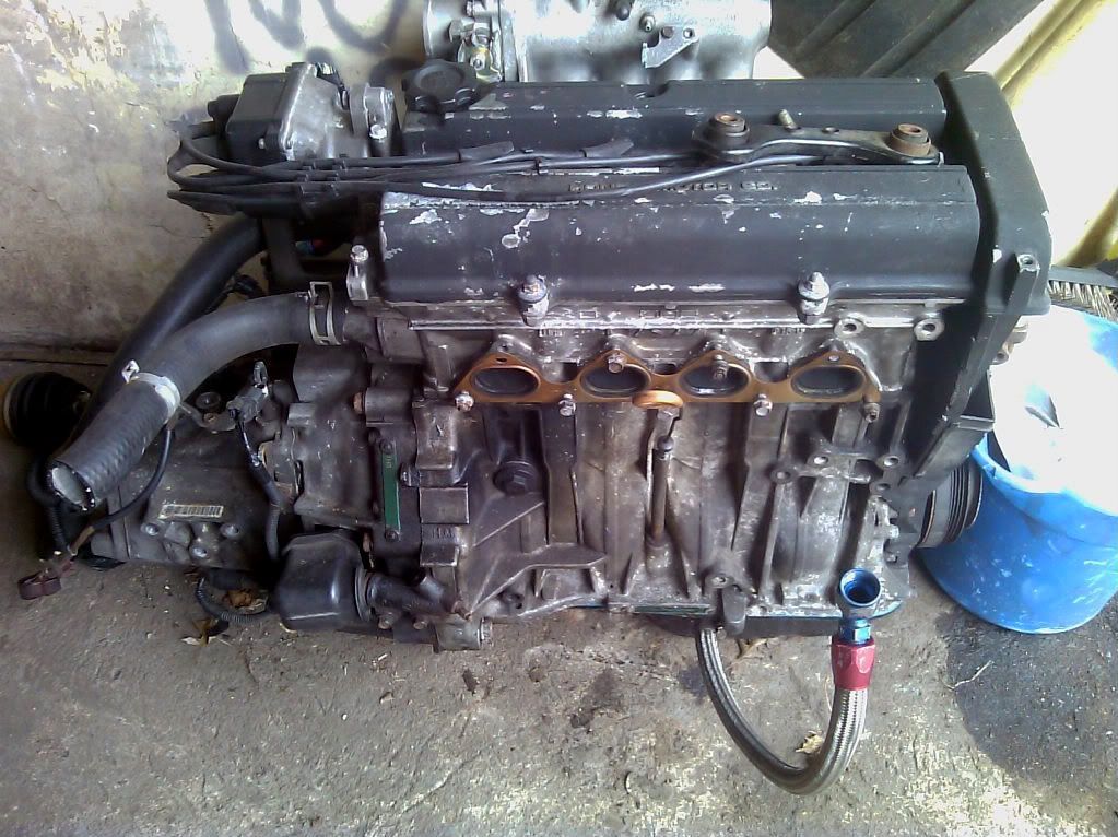

the victim stock ls motor

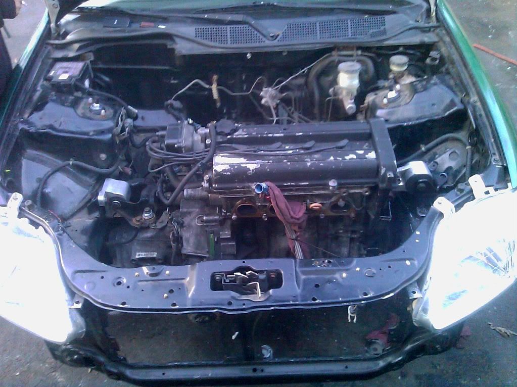

motor in

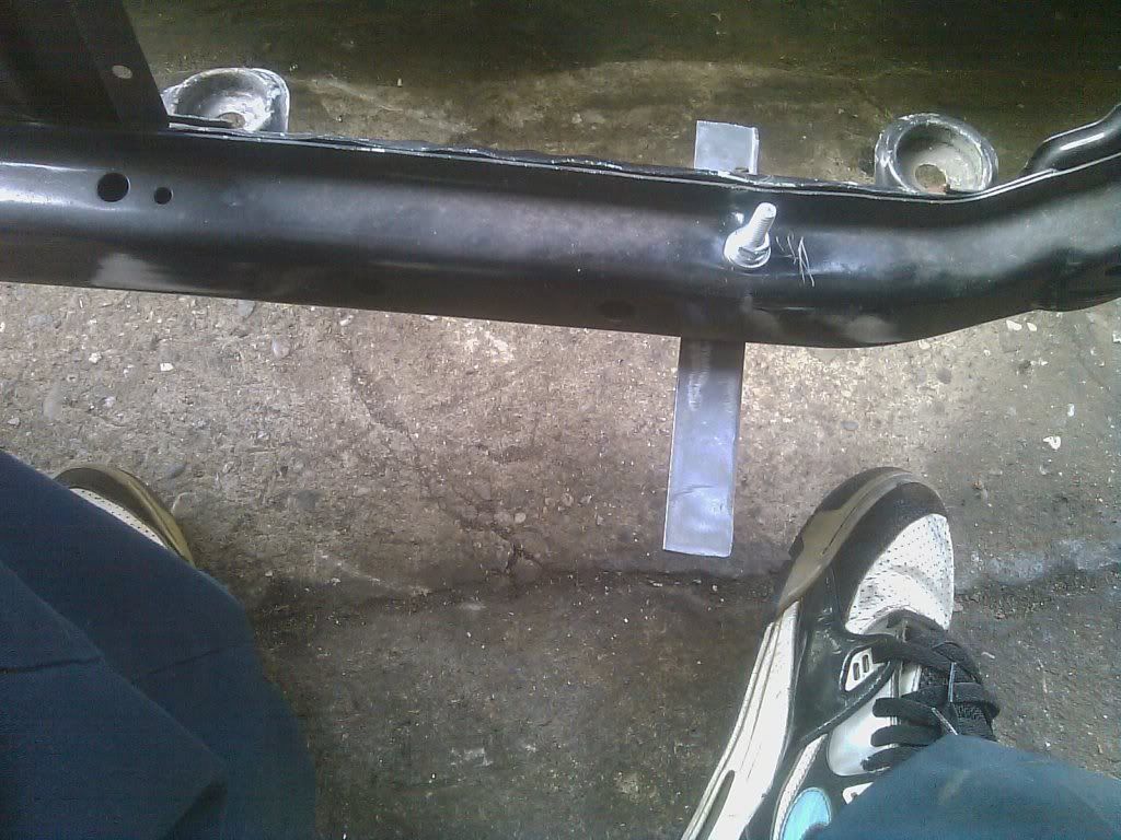

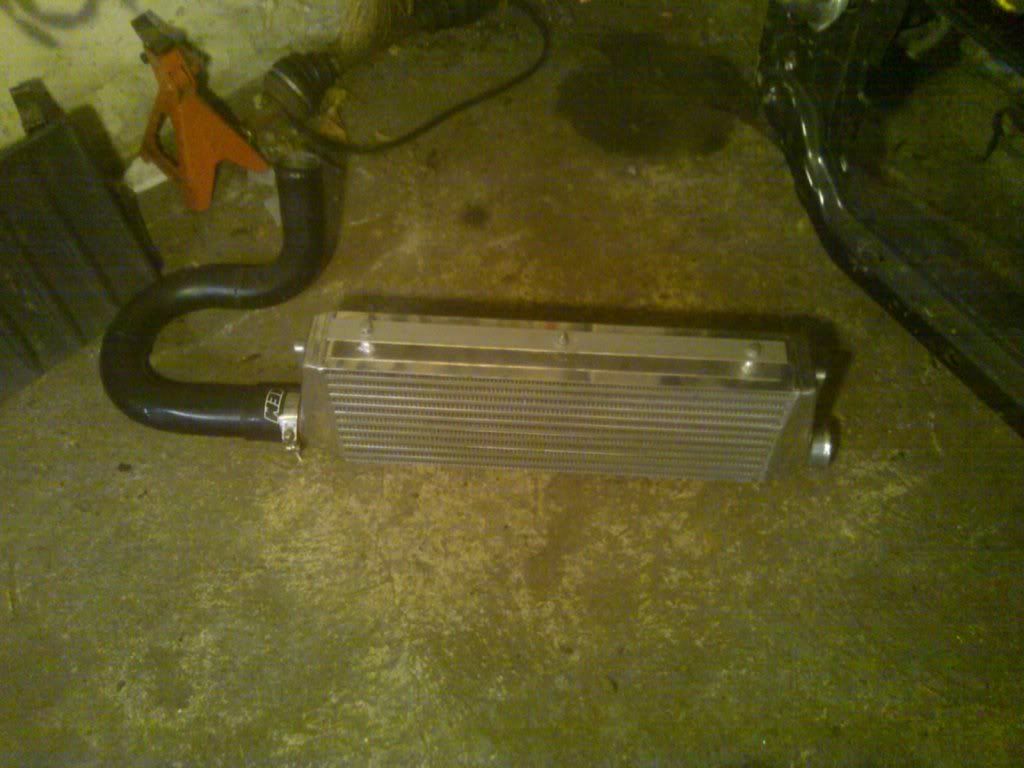

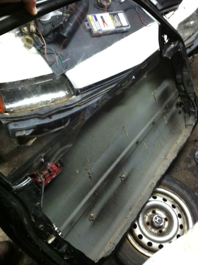

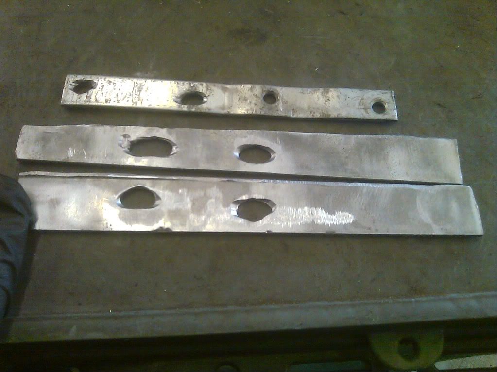

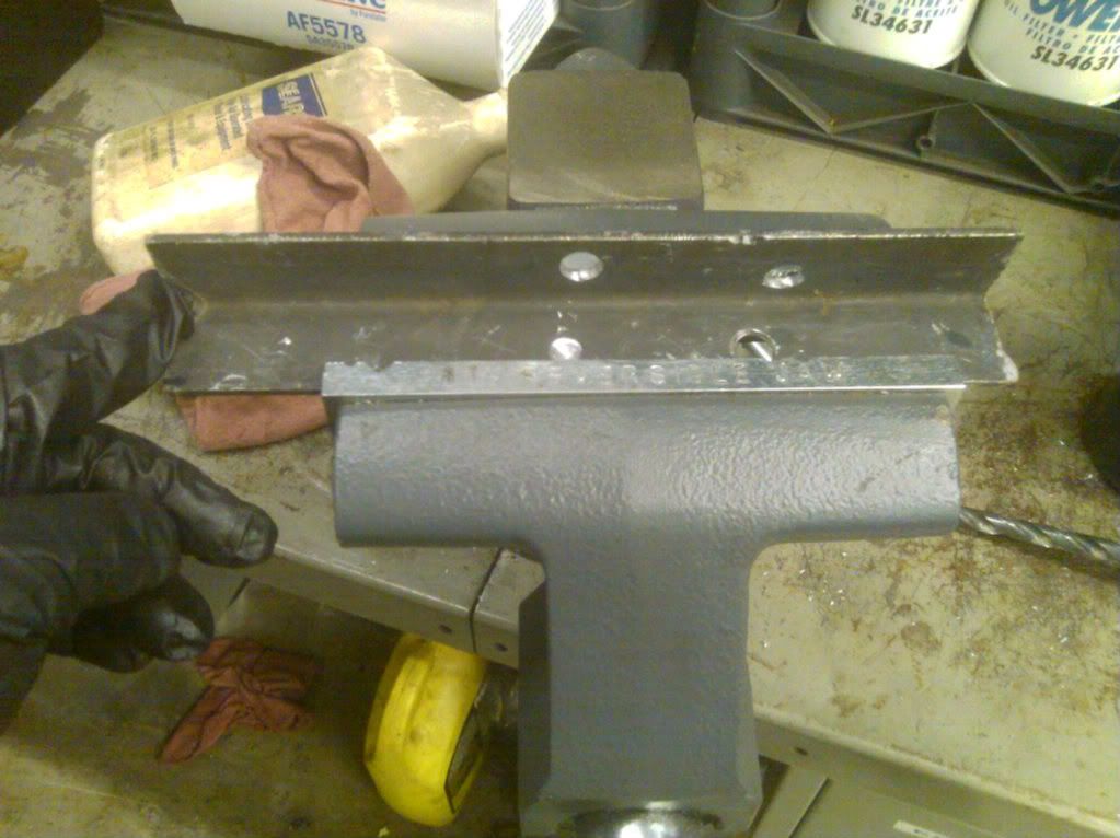

ic brakets made out of a old bed frame
holslut

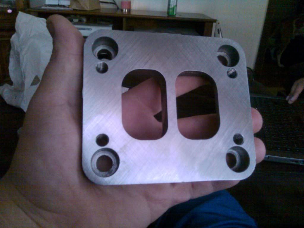

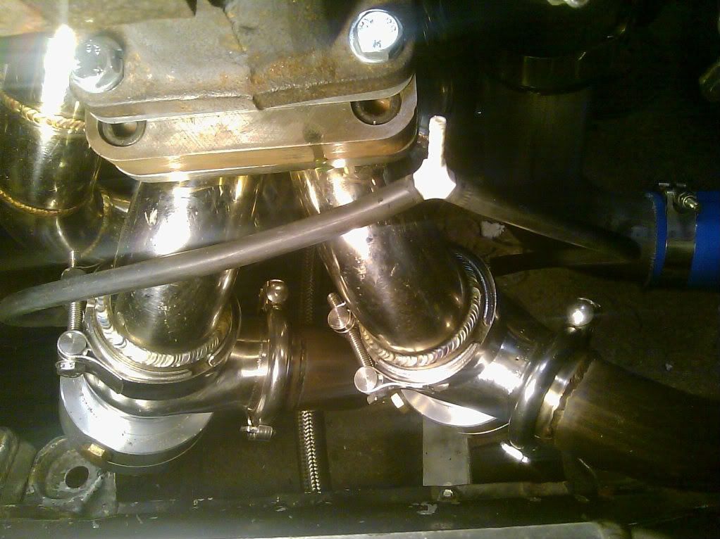

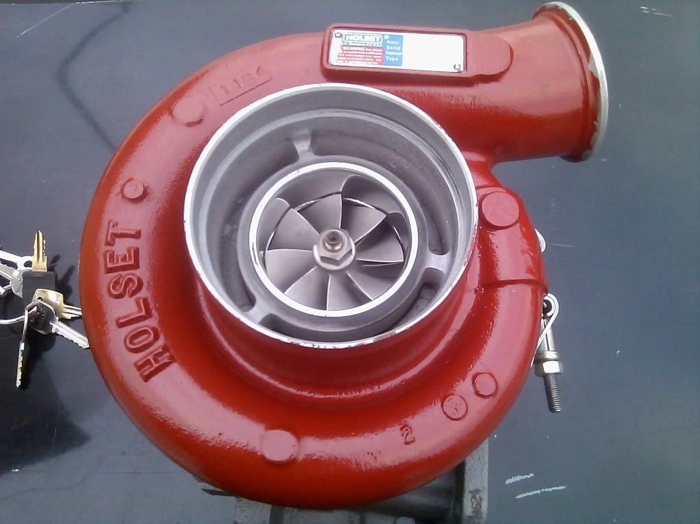

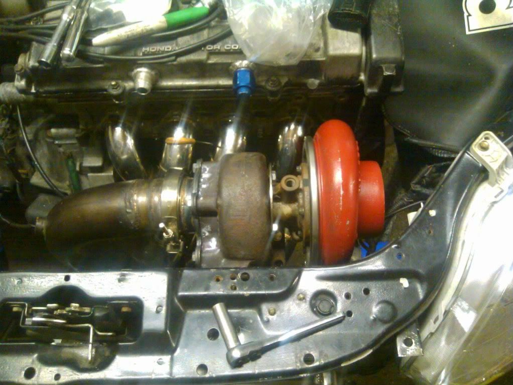

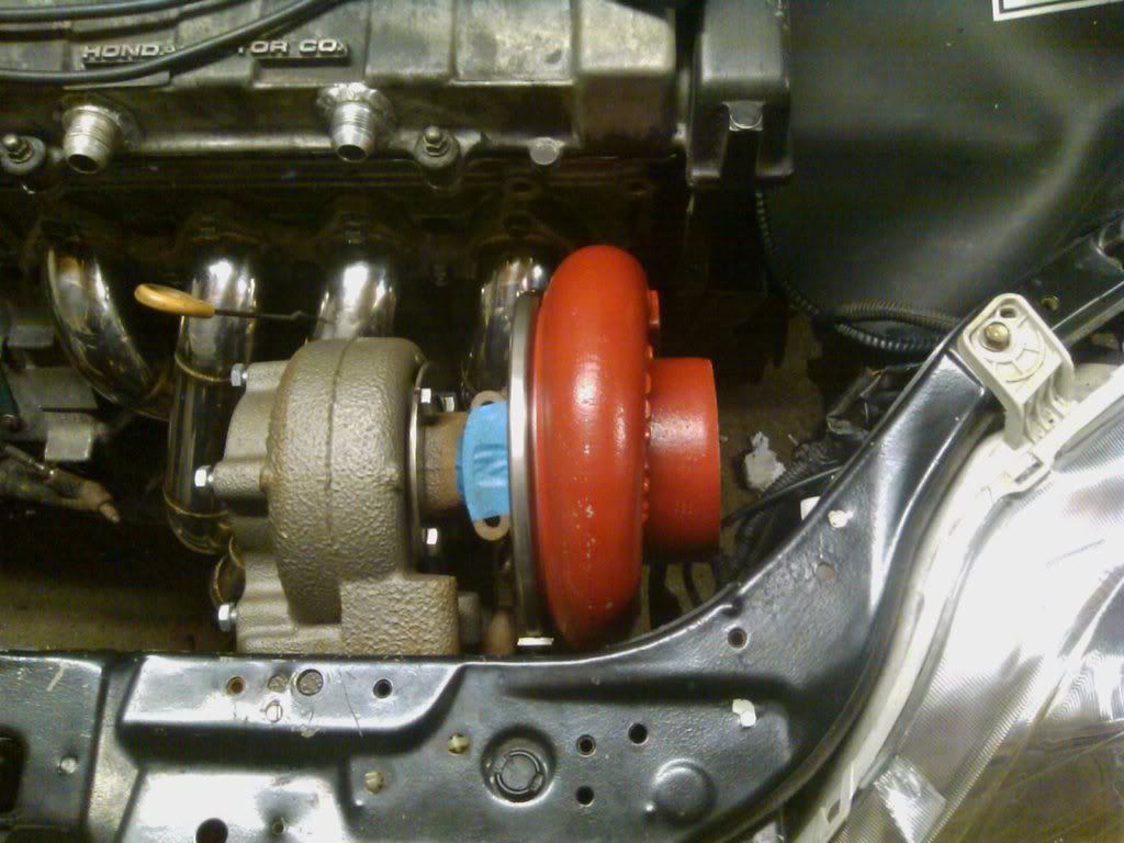

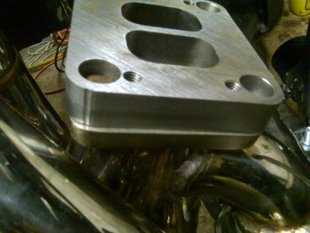

had this flange made to go from t4 twin scroll to t3 twin scroll

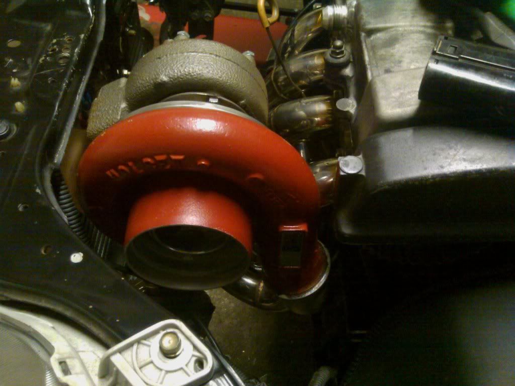

time for the twin scroll set up
egay dual 44mm wastegates

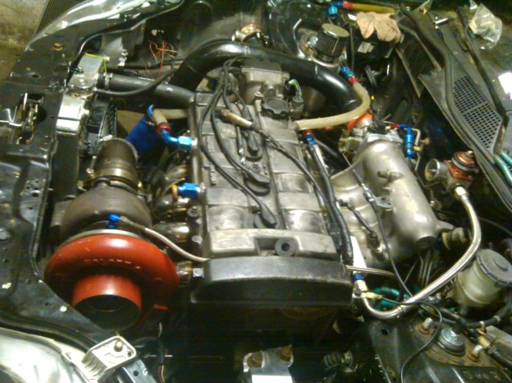

all done

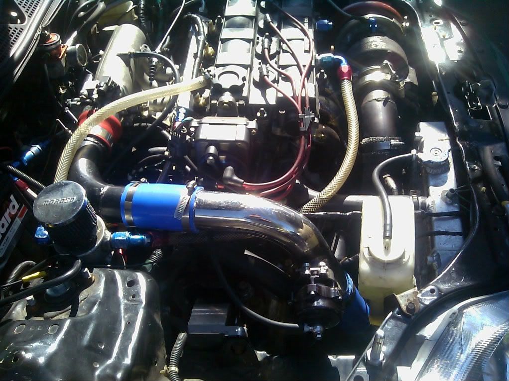

set up
stock ls
b16 trans
twin scroll topmount
holsut wh1c with a 14cm ex
egay dual 44mm wategates
2.5 ic piping all round
3 inch open dp
dsm 450's
255 walbro pump rewired
« Last Edit: February 06, 2013, 11:13:44 PM by boosted 00 black si »

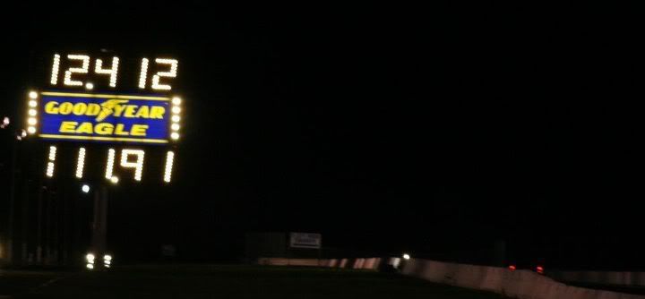

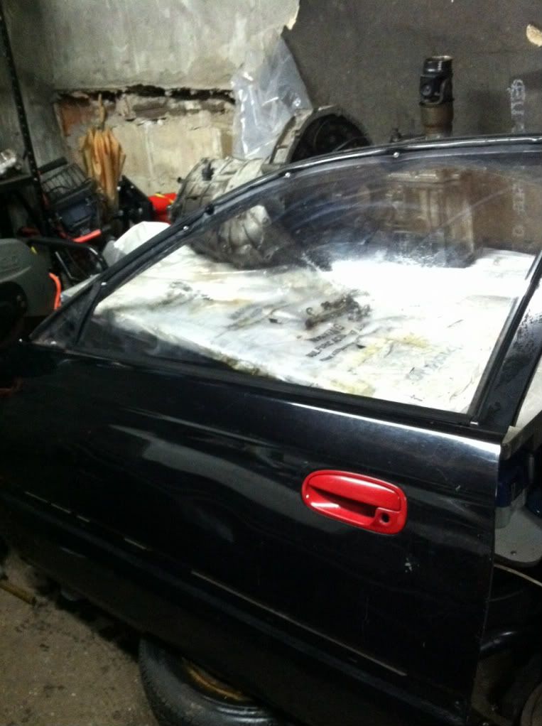

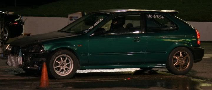

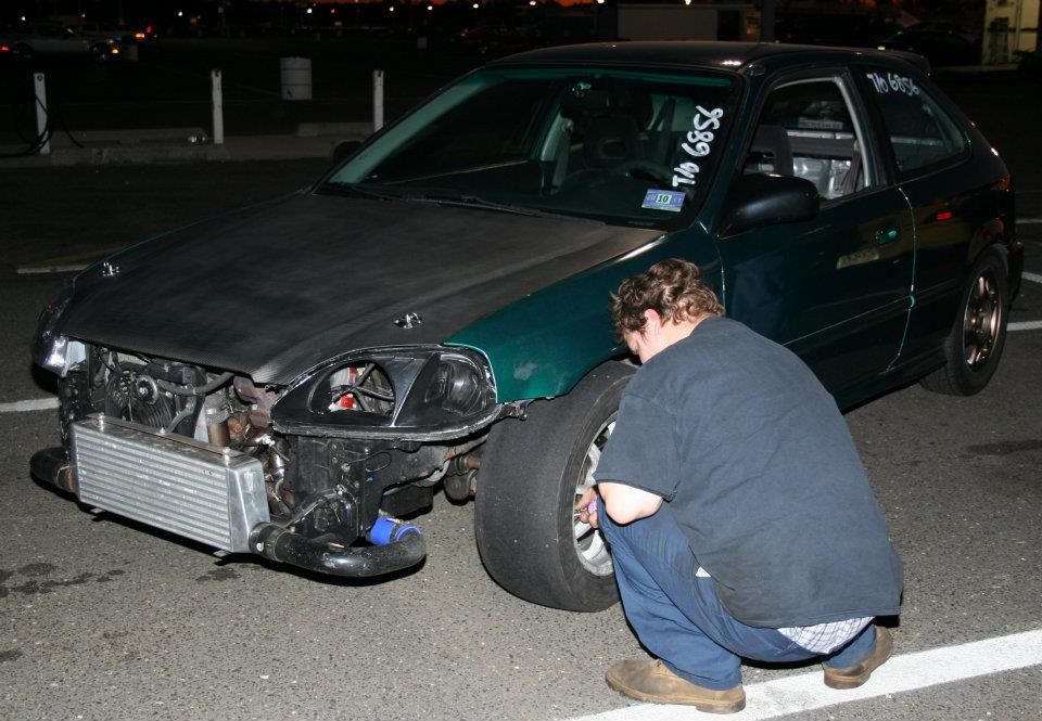

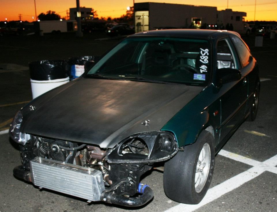

went to the track got a pass in on the car i fucking missed 4th gear but still went 12.4@111 with a 1.7 60ft not bad for a stock ls ;) weighted the fucker to its 2460 with me in it i got a set of gutted doors with lexan windows i didnt put em on yet i want the car to run 11's as the car sits with power doors and windows and then throw the gutted doors on to see what it does but next week im hitting the track again and i will run a 11 second pass with this car  8)

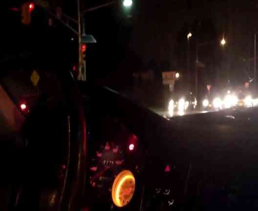

« Reply #160 on: October 29, 2011, 01:08:36 AM »
2nd-4th
1-4th
