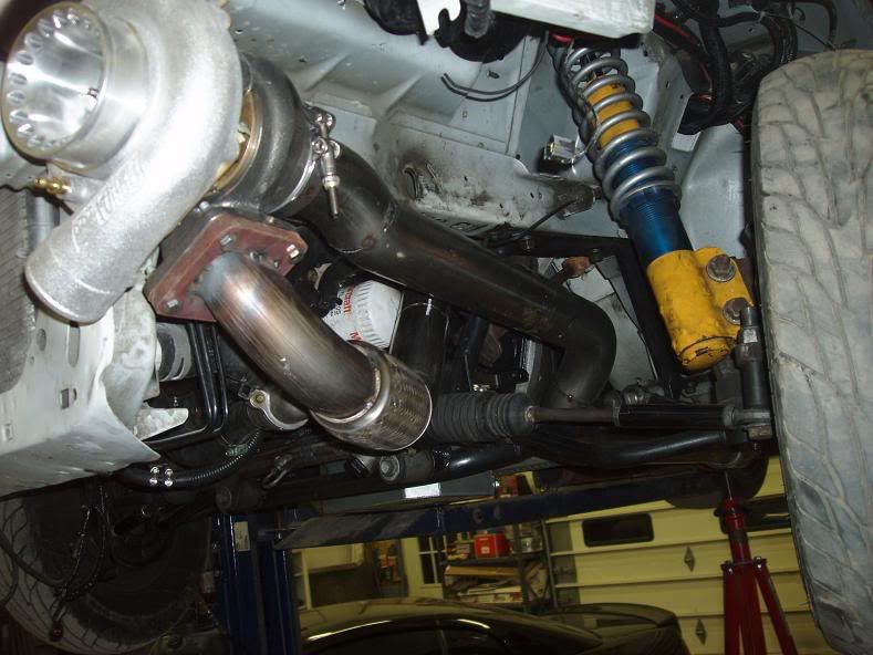

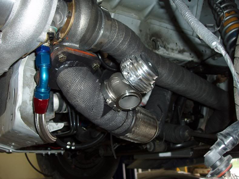

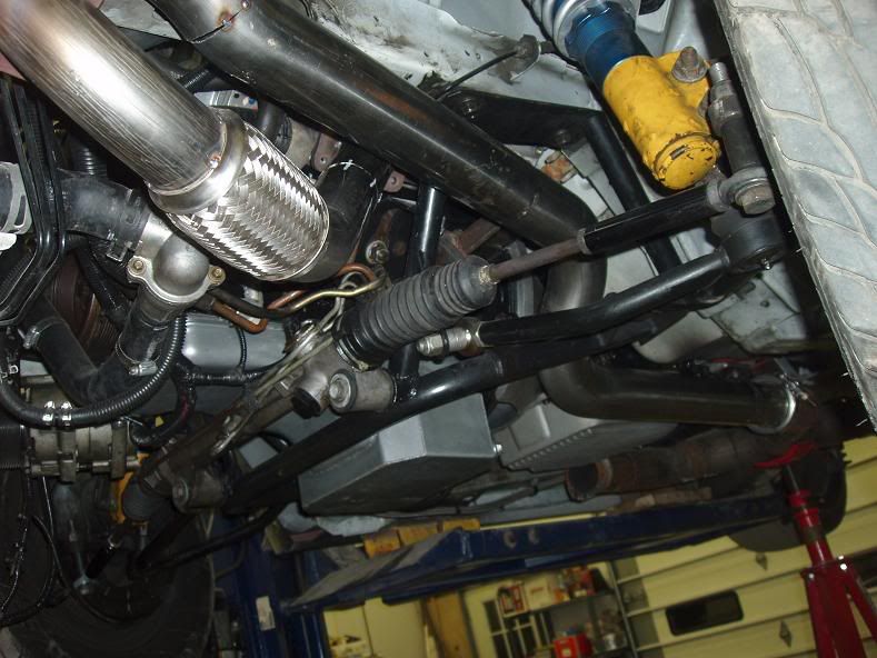

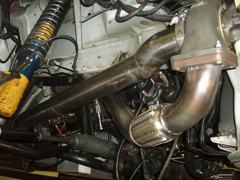

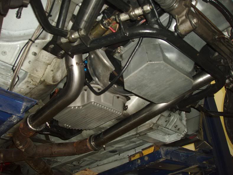

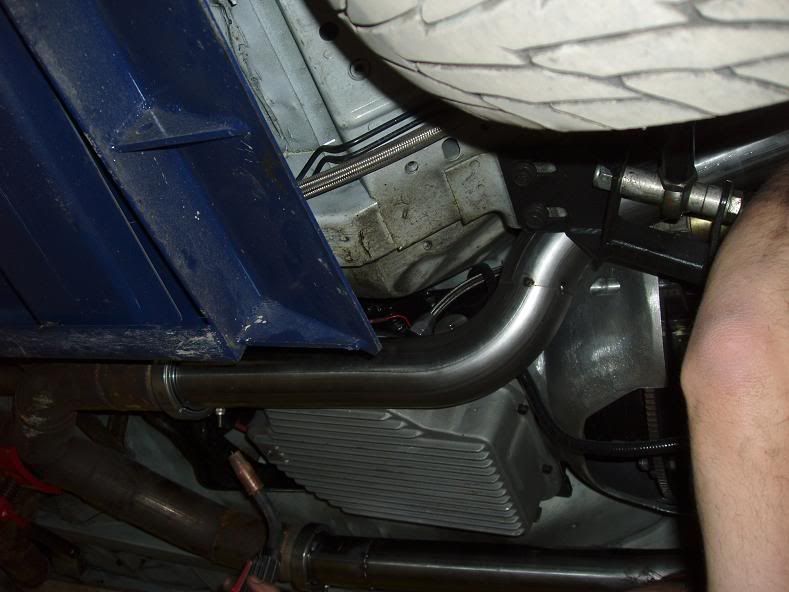

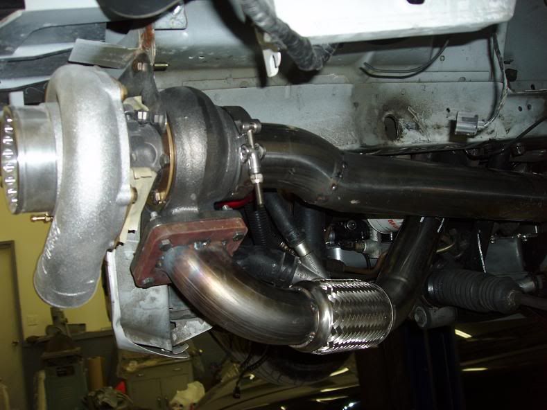

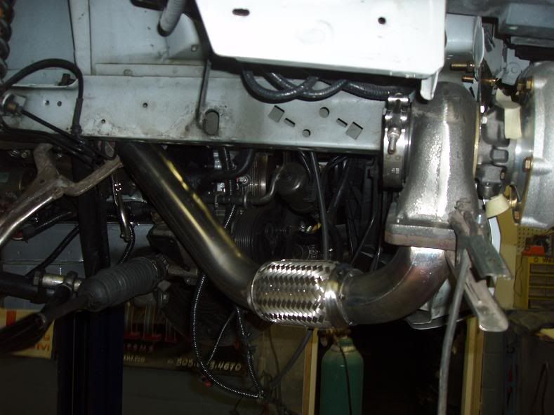

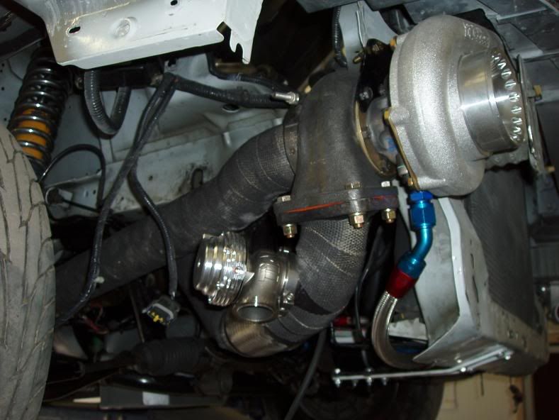

pictures on the mach STAT, specifically underneath pics of the up/down pipes.
what k member was used.

The k member is a qa1. We have since put headers on this car but the pipe routing is unchanged.

looks good. ive got no interest in removing my a/c so im gonna have to mount my turbos in the engine bay like the HP kits.
did it make the 1000hp on stock manifolds?

He has his a/c anything that came on the car is still there and working those were his requests. Even his factory gauges we wired to work with the big stuff 3.

« Reply #40 on: December 12, 2009, 10:42:15 PM »
No it did not but we never had the stock manifolds on this car. We had some log manifolds on it and it made just about 800 but the curve was horrible. With the new headers power came up over a 100 horse. The engine even wanted more timing after that and then the power difference became even larger. I think after headers and retune we were up over 200 horse peak and over 300 in the higher rpm.
hmmm the turbo mach i did didnt seem like there was enough room to come up through where the a/c comp was, granted it was a single turbo. maybe there is a big diff in the design of the k member. i was working with stock manifolds also.

« Reply #42 on: December 12, 2009, 10:57:32 PM »
The qa1 is one of the most open k members I've seen on any mustang. There is a ton of workable space.
