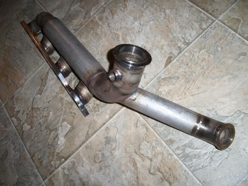

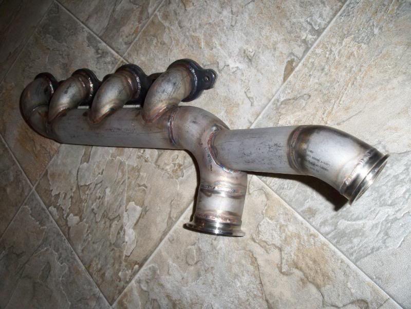

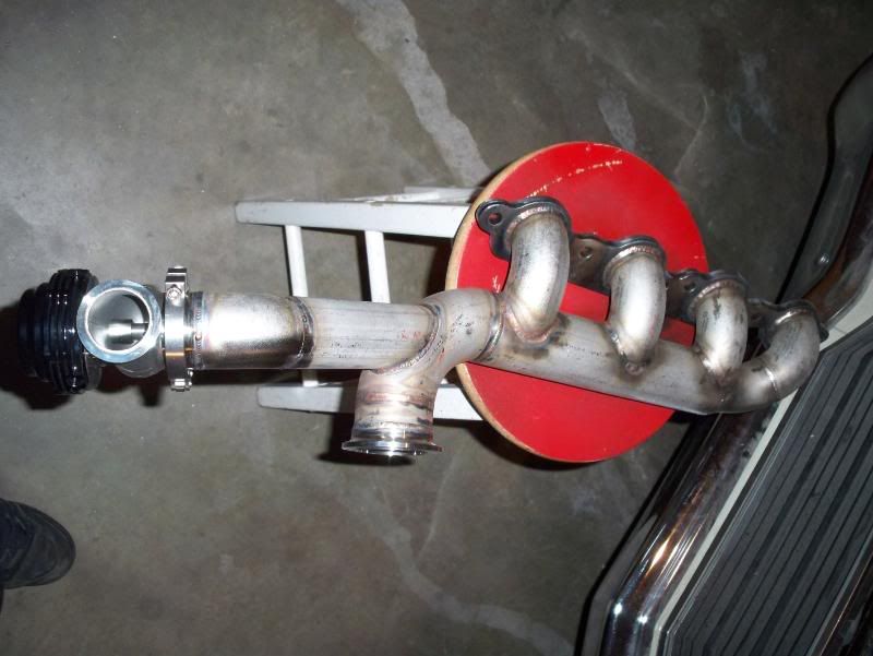

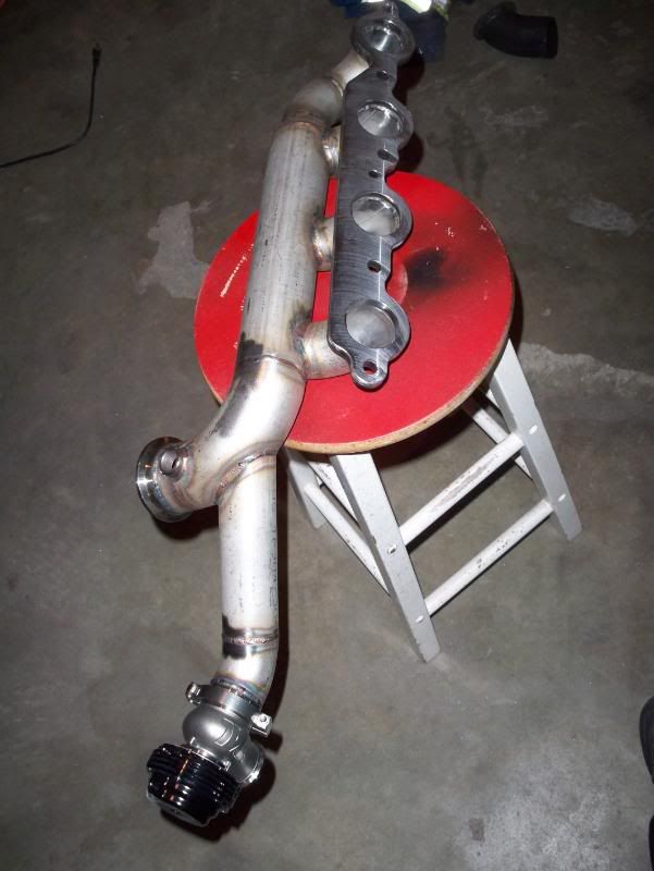

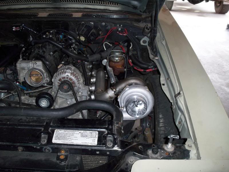

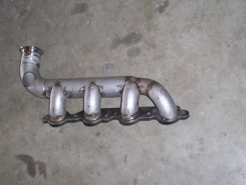

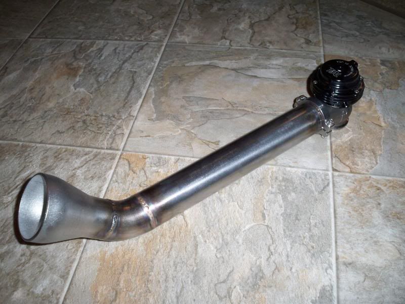

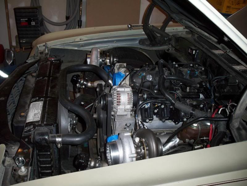

Got one manifold comleted. Both flanges got machined flat so no leak issues. Got my wilwood rear brakes today. They will go on this weekend me thinks. Rear fender lips trimmed off(tire clearance). Water line/steam pocket line kit installed. Fuel cell mounted, fuel fittings on order, and some other shit.
Pictures are way cooler then typing.
Manifold
Another angle
38mm mvs tial gate dump tube. My order was screwed up and they sent the wrong size reducers, so I slammed them on hahah
overall
dump
car

I like the setup alot, and I love the look of it all, but the only thing that I dont really car for is how the dump on the wg points at the front tire. I dont think it will cause any problems but if it were my car and with my luck I would burn a little oil and shoot it all over my front tires tread and crash.
Other than that I love this buid. V8+boost= teh Sex!
I cant wate to start building my tt truck someday!

I know what you are saying, I ran it like that for well over a year and never had an issue. I can also spin it right around and point at the ground like most doo.
Re: The Turbo Chevelle. Some new parts
« Reply #223 on: April 09, 2010, 12:19:29 AM »
totaly forgot about the whole v-band thing....lol
Right on. I dont know why, but on every open wg dump tube Ive ever made I always put turndowns on them.
lsone_chevelle
  • Posts: 210
« Reply #224 on: April 09, 2010, 12:26:28 AM »
I should grab another pic aswell. Its not nearly as bad as the pic makes it out to be. I like turn downs but it makes a fuck of a mess doing street pulls. Its a street cleaner, and it also is a huge heat score for doing any type of pull with potential people behind me. I should just put horns on it. lol
lol yea v bands are a love hate. Awesome when they are flat. LAME when they are warped hahaha

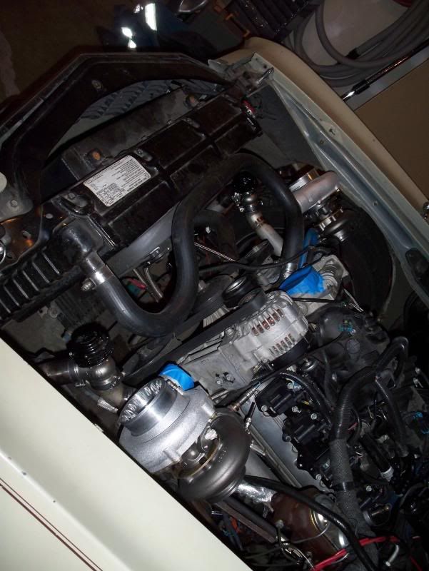

« Reply #226 on: April 20, 2010, 01:48:59 AM »
heres a video from last year. I saw the toyota boys having a meet so I showed up. Decent quality of me driving the car how I always do lol.

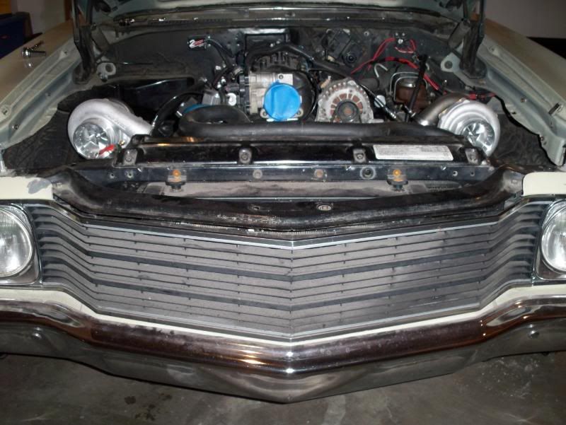

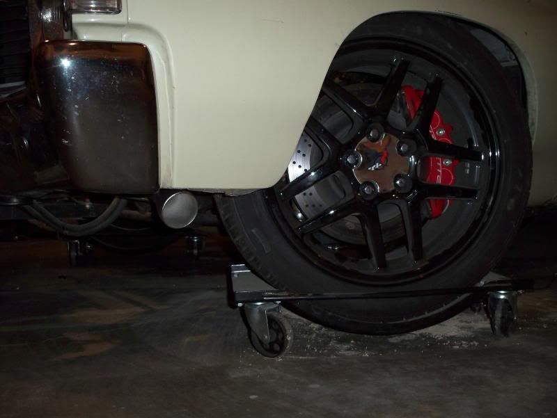

Funny you mention that, I ended up changing it, there was just too much weight way out on the gate and dump off the manifold. Slightly changed. I fnished up both manifolds tonight with gates and gate dumps. Only thing I'm not happy about, but I will change it next winter....The drivers side head is further back then the passenger side, so the identical length manifolds make one turbo sit more forward then the other. Ohwell. Minor detail.
this pic makes it look horrible, its about .75" back from the other side.
