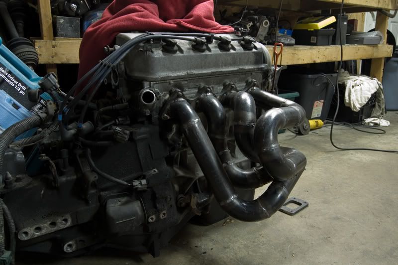

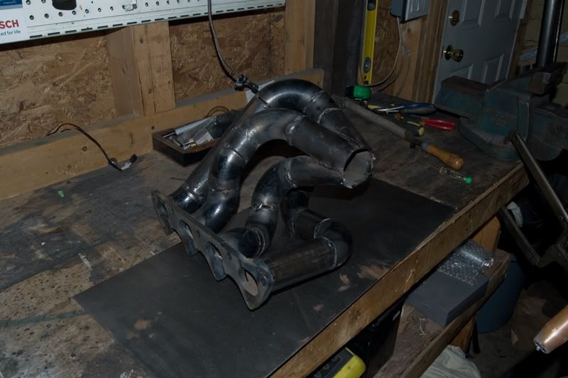

my friend darin and i fabbed this up for his ED drag car.  it weighs 1770lb and will be less when we are done with it.  vitara a6 block y8 head, zex cam, 50 trim 70 ar BEP t3/t4
hardest part was the first runner, holding the turbo in place and tacking up the 1st runner.  PITA.

what do you guys think about running the WG out the bottom or toward the block and running the dump tube straight up, between runner 1 and 2, and out the hood?? :)
as long as the DP is also going out the hood sounds good to me.

looks awesome!  i wanted to do a similar setup on a car i was sponsoring, but he wanted to keep the car streetable so i couldn't convince him to go with this style setup.
i'd run the wg under the oil pan along side the downpipe.

really nice fab  O0 , sorry for the newb question, but will it be braced somwhow to the block or somewhere or is it strong enough to hold the turbo as is?

That manifold being made from sch40 is less likely to crack then the head it is attached to.
Schedule 40 still cracks.
Re: the sickest shit ive ever fabbed in my life.
« Reply #24 on: December 23, 2009, 12:20:43 AM »
Sch 40 mild steel does have a possibility of cracking, as does all metal, but far less then a typical SS manifold does. Not only that I would still bet that if it is welded well, the head would be more likely to crack then that mani. Mild steel is very malleable, pliable stuff.
