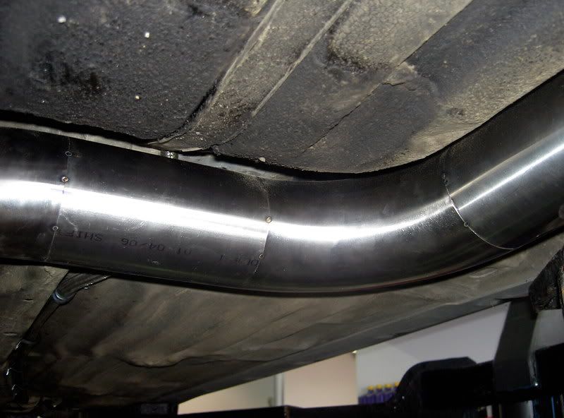

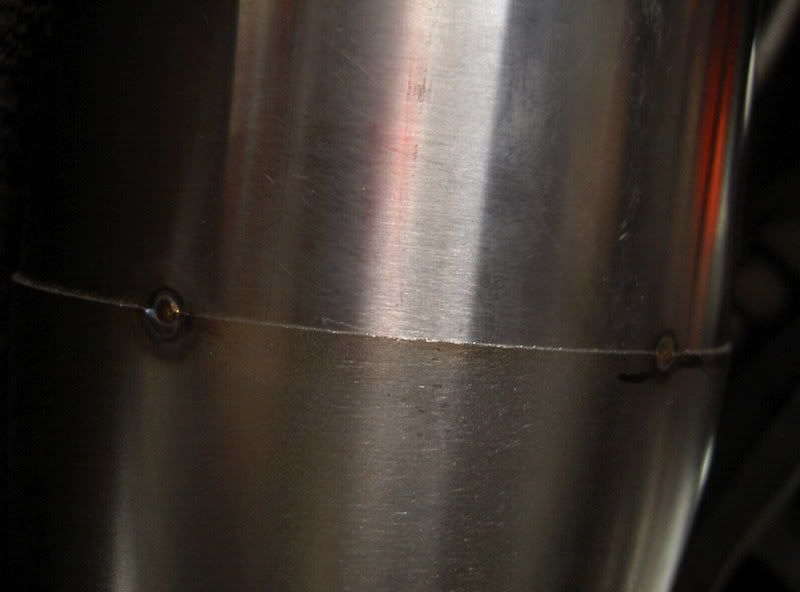

if i had to guess on that header when that runner was built there was some shrinkage when welded and that stress pulling on the runner found the weakest weld, and probably at at hottest point (closest to port) and it failed. im sure its a mixture of poor welding and no backpurge. ill give the guy credit it looks to be assembled well and id hate to have to build one of those over complicated POS.
Agreed, most fabricators underestimate the importance of fit up on tube assemblies. If it doesn't fit like this:
than you don't weld it.
LIES
If you cant fill the space with random bolts and other miscellaneous metal items
you still weld it, then use JB weld after.
BITCHES
