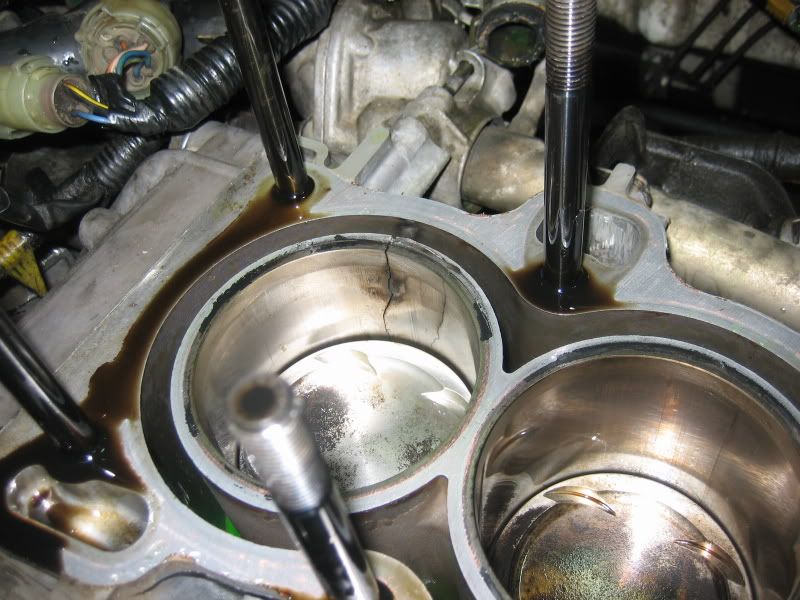

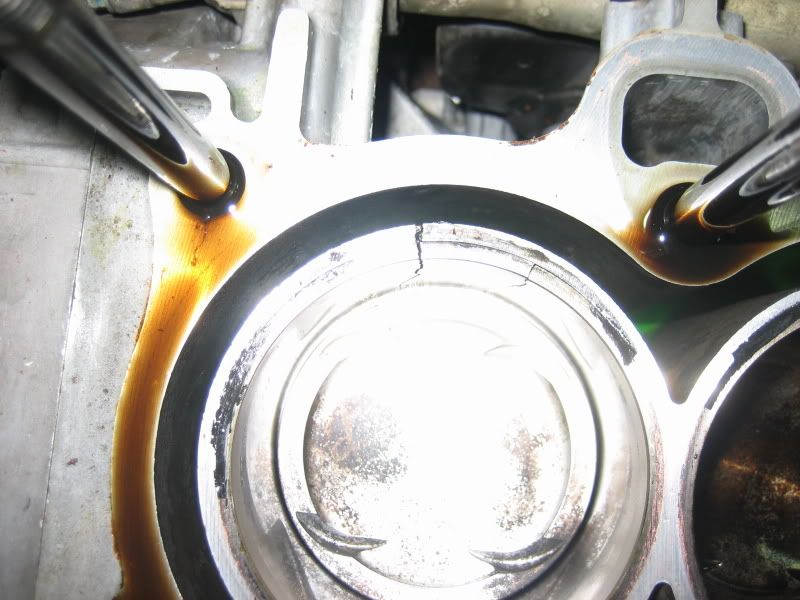

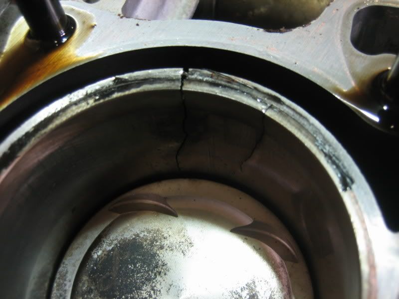

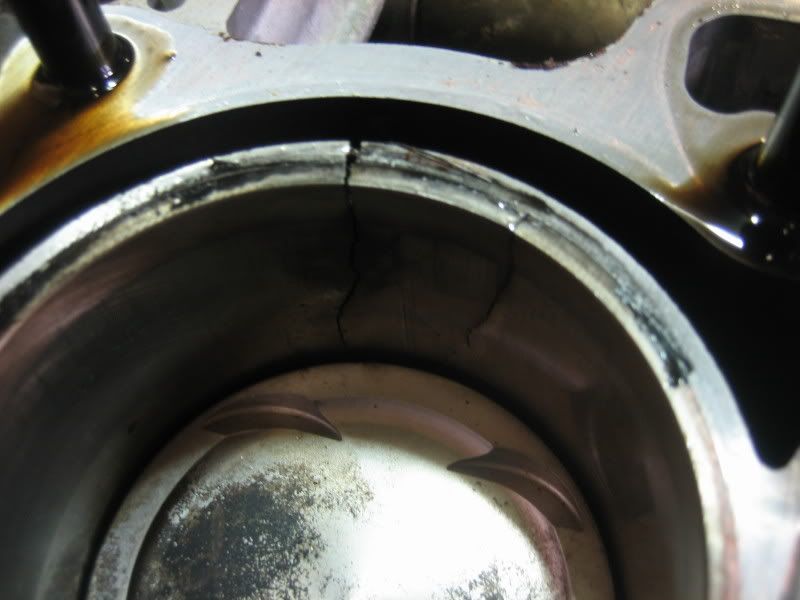

fucking around last night, had a nice 6psi spike and lost power before i could let off. huge plume of smoke, smelled coolant. i prayed it was just a hg, but it just wasnt my luck.
car was tuned for 19-20psi, last boost readout on the Greddy Profec B 2 said just over 26psi  :noel:

d16a6, SRP 75.5mm slugs, TT i-beams
it was definitely a spike, which would have also led to detonation since i wasnt tuned that high and only have a 2.5bar map sensor
