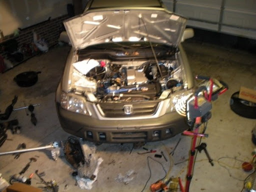

A few months ago, I bought this here 2000 CRV with the specific intention of BOOST.  It's 5-spd and AWD with 160k on the clock.
+1 internets for JD's advice
On Order or not installed yet:
Muffler
resonator
hangers
CDM cast manifold
adapter plate
intercooler
gauge pod
to order:
piping
flanges
clamps
beautiful exhaust tip
I'll probably need a slim fan for the AC.
Probably keeping it IWG.  If creep becomes a problem (which I don't anticipate) I'll switch to an external.  Shooting for 220-240whp.  Keeping AC/PS.
Installing LSD street-disc clutch

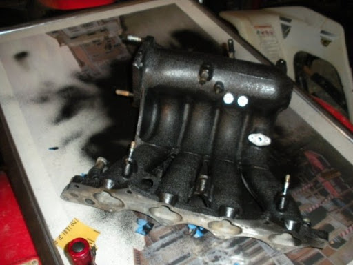

b18b intake manifold

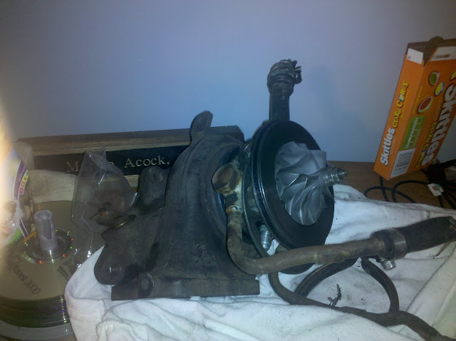

Big 16g turbo and Crazy Colors Skittles

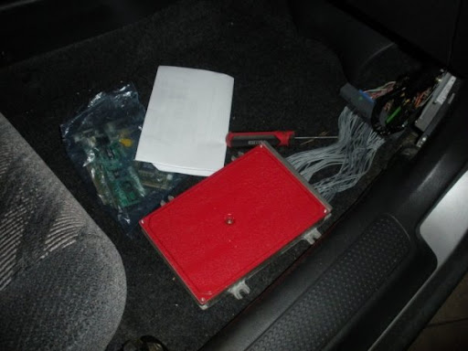

Crome on a P75.  SRT-4 Stage-0 injectors not shown

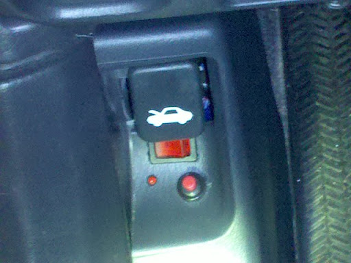

LC-1 master control panel (sometimes you want IG on without running the WB02)

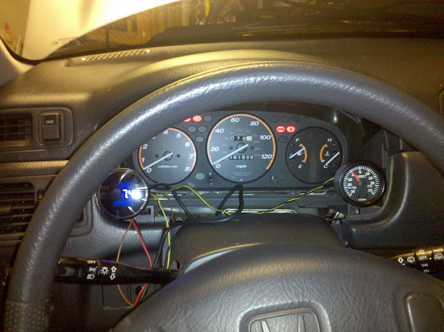

Gauges in, waiting on pod

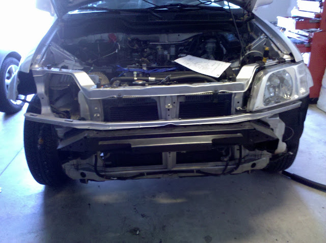

Repairing a headlight and figuring out piping routing

gauge pod installed...shittily.  OBX sucks donkey balls.  News at 11.
Its cold as fudge in the garage but I think I'm gonna go remove the exhaust.

This is the 16g I got.  DSM guys seem to have good luck with it.
http://www.bblgroup.us/automotive/product/evo3gt/

where do you order a turbo like that? and i knwo where to get a hahn (racecraft)super 16g turbo  they have a t3 inlet too 10cm housing.. i

I found it on CL.  Some guy was parting out his eclipse and I got it for like $60 or $80.
