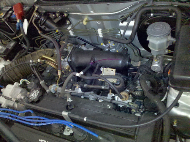

Big 16g turbo and Crazy Colors Skittles
Crome on a P75.  SRT-4 Stage-0 injectors not shown

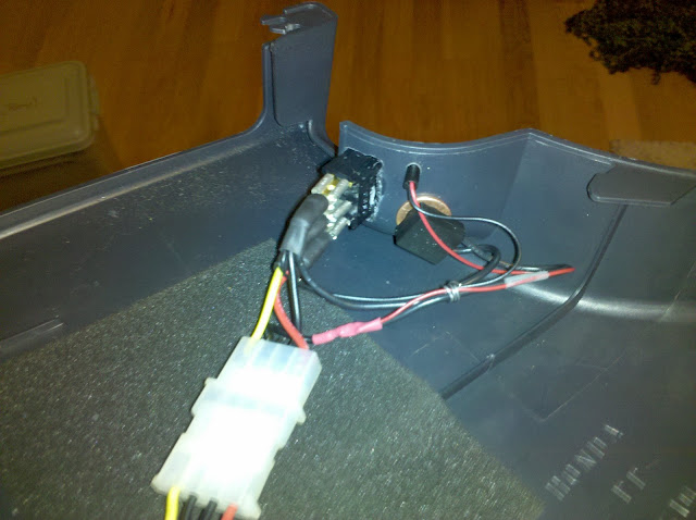

LC-1 master control panel (sometimes you want IG on without running the WB02)
Gauges in, waiting on pod

stock exhaust is outta here
gauge pod in
WG block-off plate
