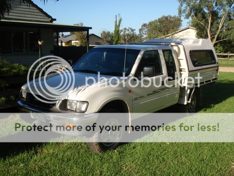

hi nogs, from australia
1998 holden rodeo tray.
2.8l turbo diesel 4jb1t, 5s, 4x4, LSD

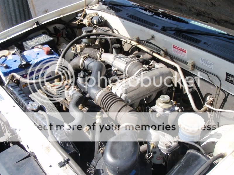

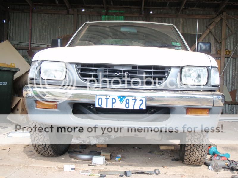

before shot
stock motor  :'(

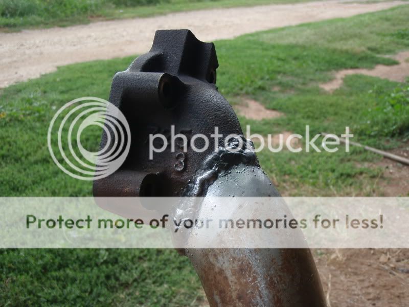

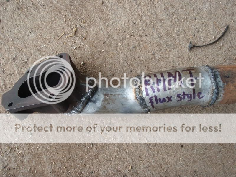

fluxcore 2.5" dp, cast to mild  :D
you like?
all junkyard exhaust, 2 straight thru mufflers from diesel ford van, reused hangers from old exhaust

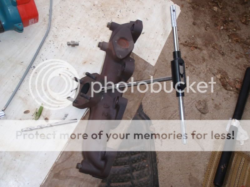

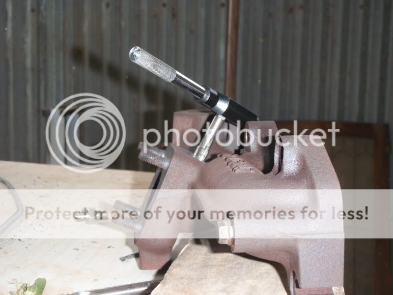

when tapping ex mani for drive pressure gauge and pyro, found i couldnt turn the tap wrench.....
until i grabbed a 1/4" extension, perfect fit!

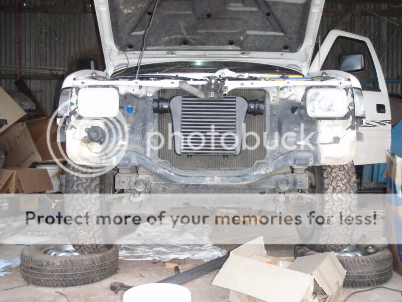

during mock up

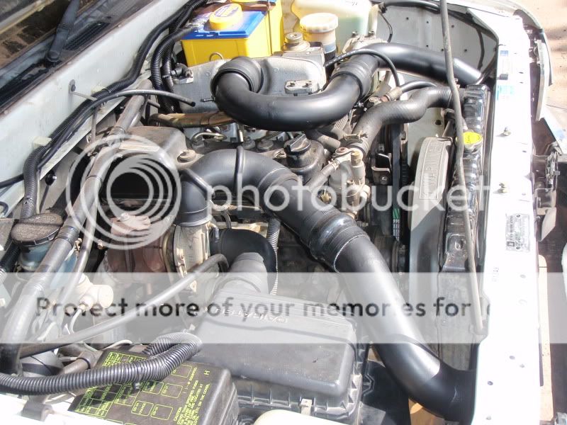

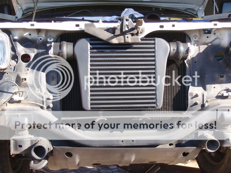

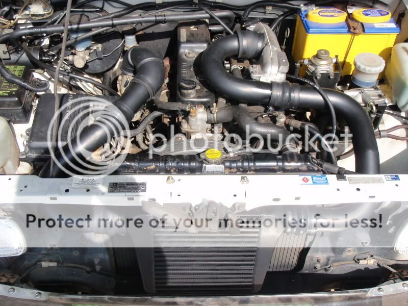

cdm cooler and homemade piping, flat black, 2.5" mild, all fluxcore welded. airbox is from a junkyard daihatsu charade hatchback lol
engine bay side, cut 4" hole in bottom of airbox for flow...

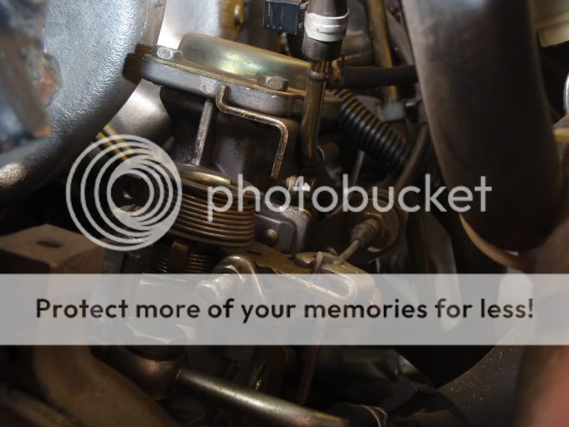

ve pump, looking back from radiator
cooler mount bracket visible behind number plate

Looks like there is lots of room for twins. Do you know what the plunger size is in the VE?

« Reply #3 on: April 14, 2010, 12:14:58 PM »
That mani looks super restrictive. I like :yes:
i havent even touched the pump yet. my plan is to crank the boost in the stock 38/52mm turbo to a bit less than choke point, and a bit more mid range and top end fuel.
at what rpm does it start to defuel?
4 cyl
11mm plunger, and as per pump serial number, "governer controlled rpm number" is 1900rpm. i do not know what this means.
has mechanical governer
pump s/n: NP-VE 4/11F1900LNP1685
any clues about the governer number?

HX-35 14cm if it is cheap will work just fine, you can always do a 60mm compressor wheel upgrade if it is limiting you.
1900rpm is pump speed so x 2 for motor speed 3800rpm is where is should start to defuel. I would mod the gov springs so you can at least pull full fuel to 5K. Heck I run stock cummins to 4K, and stock vw td's to 6K.
Adjusting the timing should be nothing more then loosening the front 3 bolts, and then one rear bolt, and pushing it the whole pump towards the head. Might need a ratchet strap, as some times they are sticky.
Back the high rpm screw right out and throw it away, and as you add fuel pull the low rpm screw out to bring the idle back down. Adjust the throttle cable and linkage for full travel.
Pop the top off the ip 4 flat head screws, and index the pin for max depth, shave the nylon washer so that it travels all the way to the deepest point. When you get it apart you will see what I mean, as there will be a rub mark on the pin, use that as a guide for which way to turn it. **Should be so that max depth is towards the Rad** but I have never worked on that particular setup so it may vary.
Dave (Passenger) has made 200whp on a 9mm 4cyl pump. With the 11mm pump maxed out you should be close to 400hp worth of fuel. Stock 12mm VE's on 1st gen cummins will move nearly 500hp of fuel maxed out
If it doesn't already have one, add a lift pump now, set it so the pump sees 15psi or so. This is very important.
If you really want to make some power, I would look at an HY35 with an external gate over something in the 64mm range. The TD04l over an HX-35-14 should be good for 300hp at reasonable egt's and 350hp+ if you ignore the egt gauge. Or you could aways spray it at that point.  O0
in reality i will only ever rev it to 3700ish anyway, and prob not regularly.
i saw a youtube video and a tech writeup, timing bump, turning fuel cone pin, and star wheel look easy to change.
diagram was useful
i'll remove the high rpm throttle stop pronto.
can i use an inline efi fuel pump with external reg for a lift pump? seems easy to make.....
junkyard bosch 044 here i come.  O0
