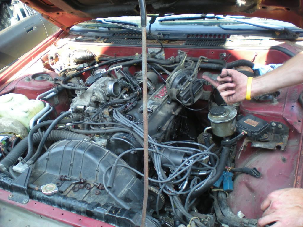

The engine bay as it sits now needed some much needed boost

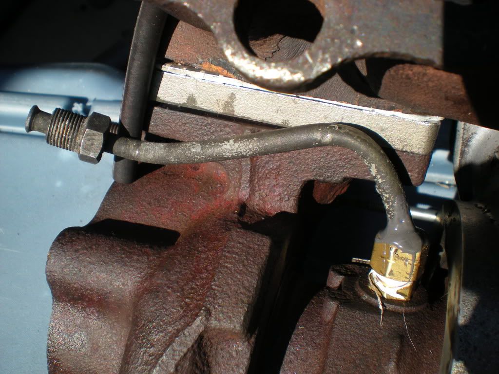

Here is one portion of the oil feed I made.  Jb weld, ace hardware  parts and all.
Other part of the feed line

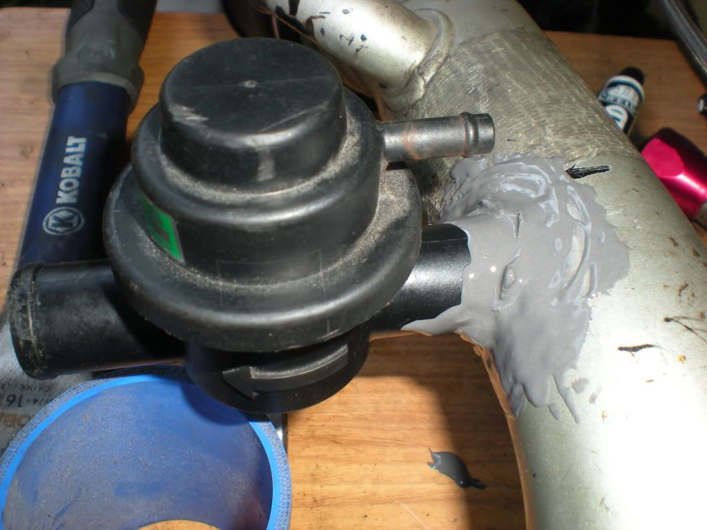

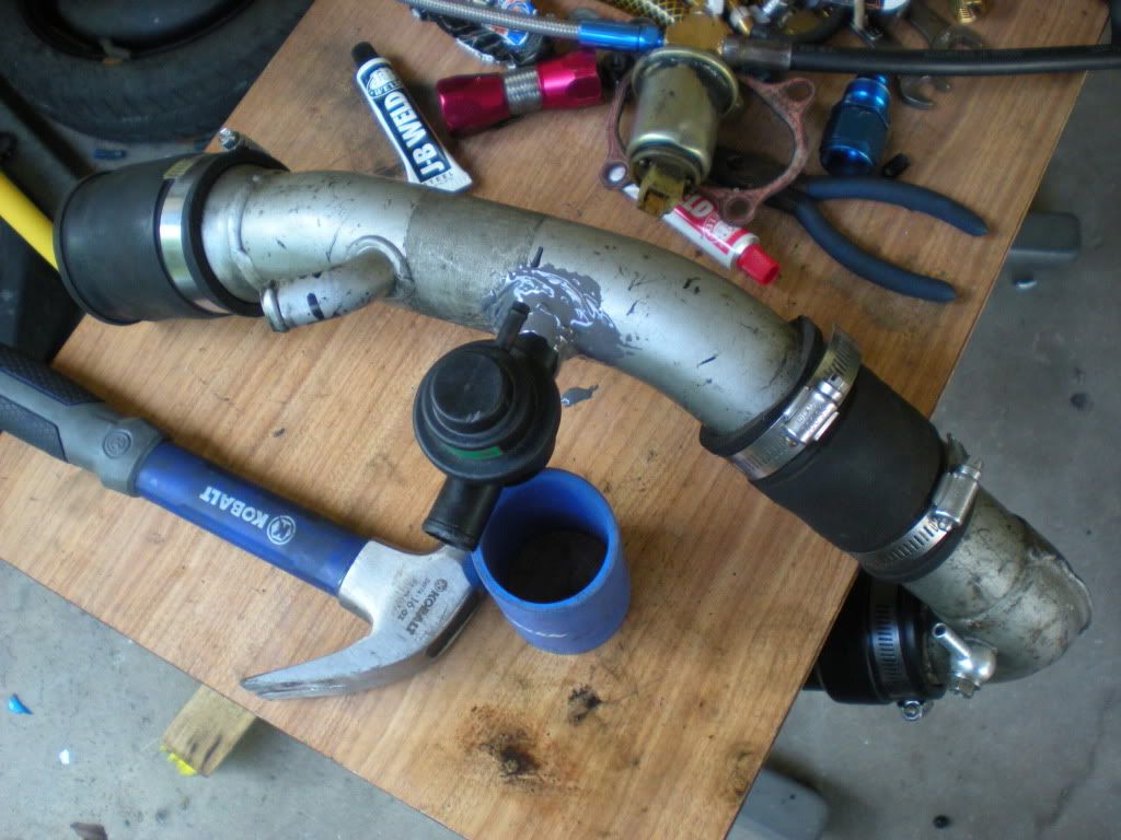

Charge pipe (yea thats all of it)  straight from turbo to TB.  Notice the jb welded bov
RX7 bov jb welded to charge pipe  O0

Also look closely at how the bov is attached.  The raised metal underneath the jb weld is where I drilled several holes then used pliers to peel metal off till it was big enough.  I cant afford proper cutting tools atm  :mexi:

That BOV is garbage and will leak.

Better off with a Bosch valve. Or put a big check valve on the end of the one you have.
I guess its not really a piece of shit. It is just not ment to be vented like you seem to be doing.

its set up like stock, but in a manner that pushed its similaritis to the limit.  That bov (i think its called a bypass pov or some thing) is hooked up attached to the air box and is right next to it.

I would seriously consider doing something different wth the oil feed.
Vibration is going to cause you some problems in the future and spraying hot oil
and a hot turbo are a bad mix.  I had a metal brake line oil feed crack
once and spray oil onto the turbo/manifold.  Made for a nice sized fire.
Other than that if it works, looks good. I've done some more ghetto stuff in the past.
Re: 200sx Stank ride build
« Reply #14 on: May 07, 2010, 08:47:36 AM »
100% correct.  That JB on the feed is gonna fail fast.  Otherwise, solid RHMT'ing  :yes:

Its only temporary till I get $$$ for something better. O0

bad news:  Friend helping me drop the turbo and broke the oil line i made. fffffffffffff
good news: said friend is buying me an oil feed line with fitting  O0 I guilt tripped him into it.
