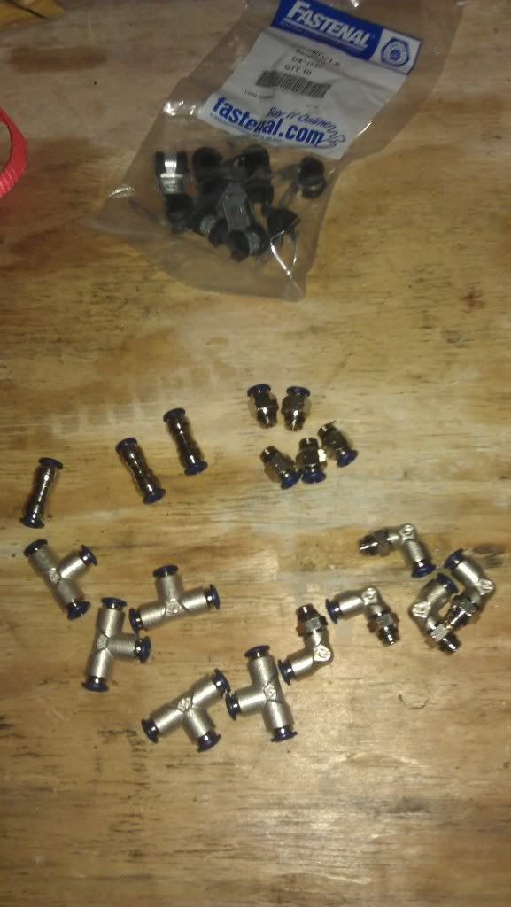

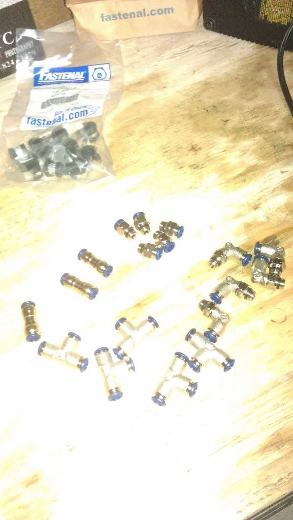

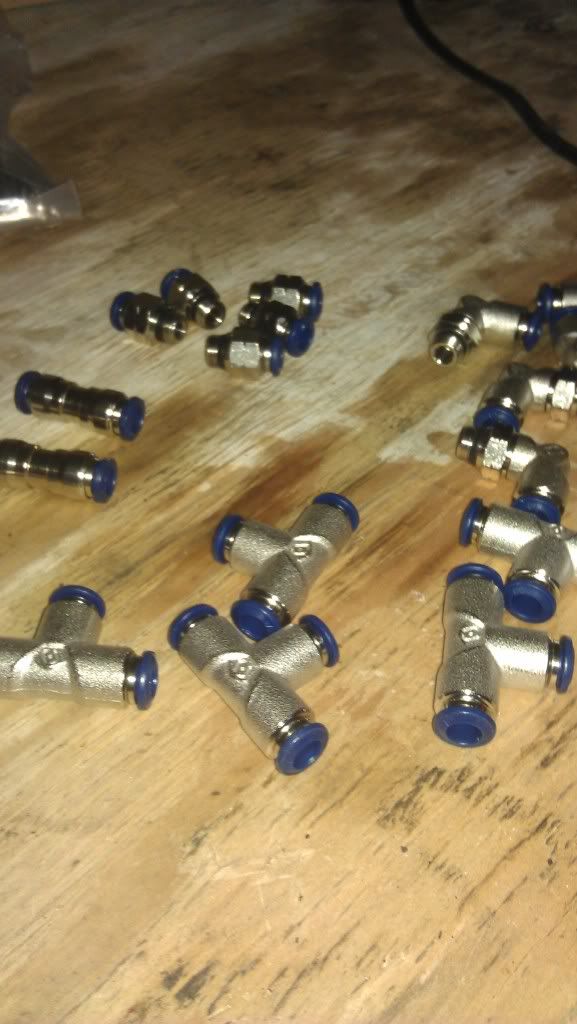

got some new goods for my vac setup

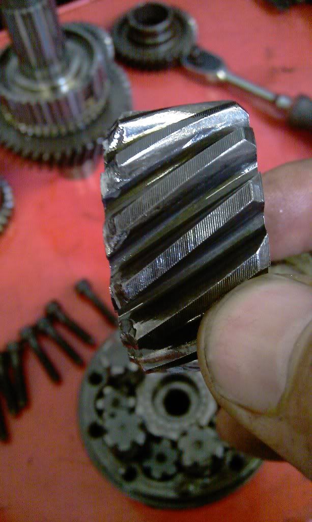

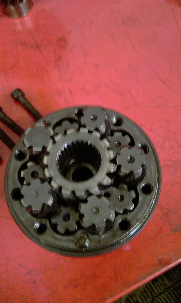

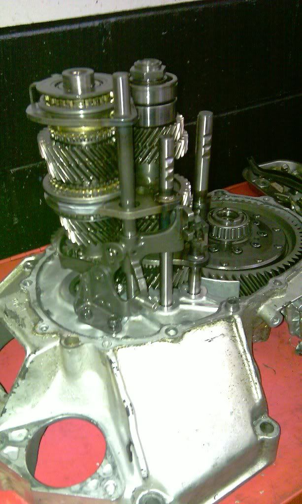

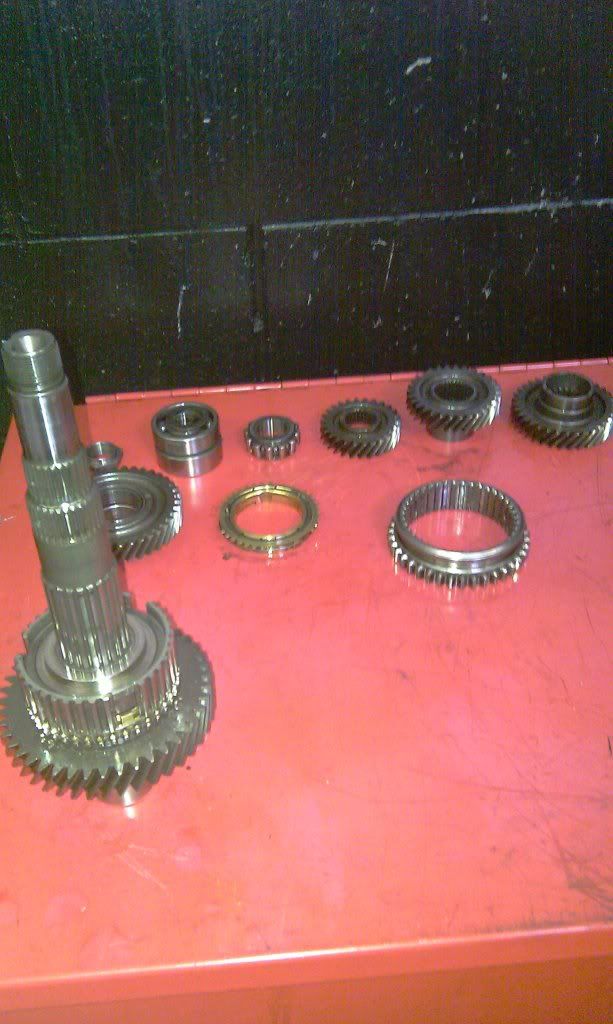

your diff looks like mine!  still works though...
hatchbone
  • Posts: 1708
Re: hatchbones ride
« Reply #9 on: December 24, 2011, 03:25:06 PM »
I got new washers and re assembled it as is and works like a champ

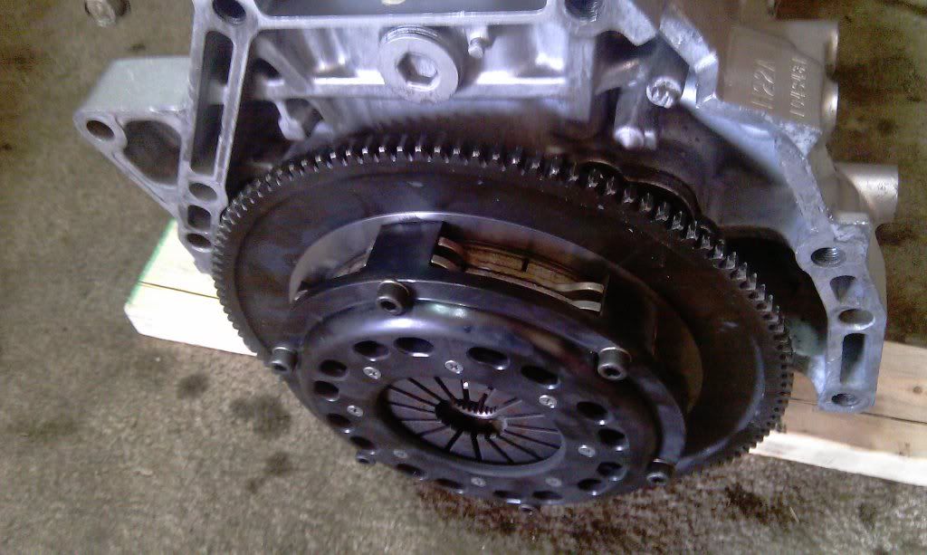

I didnt have the same ones, but I had quick release with that plastic shit, and it melted where it came out of the turbo. Worked great for my BOV, and stuff like that. Someone told me they make all metal quick release adapters.
DSharp
  • Posts: 407
Re: hatchbones ride
« Reply #11 on: December 24, 2011, 09:43:06 PM »
yep.  same here.  obx washers are like potato chips.

Around 800-820 it kept spinning over 8k on the dyno but it made 702 on 24psi its now at 34psi the dyno I use has a new strap design I just haven't put it back on the rollers,first thing next year though
Re: hatchbones ride
« Reply #14 on: December 25, 2011, 12:27:33 PM »
Fucking baller, will the obx hold up? :?:
hatchbone
  • Posts: 1708
Re: hatchbones ride
« Reply #15 on: December 25, 2011, 03:31:31 PM »
Has for three seasons already lol
Re: hatchbones ride
« Reply #16 on: December 25, 2011, 08:59:00 PM »
Damn I seen a lot of trash obx around here under 600hp :?:
hatchbone
  • Posts: 1708
Re: hatchbones ride
« Reply #17 on: December 27, 2011, 03:22:38 AM »
get the washer kit and re torque and you good to go for half price
flat_black
  • Posts: 315
Re: hatchbones ride
« Reply #18 on: December 31, 2011, 12:31:47 AM »
brian is still using an OBX in his trans, thats about the only thing that hasnt broke...

Your first post was coming at me asking me where the porn be ,I think I should be asking you that  O0
if people ar breaking obx diffs theyre nos tetting them up right. I beat mine harder than I beat weidebodys ex roast beef and never an iddue, Washers are a nust.
hatchbone
  • Posts: 1708
Re: hatchbones ride
« Reply #22 on: January 10, 2012, 09:02:01 PM »
should not be a issue if set up properly

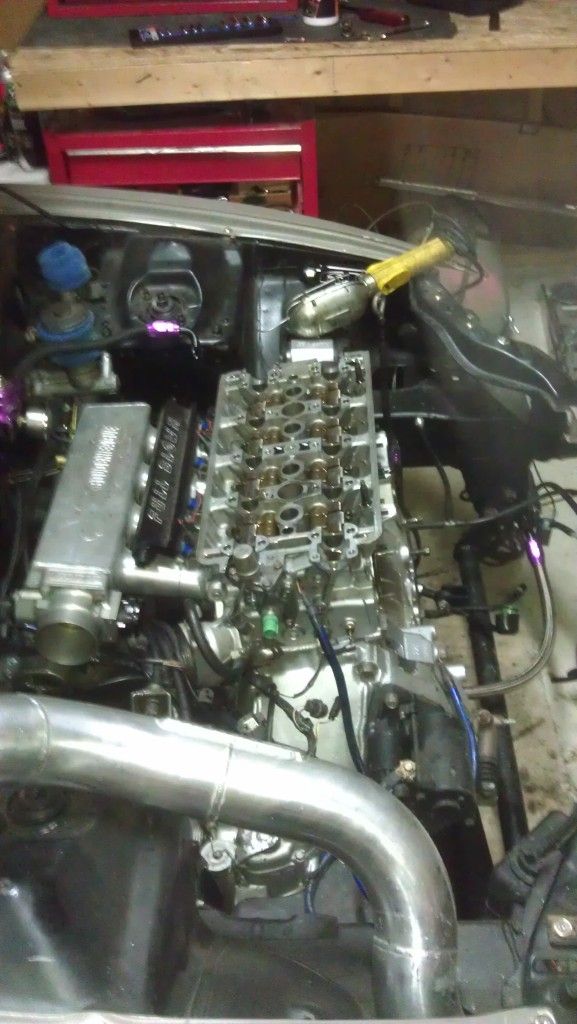

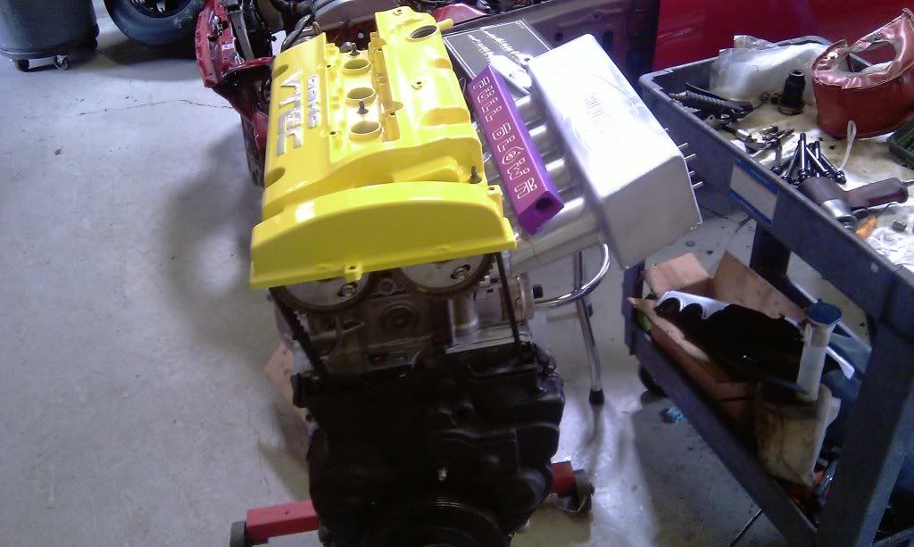

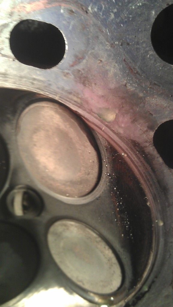

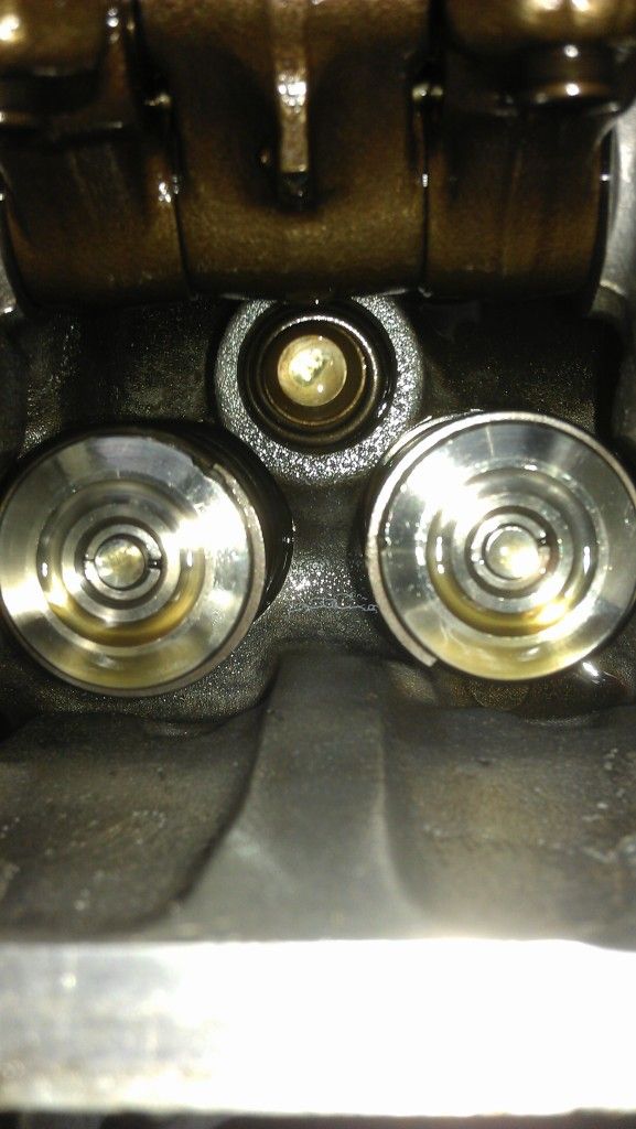

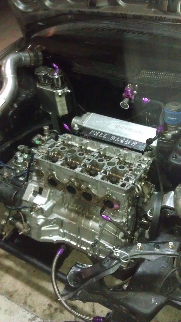

so got around to pulling my head off this is what it looks like when your springs try and pull the valves through backwards not a big deal, could of been a lot worse, could of snapped off here are some pics never will i run superstretch again. couldn't handle the anti lag
Re: hatchbones ride
« Reply #24 on: February 19, 2012, 02:57:56 PM »
I'm not understanding what happened, besides the valve beating the piston. Mind explaining, such as failed retainers, keepers, or valve stems?
hatchbone
  • Posts: 1708
Re: hatchbones ride
« Reply #25 on: February 19, 2012, 03:05:27 PM »
the valves got so hot from my anti lag they got soft and the force of the spring wanted to pull them out backwards, the pistons are fine but a couple of the retainers are a little beat from hitting the rockers when the valve stretched
Re: hatchbones ride
« Reply #26 on: February 19, 2012, 03:10:09 PM »
Time to add sodium...at least for the exhaust side. The only problem is honda valve stems are already so thin.
Re: hatchbones ride
« Reply #27 on: February 19, 2012, 05:09:10 PM »
No need for sodium valves. At all.
Jake I dont think it weas the antilag. Looks like it went lean (you did mention this happened after upping the boost?) It went lean and EGTs got very very hot by the looks of it, maybe more than once...  Fuck Superstretch/snap valves though. Go Ferrea. Ive NEVER had an issue. Valves do look like contact was made... Pics of valve reliefs?
NICE CATCH Jake....Glad those things didnt cost you a bottom end
hatchbone
  • Posts: 1708
Re: hatchbones ride
« Reply #28 on: February 19, 2012, 06:10:51 PM »
I'll get some more pics up soon could of leaned I do have my data logs from my last race ill peep and see what they say

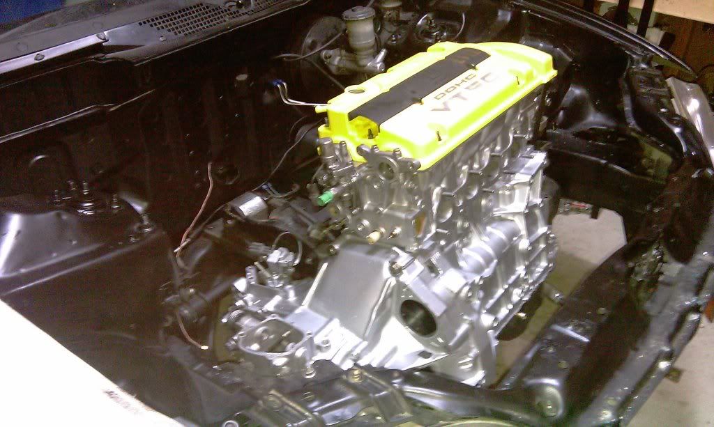

head is back new valves and seals should be rollin by end of weekend
