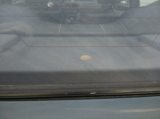

so a lame ass update. but i feel good about what was done, and thats what counts. couple little things bothering me that i can check off the list...still a couple more.
4WS sticker... i dont have 4WS shit anymore...
GONE!!!
those caps on the back deck are bothering me too... need to replace/paint/something
didnt even bother to take a pic of this thing on the car. obviously it needed cleaned. but it is also just an ill fitting piece of shit 1g DSM shift boot. the Galant one was 80's accordion style  :o

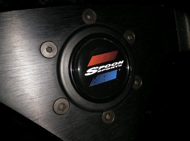

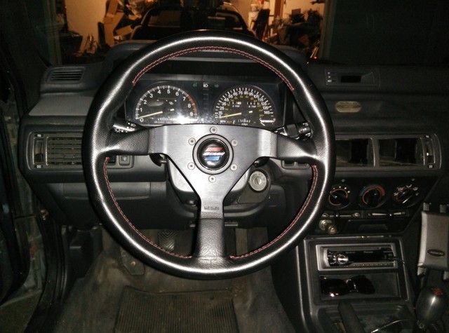

Spoon Sports/MOMO steering wheel  :P  mounted on a short hub with quick release. i bought this shortly after i got my Integra because i was pissed i left my last one in the CRX, oh and it was a screaming deal. so i put it in the integra. im currently parting that car down so i put it in beater Civic, but why? i like my Galant more, love the steering wheel, and why not? im sure some Honda guys are gonna hate, but i dont care, they annoy me anyway.  :-*

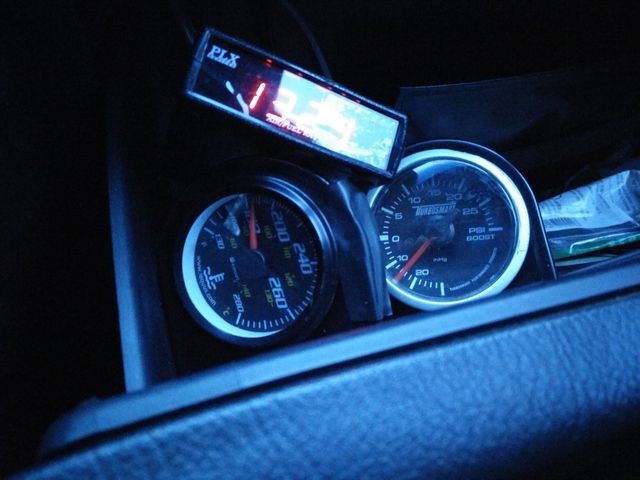

i also fixed my wideband ground. and also put in that new phone mount im sure you can see. wanted my phone in a legit spot to quickly change music...

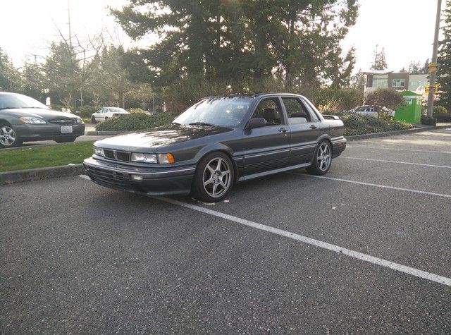

i tried to click off some pics. only a couple seemed to come out ok...
im loving it. i havent driven my Civic since i got the Galant aligned. gotta say that at first i was not impressed by the BC coilovers. they where bouncy and pissing me off. ride was firm and seems to corner tight. so i have been twisting some knobs on the coilovers. BC instructions said they are factory set to be nice or whatever. i started by giving them 2 clicks all around. then i think i did another full round at 2 clicks. then the fronts another for good measure. pretty good now. i have had the same work commute for years, and several suspension kits of different cars. hate to admit it but probably liked the Tien RE's on my ITR best, liked my Cusco's i had on several cars (but seemed firmer than Tien's). i have a particular stretch of road that is pretty much junk. its a bridge with lots of expansion joints. think the ITR was the only one that could do 70+ without fear of spinal damage lol. the Galant is good to 70.
not tring to compare BC's to Tien RE/Cusco Zero-2's, but for the money they seem to be doing good for me so far.

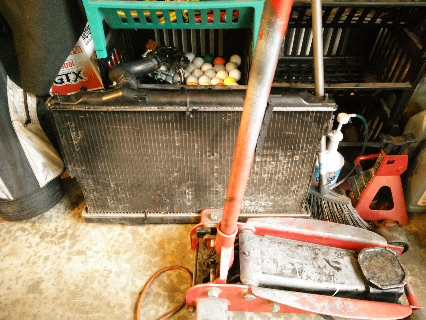

shit. so radiator sprung a leak...again. probably could just fix it again. but it is looking pretty sorry. needs to be replaced before i get left stranded.
spent last couple hours looking for radiators. really just looks like the VW style one is gonna be what im looking for.
http://m.ebay.com/itm/121393555400?_mwBanner=1 <~is that thing going to be enough? or i really need an AFCO? waiting to hear back on a used one, but he already has told me no on a couple occasions lol.
setup should give me all the room in the world for the T67 setup. we did do some measuring and THINK i should be ok as far as the stock (or is it a DSM?) radiator. but i really dont think my fan will clear the compressor inlet, let alone a tube and filter. and i think that the wastegate/dump will interfere on the drivers side.

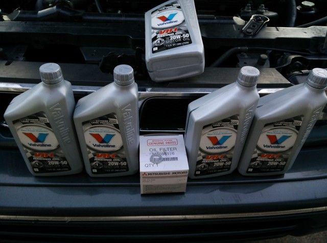

OIL CHANGE...  :o  thats right, i drove my car enough miles to require changing some oil LOL.

I normally just change my filter every 3k. My oil changes itself.
i fixed (or broke) that on the Galant. it seems to only use about whats left over of the 5th qt there (about .8) over the 3k... depending on how much the valve cover gasket leaks.
the civic is on that system though....well except the changing the filter part...  :-*

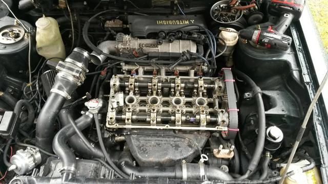

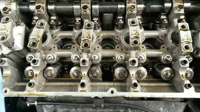

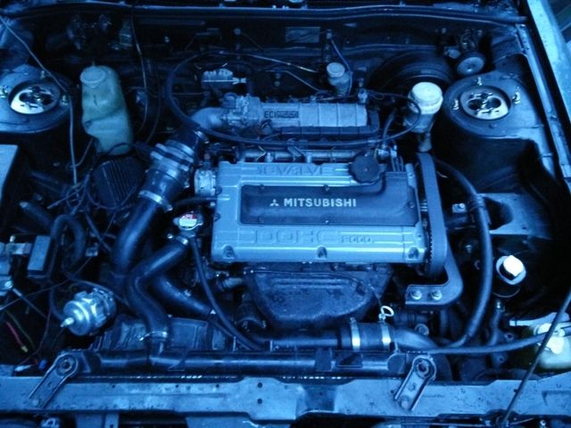

i bought need cams for her. ForcedPerformace "FP4" cams. they are like the FP2's i have now i guess. but they are designed around the stroker 2.3/2.4 motors vs the stock 2.0's... so low revers vs high reving.
oh also swapped out my problematic ass lifters.
got the new valve cover on... not sure i like 100% the color and how it came out. might redo it again later. or may be lazy and leave it.
ok. so not like same as the old cams, but bigger and better for my setup...  ::)
old cams liked to pull little over 20"... these seem happy at 15"
maybe ill take a video to get the sound of the lope.  ;DDD
so far its a million times better. seems way more driveable, no more knock nanny shutting down my fun.... BUT. seems super apparent with 2 people in the car that the 2600 just doesnt have the clamp it use to. its gonna need replaced. it doesnt seem to be smoking out, but it just isnt going. also on the same note, top end is in need of an intake manifold replacement.

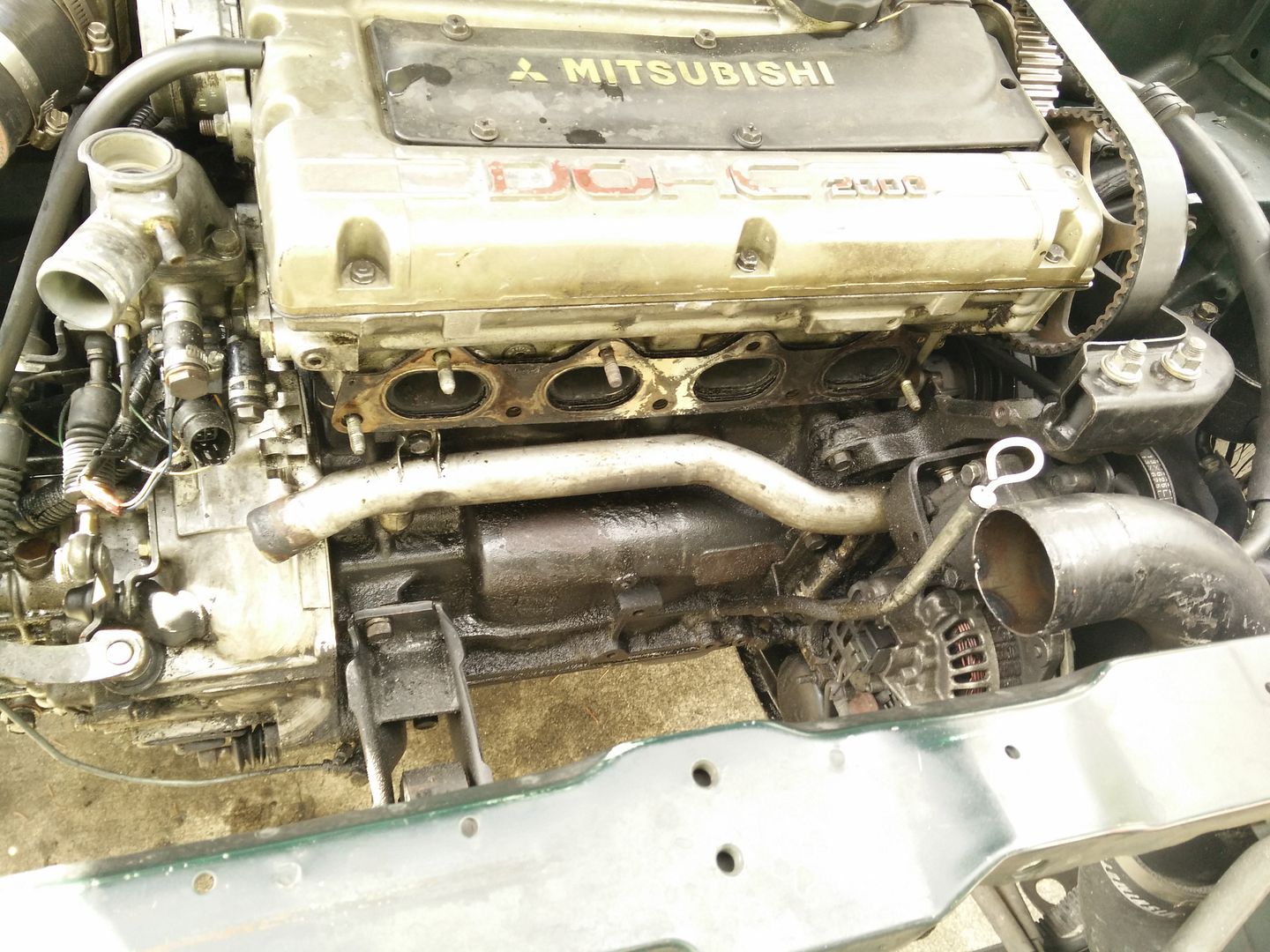

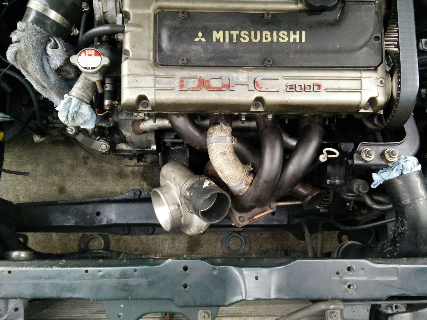

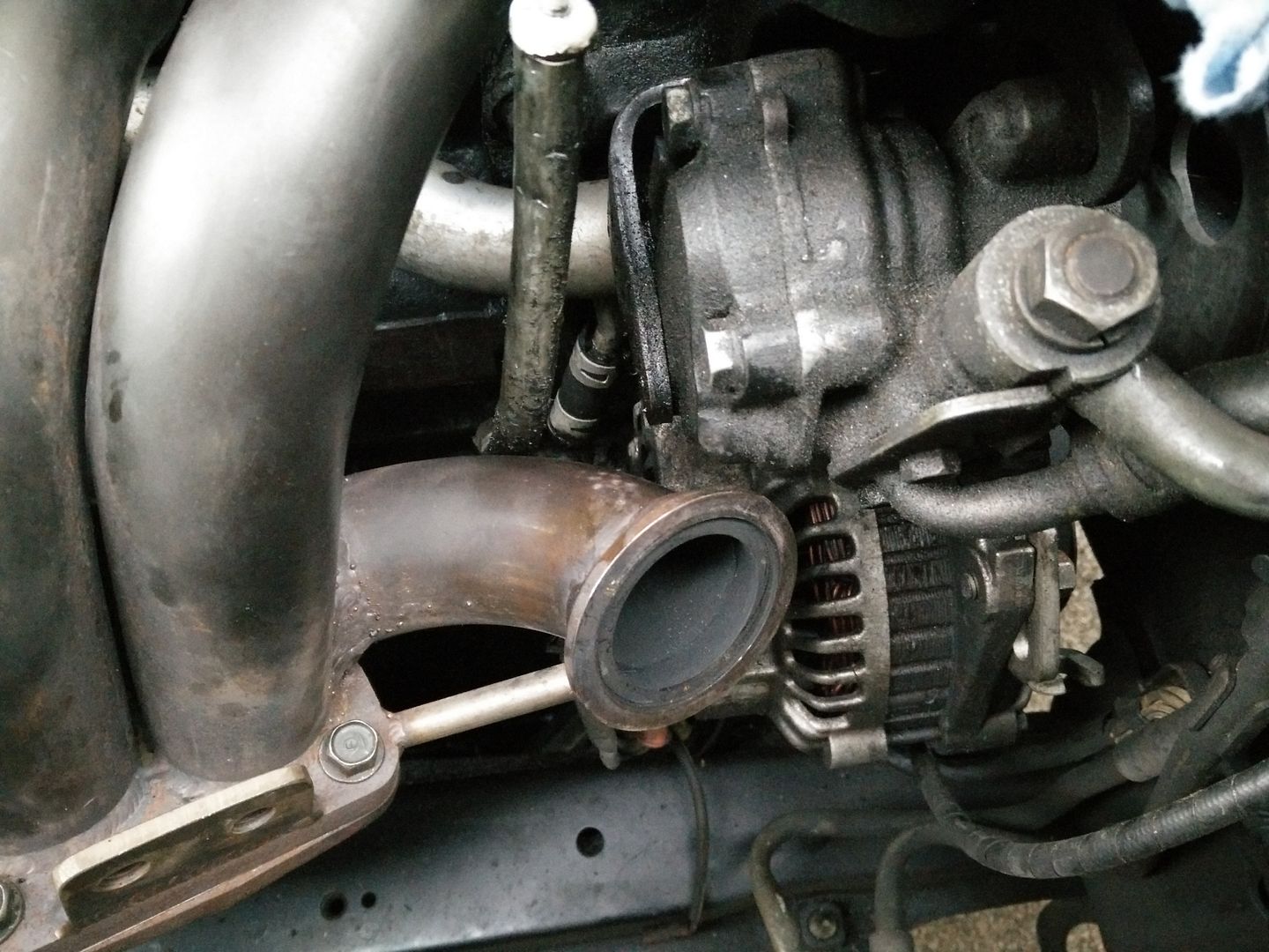

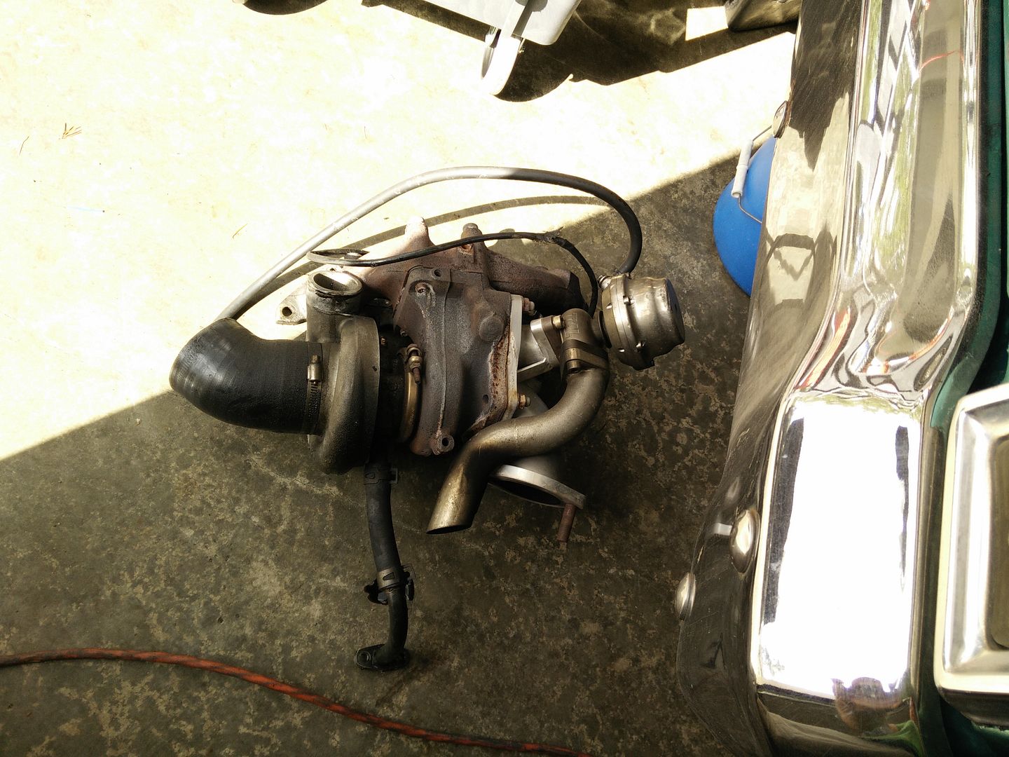

EVO3 manifold
FP Red, old school, ported
TiAL 38mm
some cool housing i forgot the name of
etc.

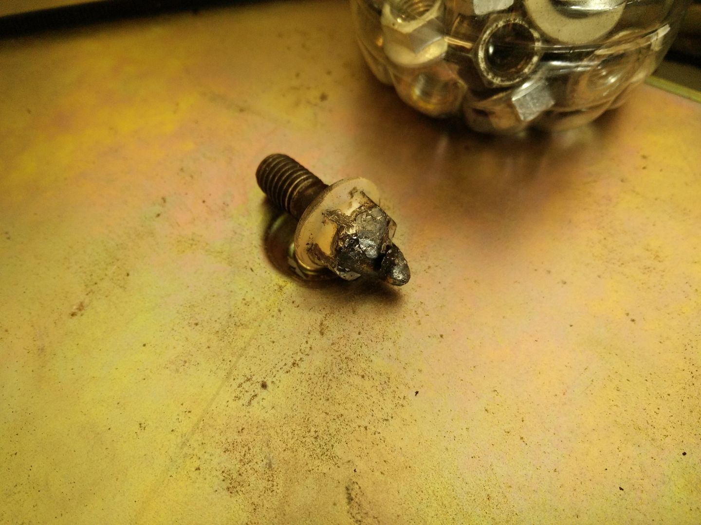

love this trick... 2 broken studs. about 3 pulled studs. fun times.

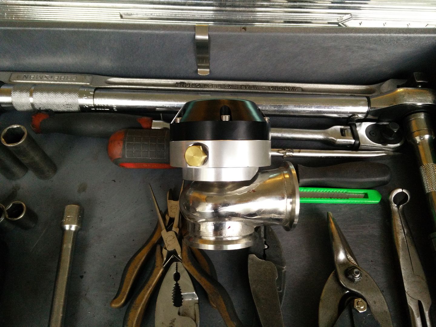

yeah, i did buy a wastegate off ebay. i honestly just am not going to spend 400+ on a Tial MVS whatever. ran lots of Tial's, and i like them, ran cheap china ones and have worked...moving on.

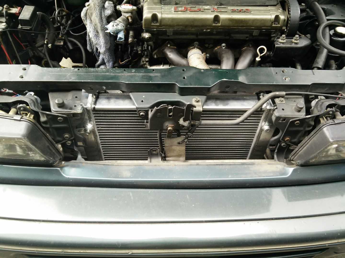

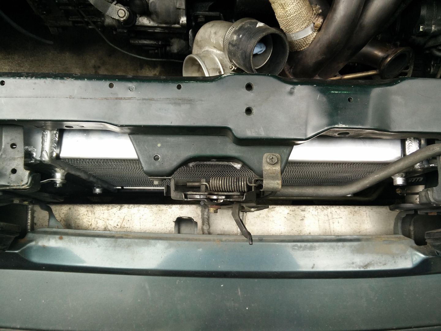

just for you guys... quality piece of  O0 :mexi: :Jew: engineering. LOL. radiator had to be narrowed to clear intercooler for dual back door short route pipes... tried to take a pic of the soldered patches, but pic just looked like shit. had a clamp wear threw a couple times.
new radiator isnt here yet cuz UPS.
i have test fit pictures with old radiator, but its depressing. so..

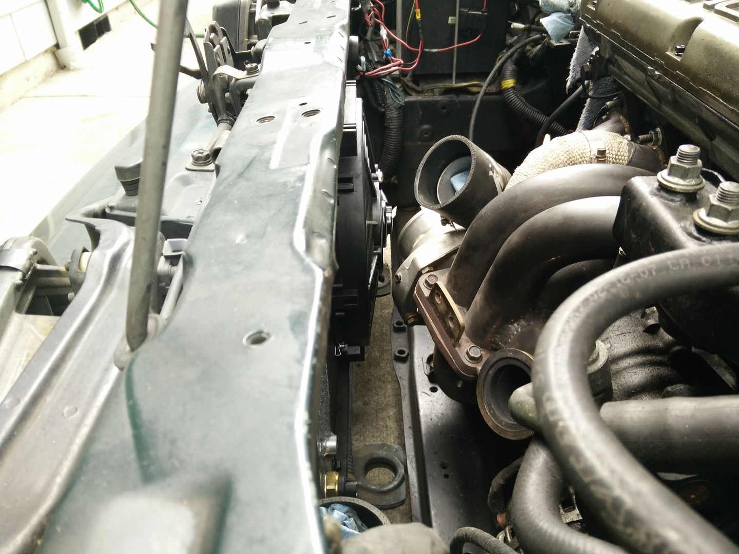

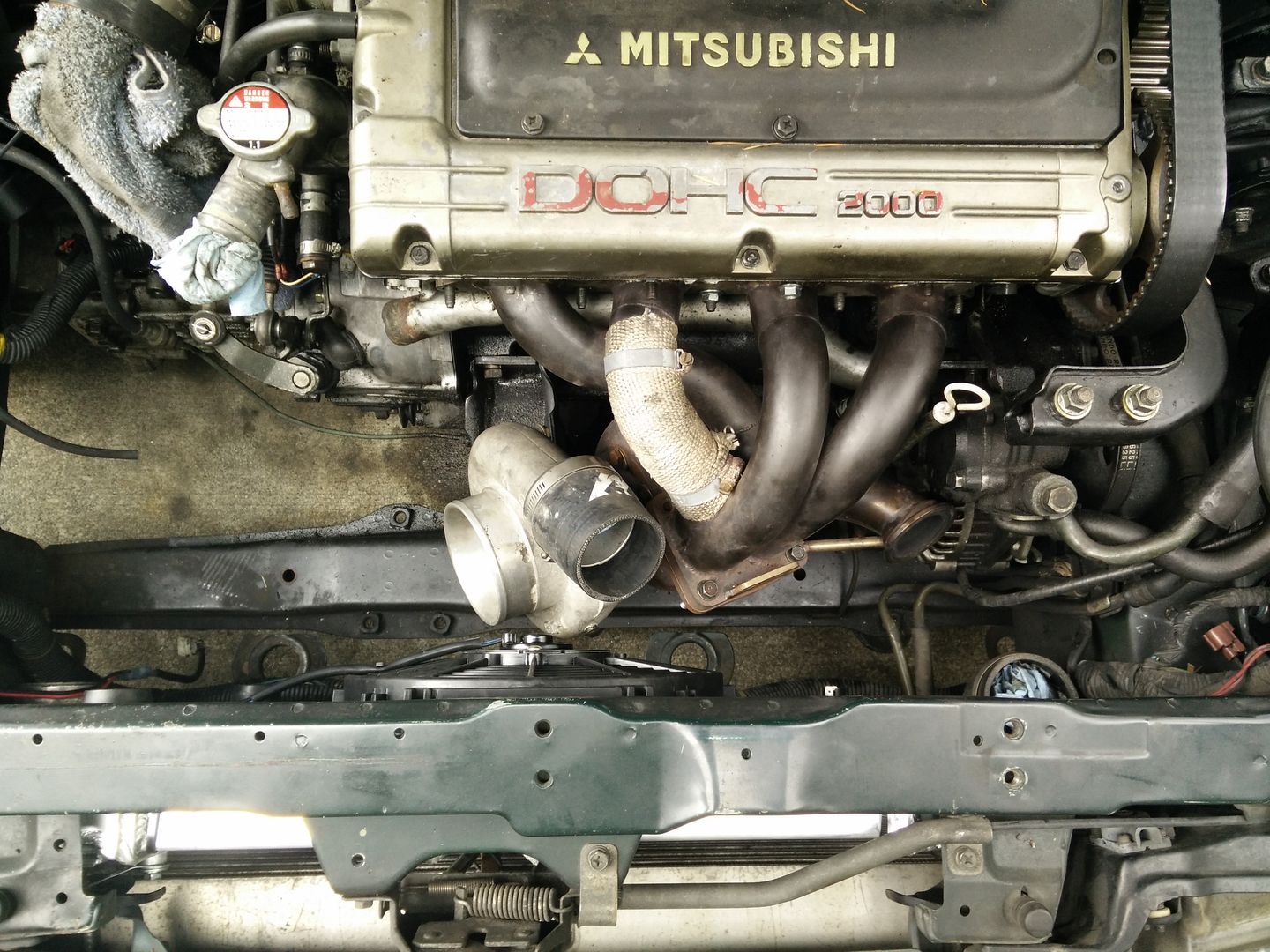

i have about 2" from radiator support to the turbo. think i will have enough room once radiator is tucked and fans are on...i hope... wastegate tube is still touching dipstick tube, needs a little more massaging, and the wastegate VBand clamp was touching the PS pump on test fits. so plan was to just hit the clamp with grinder real quick. but i think i will try a shorter belt on the pump first.
thats about it for now. i took a good long stare at her, getting plans. oh and i re studded the head so the turbo manifold has something to bolt to... waiting on radiator and fans. need to make oil drain which might be a bitch as it points at the motor mount, and see how close the down pipe that came with it fits. im sure a 4G63 swapped Hyundai and a Galant use the same downpipe right? LOL.
hope she runs before it snows...  ::)

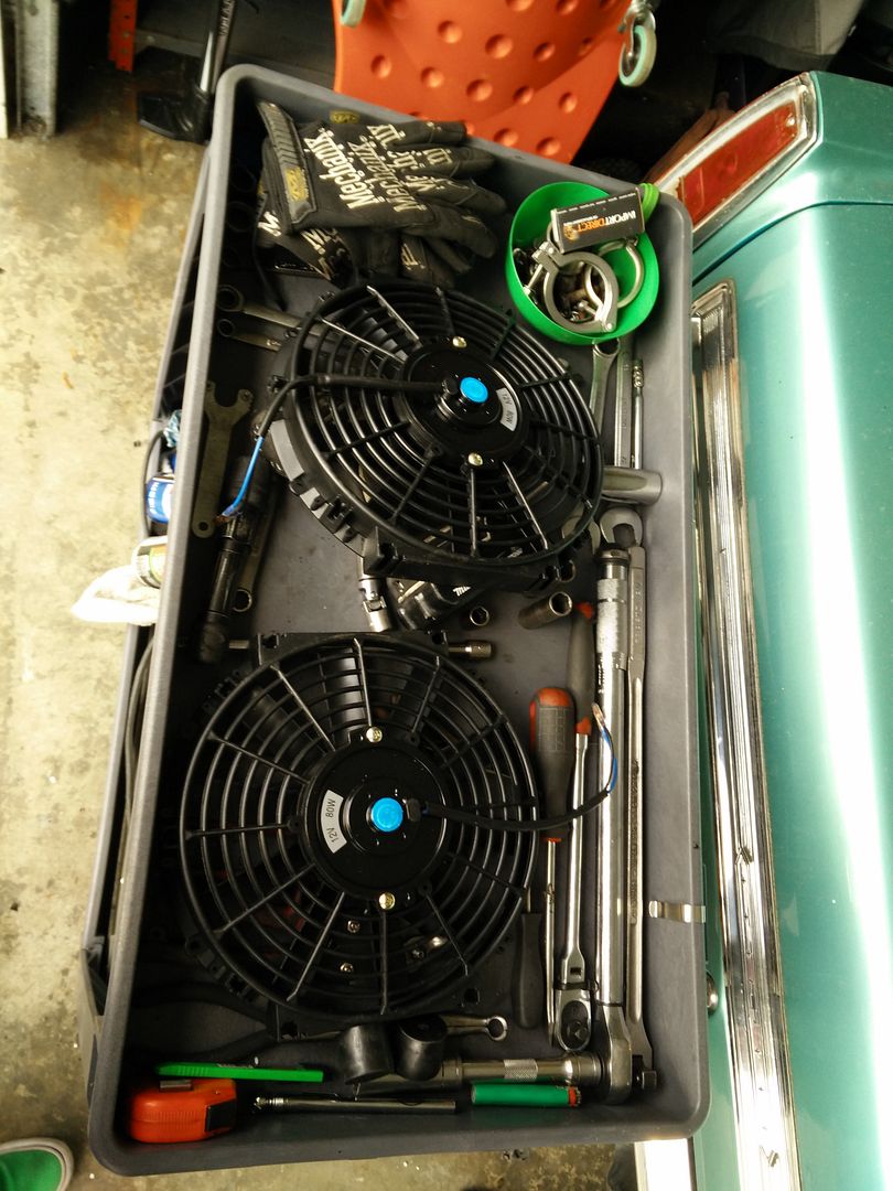

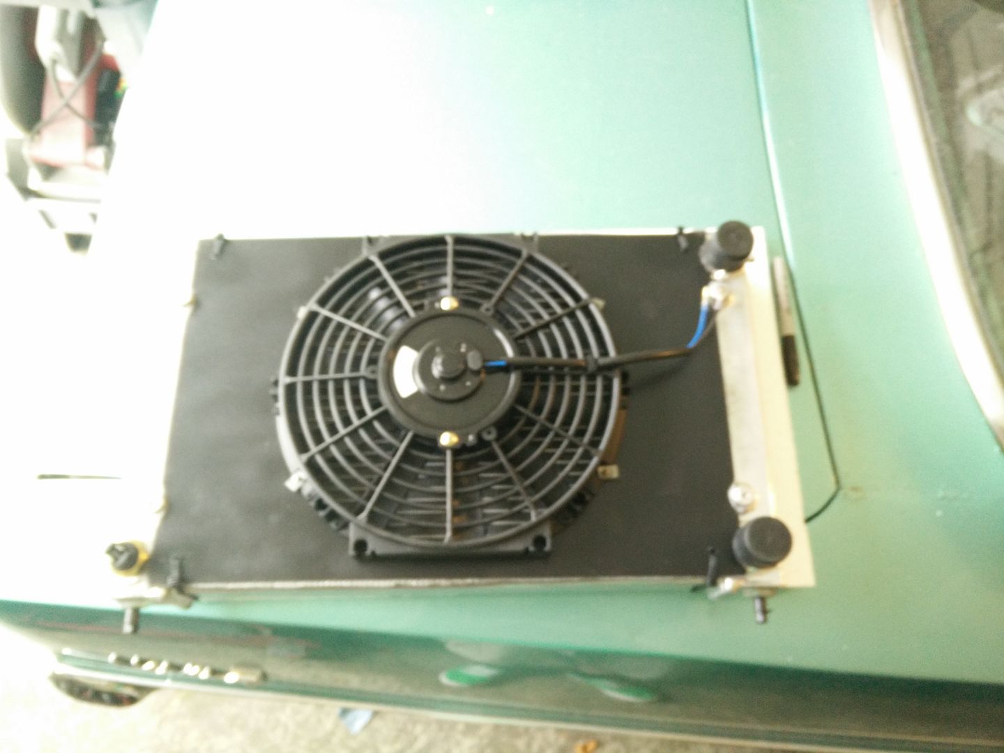

fans i bought. think they are suppose to be 10", they are little over 11". hope they flow the 1730cfm they asy.

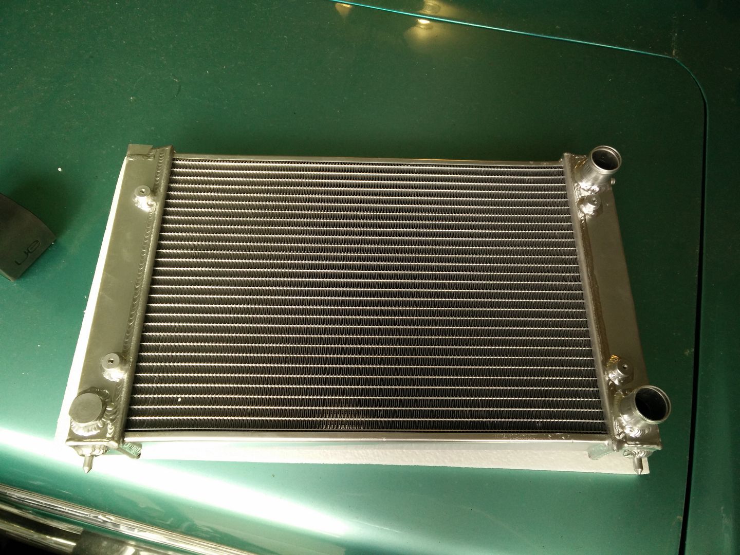

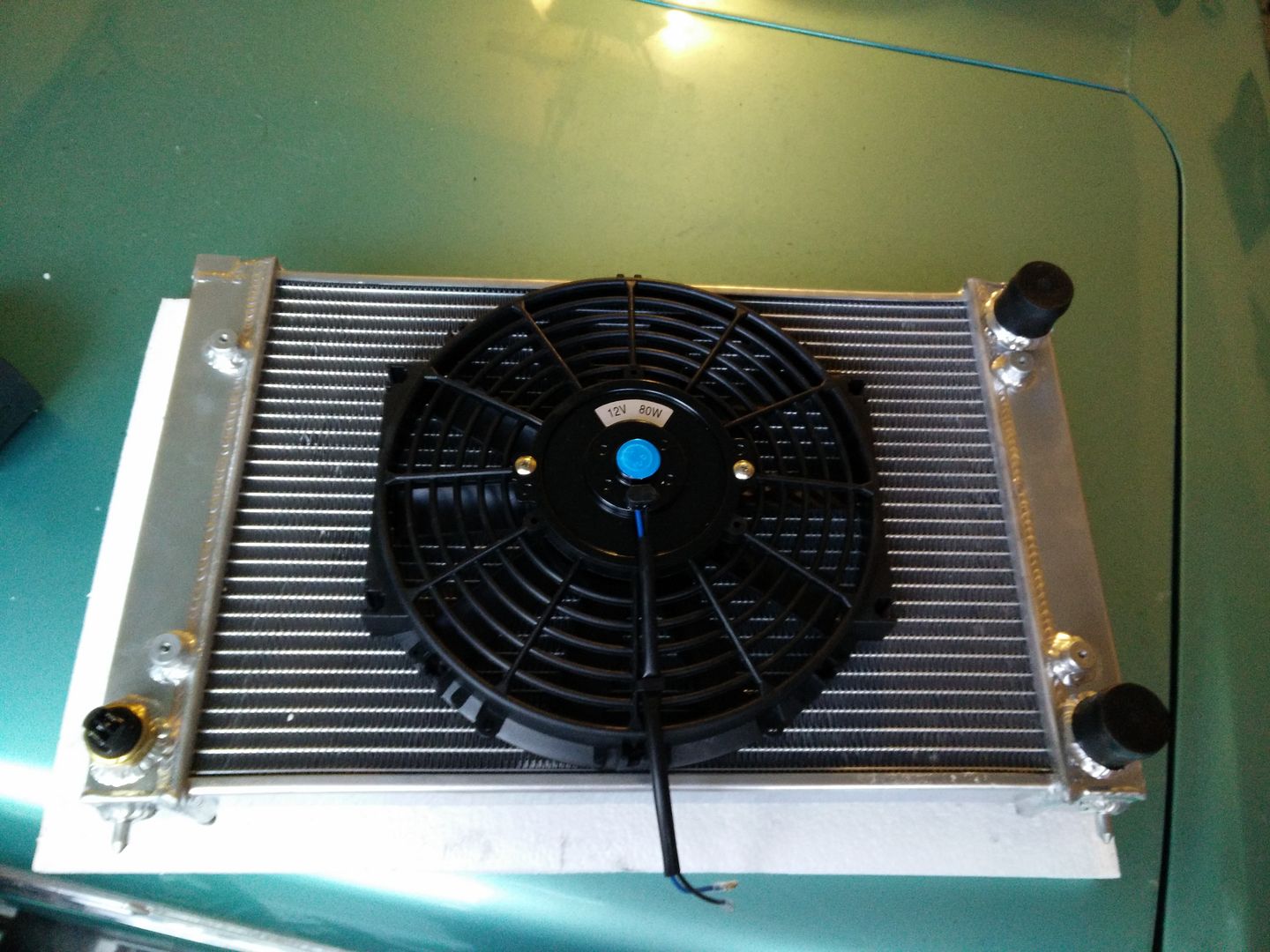

radiator i ordered. its the cheaper (than an AFCO) aluminum one i found on ebay. about $135. MK1 Golf/Scirroco fitment. looks decent. has nipple for steam port if you have an LS1 lol. also has spot for fan switch.
yeah, not a chance in fuck both fans fitting. oh well. this car doesnt have AC anymore so when its 80+ i probably wont be driving it anymore. same goes with cheaping out on the radiator. BUT i will be building a shroud for the single fan.
this is the fan switch i picked. comes on at like 192-195* and has gasket with it. was $8bucks or so. i liked this one over the others i found because it has that plastic crap in the middle to hopefully protect the terminals from getting broken off if i bump it lol.
i did some more poking around and staring. lower hose will work great, oddly i need to trim 2inch off. but the upper is about 3" too short. will need to see what i can find tomorrow at parts store. fan should clear the turbo even on a shroud without issue.
What is the overall width and height?
21 x 12.5 x 2.25
  • Posts: 6862
21 x 12.5 x 2.25
I'm using that exact type and material radiator on twincharge civic reboot, tucks in the radiator support perfect. :)

No finish putting it back together, cleaning up the engine bay welding up holes, repaint the bay first then put everything back in.

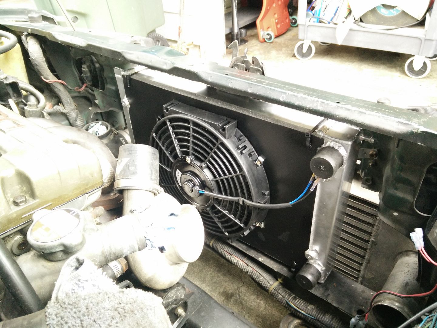

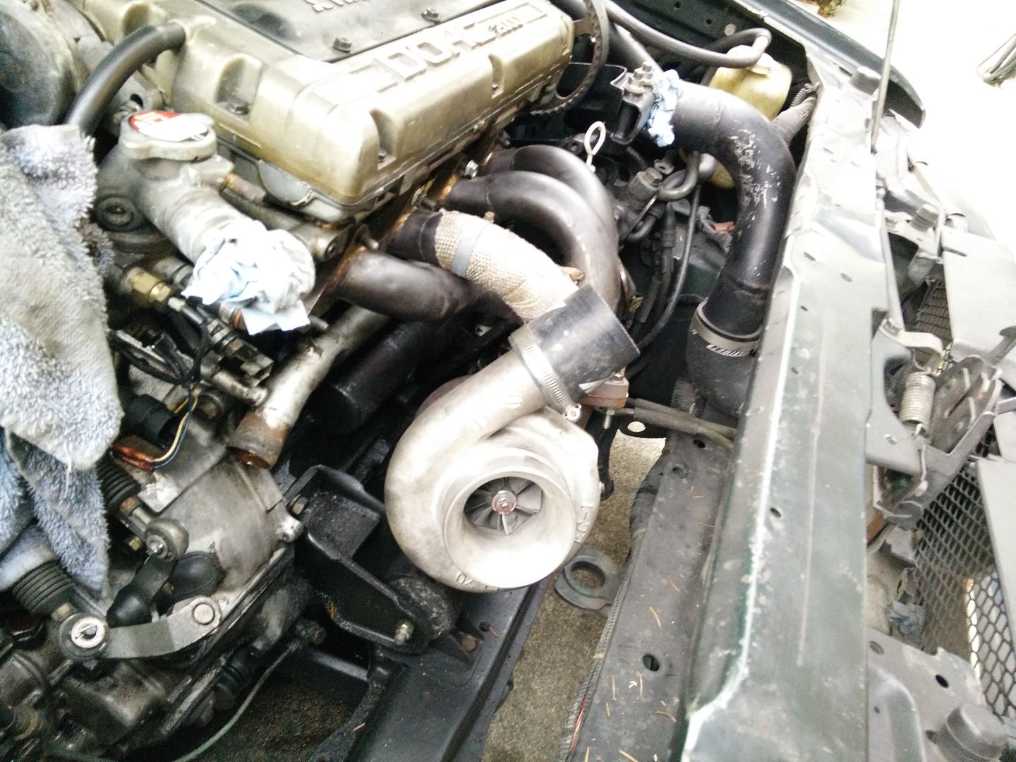

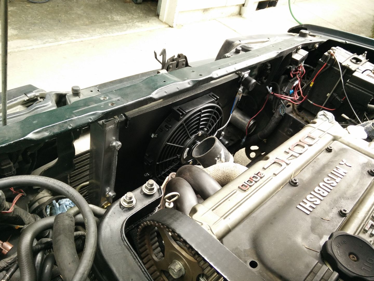

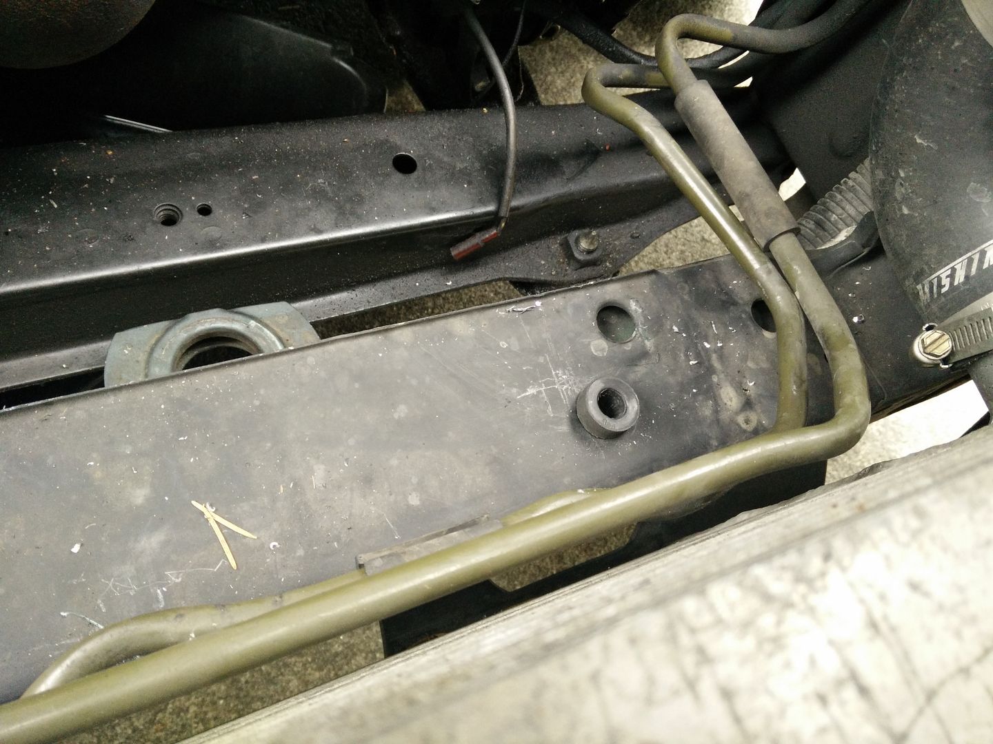

so this is the turbohf china aluminum Scirocco/MK2/whatever radiator install.... http://www.ebay.com/itm/261763767683?_trksid=p2057872.m2749.l2649&ssPageName=STRK%3AMEBIDX%3AIT <~ thats what i bought and im installing here.

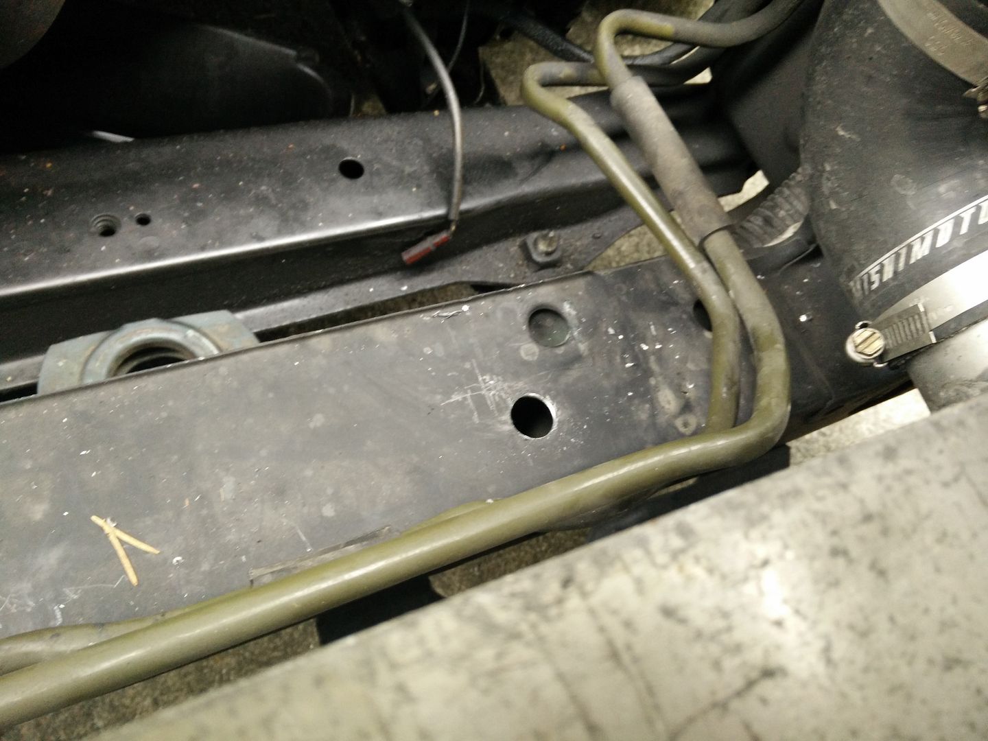

i did a fair amount of test fitting and beating/bending of the PS 'cooler' lines. was trying to push the radiator as far into the core support as possible.
i drilled some holes right into the core support.
i used these grommets that i cut down to poke into the core support. not sure what the hell these actually go to? maybe an air box resonator from integra? AC condenser from Galant? or mounting grommets from cruise control box? all possibilities or good places for you to look for yours lol.
like it was factory  O0
it was a fair amount of work to get this far. lots of trimming and cutting a big ass hole in sheet metal. its all mounted on low density foam to seal it all up. really happy how this truned out, and how simple it turned out. my plans in my head where all over the place from super ghetto to overly complex welding/bending.etc.
sexy

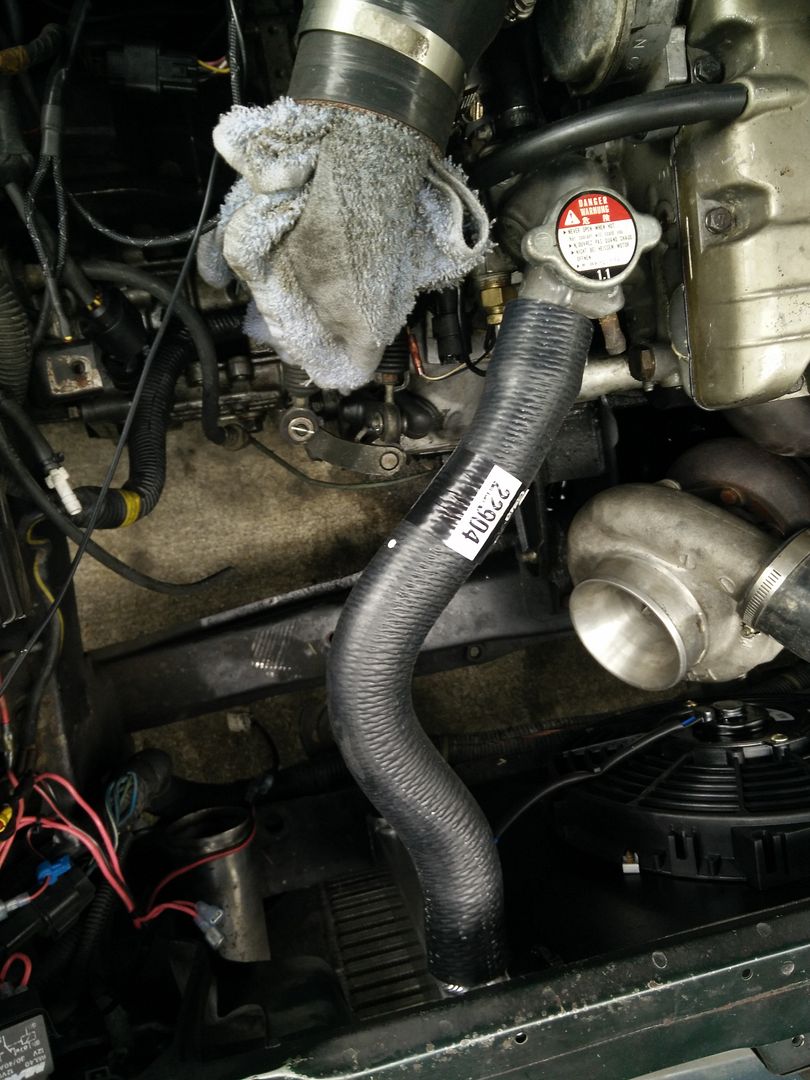

that is an unmodified upper radiator hose from '92 Eclipse turbo' that i got from O'reilly's. lower one is...well i dont know. i replaced it with something, but i remember it was a bitch finding one i liked. probably Eclipse one also. anyway i cut about 2" out of it oddly enough (original upper was 3" too short)
oh, i also made a little tab on the front side that goes from the back of the headlight (bolt/stud sticking out) to the front of radiator.
now thats it all done and in the car...i want to pull it back out and paint the radiator black lol. probably should have done that first. oh well not that big of a deal.
