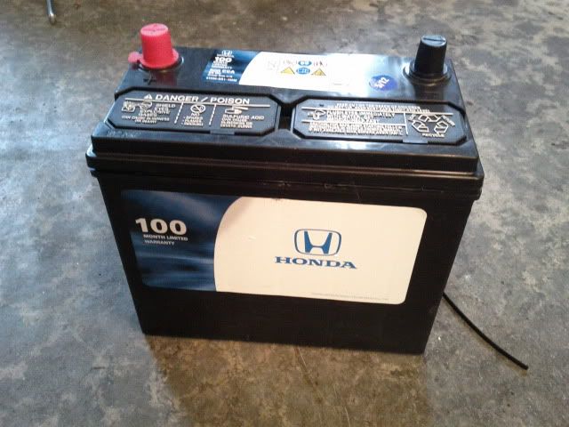

cuz everyone loves OEM parts (or should)
so i installed the battery and it cranked over and started on its own champ? FUCK NO... runs for like half a second at a time. so after messing with it a bunch, swapping parts around, checking shit. i throw a stock MAP sensor in it (i have a 2.5bar Motorola in stock case) swapping bins real quick, and pretty much starts right up with no issue. shit. anyway. ill rock it for a bit at lower boost i guess. but i need to get a 2.5bar back in it before getting it tuned/dynoed.
drove it up the street real quick. its leaking a little oil still. diff/trans bearings are making a little noise. sounds like it might need some more tweeking. but i think it will be solid.
CEL for VSS... noticed it wasnt working... probably not plugged in actually.
Tunerview still doesnt work. just blinks. and the only value that changes is MAP (and its wrong). the rest are all just pegged out, causing the warnings to go off, aka blink.  :'(

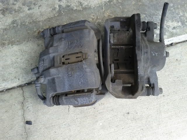

set of ITR (ok, Accord Wagon this time) front brake calipers. fluid looked ok, piston compressed nicely, and pins move freely...and mad jew cheap of course... just need some SS front brake lines, and some Mini Cooper rotors... (my CRX already has EX knuckles)

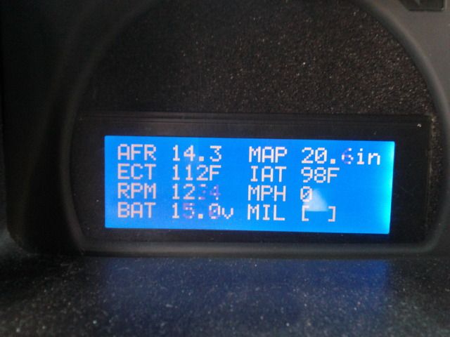

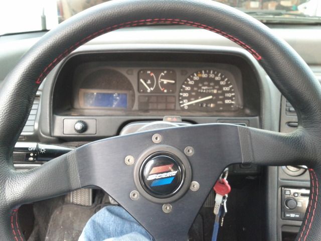

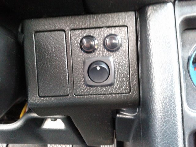

« Reply #140 on: August 01, 2012, 11:20:36 PM »
well fuck me. i have been having a little issue the last couple days, CRX wasnt going full lean (turning off the injectors) on decell. sometimes was just holding like 13.5's AFR's. not good. also, getting some random AFR fluctuation, but thought that may be caused by something else. first thought was TPS. but in reality Honda TPS's never really go bad. and i cant test it cuz i gave mine to a buddy that NEEDED one bad. but i did test the voltage and calibrated it (didnt remember if i did to begin with). so i set it up, double check, ehh little off, then semi tighten it, wonder around, come back, and its way the fuck off again?!?! this is without even the car running. nope. dont like.
so mentioned all this to guy at work, he digs around and pulls out a 92-93 DX lookin throttle body with a minty lookin TPS, tells me to lmk what i find.
so i hack off TPS, install, etc... shit works minty. calibrates just fine. doesnt move, and  i did wait lol. went for a drive and shit. i didnt think it drove/idled/whatever poorly, but it does it better now  ;DDD

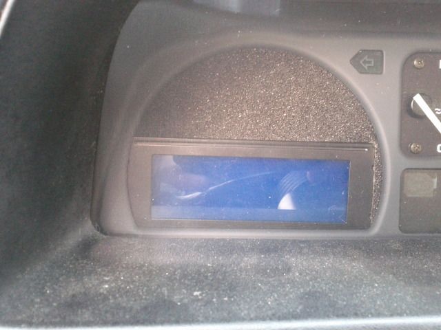

so while i was at it i figured i would give the Tunerview II another shot. im 99% sure i found the problem (hardware, not caused by me) and i got her mounted up! hopefully it doesnt act up, and it shouldnt, even threw in a little safety. shit turns off the ECU/fuel pump when its causing a ruckus.
anyway, im sure you came for pics, i know i do...
thats my view...threw the SPOON wheel, too bad i lost my ballin HF tach with its 5k redline going up little passed the missing 8k marker lol. up to 893k tho! lol
off, then on... last is the right and left scroll buttons (switch is for fan ON override). its set up to display 7 screens...

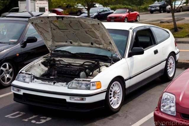

so a meet was bought to my attention, and realized i havent been to any lol. always complain that the hood/bumpers are up to par. so i felt some actual want to work on the car. so i brang it to work, and PRESSURE WASHED off all the paint off the front bumper. yeah. didnt really stick too well to the bare plastic of the bumper. i also bought some adhesion promoter. was recommended by a couple people. so im gonna give it another try, and paint the rear bumper.

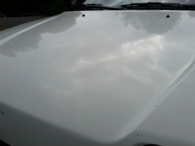

i wet sanded down the hood with some 2k grit, took all the grainy texture of it. started polishing it, looks liek its going to turn out ok. also think i fixed the hood alignment. looked like didnt really wanna shut all the way.
been staring at the tunerview non stop. noticing that the coolant temps are way higher than i want them to be. been fucking with it for weeks now. i cant really get the temps down when its cruising speed. thinking of getting a full legnth aluminum radiator... we will see.
NEW PROJECT COMING SOON...  :Jew:
i know i keep saying that. but im lazy and shit. he isnt really in a hurry. he says he will try to drop it off this weekend. whenever it gets here ill make a thread. its gonna be a minute before its a driver. needs paint/swap/turbo...
CRX will continue. although not really looking to do too much to it. might do some suspension shit, and needs tuned. plan to drive it and have fun. probably DD status cuz it gets good mileage.
GVR4 will continue also. it needs the intercooler installed. will be working on that here very soon. need to get it ready for winter snow drifting. maybe a real engine management system...

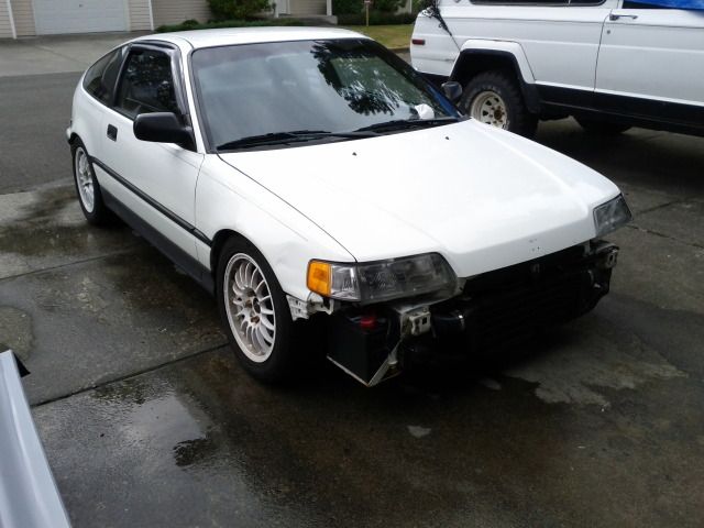

didnt have my phone on me when i was pressure washing the bumper, just looks like a black bumper now with just a couple little paint spots. stuck good on the drivers bumper light pocket. the other bumper is just a red 90 rear bumper. ill take some pics when i start painting on them.

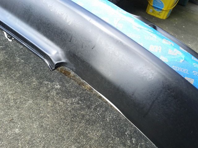

ok some car porn for ya. im sure not many are here to look at my ramblings anyway lol.

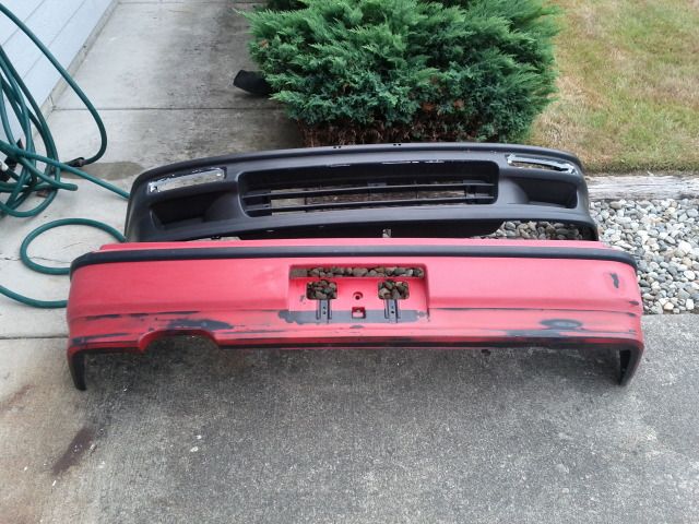

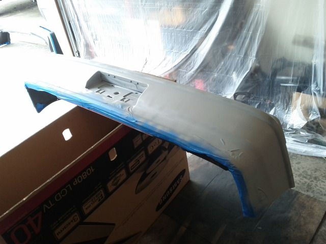

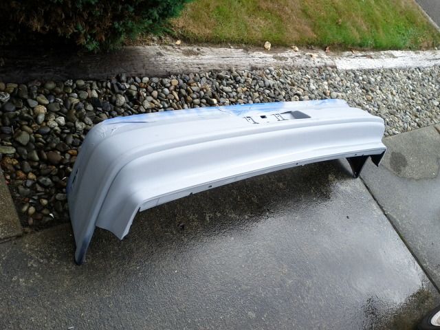

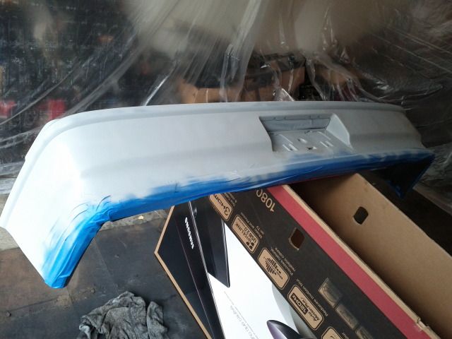

these are the victims. 90 HF rear bumper (to complete my 90-91 swap) that i have had forever, just havent wanted to put the work into it to get it useable, and paint it after the front didnt hold for shit. speaking of, thats the other bumper, new 90-91 unit. i litterly pressure washed off the paint with the washer in our detail bay.
rear all sanded then primed up. then the last pic is after wet sanding down and washing.
CRX sitting and watching patently to get its newly painted parts.

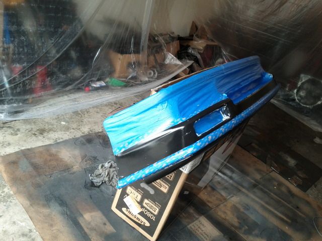

buffed out the hood while waiting for coats and shit. hood was not the best condition, and still isnt. but i did get it to polish out ok. phone probably doesnt picture it well tho...
laid down this adhesion promoter, looked like complete shit. so i sanded it back down.
still doesnt look all that great. but at least there isnt lint and shit in it. gonna prime it up hopefully tonight, and wet sand it. hopefully it comes out smooth and flat. and holds paint. etc.
tape sucks ass, i think its gonna have some overspray/runoff bad... but ill bumper coat it, or scratch it all off with a razor. we will see..
oh yeah, the rear bumper will be half painted half texture black before its mounted. i hate that full paint shit. OEM!

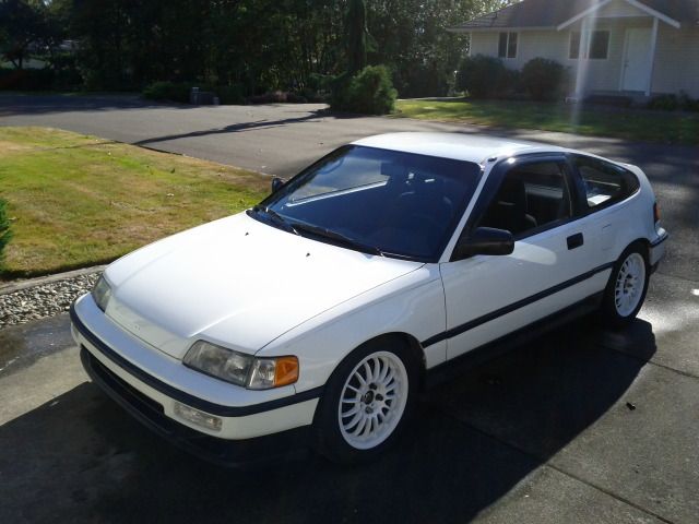

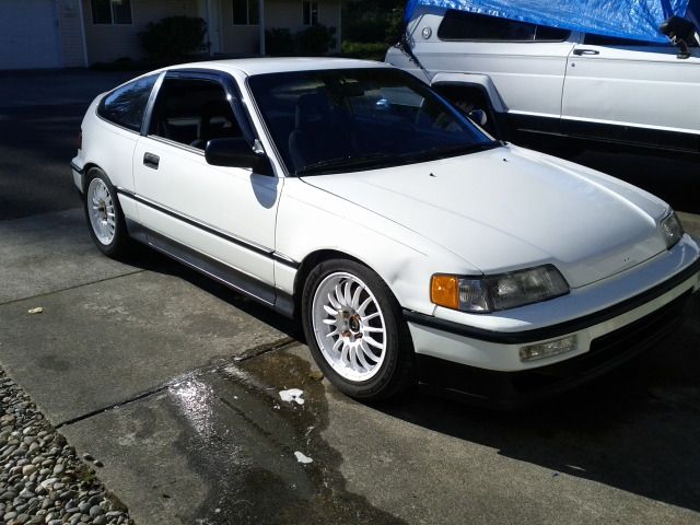

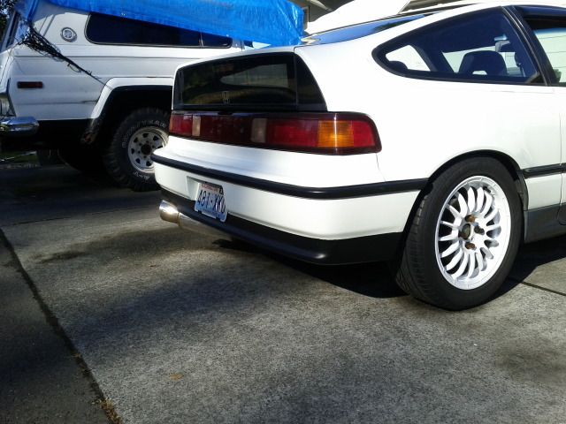

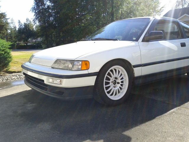

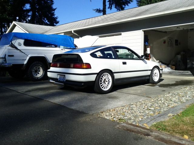

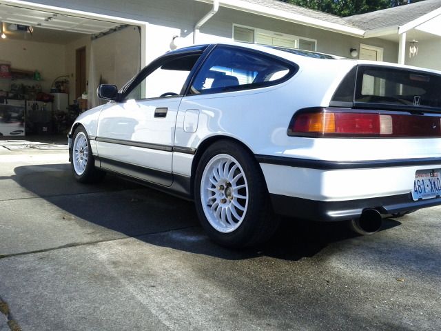

not gonna post pics of the bumpers painted cuz there are lots of runs and shit in it. lol.
anyway, getting ready for the annual Acura of Lynnwood All Import Meet. plus just getting the cosmetics where i want them.
pics.
this is for Marcus.
fuck you  :P  this took forever.

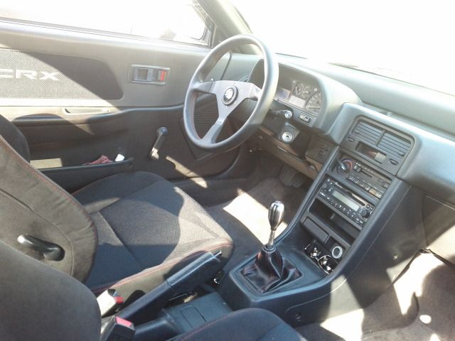

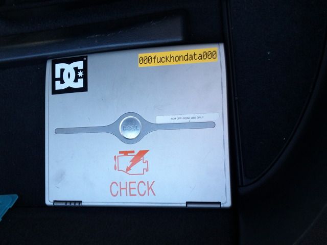

just little interior shot.
the "tuning" laptop... really thats all it can be used for. my phone (and tablet im sure) is fuckin faster im pretty sure.
