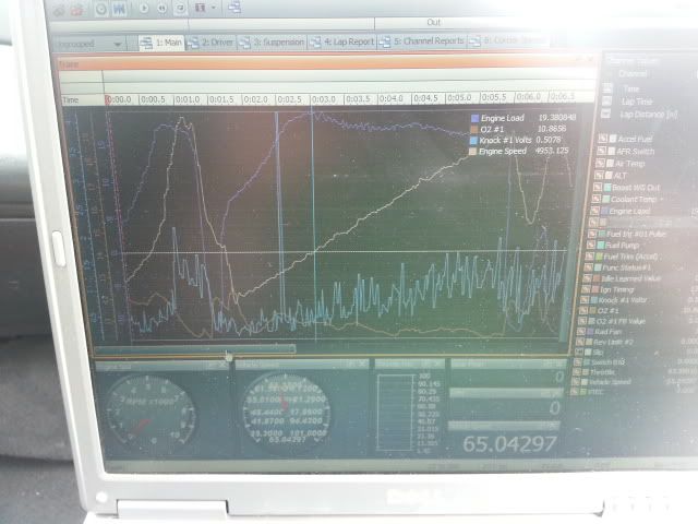

its a Honda B-series KS. cuz thats what i found. wire is shielded (honda 02 sensor wire).
thoughts?
Why are you paying attention to a Honda KS at WOT?

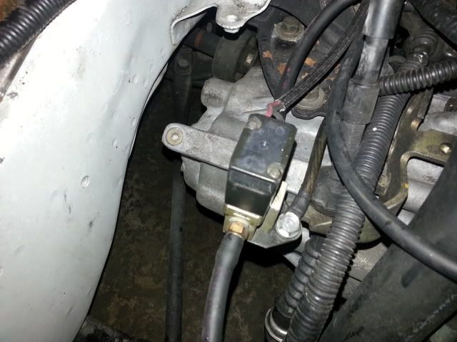

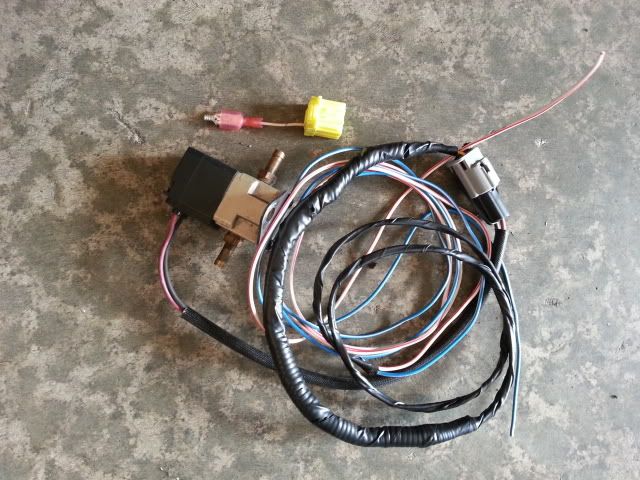

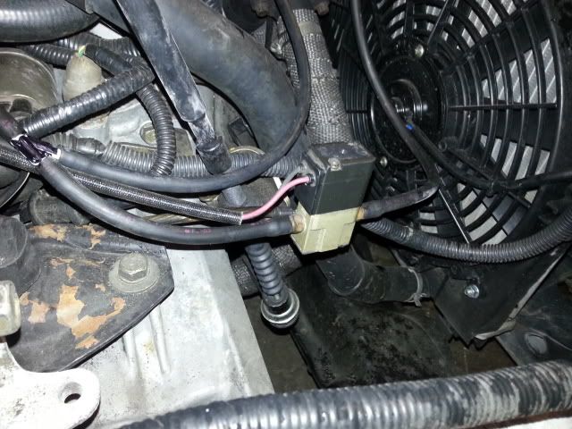

gathered up parts for PWM boost control via the AEM EMS.

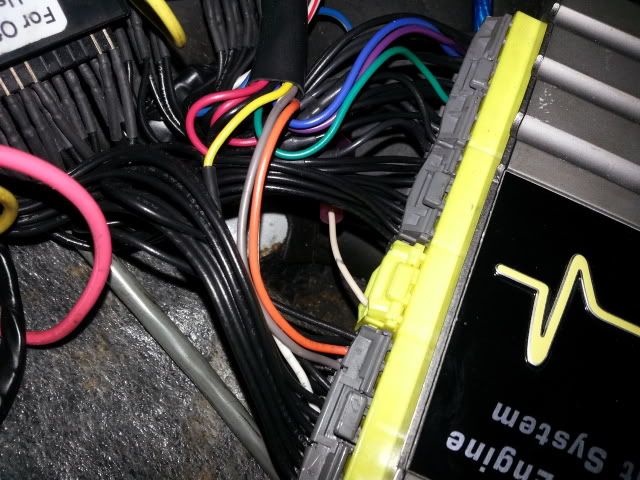

you ever notice on a OBD1 Honda ECU pinout it is labeled A-B-D?
cuz there is a C plug, Honda just doesnt use it... but guess where AEM pin is for boost control? C10. cock.
was a bitch to find, then a bitch to get. got 2 just in case i need another ever.
buddy had this MAC/GReddy boost valve in his extra shit, so i swiped it.

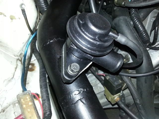

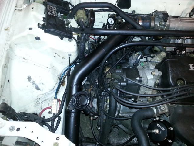

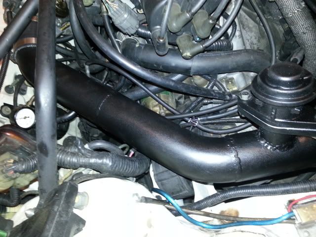

i was seriously hating on the upper chargepipe on the CRX. i painted it with this wrinkle black paint hoping it would turn out like a Honda valvecover....it didnt.  :evil:
i also didnt like the chinaRS bov. so i donated it to the EK, and put the GVR4 bov on the CRX (and a TiAL 50mm on the GVR4).
this black textured paint looks a lot better.  :noel:

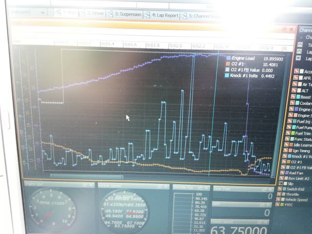

been trying to clean up the tune for dyno day. needed to refine the "boost comp" map. kinda a simple idea. you tune the car for low load perfectly. then just use table to increase fuel by a % as boost goes up. so it just uses the cells you tuned at say 10psi + 35% fuel for 18psi (example). anyway, seems to work great. still a running a little rich up top (10.8afr).
couple of tuning screen shots for ya lol.
seems to hit about 20psi, then settle down to 17psi, then falls to 16 at around 7000rpms. clean pull, only smoke was the revlimiter/tires breaking loose in second lol. couldnt tell as it started to move quick when i shifted 3rd. was black/whiteish. plugs looked ok also. but i coudnt swap them as i put the extra set in the EK, and parts store suck ass around where and dont stock shit i need.
D-series + 20psi = slower than the GVR4 @ 20psi.... i mean TURN OUT OUT  :-*

Honda used the C plug.
Stop logging the stock KS.  It does not work the way you think it does. No 90sa Honda KS was ever monitored at WOT, read your service literature, and the cars with KS that work the eay you think KS do routinely have it shut off due to phantom knock. KS are not your friend, and are not a tuning tool for anything other than poorly designed & fragile Subaru products. GVR4 is a 3800lb Pig Slut, if it is faster than a turbo CRX you are doing it wrong - survey says timing and lack of dyno time to set timing correctly.

I can't hear actual detonation/ping/knock/whatever. so the KS is what is available to me?

If you will not go to a dyno, tune by pressure drop.  If you think over-advancing timing requirement 3-5 degrees so that you can listen for detonation has anything to do with tuning, then build a set of det cans.  They do what KS are reputed to be able to do, but can't unless 10-15 newer technology in a super quiet completely stock new car environment.
97.5% of the time KS are turned off as the suck ass.

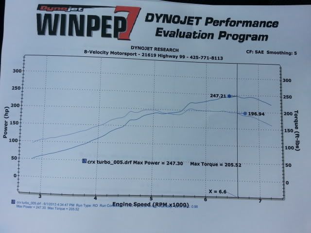

so RHMT Dyno Day 2013....
got LEED to look over my map. he poked around, seen some things to touch up on and tweak. couple little tricks he seen tuning his bros car. like my idle was pretty damn solid. he had it with little fluctuation at all on the way home i noticed. wasnt something i didnt know how to tune, it was just turning off cuz of the TPS.  :evil:
he liked the microbit, and seemed to like my hybrid boost comp (called me lazy tho lol). oh ill take a screen shot when i remember so you can see what i mean by boost comp map.
so for the record, my timing was little too advanced. just a slight pinging in 4650 area. think he took a deg or so out. did some smooth/ironing out of my map. still needs a little more fuel tuning, but 100% safe, just not flat AFRs lol.
so all my pulls really made all about the same power ~245whp. think we picked up TQ tho.
overall im pretty happy with the results. in reality "it is what it is" (see quote in sig). about what i was expecting.
was hitting ~19psi at peak TQ, then settled to 17psi i think, the rest of the way out.
