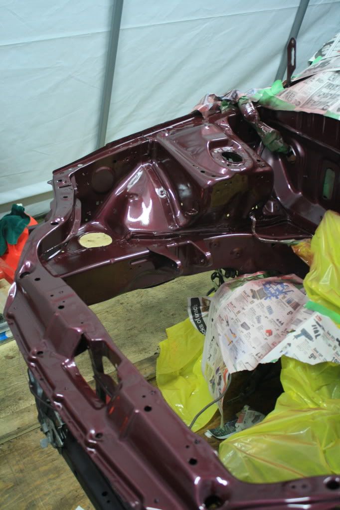

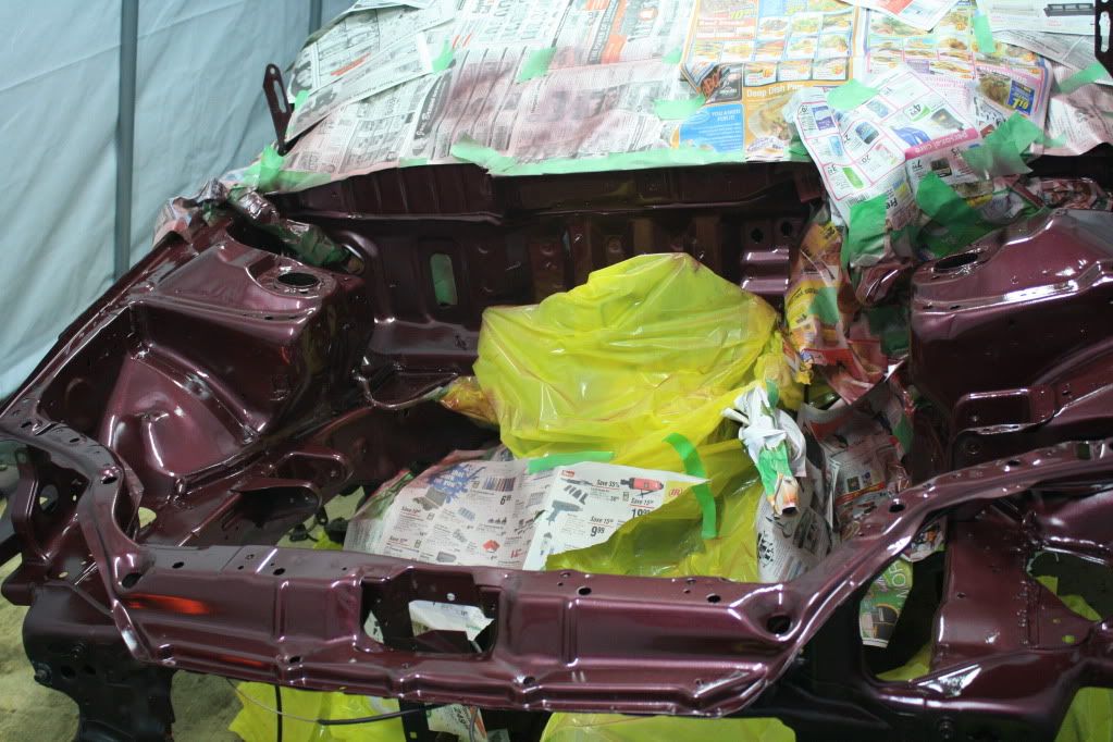

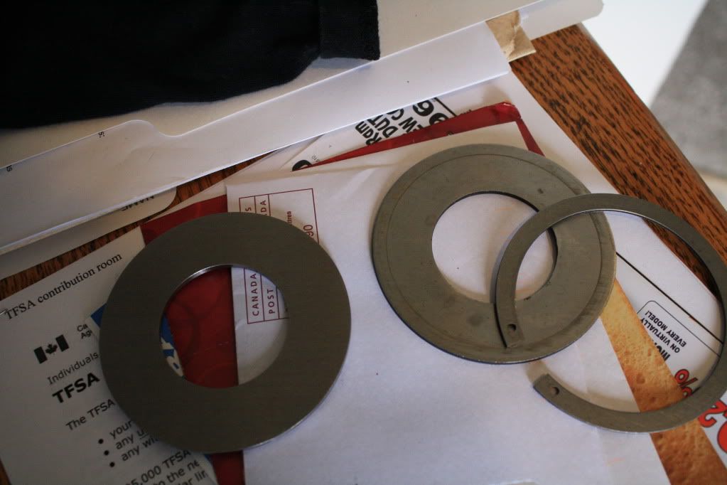

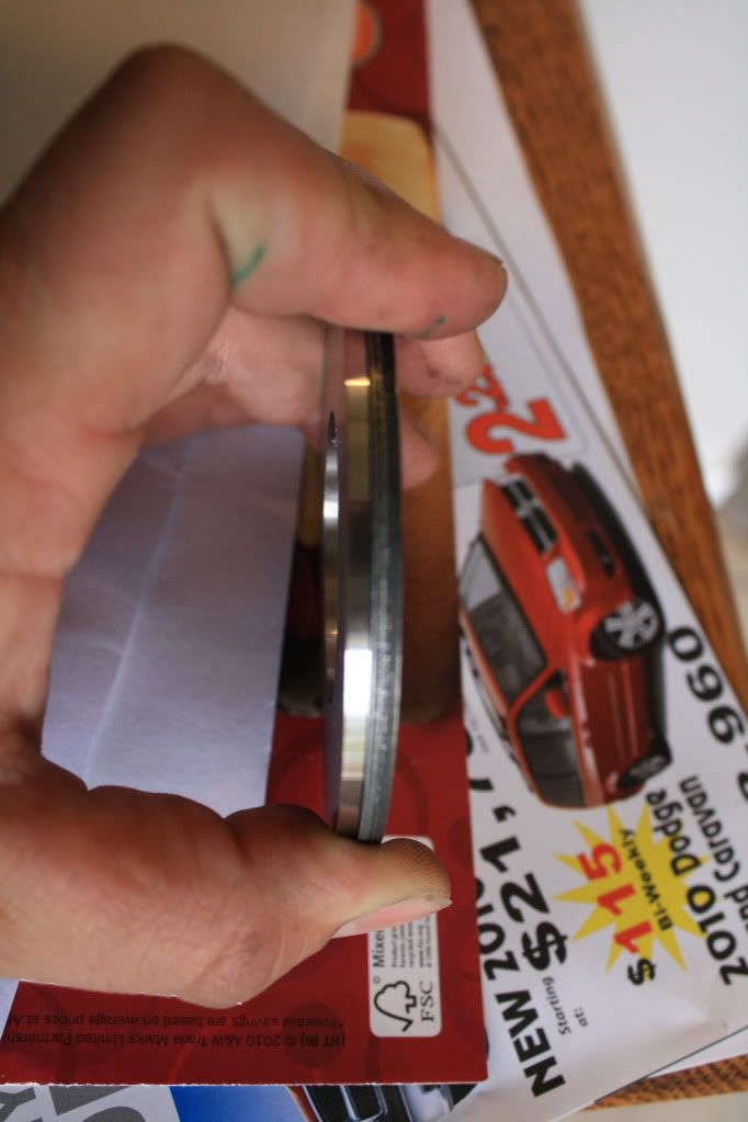

put on 2 light coats. I just did this to try and cover up some of the gouges. It will be getting full paint this winter hopefully with that new front end.
Just waiting on my shim to be finished then everything is going back in. Most likely Thursday night.

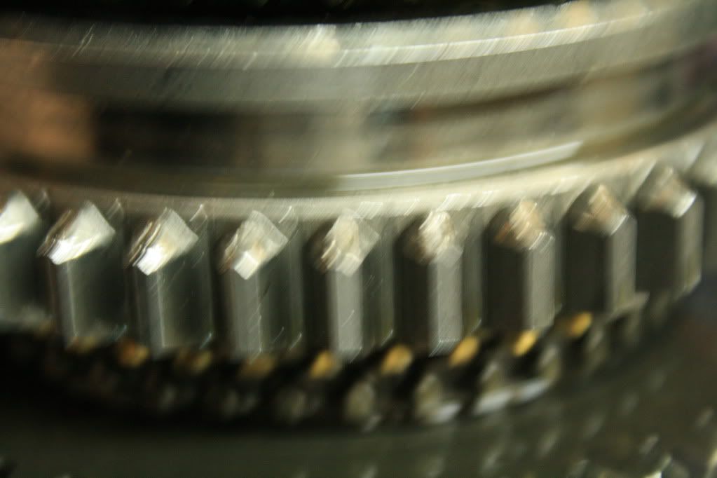

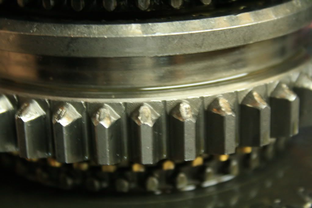

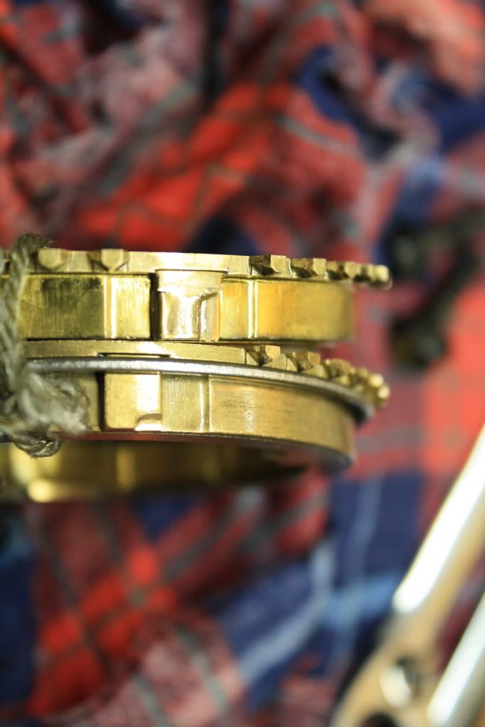

Finished painting the engine bay, pulled the spare b16 tranny apart. Found some shit, I am seriously wondering how the fuck it stayed together. Every tooth is either showing major stress cracks, is cracked, is almost broken off or missing. Who knows how long this thing was like that.
That and one of my sycro's was beat to fuck in a weird spot on the outside ring?

Levi: The syncro rings are EXACTLY what i thought... and are doing that excactly whyt we talked about. The 1st gear issue is a sure sign you need to start thinking about looking at them. HARD launch in 1st gear is Y.
side getting eaten is getting hammered against the selector hub... after a while, it can actually work its way UNDER the lobes of the hub and CRACK IT (The hub)... Ask me how I know. LOL   :noel:
The reverse gear... Looks like its hitting something, not sure of a B trannys orientztion and what it could be.
As fort he shim...  I wasnt aware you were talking about it being for the endcase/input shaft.  As long as the oil trough fits still and flow isnt impeded that will work... Thats why those shims have the section cut out, so that the oil can get to the end.
