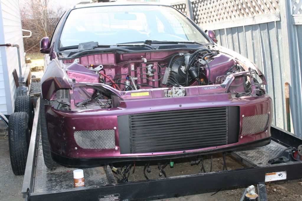

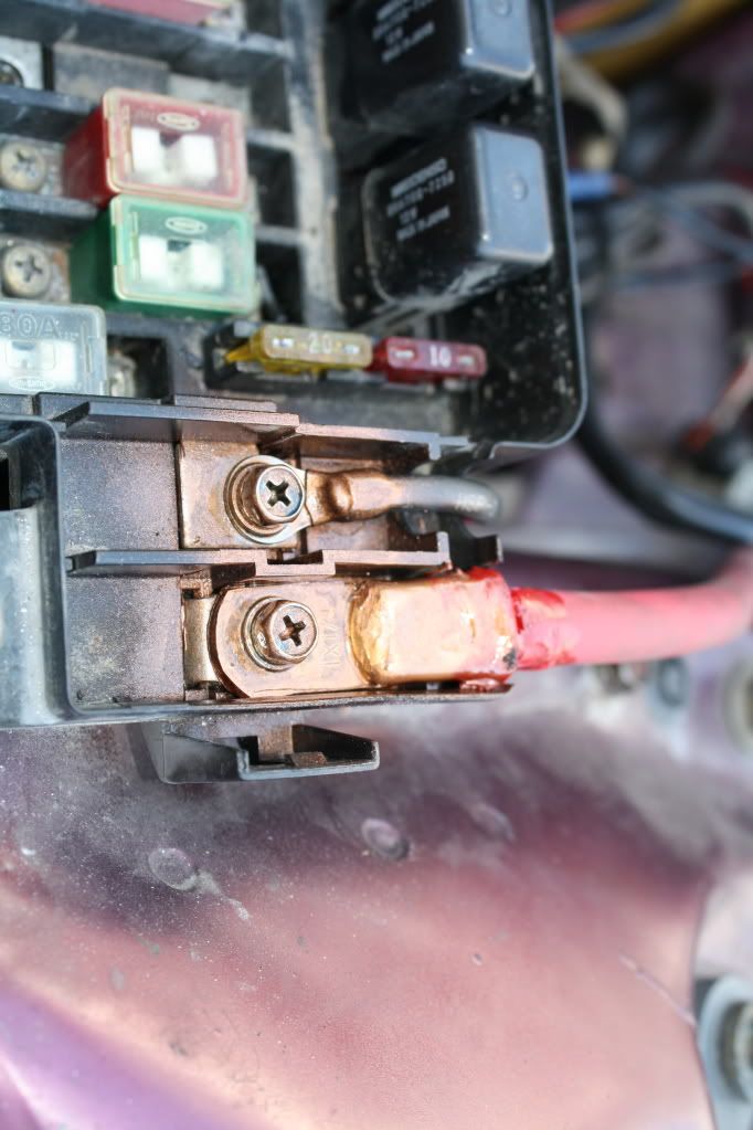

...Fixed some sketchy wiring...
Get a grommet or some silicone on that group of wires (far left top 1/3rd of the screen) going through the firewall, that is just asking for issues.

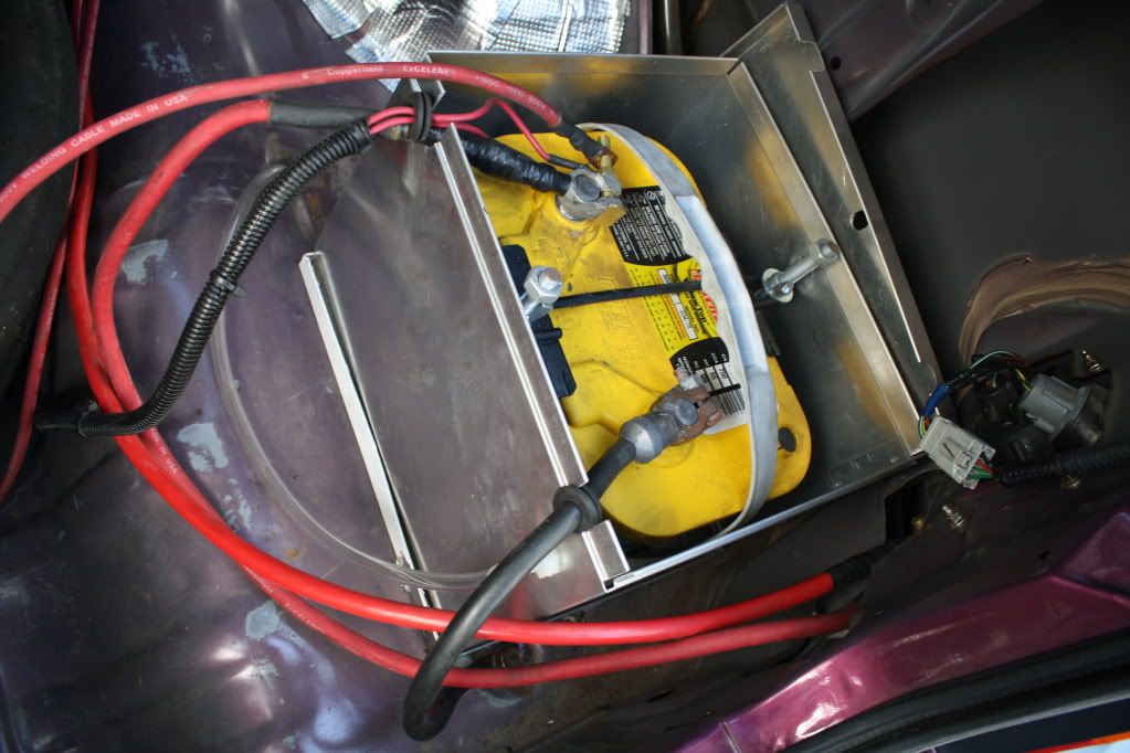

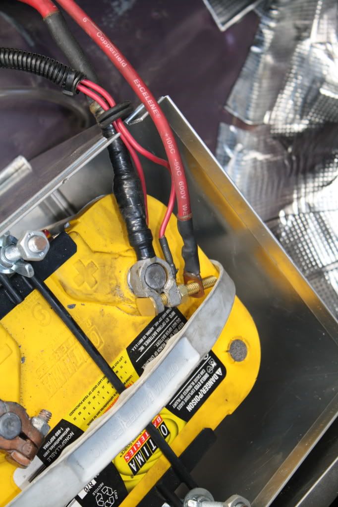

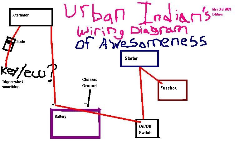

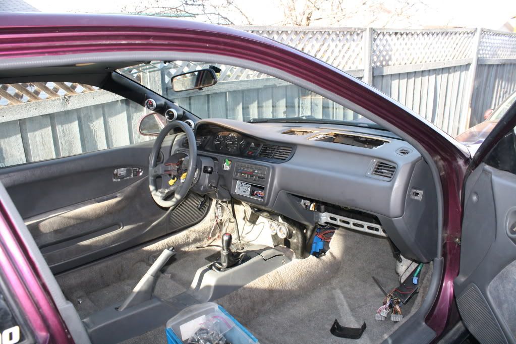

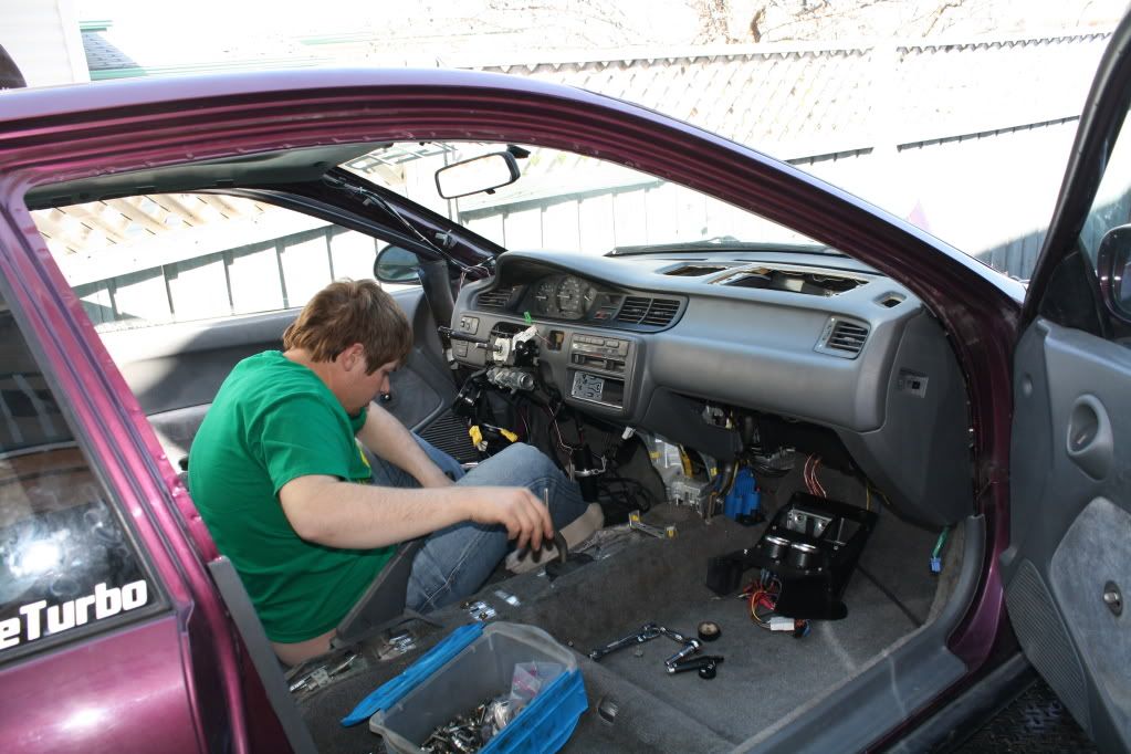

All the gauges are wired. The MSD is hooked up and the box light turns on( just need to add clips to plug into the dizzy ignitor. Dash is back in, just needs a little bit of wiring.

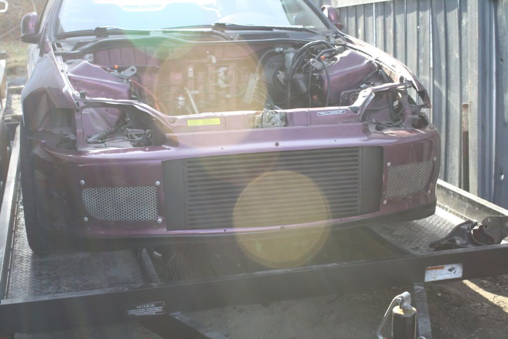

Rocking this bumper until I get a different one. I'll still keep this for the track.
Charge wiring problem thread
http://www.realhomemadeturbo.com/forum/index.php?topic=2149.0

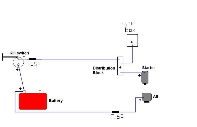

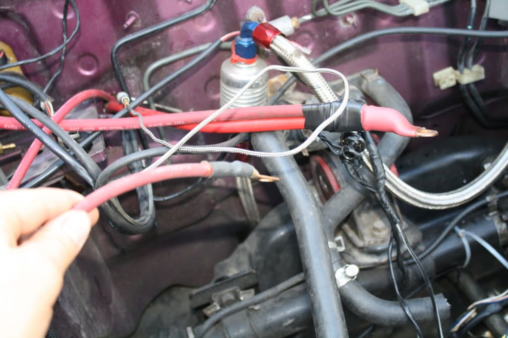

This is the way I did my kill switch setup. Works great.

And fuck off JH, thats andy P there doing some fucking wiring up in that bitch.
I hate how AEM has like a MILLION fucking wires for their gauges. Hard to stuff it in that little hole

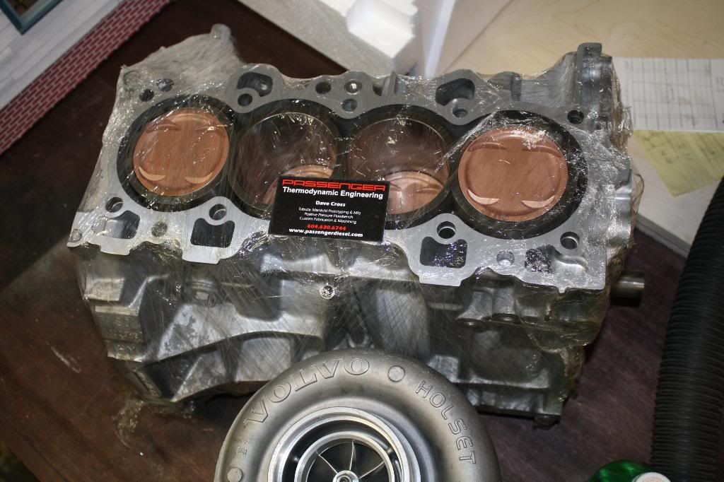

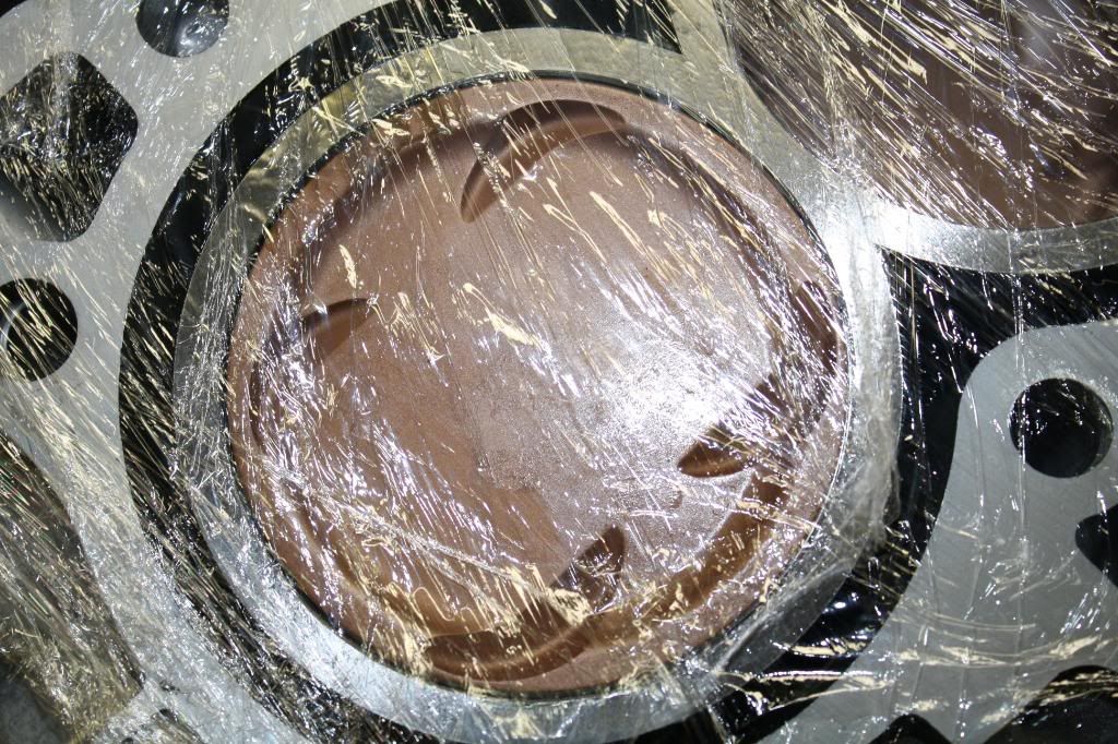

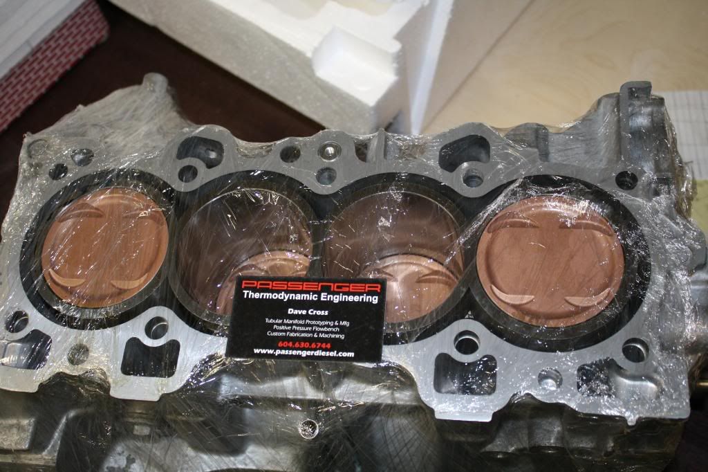

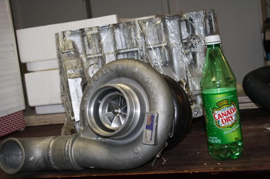

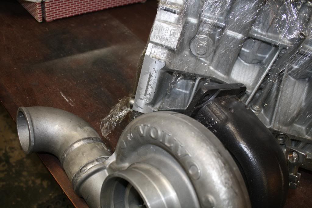

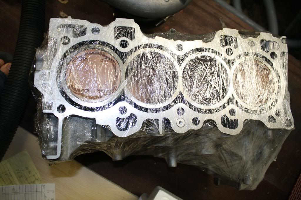

Well since super dipper failed to bring me a bumper I am going to rock this one. Pics of the new block, and the fancy dancy coated pistons. Just waiting the head and then its go time for assembly.
d-rail
  • Posts: 1005
Re: Urban Indians Re-Rebuild on the HX-52/2.0L GSR
« Reply #76 on: May 19, 2009, 03:08:56 AM »
Very nice. Looks expensive
« Reply #77 on: May 19, 2009, 04:15:33 AM »
he's indian, old ladies betting their social security checks paid for that shit

Laskey gave me a bunch of free shit. Like i was going to buy teflon coated pistons anyway. Shit looks baller though.

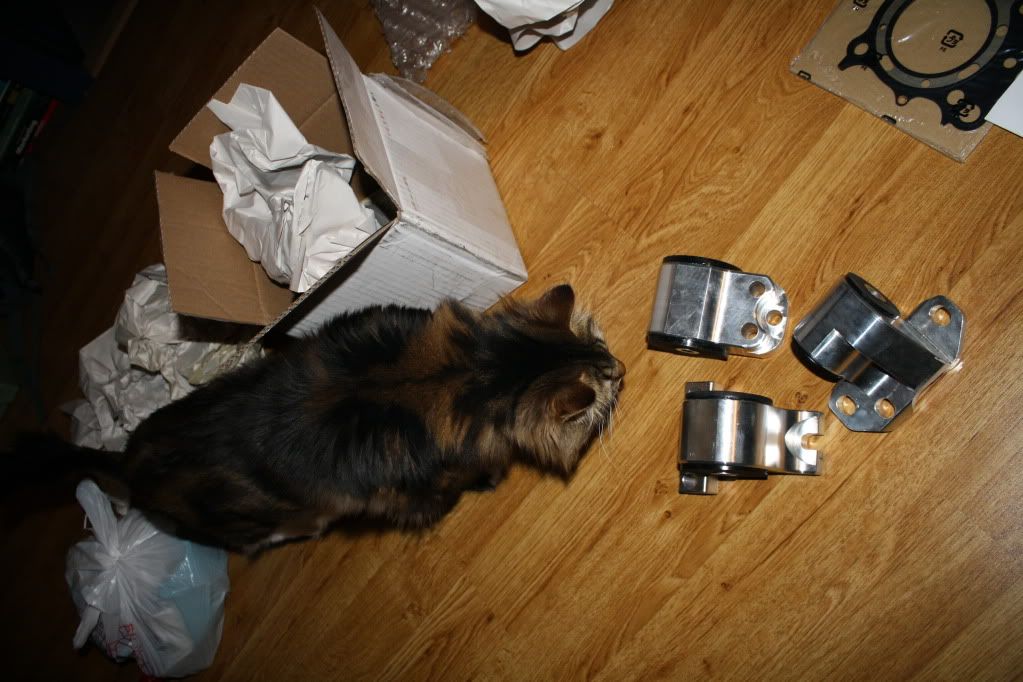

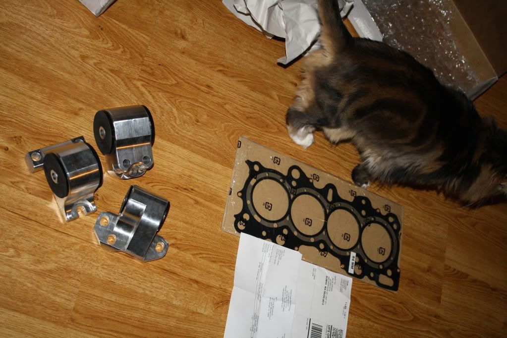

Lion Cat, new avid mounts. and the 2 HG i got from Tuner toys?(accidental shipment?)

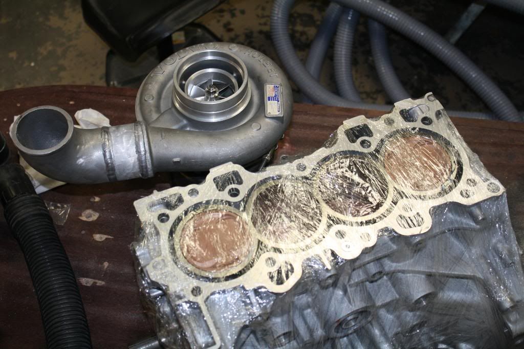

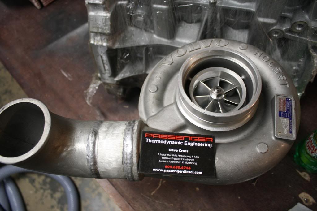

finish installing turbo onto manifold with wastegates. tranny is on, might go in the car tonight
