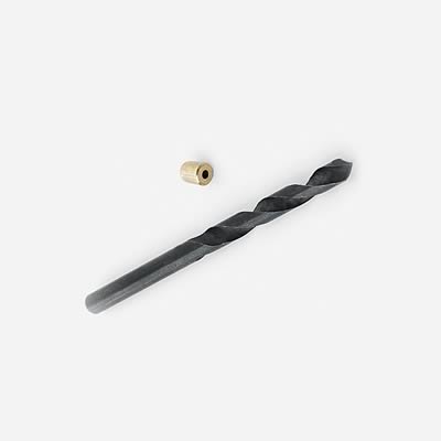

All the old holleys will shit powervalves out of themonbad backfires..... The famous stumble bumble off idle on hard press
Power valve saver from Summit: http://www.summitracing.com/parts/mrg-1511g?seid=srese1&gclid=CLv0iL7ivbcCFbE-MgodzWoATg
Should help in the future rebuild, or if you get a new Holley Avenger series carb they already have a saver in them.  :noel:

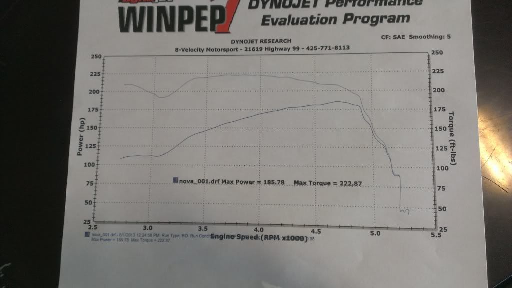

complete guess as i dont know what a 327 makes: 201whp 240ft  :-*
So It made about as much as I thought it would through the tiny exhaust manifolds.
RHMT RatCityRex 1966 Chevy Nova II on the dyno
