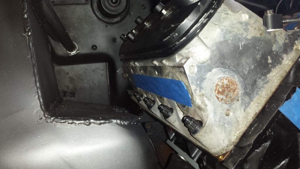

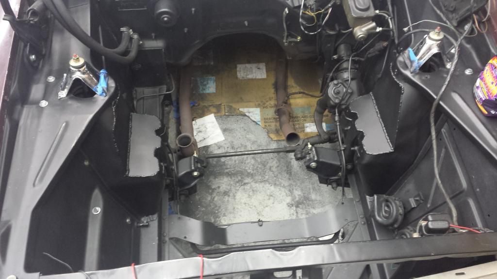

Got a little more progress done today. So I started grinding all my welds to make it pretty the other day. Today see how much more I would need to do to make the shock towers look worth a damn I decide to say screw it and went to town.
Got the spring and shock out of the way.
Welded up the outside
Cleaned it up and Taped it off and sprayed with permetex rubberized undercoating.
So I didn't get a pic of the engine bay side but I went back over my ground off welds and welded some new better looking slug trails.
Re: NOW WITH TWIN TURBO LQ4 ACTION~~~~~~~~~~~ 1966 RAT CITY RED ROCKET!!!~~~~~~~~
« Reply #602 on: February 06, 2015, 01:20:07 AM »

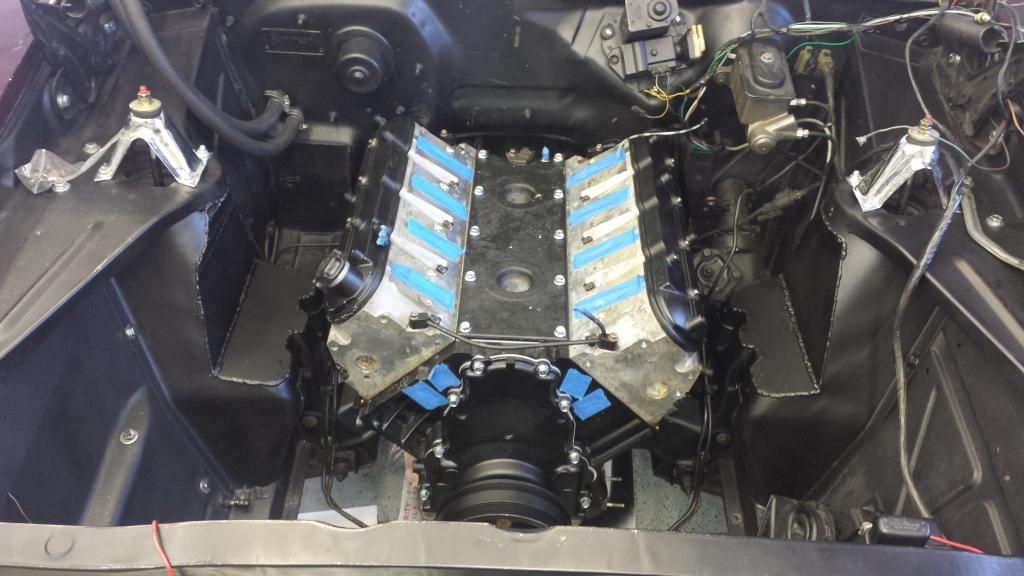

Well, drivers side all done. Now it's time to clean the engine bay and give it a fresh coat of paint and drop the motor in.

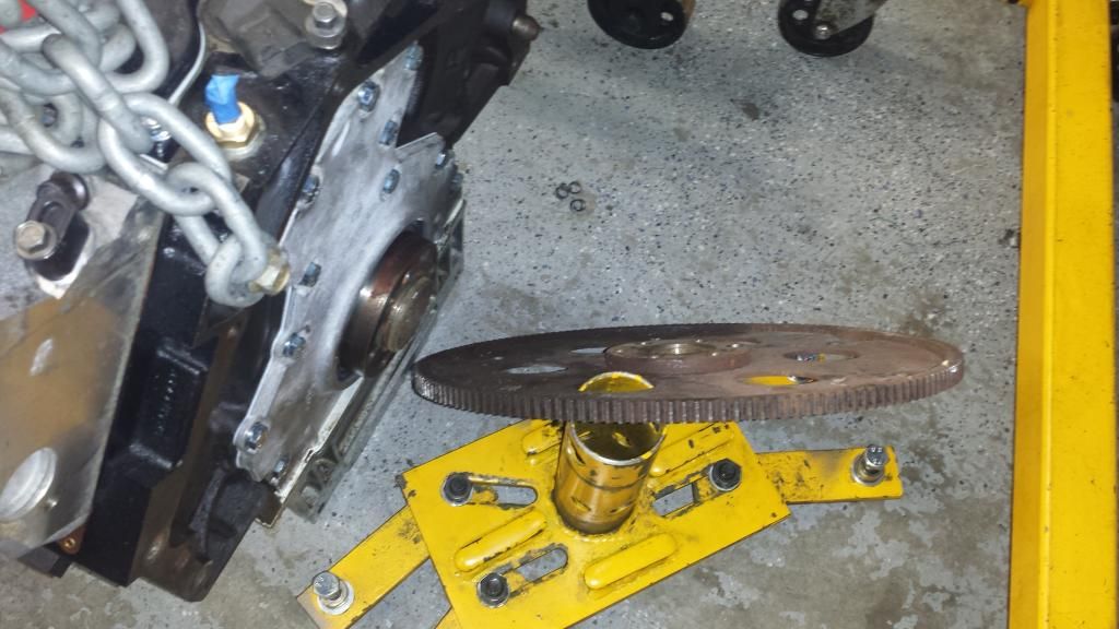

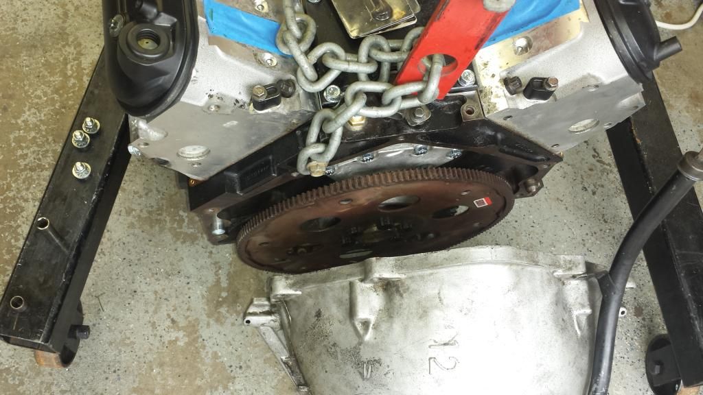

Well fuck me I got a lot done tonight.
1. Front main cover torqued down
2. Rear cover torqued down
3. Motor mount plates painted and installed
4. Engine bay cleaned up and painted
5. Steam vent tube and caps painted and reinstalled
6. Dipstick tube capped off
7. Oil pan bolted on
8. Pulled engine off engine stand to only run into problems

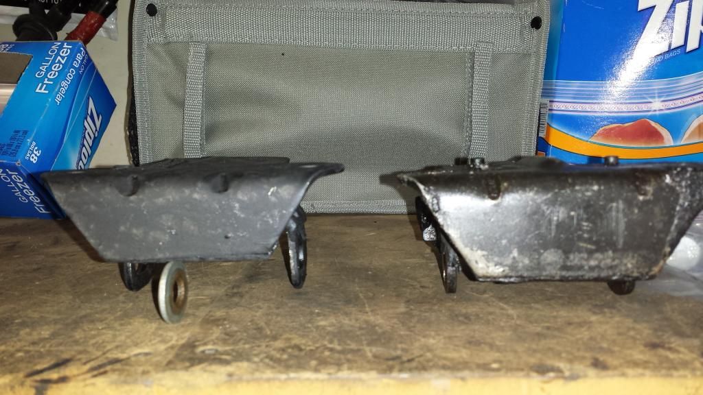

So that's where I stopped. My motor mounts won't fit on my motor mount plates because there is a weird bulge on the back so I'm gonna grab a new set of es poly motor mounts.
Then I went to bolt my flexplate on and was taking some measurements and it looks as if I have a early 99/00 long crank. So when I pulled my flexplate out of the back of the car and went to bolt it up it stuck out about 1 3/8" from the back of the block to the far side of the flexplate. And it should only be about 1" So after calling it a night and going in and taking a shower, I started reasearching. I just figured I had the wrong flex plate. Which I have a 01+ flexplate with a built in spacer. Now I've seen some pictures of where people remove them but I don't know how. So I think tomorrow I'll just take my bfh to it and see how it rolls.
Onto the pics.

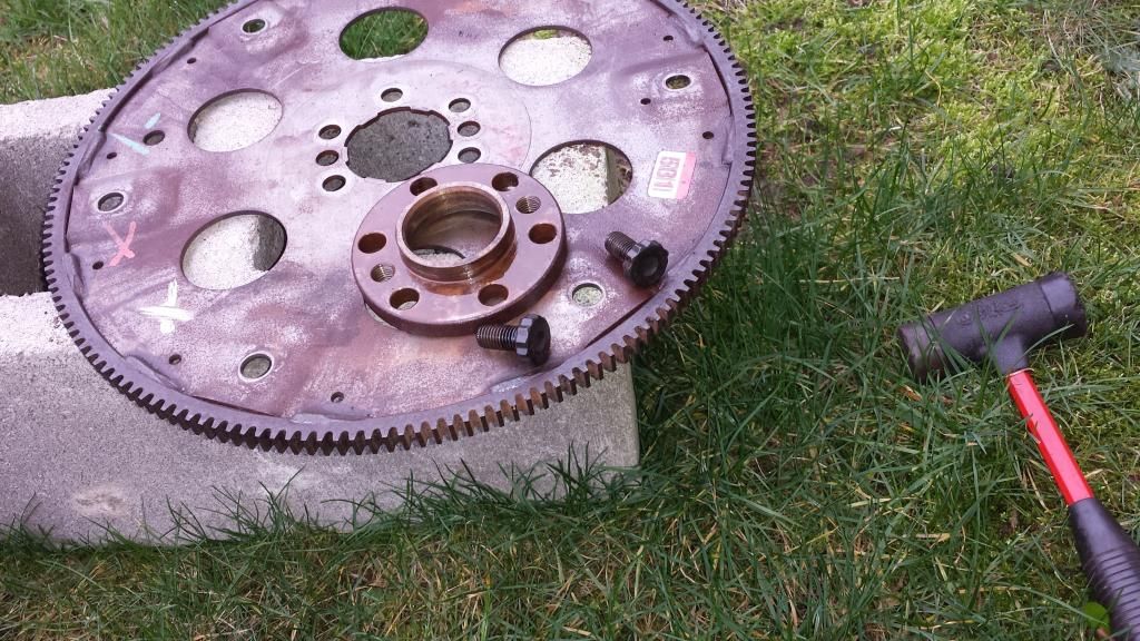

I already knocked the spacer out of it. Now I just need to slide it onto the crank and tq it down.
So just a quick update. Spent all of about 10 min in the garage b4 my kid woke up and had to get back to daddy duties.
This is how it looked last night when I called it a night.
went to the auto parts store today and just picked up a new set of motor mounts. Mine were pretty haggard anyways and god only knows how old. New ones don't have as large as a hump on the back so 1 washer to space it out and I should be golden. Hard to tell here but the old one had at least 1/4" hump in the middle. Couldn't sit flush up against my adapter plates.
also soaked the plate with the spacer in a little wd40.  Took 2 flexplate bolts and stuck it on cinder block and worked it with little taps from a rubber mallet.
to tomorrow I'm gonna tighten all that shit down and bolt the th400 up and slide it in the nova. Unless I run I to more problems.
« Last Edit: February 08, 2015, 09:41:46 PM by ratcityrex »
« Reply #606 on: February 09, 2015, 04:49:49 AM »
Well its all buttoned up for the night. Got the motor mounts all shimmed out and seems like it's gonna work out good. Got the flexplate bolted down and it's gonna work. Also got the crank pulley torqued down. So tomorrow, this will find its new home in the nova.

Well fuck me!!!! This fucking motor fought me the whole way. IT DID NOT WANT TO GO IN!!! But it's in.
First thing. I went to go install my trans on and I noticed I only had 1 alignment pin for the transmission. Not a big deal, but I had to stop and run to the hardware store and pick up a couple of different sized ones. 5/8" is just about right. Bfh and a block of wood and I drove her home.
next was putting it in........uhhuhgggggg
So I had to drop the front crossmember, swaybar, steering linkage, passenger side valve cover, and I still had to use brute force to get it in. Once in I had to move the mounts on my motor mount plates back 3/4" (which moves the motor forward) I was able to get it in. But now my transmission is 3/4" forward of where it was. So now I don't know if my driveline is gonna work out. FUCK!! And to top that off I now have to fab up a new crossmember for my trans. There is like one 1/4" of room between the rear of my passenger side head and the fire wall. So there is no moving it back more....lol oh well at least it's in.

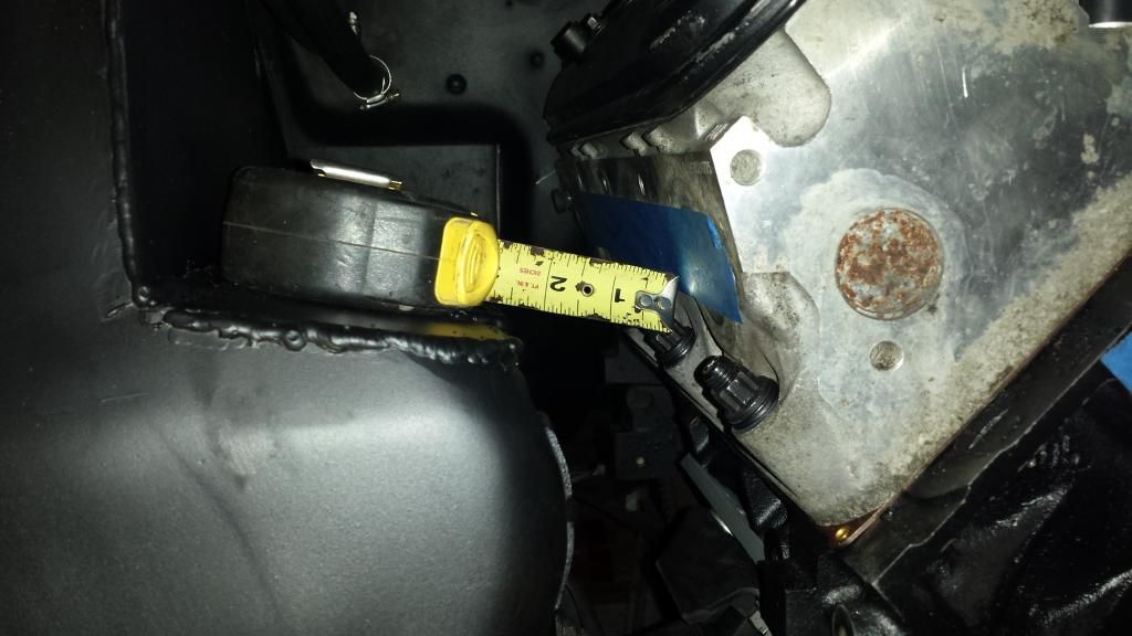

I like that idea, but I have to get some measurments from them. I really don't think they will fit to be honest.  Clearance between the head and the shock towers is very close.
« Reply #619 on: February 11, 2015, 02:08:56 PM »
Just got a email back from vsracing.net They are already out of stock and they stick out 5.6" which I think is about 2" to far....lol
« Reply #620 on: February 11, 2015, 02:38:37 PM »
So I have about 2.5ish from the exhaust port to the shock tower. Defiantly going to have to go up with them or build a couple of logs
