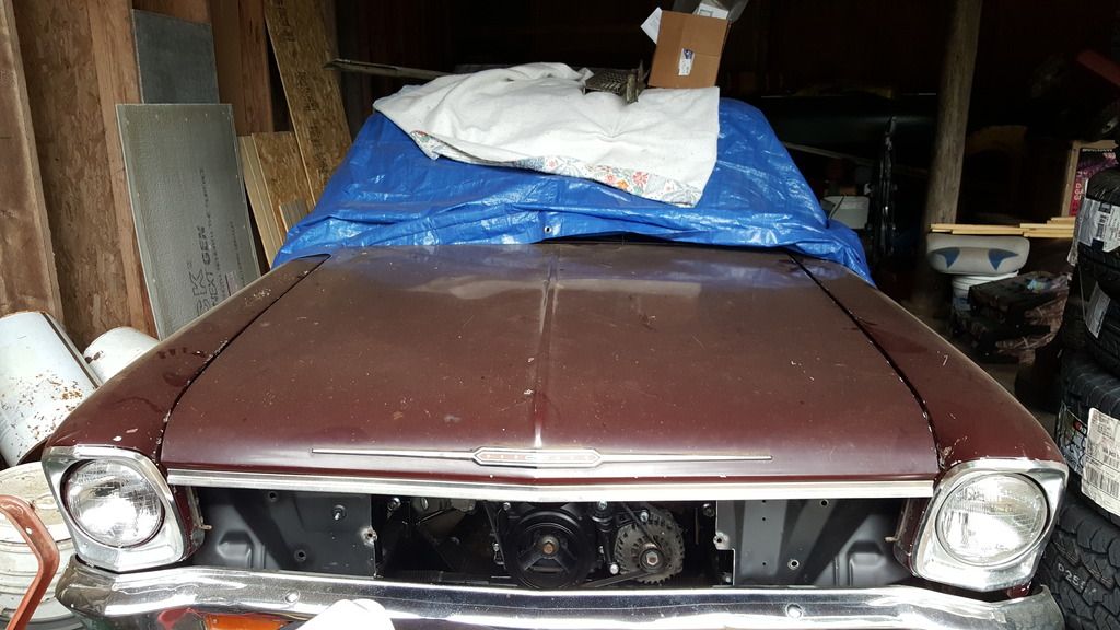

Well, fenders and core support are on. Everything fits about as well as it did before. Now I just need to elongate a couple of holes on the core support so I can actually bolt it to the frame rails. Then paint my inner fenders and bolt them on. Getting closers, that's for sure.
looking good. looks like it lines up better than my car lol.
dont you need to put the inner fenders in first?
Nope, core support, then the outer fenders, then the hinge supports then the inner fenders.

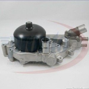

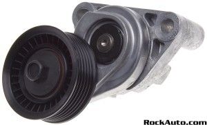

Next, I got a ls1 water pump from rock auto along with a ls1 tensioner. All for fbody for about $110 shipped

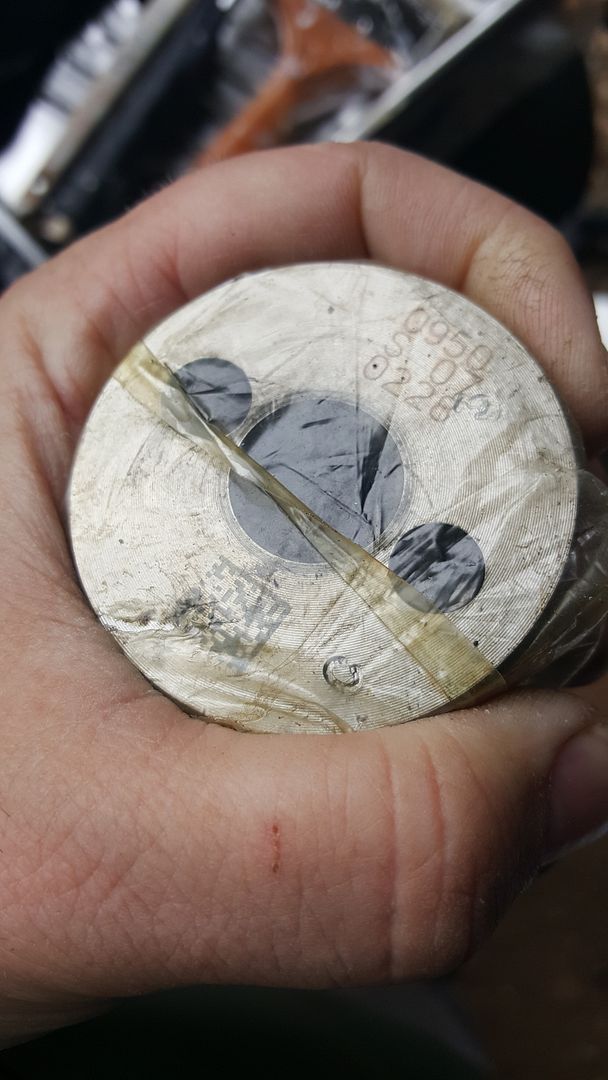

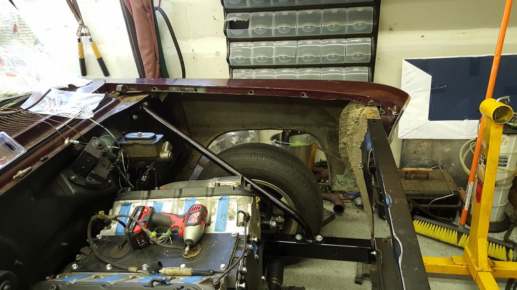

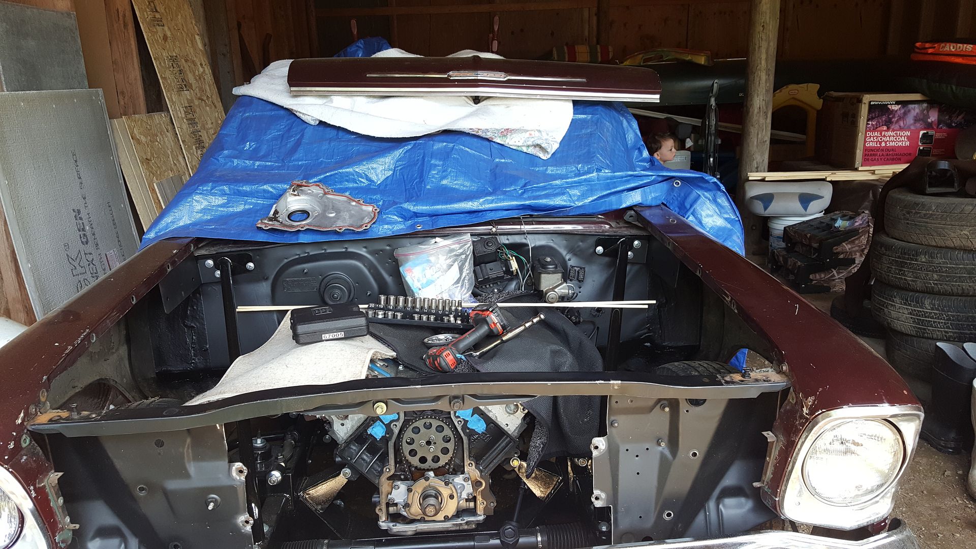

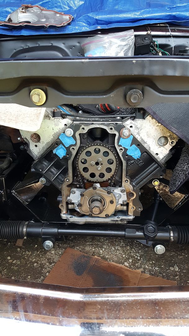

Well today,I yarded my lq4 cam out and put the ls6 cam in. Didn't do pics with it pulled out, but I did the dowls trick. Backed all the rocker arm bolts out and then got it to the point of where i was going to pull the cam and I spun it over about 5 or 6 times. Slilped in a couple of $0.97 5/16 dowls in to make sure the lifters didn't fall down while I had the cam out. Worked great. Took all of about 30min start to finish. These are the only pics I have
my cam!  :mexi:
nice that the dowels work. might do that some day to the truck...or just a 6.0L...
Where do the wood dowels go?
Pull valve covers, unfortunately rockers, take all the shit off so you can get to your cam, pull cam gear and all that shit, pull cam retainer plate, put cam gamer back on, spin it around 4 or 5 times to push all the lifters back up. Use a 5/16" wood dowls and push that bitch into the holes that are behind the cam plate. Make sure it goes all the way to the back of the block. I referenced how deep I need to push it in against the cam I had out and made a mark on the dowls. Pushed in with  little side to side wiggle and it was a snug push the whole way but the lifters weren't falling down in the block that's for sure. Hardest part of the whole thing was pulling the crank pulley off. My 3 jaw puller is in storage somewhere and I had to rent one from the store. It was a totally piece of shit. So I ended up using a dodge/chrysler harmonic balancer puller and it worked ok.
That's the puller I use on them to, not a perfect fit but ok.
I've never heard of this wood dowel operation before. Badass!!
Yeah they sell special tools and shit like that to do it. But I think I had a total of $1.94 in wooden dowls. Think they were .94 each at home depot. Has to be the 5/16 ones though. It's great because you don't have to pull pushrods or heads!

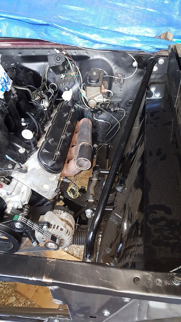

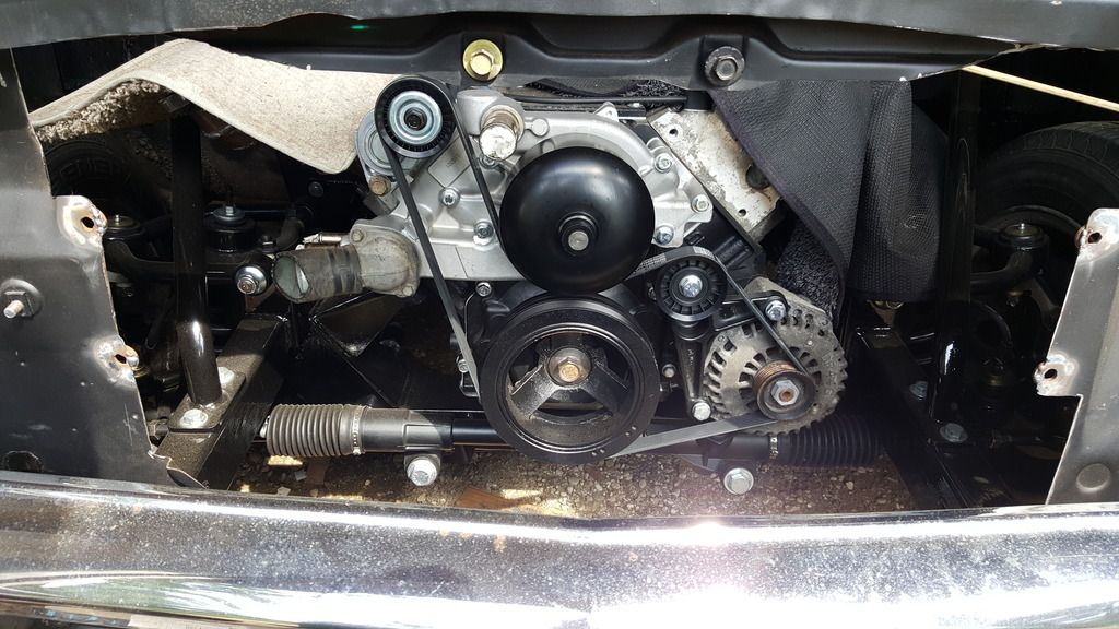

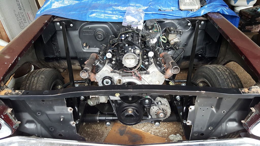

Well, im One step closer. Fbody crank pulley/balancer on. Block tapped for Fbody alternator bracket, so I painted it and bolted it on. Tomorrow I'm going to try and get the water pump bolted on and get the other inner fenders painted and the one that is painted hopefully bolted on.
« Last Edit: May 09, 2016, 12:11:20 AM by ratcityrex »

i've done it about 50 times without the dowels. someone gave me a set of dowels a few weeks ago and i was like WTF are these for? and he then asked me if i've ever done a came swap in an ls.... lol. this guy.
I've heard of alot of people doing swaps without them. I just know with my fucking luck I would drop one down into the pan and fuck myself....lol
Random Hero
  • Posts: 2114
i made the dowels 4 peices. cut a screw in half and threaded it in both peices, no i have short dowels!
Not much to report on. I painted my other inner fender. Now I need to figure out what I need to take off to get these bolted on. Once they are on. I orded up a tentioner pulley, and a belt. Hope to get that on monday. Then I'm going to sites that fit my sump Pan for my fuel tank and hopefully get it out and drained. After it airs out for a few days I'll light it off and see if I can get it to burn. Then hopefully weld that bitch up, paint it and bolt everything back in. Then maybe I'll work on intercooler and radiator shit.

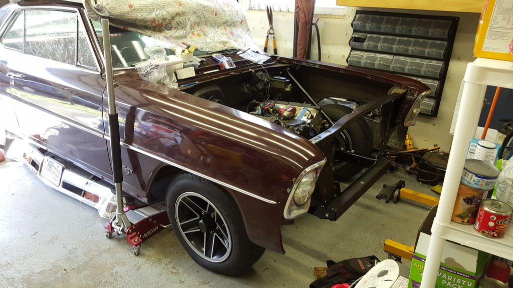

Next thing to do is install inner fenders and hood hinges and see if my truck intake clears the hood.

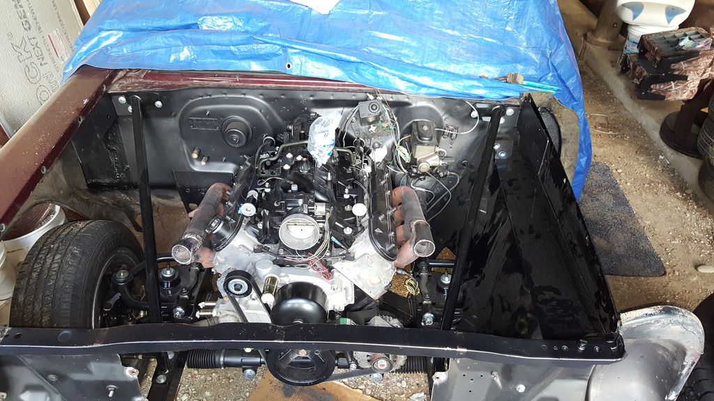

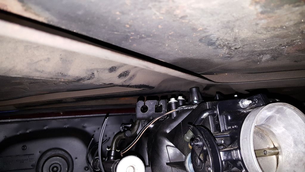

Fuel rail spacers installed and rail is bolted down. Hood test fitted and there's plenty of room between the truck intake and the underside of the hood. Like I could probably fit a holley hi ram without having to cut the underside of the hood up.
I felt it move a little...
Damn so much room in that engine bay!
Not really. Once I put the radiator and inner fenders in its gonna take up so much room.

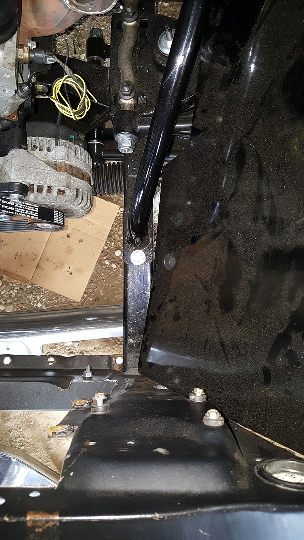

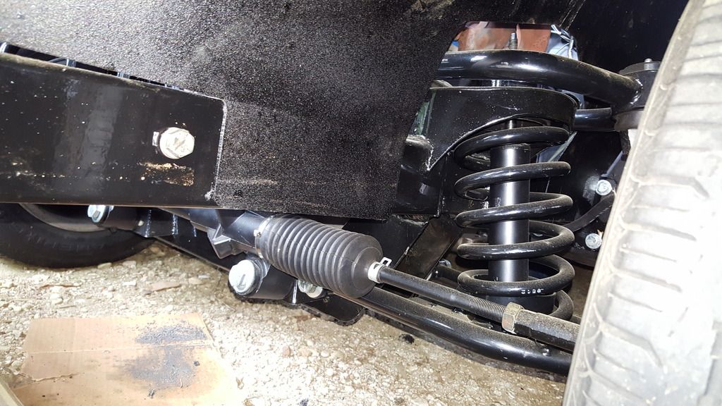

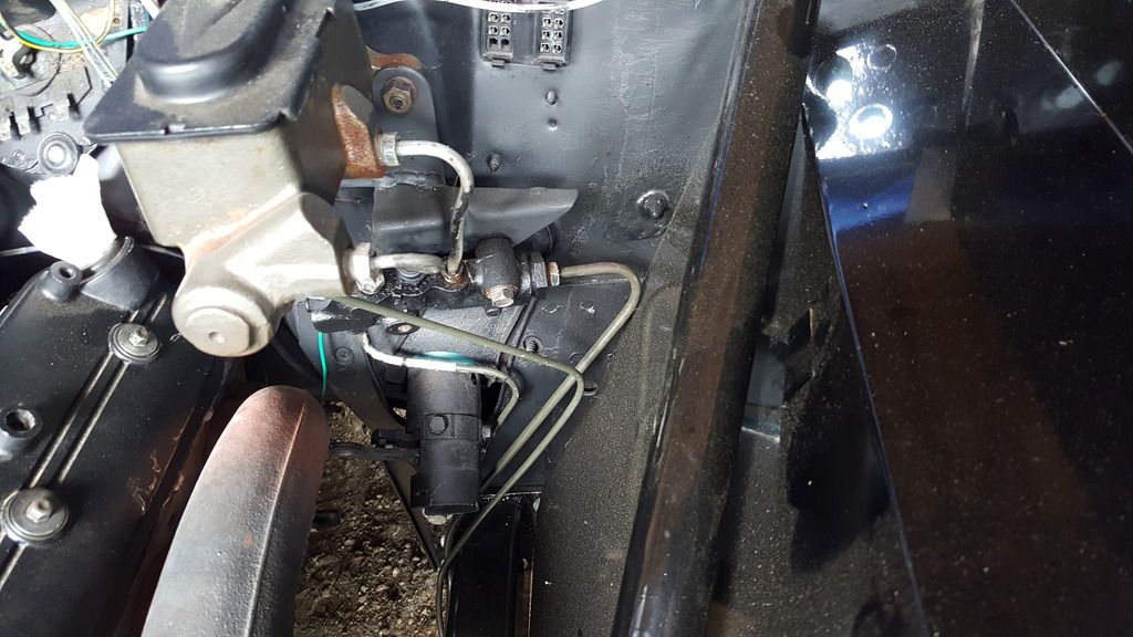

Ok, so I'm trying to get the inner fenders bolted on so I can get the radiator, intercooler, plumbing and all that installed so I can weld up some new turbo manifolds. New inner fender fits like shit. I'll make it work, and nobody but me will probably notice it but it is what it is.
Fucking brake line was in the way. So I gave her a bend out of the way.
That's all for now. Gonna try and finish up the other side tomorrow.
