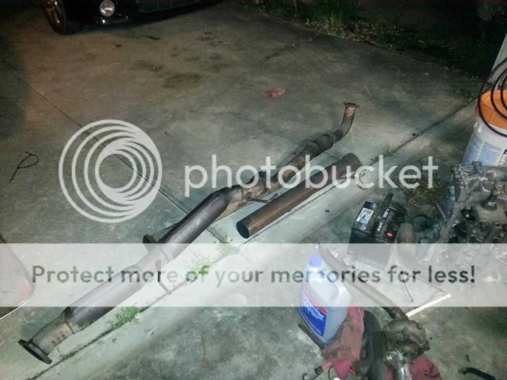

Car won't start again. Most def have fuel and spark. I'm too tired to try and figure it out. Good news I aquired gas for my welder for $0.00  :Jew: & some free 3" modge podge of exhausts from a excursion, eclispe, and a f-150. lol

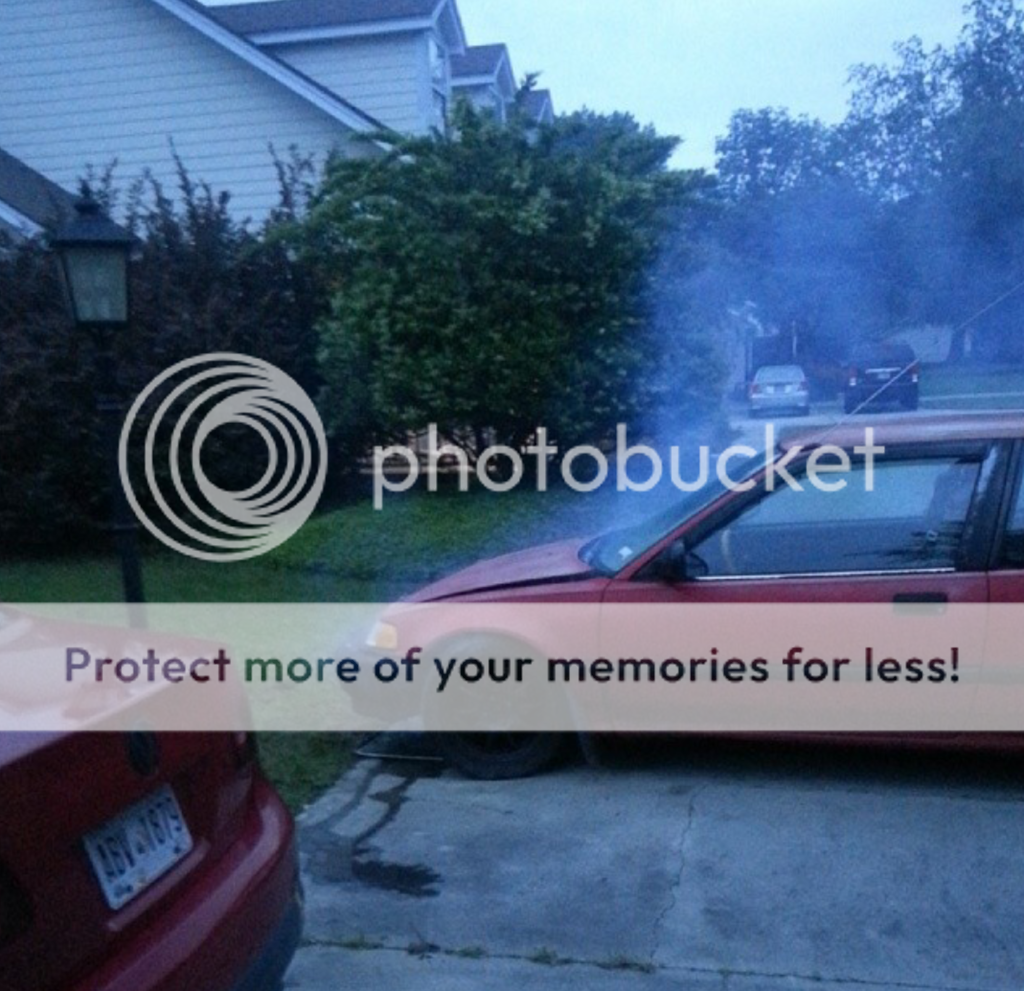

Actually ended up destroying the headgasket and ran the motor hot because I'm smart.

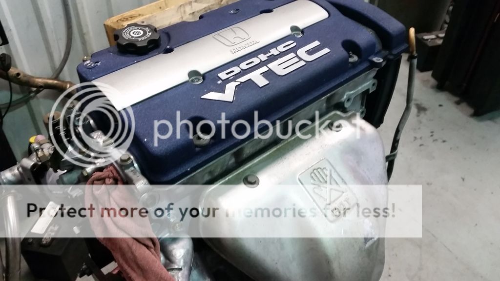

Decided that I cant have a reliable fast turbo car being as fucking broke as I am, went na f23a for a while. Motor was $350.
Found out I can't tune for shit the hard way.
Saved up some cash
To buy this turd. Jdm blue top h23a fresh from hmotors. $1294  :-X going na again  :'( till this motor shits itself then sleeving the f23a, throwing this head on and maybe I'll go forward facing turbo and fuck some people up.

Great choice with the H23A. If you need a BIN to get it started, I have a decent file that's eCtune based (burnable). Keep in mind the H23A FPR is probably 58psi not 36psi like most H22's, that's what mine tested out as.

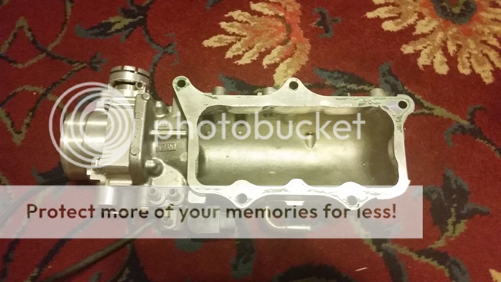

Un wrapped the boat anchor
And started porting the upper manifold

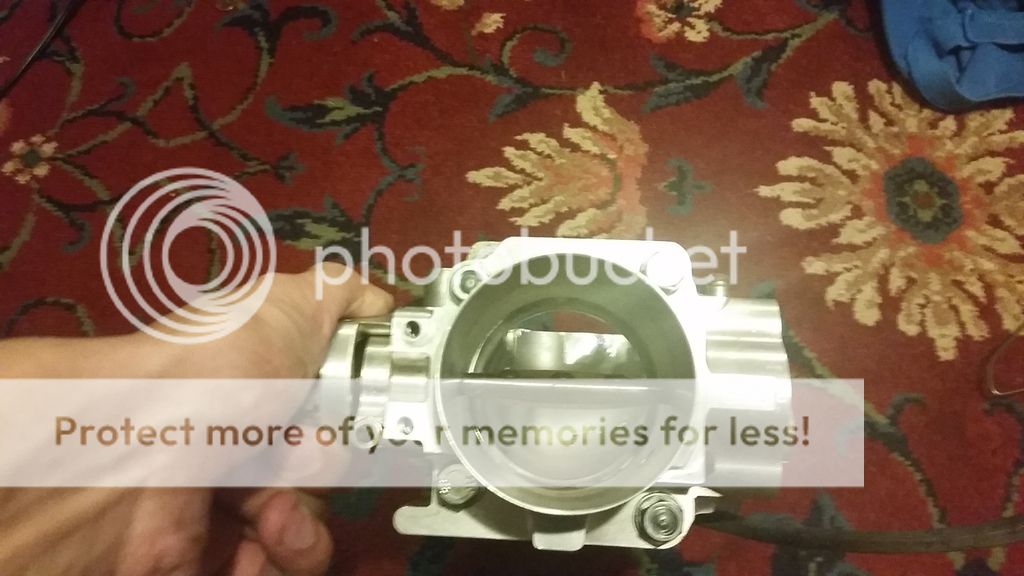

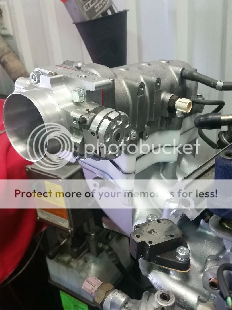

68mm throttle body I got for a while ago for $0.00  :Jew:

In that case just use an H22 map to start. For the IM do NOT cut the dividers between runners, just make them into full-length oval-inlet runners. The H23A doesn't like super-short runners, plus the area below the side walls gets very thin if removed. With the TB all you really need is decent header and a good tune.
