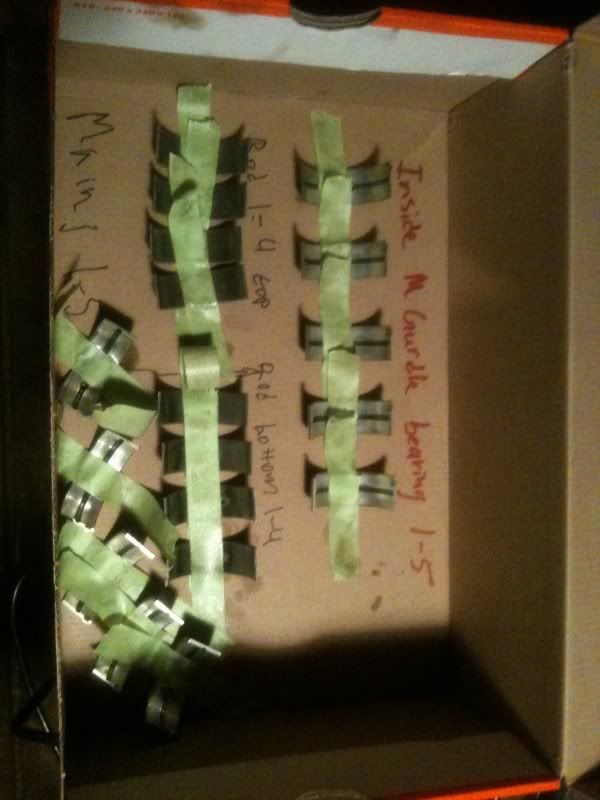

gotta stay organized all the bearings will be recycled back into the motor they look minty fresh

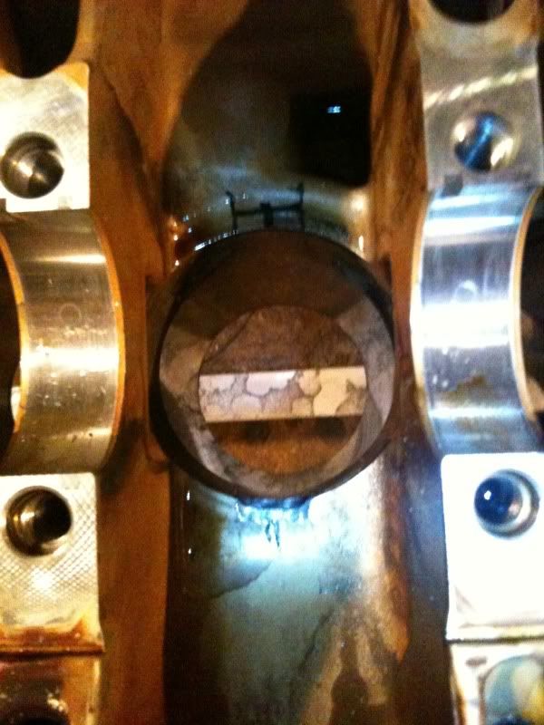

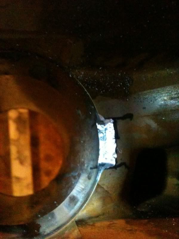

should I keep going deeper with the notch? I used a pice of 3/4 tape to mark out the width then i went about 1/4 inch up into the sleve and 1/4 back into the block and connected

Help a nig out notch deep enough? Really don't want to reassemble just to see if it is :P tell me if you think I should take more out
Re: boosted 4dr...OFFICIALY jdm since pg 6
« Reply #280 on: May 06, 2010, 08:50:42 AM »
I took out a little less material then you with good results. :yes:
But you should be fine.
