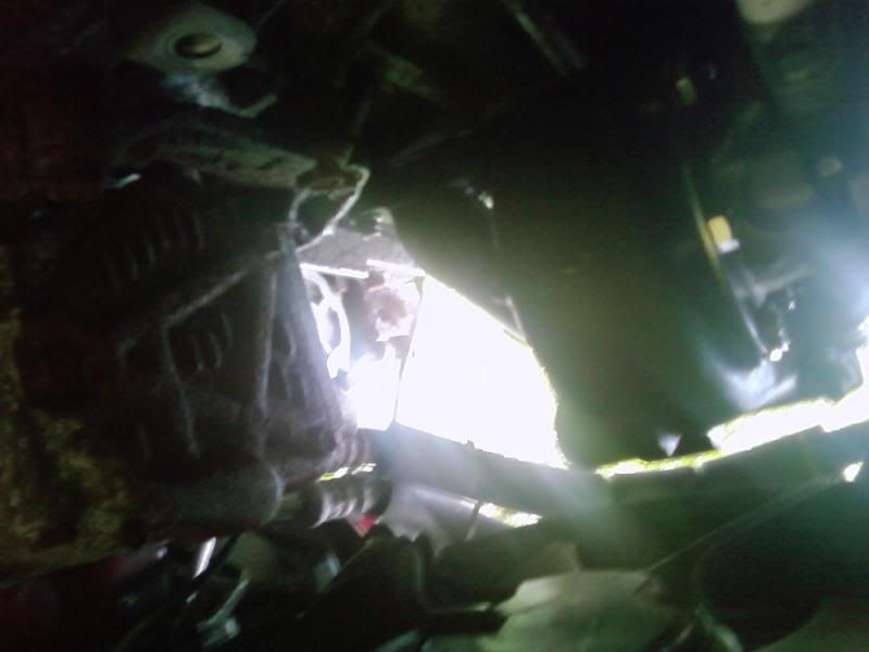

k got the DP done today, now trying to get the fucking WG tube to work. . . pain in the ass no room at all.
phone is being gay at the moment so no pics, but its a TIGHT ass fit about 3mm or so from touching the AC condenser and had to remove the 5th bolt on the flange it order to get it bolted up.
kinda wish i ran a 2" dp now but hope the power gain is worth it in the end
took one shot at it and it worked was routed back into the exhaust fine, but couldnt remove the fucking thing to finish weld it.
no room for just a dump tube unless i run it up and through the hood lol.

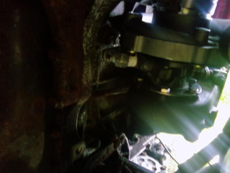

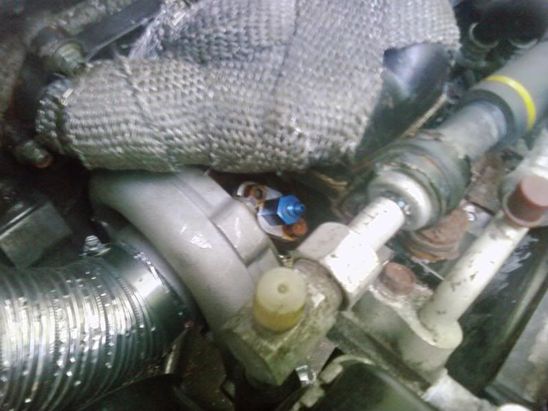

so i got stuff through summit racing to make the oil work, even got the weld on AN fitting. car fired up turboles with the rc440 and my basemap just great idled fairly well too
got the turbo clocked correctly, should be coming together on friday.
still need to notch the block some because as i clock the turbo the cold side touches a little bit.

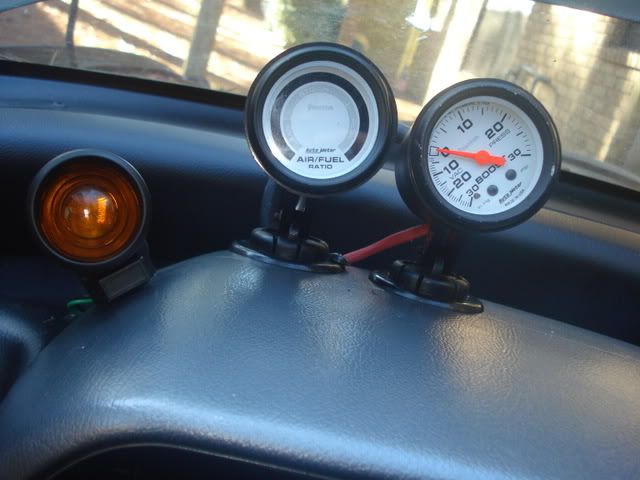

another update, got everything i can done before the oil lines come in tomorrow. cold side pipes are done, bumper is trimed to fit, IC is mounted up. some pics
stealth BOV lol
was tight as hell makig it all fit, open WG for a bit until i can find some of that flexible exhaust pipe stuff at autozone
z6 + boost =  O0

got some more done today, made a new new intake out of the stock box, turned out great IMO and IAT's are 40-50 lower too
well here are some pics
if anyone has a stock kn drop in they want to trade for a kn cone filter w/ 3" opening would be great :D
the "mufflers", just gonna run one into the other right out of the downpipe should sound mean as hell 2.5" glasspacks 30" length
twisted for pleasure
gonna register, and inspect it after memorial day and finish u the tune
so far i like the power, but the turbo is laggy as all fuck lol. its not too fun on the stock motor but once the vitara build is done it will be great
right now boost is coming in right at around 4500ish and hits hard as hell once it get over 5000 and vtec engages.
its also idling very lean, 18+:1, when fired up cold, gotta play with parameters in crome a little more to get this taken care of
right now its only tuned on low cam, gonna work on the high cam tomorrow afternoon once im out of work.
