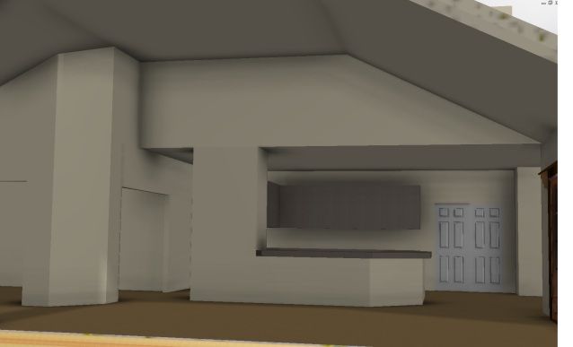

The walls are already studded out with 9' studs so the lowest ceiling I could run is 9 foot.  I've got a wood stove so that puts out a lot of heat.  My uncle has a 5300sqft house with vaulted ceilings and his electric bill was always around $400 a month with his heat pump.  So I'm only heating half of that and I'd be happy with a $400 heating and electric bill
With the 2 roof lines over 8', I don't know if I've seen two angles of ceiling going to a flat at any height other than an attic loft or something. It could work, and 10' is always a good ceiling height, and would still leave some room for an attic storage above, but that 2' of roof line between your walls and your flat ceiling will be an in between wall/ceiling. It can work, but I'm not envisioning the finished deal.
Here's a picture of what I'm doing to the ceiling in my great room looking at the kitchen.  9' walls, sloped ceiling to a height of 15'
« Reply #31 on: October 18, 2012, 09:27:46 PM »
That looks good.

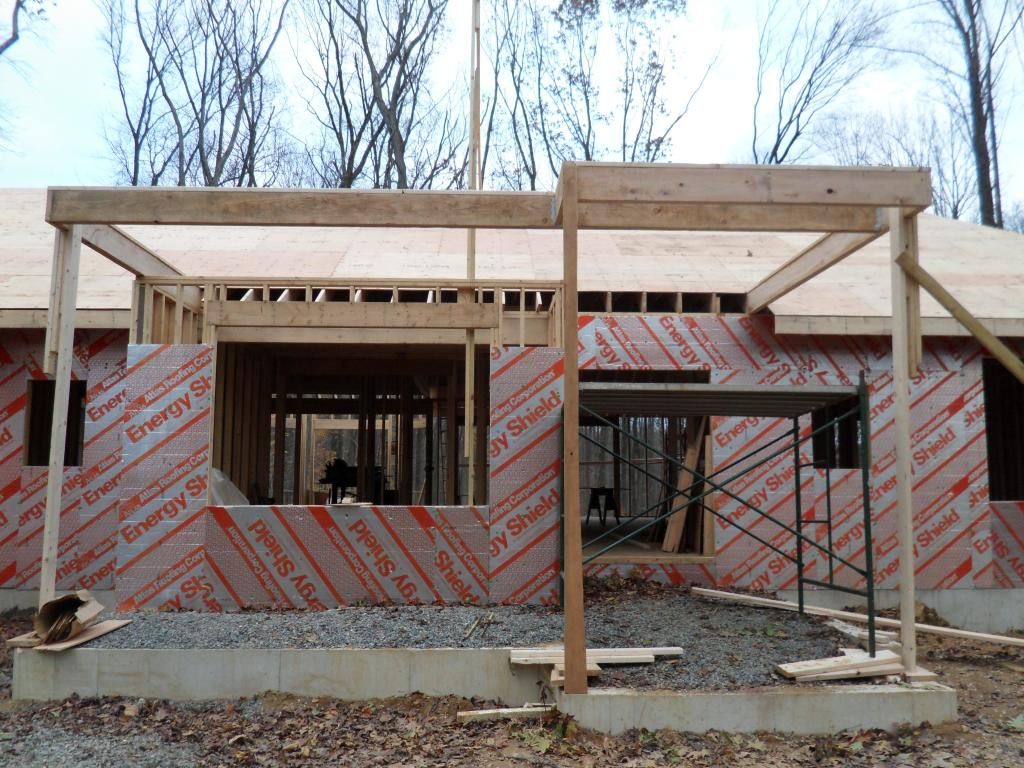

Started on the main roof and the outside 1" foam

I notice the foam around the perimeter of the house. You going brick or siding or a combination of both? Also can't tell from the picture,but did you Moisture barrier it with some home wrap?

I'm doing a combination of stacked stone and stucco on the outside.  I'm thinking of a light stone and a darker tan/brown stucco.  I don't need a house wrap cause the 1" foam has foil on the ID and OD.  I may tape the seams of the foam but its not required.  I did add expandable foam to any joint where I couldn't get any insulation in.  For the roofing we're doing ice shields in the valleys.

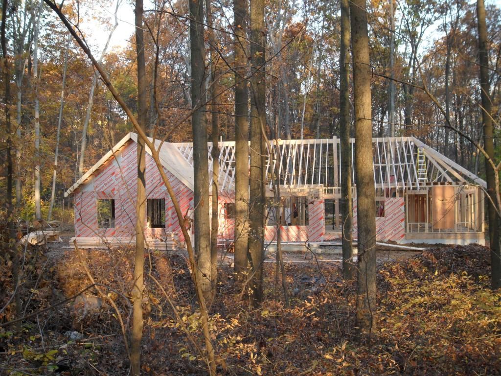

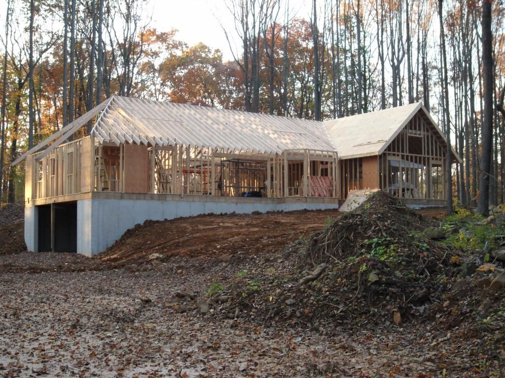

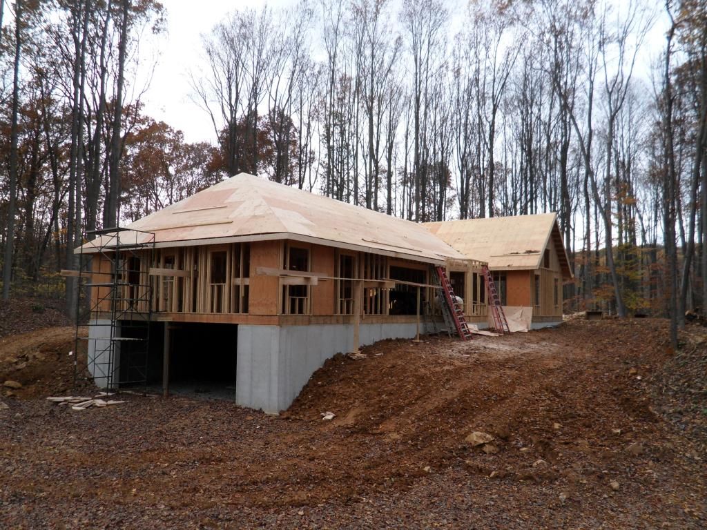

A little update here's the progress on the main roof from the back of the house.  You can also see we backfilled the house but the ground slope still isn't at final grade, that's still up in the air:

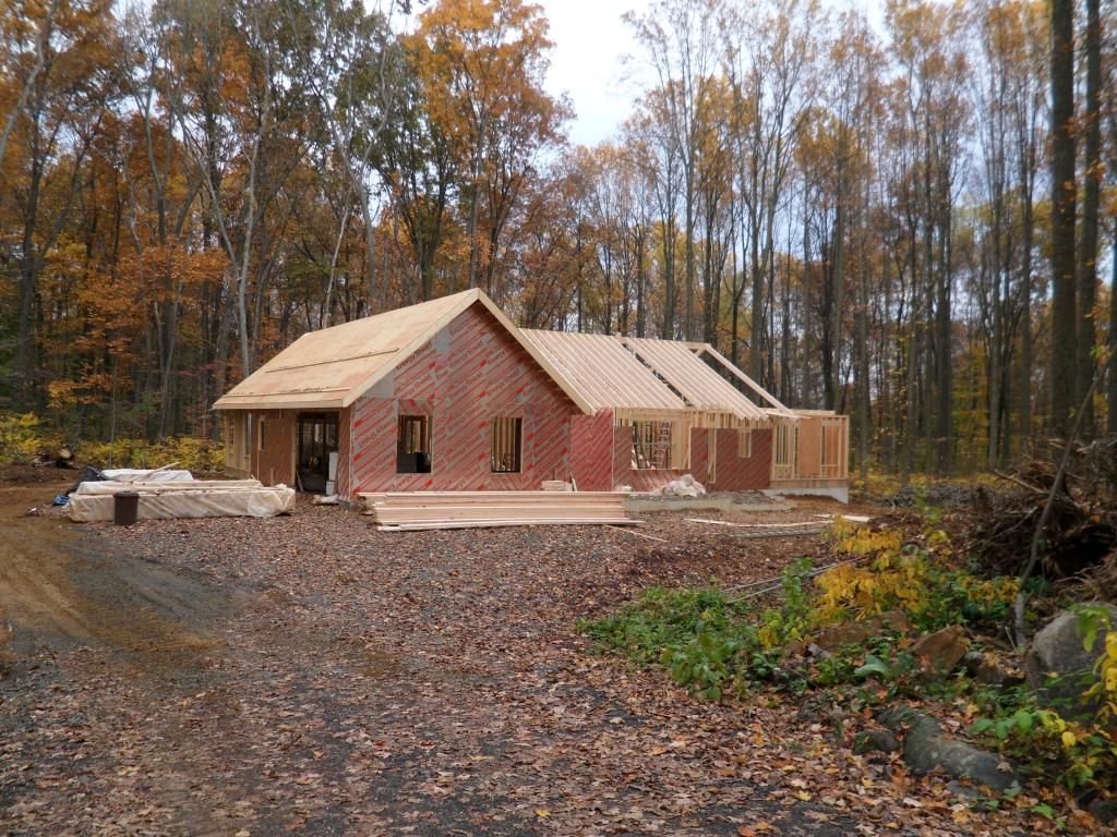

Front of the house, still have another dormer coming out for the porch that's not framed out yet:

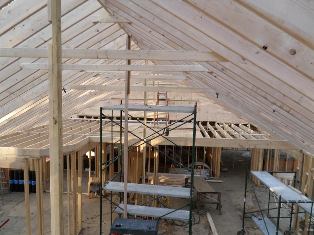

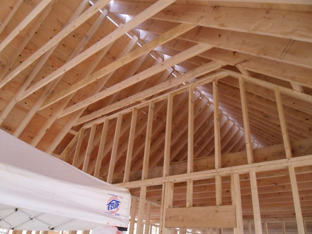

Setting the collar ties for the ceiling height in the great room:
It's getting built as we go along so any suggestions or idea's on what you would do I'd like to hear it.
« Reply #40 on: October 24, 2012, 06:36:07 PM »
Fuck man, Looks good! What are your overhang soffet lengths?
The overhangs off the dormers are 18" finished.  The main roof has a 22" overhang and the garage/bedroom has a 16" overhang.  That was the only way the facia would line up with a 7:12 pitch main roof and a 10 1/4:12 pitch on the other roof

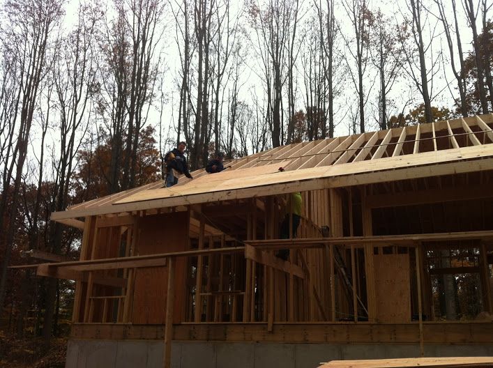

Me putting the plywood on the roof:
plywood on the main roof done:

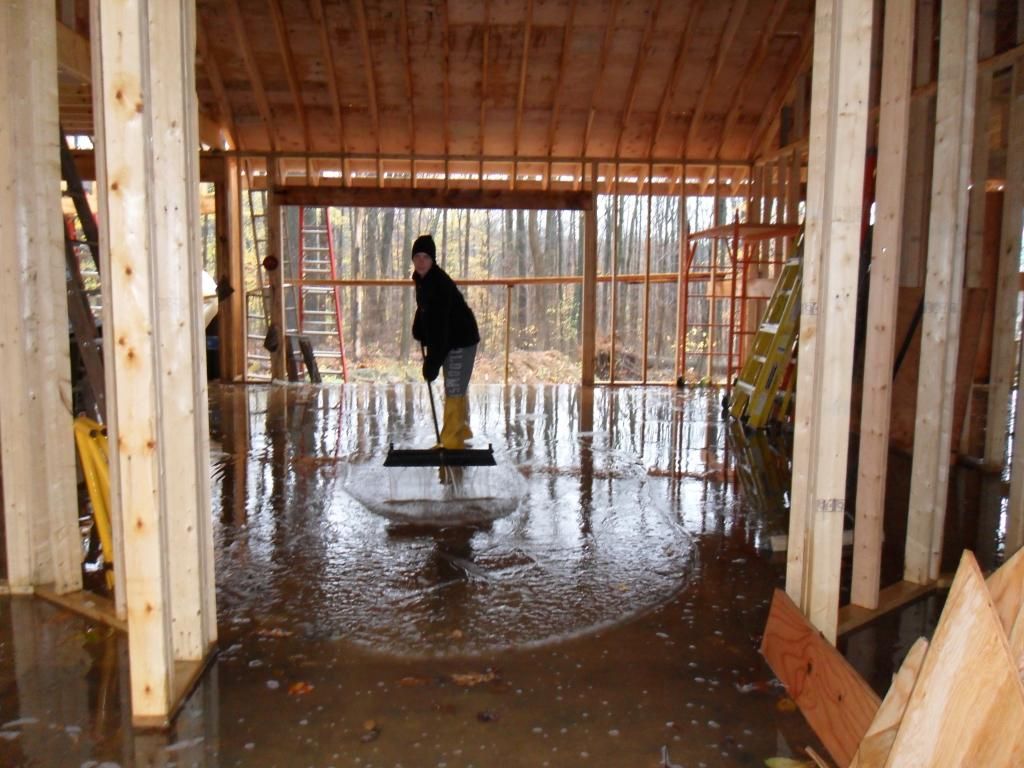

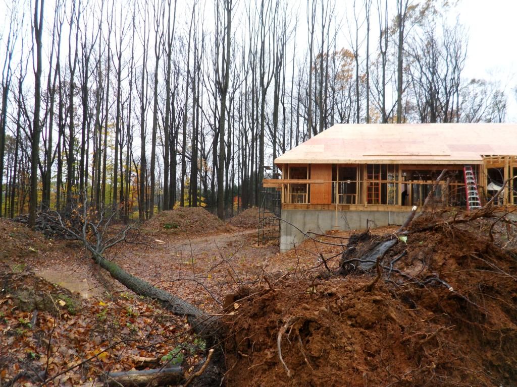

That cunt Sandy trying to drop a tree on my progress.  Missed by about 35 feet:
2" of water in the house:

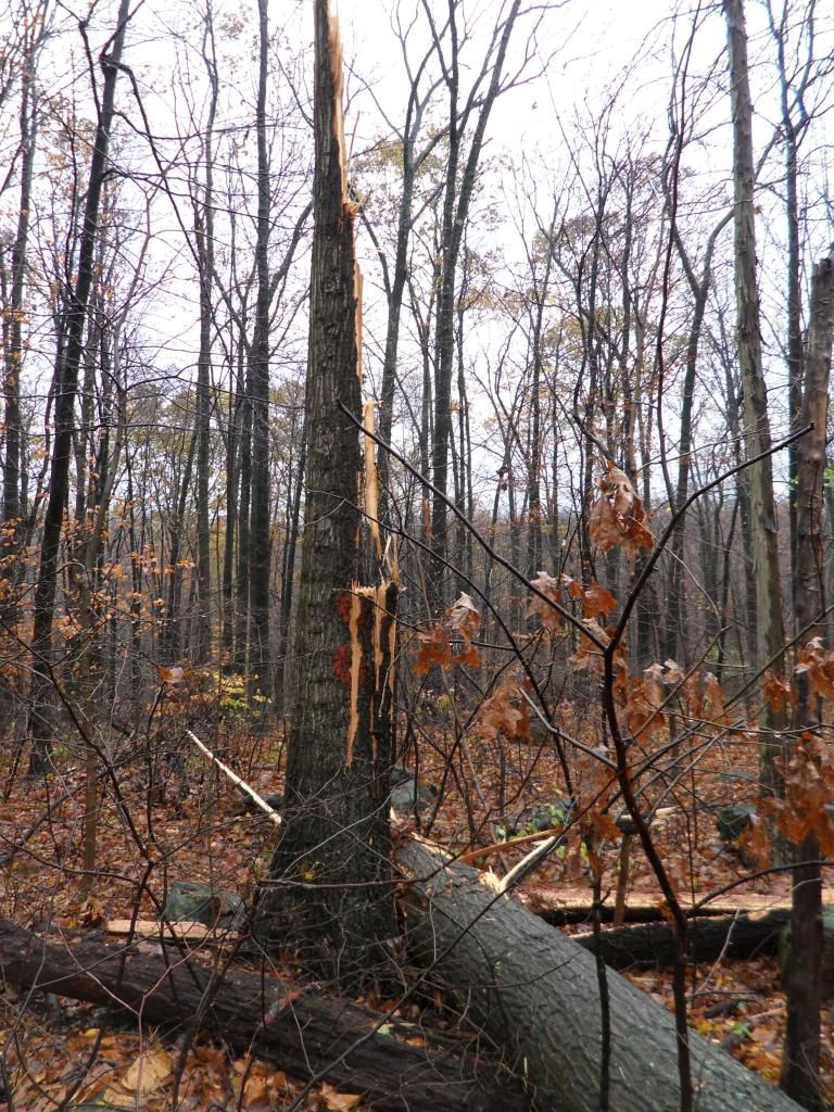

Another 100 year old oak taken out by Sandy:
Another broken oak.  The double red dot means the loggers wanted to take it cause it was worth some money. I told them to fuck off cause I liked it.  Go figure it falls over less than a year later.
