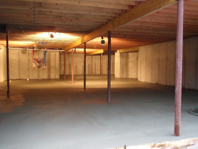

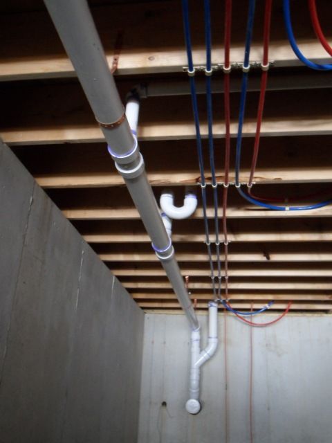

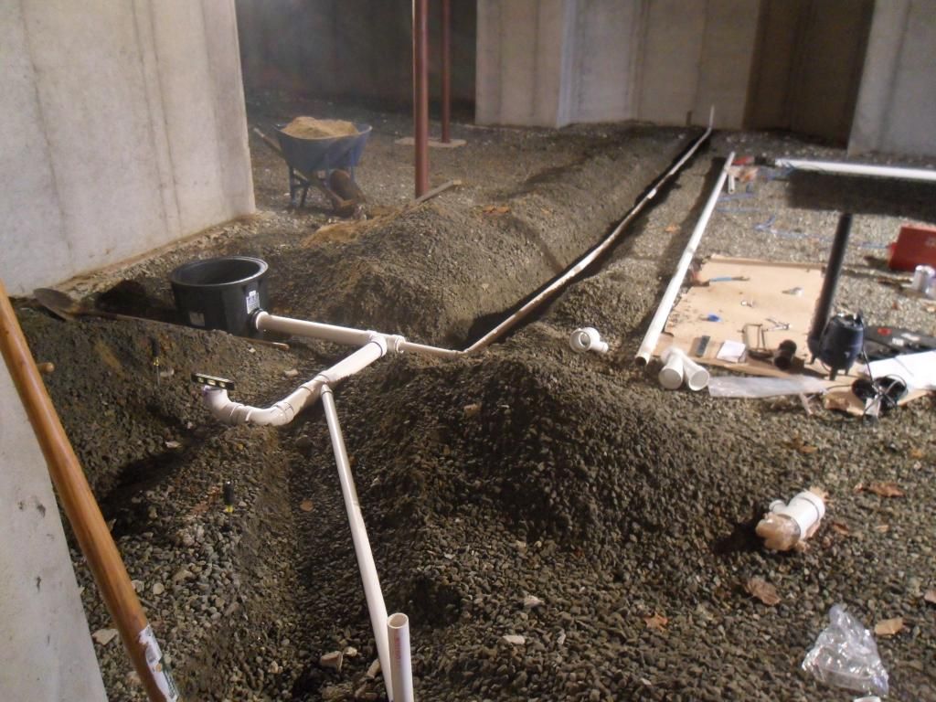

Started on the plumbing.  Decided to have some running water in the basement so had to rough that in before we pour the concrete.  Buried a crock and ran the drains in the floor for a full bath in the basement and a drain for a sink at the bar.  I was only going to put a half bath in but if I rough in for the shower it costs me basically nothing right now and at least it'll be there if I want to use it
View from from the walkout side of the basement, its been foggy as hell all weekend looked cool:

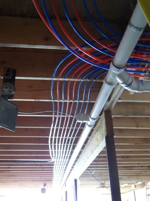

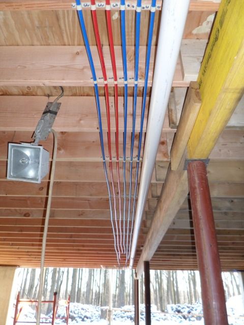

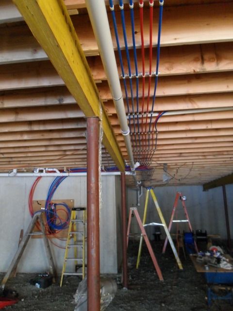

Still working on the plumbing all the drains are in and running the hot and cold lines:
I don't know who said this PEX tubing is faster than copper cause there are a ton of lines to run.  Still not done so they'll be run neater once I get them all tied up:
Its been like 10 degrees outside so working with this stuff is a bitch cause it doesn't want to bend.  Maybe tomorrow I can start tying into the manifold

That's a Shit ton of pex. But it's way less than the cost of copper.
Pex would be real cheap if you plumbed like copper but used pex instead.  2 3/4" lines and branch off that.  If you run home runs to everything, with the price of the fittings its not a ton of savings.
« Reply #97 on: January 28, 2013, 09:12:26 PM »
And its a pain if you need to t into something ib the future, unless you have Yeh tools. I have pex in my house and its all fine and dandy untill I went to plumb a sink int my garage, and fittings are like omg expensive.

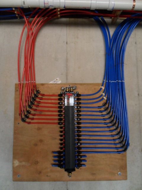

Tied in all the plumbing into the manifold

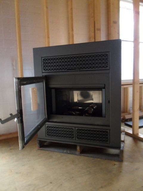

Also bought another fireplace.  Its an EPA rated fireplace that doesn't need masonary.  It'll save some time and money since I can just frame around it with 2x4's.  I'm putting the other insert in the basement

Hey man, good looking work... That plumbing makes my OCD happy, can't wait to see how you do electrical.

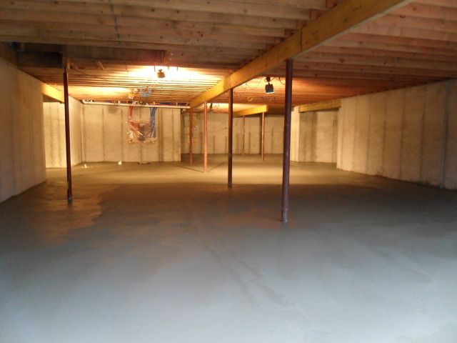

One critique or suggestion, you may want to go ahead and run a steel/engineered beam in the basement so you can do away with the majority of those steel posts. Not sure how you have the flooring layout planned in the basement and it you're going to hide those support pole in a wall or not... Personally I hate walking into a sweet as basement and seeing support poles just hanging out like a rank fart.
Anyways I like what you're doing, keep up the shiny work.

« Reply #105 on: February 05, 2013, 06:54:41 PM »
If you look at the pictures the beams are engineered lumber.  Its a 12" laminated beam.  I went with a lam beam over steel because it was easier/less weight to work with.  There's a column every 12' instead of every 8' with regular lumber.  Unless your made of money you are going to have lolli columns in the basement.  The house is 76' long so I have a total of 7 columns.  2 are getting buried in a walls, 2 are near the bar/pool table so I'm going to put a countertop/circular table around them so they will blend in like tables.  That just leaves 3 poles left...I'll paint the one chrome and put fancy lights around it for the whores with low self esteem. So that just leaves 2 poles that suck but have to be there.  If you wrap them with decorative surrounds they'll blend in as best they can but I'd rather have a large open room instead of cutting it up with a bunch of unnecessary walls
Yeah it's hard to roll a big steel beam in without $ and equipment, but you can't beat it for holding shit up. There's one spanning 1/2 of my basement (30ft) with support columns on either end that are architectural and have stone work up the sides to make them pretty. 30ft x25ft unobstructed room makes for a lot of space to fill with bar and home theater junk... Although I still have the steel support posts in the other 1/2 of the basement. I might have to steal your idea about chroming one of them for the whores.

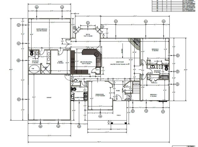

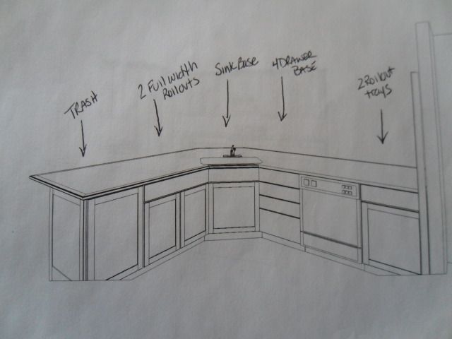

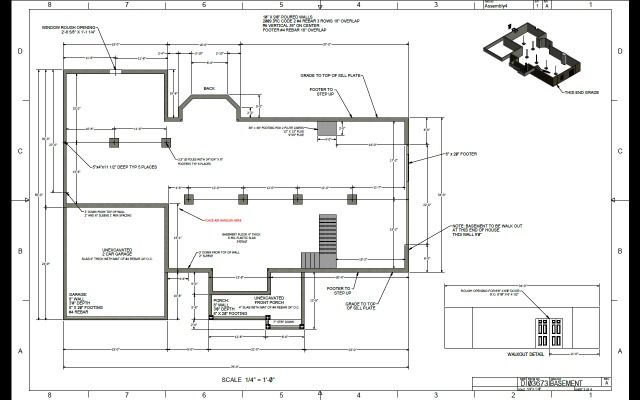

Wow, thanks for the compliments. I wasn't sure if anyone gave a shit and its nice to see my house isn't a huge fuckup so far since I'm not an architect or even in the construction business.  We just finished putting flooring down in the attic/ potential future bonus room.  I'm thinking of putting in a window now in case it does ever get finished off:
Here's pictures of the plans I drew up and we worked off of.
floorplan:
Basement:

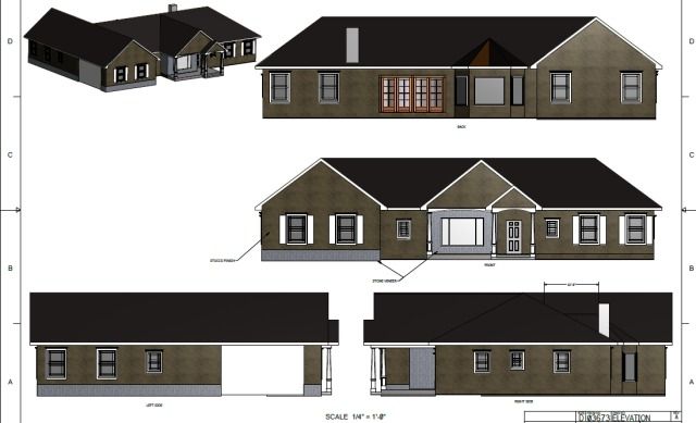

Elevation.  At first my finance' wasn't too sure about the design because she liked 2 stories and was afraid the house would look like a plain rancher.  I told her to trust me that it would look better than what it did on paper.  I was a little worried too but I think it did turn out nice and its still not finished yet.

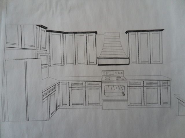

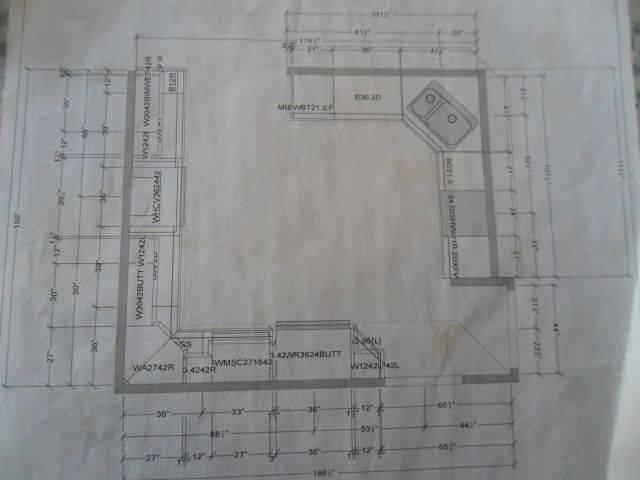

We're also working on the kitchen layout and here's what we got so far.  The cabinets are going to be a dark cherry:
Here's the island/penninsual the divides the kitchen from the great room. This picture isn't up to date cause the countertop will be on 2 levels so we can have bar stools:
That's all for now.  Anyone know about LED's instead of halogens?  Since I have bought any bulbs yet I think I may take the plunge and just do the whole house in LED's.  Even though its more money they last 5 times as long and use 1/5th of the power.  Any thoughts?

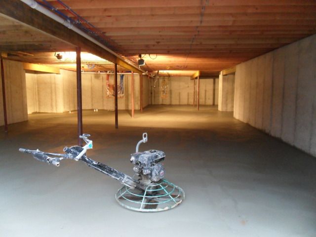

Had the slab in the basement poured today.  30+ yards of concrete.  I still need to get the garage and front porch done.  Hopefully that'll be next week.  But at least now I can frame in the wall, frame the stairs, set the air handler and start on the HVAC.
