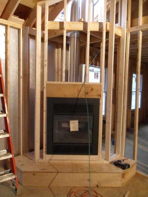

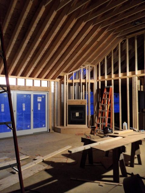

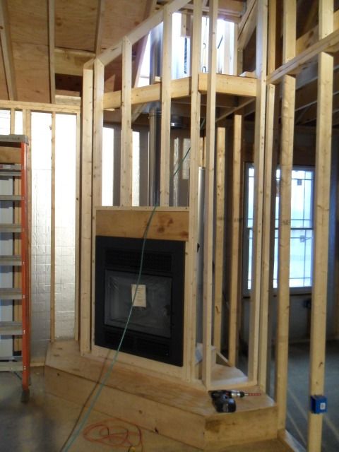

Fireplace is installed.  Used Superpro 6" class A chimney vent.  Has 304 stainless inside and out compared to other vent pipe that uses 430 stainless.  So it should outlast the house.  Ran a second flue for the basement but I don't think I'm going to build that until the building inspector is out of my hair.

Gas fireplaces are for homos:
Fireplaces today aren't like the old heatilator boxes.  Its an EPA rated fireplace.  It burns 75% efficient, up to 100,000 btu (depending on wood quality), has provisions to duct into your HVAC system, burn for 8 hours and is rated to heat 2500sqft.  These things just plain put out the heat.  Plus I liked the look and how much of the room it takes up better than a freestanding.
http://www.supremem.com/supreme_plus_zero-clearance_fireplace.php

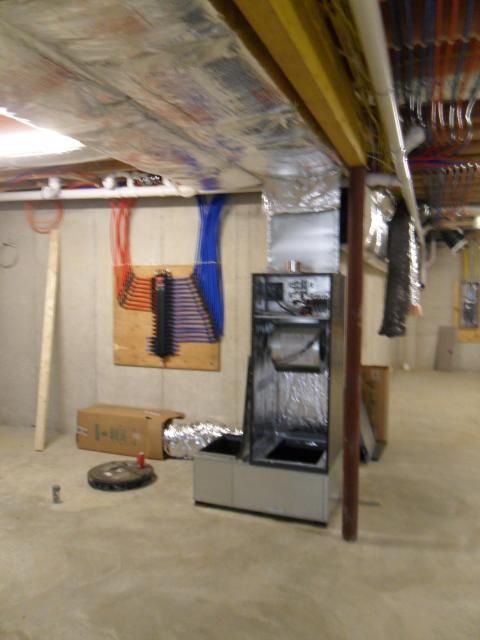

Not yet, probably another 2 or 3 months.  Starting Monday we're digging the trench to finally run the electric from the street.  That was a pain in the ass fuck you 8 month process of dealing with met-ed.  We're also digging the well next week and getting an electrical inspection.  The kitchen is comming the 23rd so I want to have insulation and drywall done.  Here's some updates:

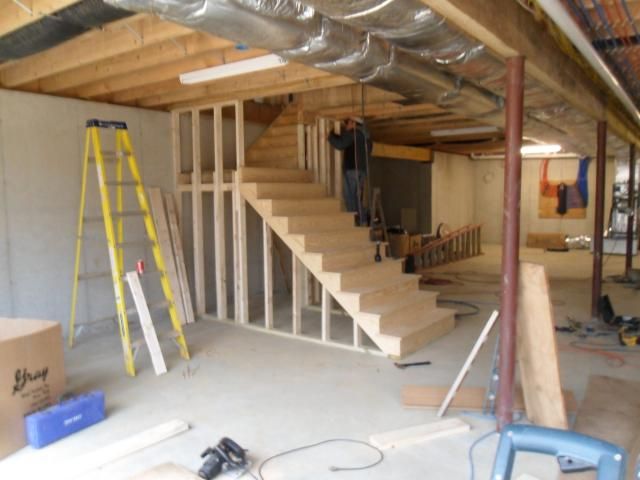

Put in the stairs for the basement:
Most of the HVAC is in.  Got a 4 ton air handler with a 3 ton compressor, electric backup heat but hopefully don't need it with the wood stoves:

basement = man cave, garage, shop?  Looks really deep past the steps.

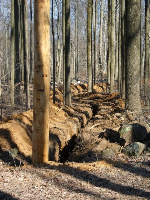

After 8 months of trying to get power I think its going to happen this week.  We dug the ditch for the power, they are supposed to run the primary tomorrow:

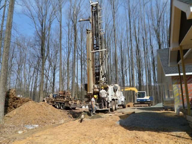

If anyone cares we drilled the well.  Was hoping to catch a break and hit water at 75 or 150ft max.  However, we had to go to 400 feet.  We hit 6gpm at 240 and 10gpm at 360.  Drilled to 400 and set the pump at 350.
All the black is the granite they hit.  This whole area is all granite boulders:

Yeah, the drillers always tell you horror stories of when they don't hit water and how much it costs.  So I'm just happy we hit water.  I've got great water pressure and at 400 feet I've got plenty of reserve so I'm happy.  I was just hoping I'd catch a break because its $10.00 a foot

If you don't have the volume you can usually put in a tank.  The well has a 6" casing that goes down 60 feet and the actual well is 4"  so the well can hold 260 gallons if it was filled to the top but realistically the water doesn't go to the top so maybe like 230gallons and that isn't including what is in the well tank and hot water heater.

$4,000 is just for the 4 inch well.  Add $15 or $20 (I forget off hand) per foot for the casing times 60 feet, plus the well pump, well tank, permits, water testing, excavation for the plumbing, ect.  It comes out to $9500 total package for the well.

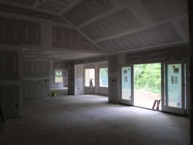

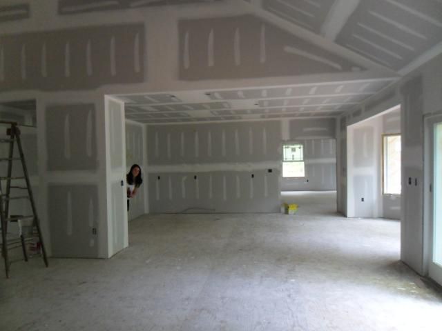

« Reply #149 on: May 10, 2013, 09:30:32 PM »

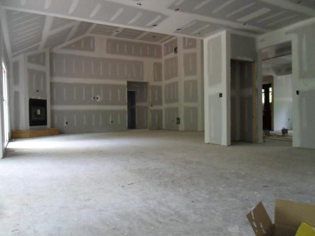

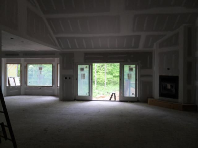

Drywall almost done.  I was away in Ohio all week but the drywallers started on Monday and are almost done.   I was nervous about the quality of work since the Mexicans started the Monday after Cinco de Mayo.
Garage:
Great room/ Kitchen
Hey Stealthmode, you'd be the man to ask.  I've got 9200 sqft of walls (including ceilings) to paint.  I estimated about 60 gallons of paint with 2 coats.  What do you think?  How much would a pro charge for a job like this?  Also, any recommendations on paints and what to do/not to do?
