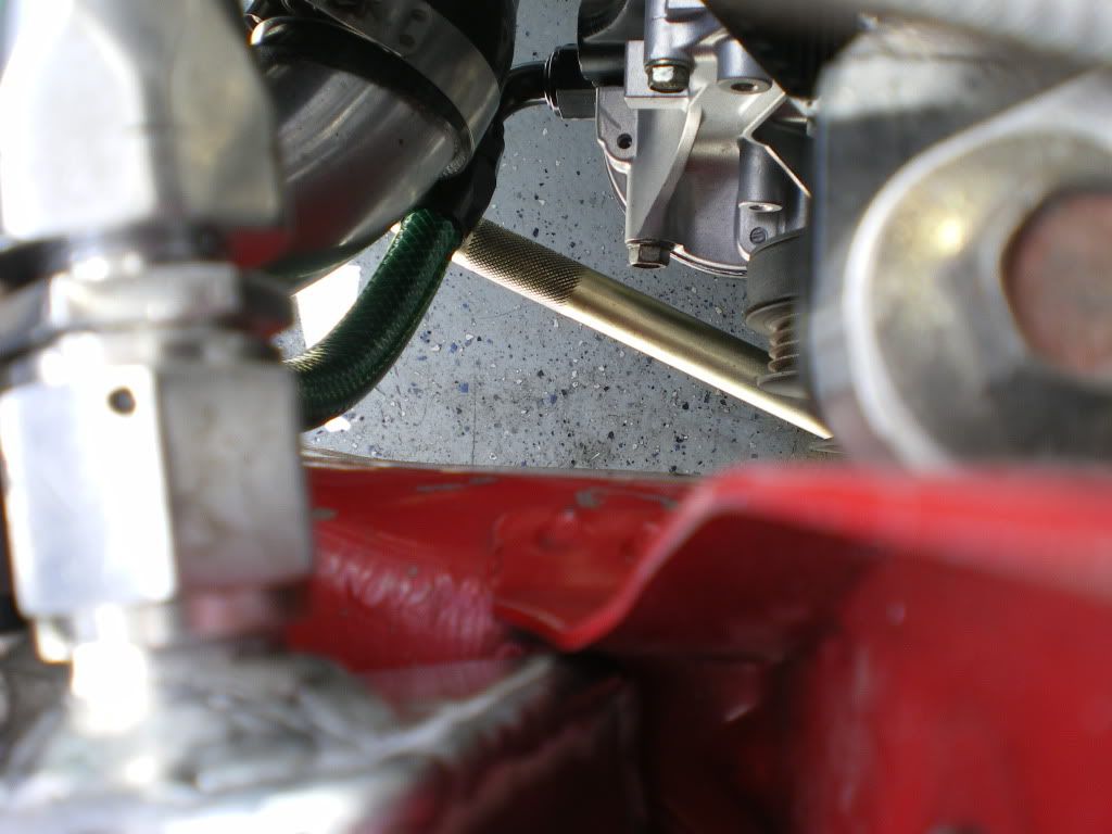

Seems to be working, Not really any leaks, but I will need to switch to some differant hose. As much as I would love to keep the garden hose. It just is way to mushy when it gets hot, and Im worryed that it will pull away from the an fittings once it gets too hot. So Malichite is gona kick me down some hoe's and all will be good.

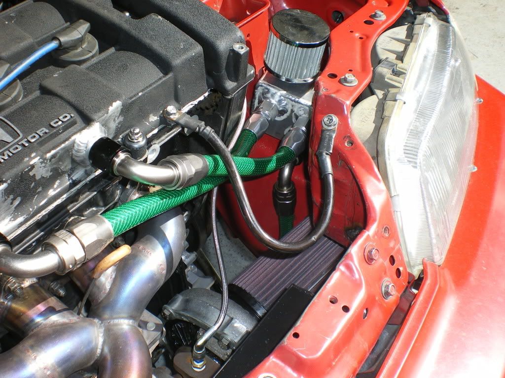

Now im gona go get a breather that looks like this and put it in place of the filter that is on my catch can

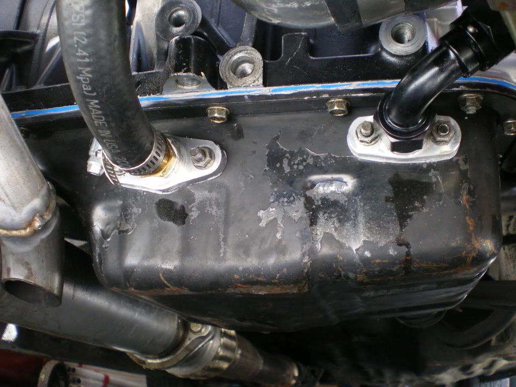

And run a hose from it down between my stearing rack and firewall so I dont puke fromt he fumes this bitch is unleashing on me when I drive. My heater is on recerc, and its still is bad.
narfdanarf
  • Posts: 341
what size fittings are those?  Since it's obviously not very much hose, I can spare some black braided -10 if you need it.
-10
2@ 12"
1@ 16"
