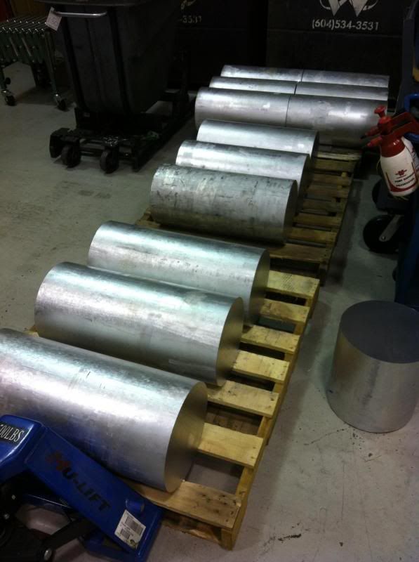

Its a different ballgame when you get into the large diameters, there is little stock available, and the there just isn't much demand for the big stuff.
They are 12' bars (at this size its usually 8'). I just looked up the quote, says $7200 for the two bars. Total weight of 3,190lbs, so about $2.25/lb. Not bad for under 2 weeks delivery. If I wanted to get some mill direct stuff from Russia and could wait a month or two I could get this size for $1.90
Pretty much all the 12" round in the USA is 8' lengths, doesn't work so good for me being that I need 24" and 26" slugs.

Ah. We have coast aluminum around here that common stocks up to 16" round. But $2.25/lb is not bad anyway.
But are they 12'ers?
What mill does the aluminum come from?
I can get 8-18" rounds in stock from my local Thyseen Krupp or Alaskan Copper and Brass but not 12'ers.
We talked to Sapa about doing a mill run of 12'ers for us, and they were willing to do it, and we would have gotten great pricing but then one of the guys on this project backed out. And iirc Sapa wanted to run 5 bars minimum. We'll do it next year.
I should mention I am only making 6 tombstones for myself right now. The other 6 are for a friend that has a smaller 5 pallet cell. Early next year I will likely do another run of 6 or so for myself, 6 or more for the same friend I am doing these for now, 10-15 for another friend, and possibly another 5-10 for a different guy. So I should get pretty good at building tombstones here pretty quick.

I can find out. Everything we get from coast has been 20 footers, including some 8" bar we ran a couple months back.

Let me know if they can get 20' 12" diameter. I don't know of any mill in the USA was pressing a diameter that large, that long. Alcoa has a press to do it but they've been so backlogged I doubt they would take a simple round profile job like that.

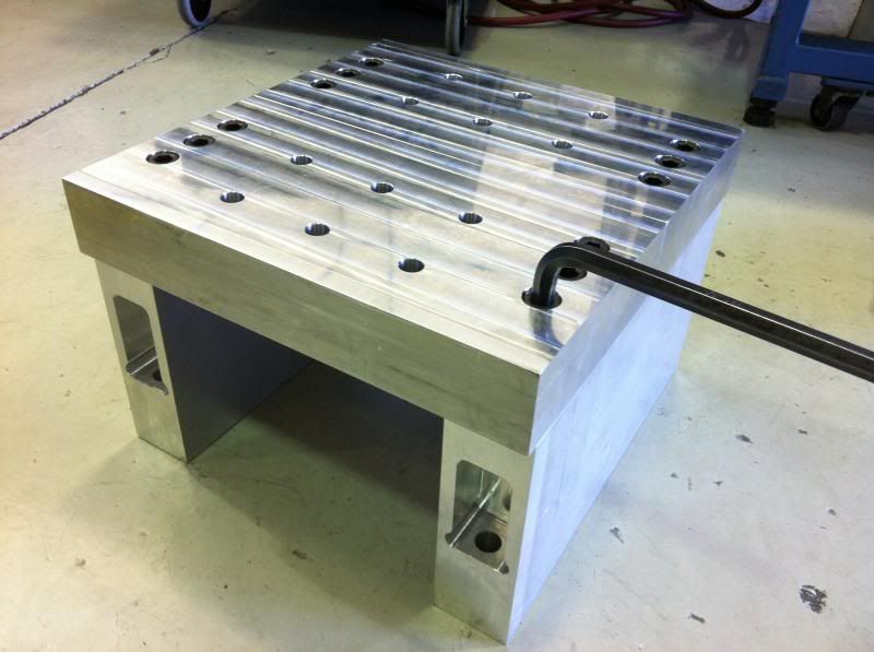

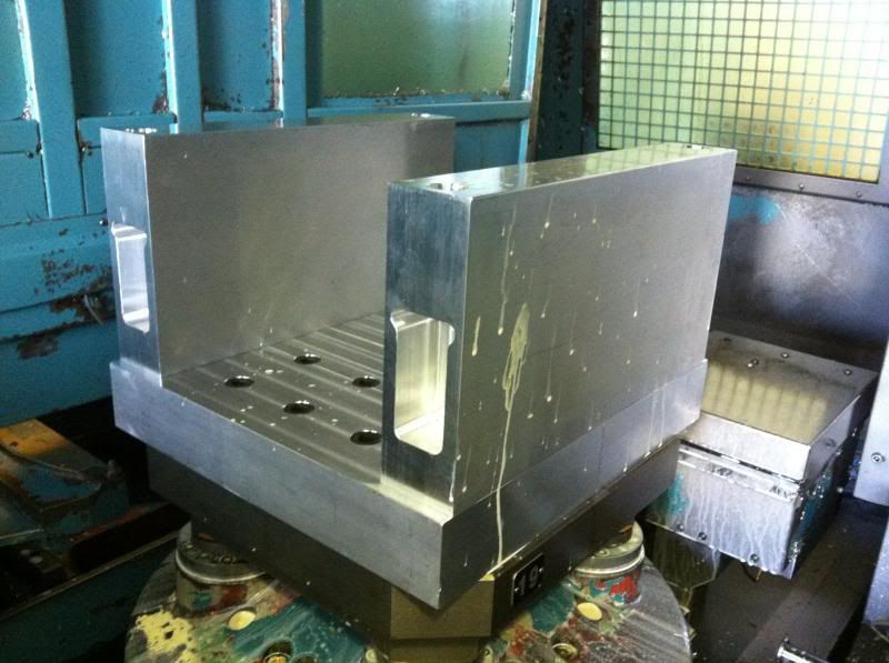

We use Mastercam for mill programming, noggincam or mazatrol for turning, and Solidworks for design.

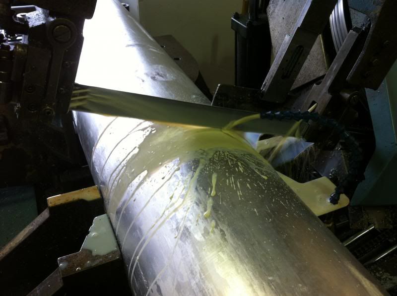

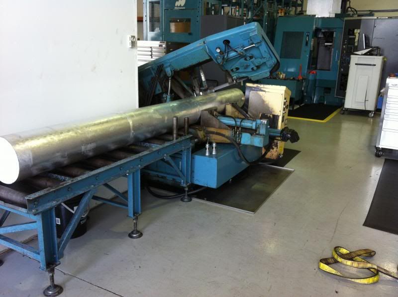

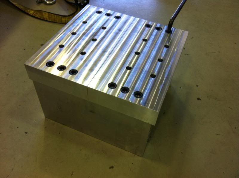

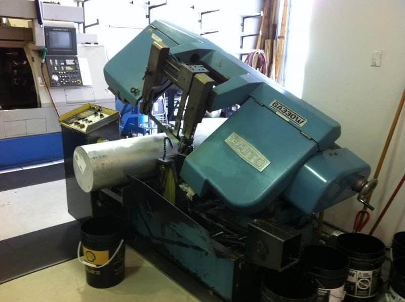

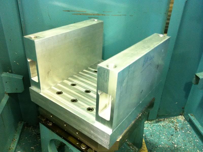

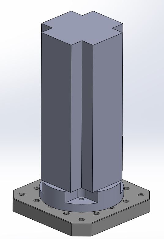

Only had a half day on Saturday to work on this project, hopefully I'll have all day this nest Saturday to spend on it.
Sawing up bars on the trusty Daito:
Here is the start of the V block cradle for doing the end work:
Here is roughly what the tombstones will look like before the subplates are mounted:

Tombstone, like a headstone at a gravesite?
Re: Todays machining project
« Reply #99 on: September 10, 2013, 01:00:51 PM »
Yeah, its the trade name for these type of fixtures.

Looks like its meant to hold 4 parts at a time for machining?
« Reply #103 on: September 10, 2013, 03:19:32 PM »
Or more, typically  you look at stuff like this as "4 parts minimum". In milling, you want to set up as many parts as possible in the machining envelope so that you can amortize rapid movements, tool changes, loading etc.
