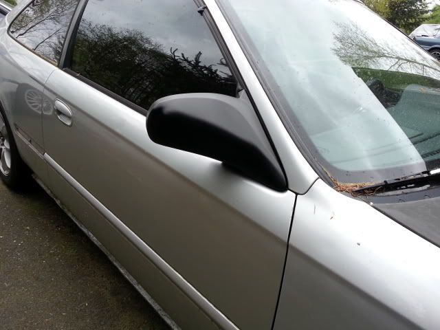

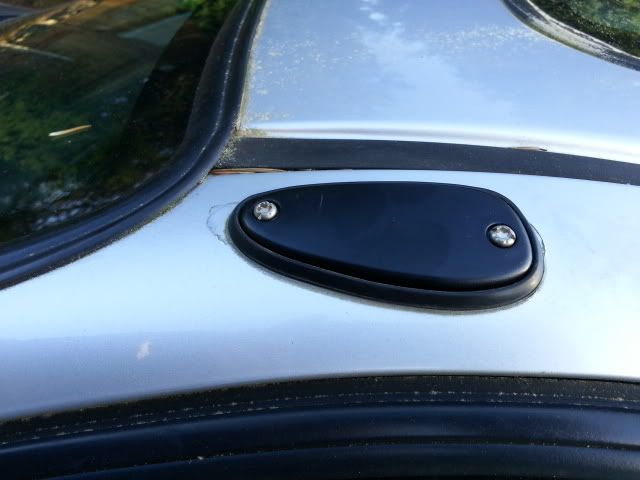

OEM antenna blockoff. i think i ordered this with the radio blockoff. and when i ripped the antenna out i noticed it was OEM, so i reused the gasket (returned the new one)  :Jew:
this was a EH2/SR3 part number btw. didnt see one for an EJ/EM1.
yes, the paint on my car is THAT SHITTY.

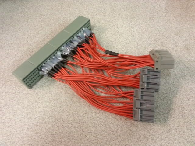

china OBD2B-OBD1 harness. i sold the one that was sitting in the car when i got it, along with engine harness... so i think make like 43bucks on that deal? lol
lol. car has been sitting for a minute.

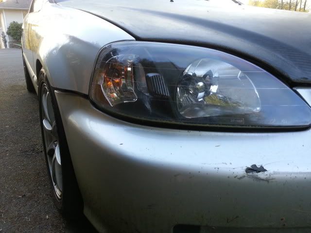

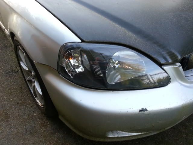

newish non-sidemarker fender. and black housing headlights im not sure about yet. i think i like them.
primed drivers fender that fits like shit.  i have the missing moldings. i broke them off for some stupid reason?

« Reply #31 on: April 25, 2013, 11:21:58 PM »
Don't like the headlights at all. Other than that. Good work..
Re: turbohf presents: RHMT PROJECT JEW EK
« Reply #32 on: April 26, 2013, 12:12:40 AM »
im torn on the headlights. they bother me forsure cuz there not OEM. but i kinda like the black housing. EK9/CTR's have a nice gunmetal/black chrome color, but are expensive as shit.
i can get some OEM ones for like 70bucks from a friend, probably jew to 50 easy....
i could also take these apart and try to paint them the gunmetal/chrome of the CTR??

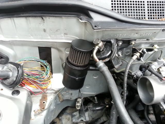

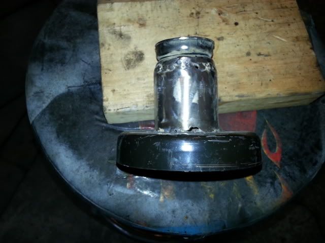

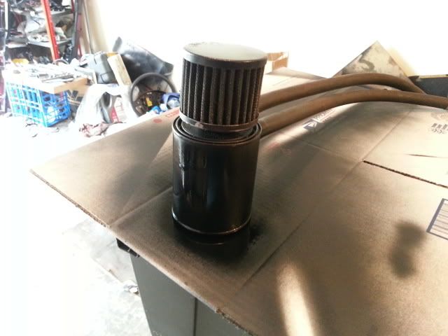

i made this for a project forever ago... i think the NA B20VTEC? yes, thats a little 1pt paint can   O0
2 5/8 nipples JB Welded into it. they go to the back of the block. into the Honda OEM block fittings.
maybe a temp mount... maybe it will be like that forever.

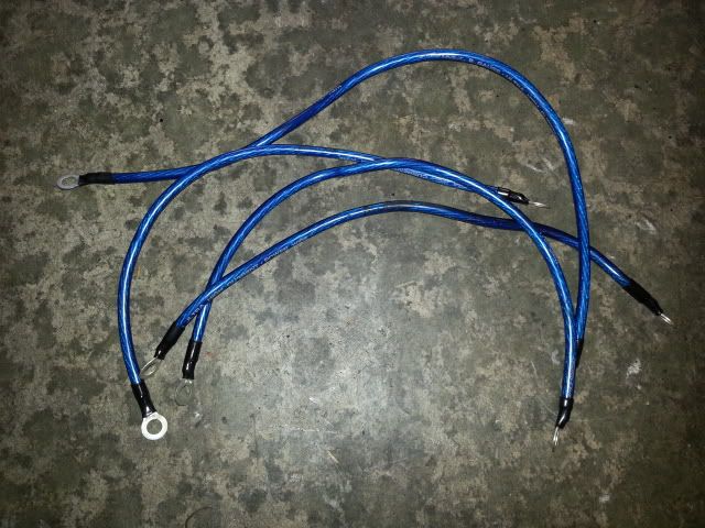

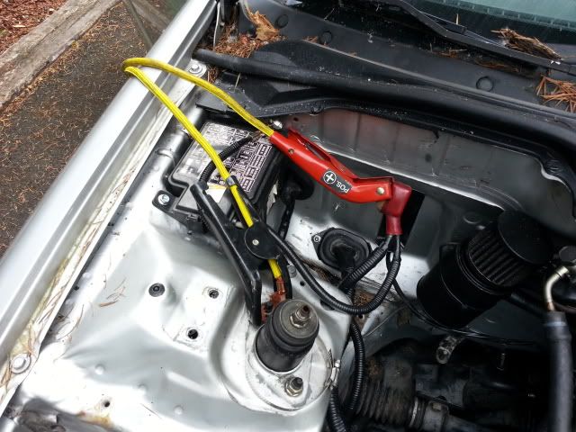

thought i needed a solid set of grounds. so i picked spots i wanted them on the car, cut to length.....then of course didnt mark them. lol
i threw out the plastic insulation on the connectors, crimped, then soldered, shrink wrapped all the wires.
they are connected as fallows:  back of VC stud to drivers shock tower, thermostat housing to passenger shock tower, shock tower (stacked on other one) to battery. (extra one went on GVR4) all sanded/clean.

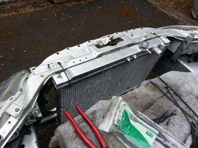

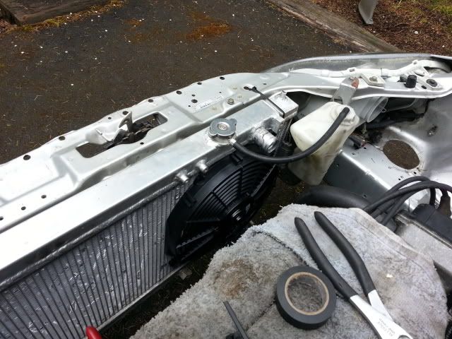

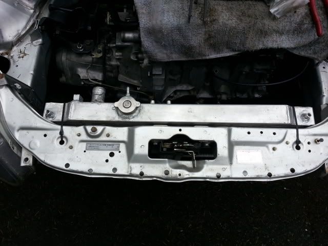

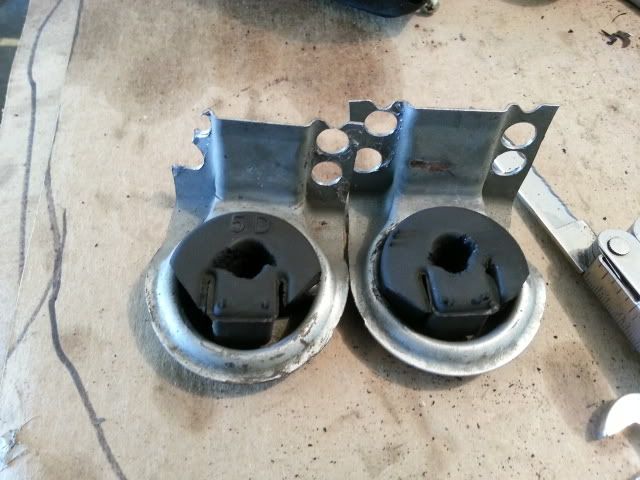

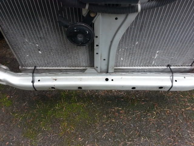

i had this great plan of some cutting and welding. some jew radiator isolators, etc...
then while test fitting i said fuckit, it fits pretty good without all this effort.

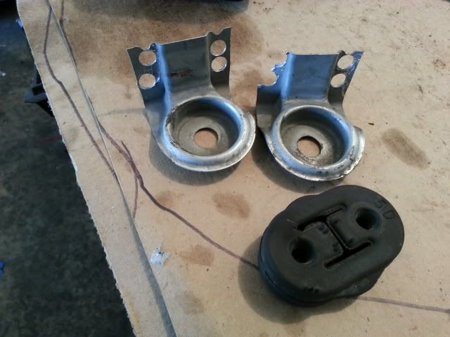

still used my exhaust hanger isolators tho. fits minty.  :noel:
oh yeah, nice $10 bnib fan, and coolant tank. wired it in also.

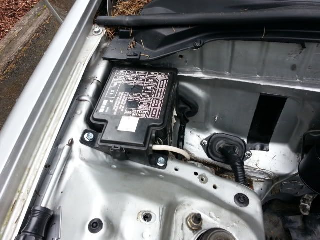

so this thing was half ass wire tucked when i got it. fuse box was just like hanging under the dash.
i had to pull the heater blower to get the wires back threw the firewall. bitch. actually once i pulled it everything was easy. and i got to empty all the cool pine needles/seads shit out of the blower box.

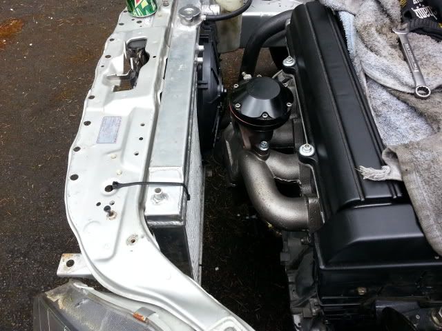

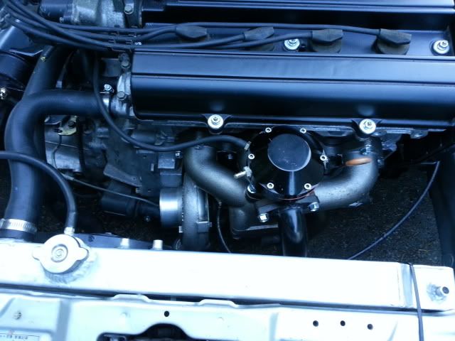

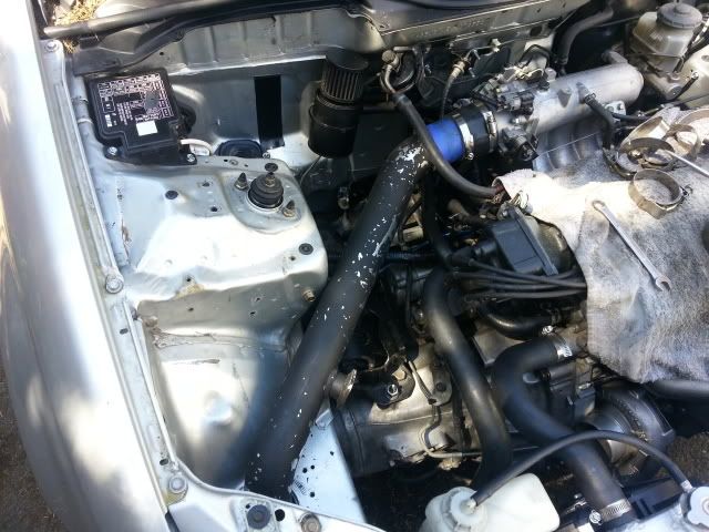

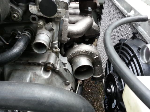

a little turbo test fitting.

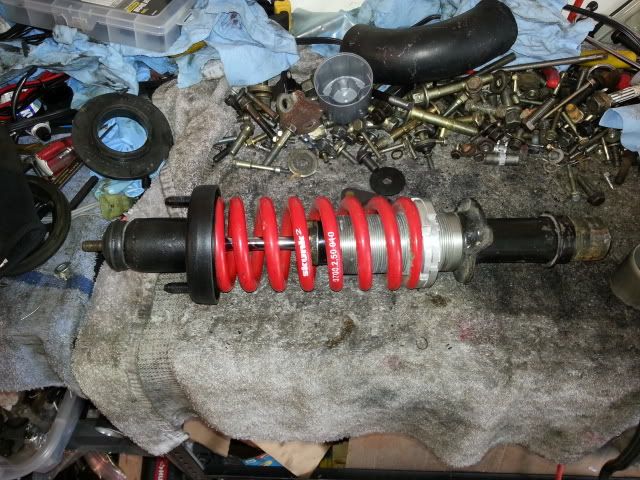

little work tonight. i put the axles in. and eyeballed the alignment. it was SUPER toe'd in from the crossmember swap.
tooks some pics of what im working with...

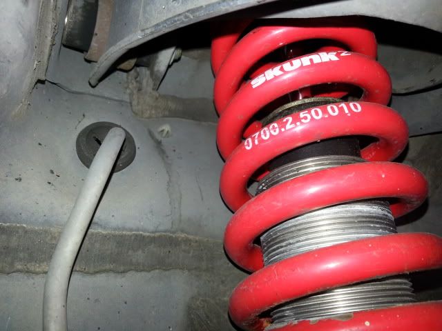

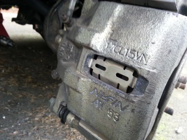

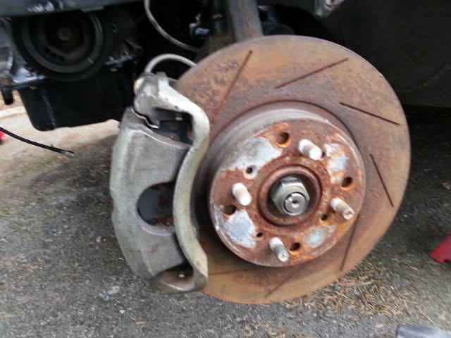

ITR calipers? and SS braided lines.
redrilled Prelude slotted rotors?
Slank9 springs on sleeves
still gonna pull the suspension off and extend the top hats all the way around. and lower it another inch or so.
 :Jew:

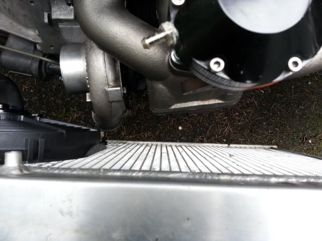

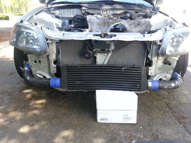

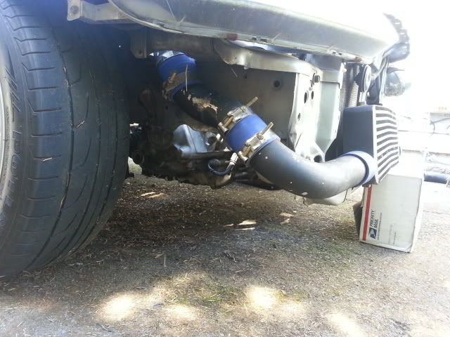

all still test fits obviously. ill strip down or maybe jsut repaint all the pipes and shit when its done.
i made a couple little brackets to hold the intercooler up so the bumper would go on without much trouble. still need to finish the hot pipe off the compressor. its being a bitch with the pipes i have. gonna hit up the auto parts store for some 2.0" and a reducer from 2.5.
 :Jew:

Is that integra radiator?   :noel:
« Reply #38 on: May 04, 2013, 05:36:13 PM »
yes. 94-01 Integra

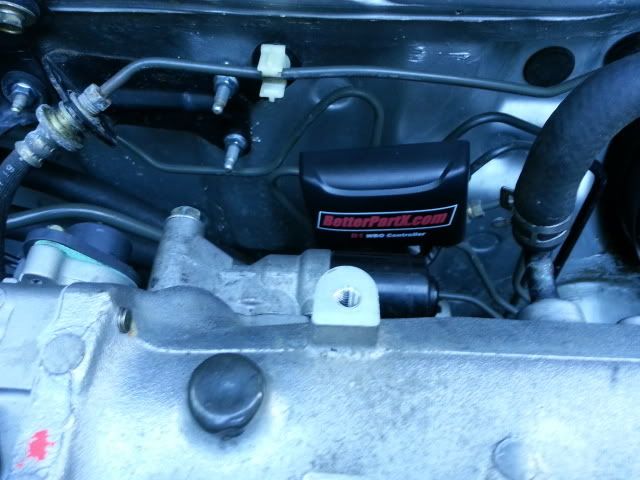

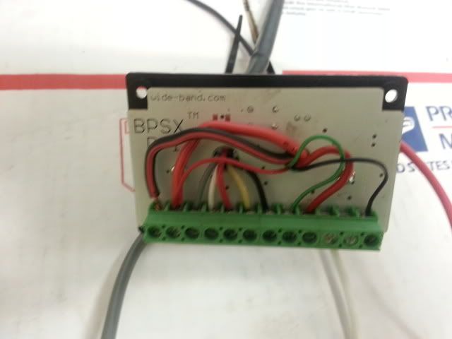

so i bought this BPSX wideband setup being talked about in the engine management forum. its like $99 shipped off ebay...
some assembly required.  ::)  comes with a NUT for an O2 bung. i always hate that. but i have 2 O2's in my downpipe already, so no big deal. you need to cut the plug off the wideband sensor and hardwire it to the box. when i was doing it i thought to myself its gonna be annoying when i screw the O2 into the downpipe. so i might add a connector inline.
has a little display board, no case on it. again no connector inline so its hardwired to board. its the size of a quarter.
didnt come with harness for power/ground or analog wire to ECU for logging. so had to find that myself.
more on this later. still have some work to do before i test this fucker. like getting a battery tray and battery...

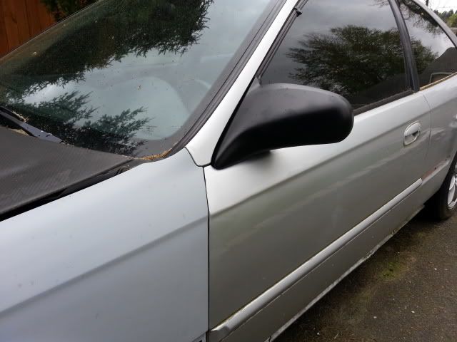

visual progress:

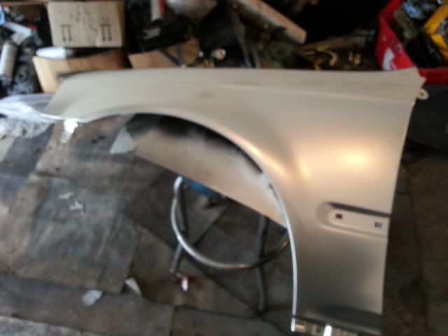

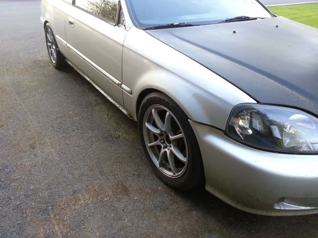

drivers fender looked like ass. all primered up. actually, probably one of the best painted panels on the car...and thats sad. but didnt match.
cock. only pic i took, and its blurry.  :-\  anyway. testing showed that the color is close. and this doesnt look to bad.
no joke, thats the shit i used. someone told me they used this before on a VSM color hatch. my hardware store didnt have the other shit that internets say would match.... no touchup in spray for my car.
gonna try to wet sand this a little and clear it. good enough for now...

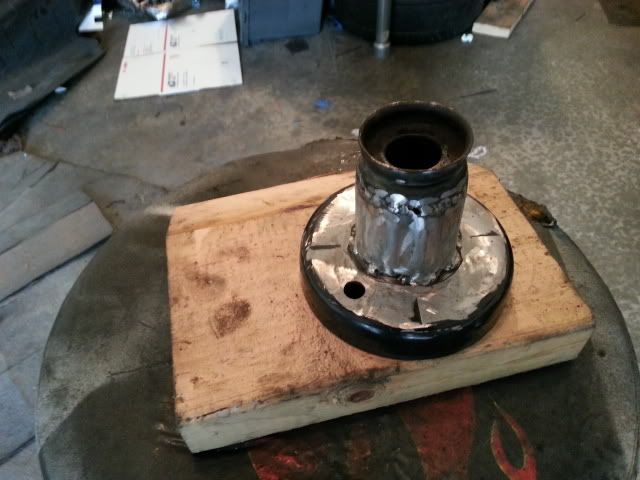

EXTENDED HATS!
4 fuckin pics. this is the best one. phone doesnt like garage light.
little over 1.5"
wont go into how to do this 100%. not a witeup. plenty of those out there for this. over 1.5" and the shock hits the hood structure...drill a hole.  O0
i had some Grround-Control upper spring seats hanging around. threw those in the new 'turbohf extended' hats  ;)  my bump stops where already hacked. so i found some extra tophat bushings to stack in there.
looks solid.   :Jew:
hopefully it rides better than my homie says it did before... but i doubt it. im offsetting this by going another 1-2" lower than he was. same car/suspension/wheels lol... just doing it better.  :-*

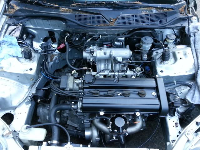

did a fair amount of small shit today.
put extended studs in the head for the spacer/manifold combo..... actually i dont think i have mentioned that in this build? to clear the larger T04 cover i cut the webbing on the block and stuck a extra head flange between the manifold and head to space it out some more. i did this on my ITR/CRX also.
anyway i got some longer studs from work (Genuine Honda...power equipment part lol). then bolted everything down for final fit.
oh yeah, tweeked the shit out of the dipstick. it sucks. it might be hitting the oil drain on the inside of the pan? its got 4qt in it and its at the top dot. so fuckit.
worked on fender some more. still looks like shit. i think im just gonna give up and throw it on. rest of the car needs paint anyway.
calibrated the BPSX wideband...i think? then installed it into the car.

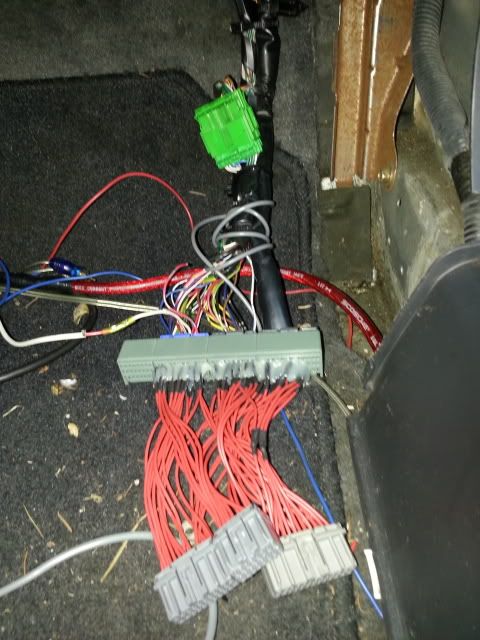

also cleaned up the ECU harness on the inside of the car. and swapped the IACV wires (non-VTEC AT harness originally) and plugged in my jumper (hard shit right there).

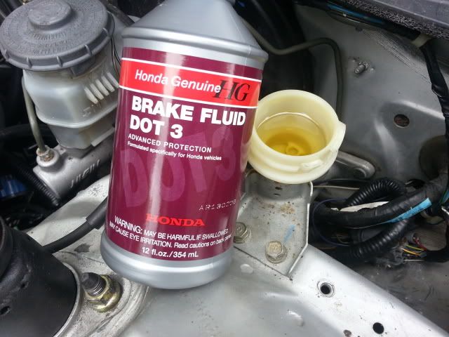

cleaned out CMC tank and bled clutch. a while later i was in the car and pushed in the clutch with left foot...seemed soft for a HD PP...  :-\
lol. yes i used Honda Genuine brake fluid.  :-*

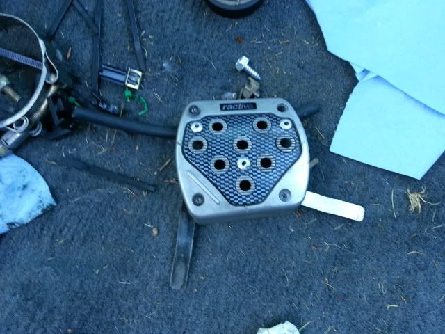

took off those qweer reactive carbon fiber lookin pedal cover things. omg. why do people even bother?
the OEM rubber pads under them got a little worked. ill order some new ones on tuesday.

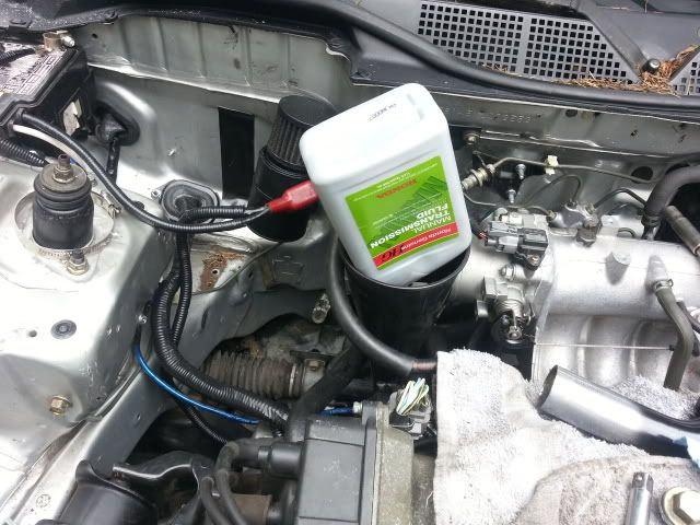

pulled the tranny drain plug to make sure there was no more fluid, little came out, and i didnt like the way it looked. so flushed some random 5w30 (i dont use 5w30 in anything) that was hanging around threw it. put new washer on the drain...
i fill threw the VSS with this long ass funnel... Honda Genuine MTF or course.
also filled her with 4qts of some Mobil 10w30 (non-syth). and coolant (random used shit found in garage lol) took like 2gallons! radiator is huge..

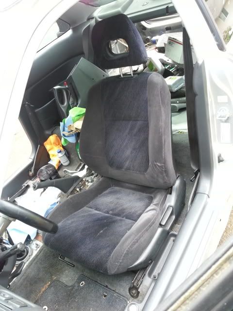

i HATE 96-00 Civic seats..... i have 2 minty gray front seats forsale btw. mad cheap/trade for something
i got this DC4 dark gray seat for....FREE  :Jew:  fucker sold his car before he got a second race seat to give me the passenger side tho... so i still need another lol.
how it looks right now...
i need a battery and mounting tray for it... other than that and an exhaust? its pretty much ready to fire off.

ok... so had some issues.
i didnt read the BPSX D1 Wideband instructions right and had a couple wires swapped.

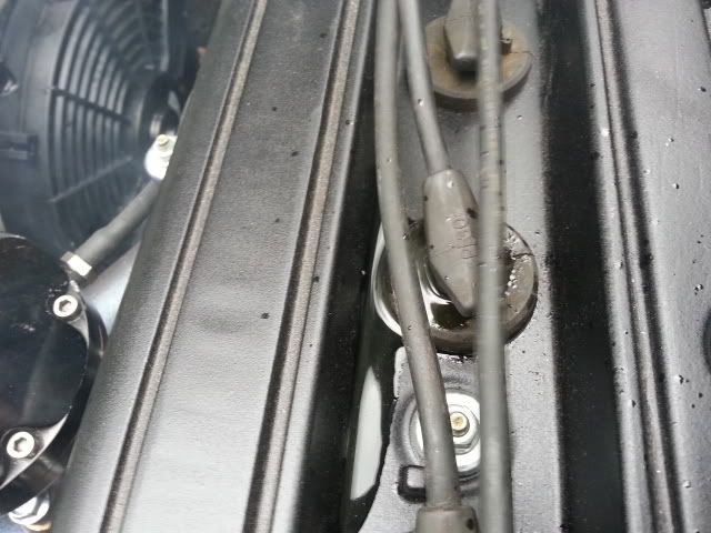

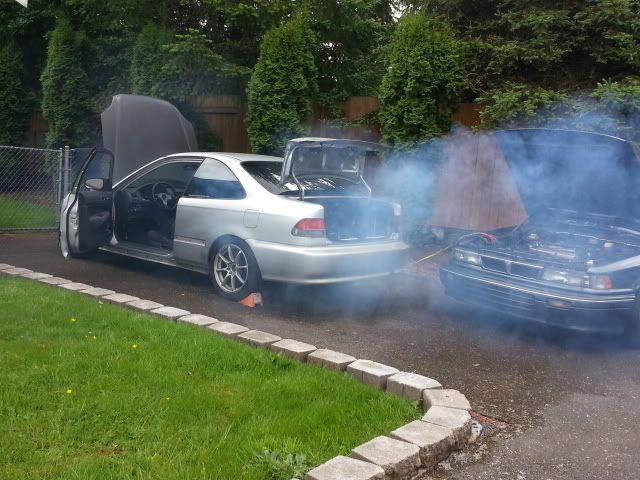

fuckin spark plug tube seal fell out the cover when installing it?!?! filled the plug hole till it shot out the breather hole in the wire.  :-\  found the seal hanging out in the head. managed not to get stuck in a rocker/cam, so thats a bonus?
this was cool.

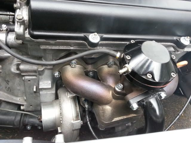

i have seen headers change color on first startup, but not a cast manifold?  :mexi:
oh....
runs champ....   ::)

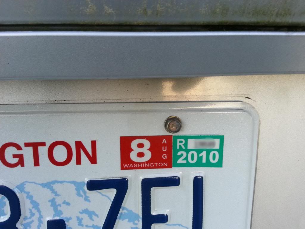

no battery/tray. and tags are 3years old.  :-X
« Reply #49 on: May 28, 2013, 12:30:02 PM »
Mine are only 30 years old....
