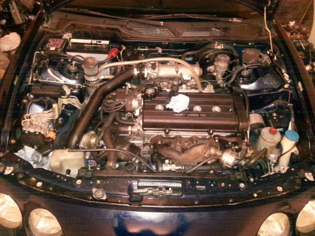

ok. little update.

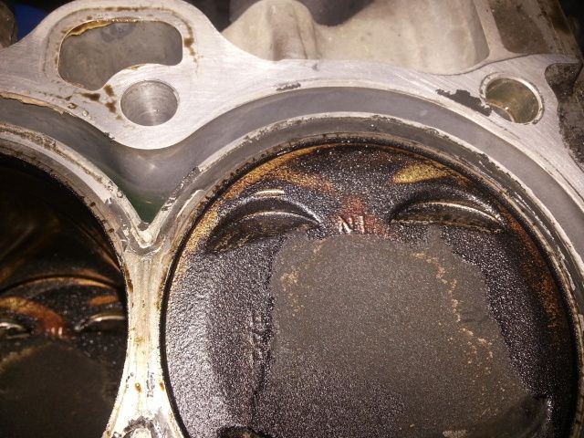

did i mention it was pushing air into the coolant? cuz it was. replaced the headgasket, fresh surface on the head for good measure. all seems good. had a cam plug leak, but easy fix.
im thinking that when it was hot (when it was pushing air) it was loosing compression and making hard starts? havent noticed an issue. but its pretty lean on starts i think now. still some more fine tuning needed.
also. it is fuckin loud on WOT 3rd gear pulls. 2nd gear just gets a revlimiter. 3rd struggles for traction (even with LSD) and is just loud when the wastegate cracks open... ehh. whatever. its nice when not WOT.

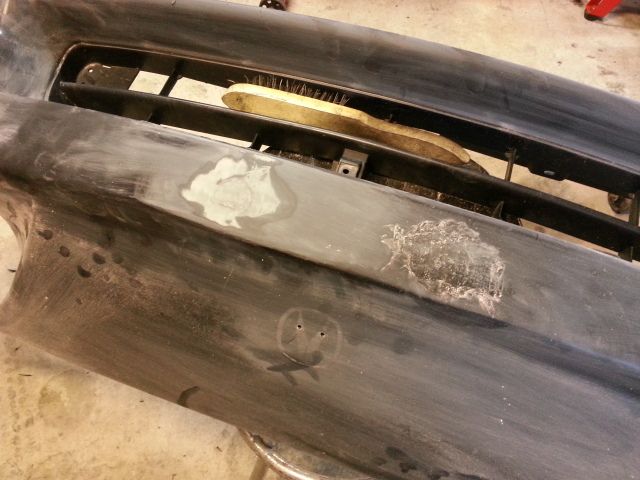

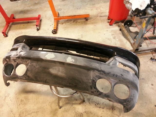

bumper was fucked up when i got the car, had tagged a trailer hitch or something. plus it had that fake junk ass moogen lip on it. so i picked up a fresh OEM bumper, and OEM ITR lip...
decided that since someone had buggered up the licence plate holes that it was time to full fill a dream of mine and fill/shave them off.... i dont run front plates, dont care what the cops think.
pic of it all mounted up...
yeah.. whatever i guess. but that shit kinda bothered me....

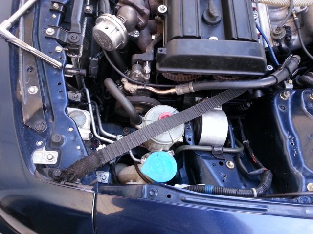

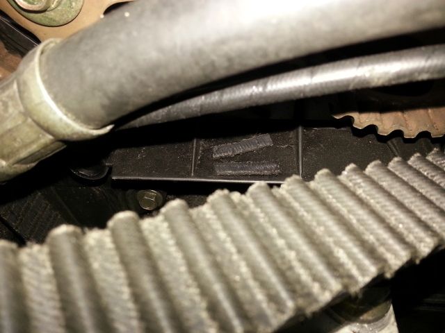

car kinda hiccups, maybe a fart, tach starts to bounce around... think maybe its ok, like ignitor or something for a second, then of course my mind shoots to the "fuck me it just broke a timing belt" routine.... i slide across 3-4 lanes of traffic (pretty legit actually) and rail the brakes to get a nice spot on the shoulder... notice it seems to be leaking something... let it do it for a min, give it a push, seems to be coolant?
i give it a couple cranks (i know) and she just zings... no compression at all... FUCK...
make some calls. end up getting a tow home.

That head have stock valves?
Either way I'd slap a belt on and see if it has compression before I dug in but I'm lazy
Especially if you're selling it
I would do the same. Slap a belt on (after seeing if the water pump will spin) and take it for a spin.
after seeing the coolant, i was thinking water pump failure.... but didnt actually bother to give it a spin.
also it appeared that the water was dripping down the back of the block behind the alternator... so probably water tube o-ring? i dont remember where the bleed hole is for the water pump...

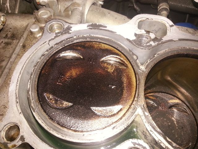

any marks on the pistons? guess its not really possible to look through the spark plugs and see the whole piston top

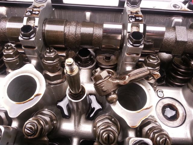

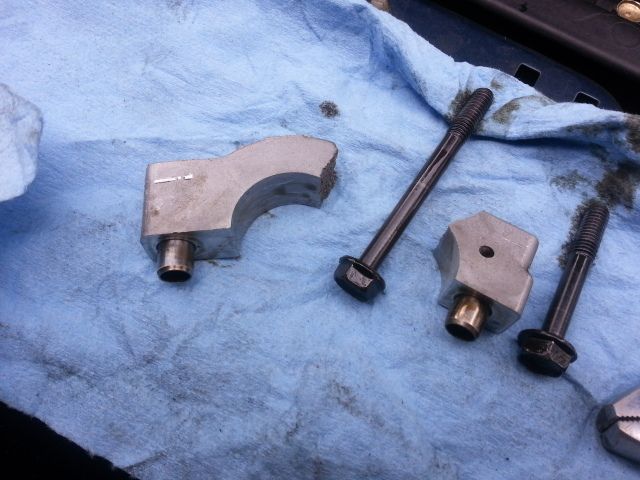

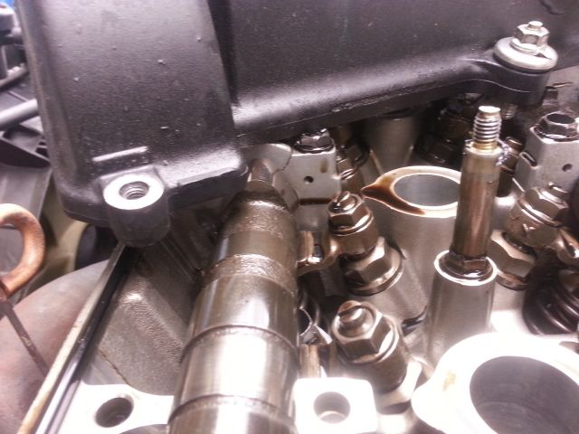

dont use a breaker bar to remove cams LOL.

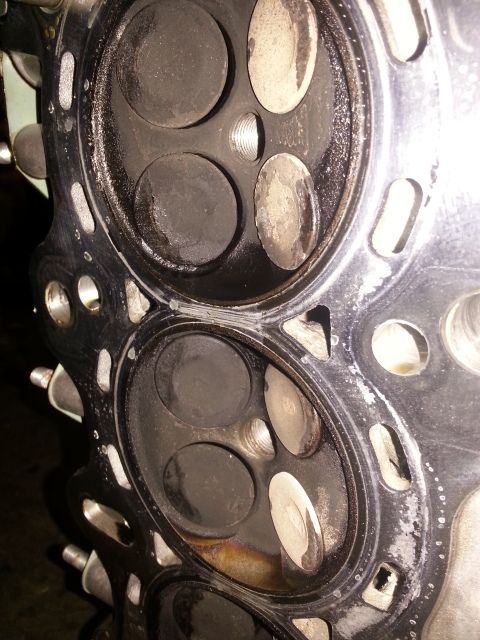

decided that if i had lots of valve lash there would be bent valves...
so, i think the valves MIGHT be bent when you can remove the rockers with the cams installed.

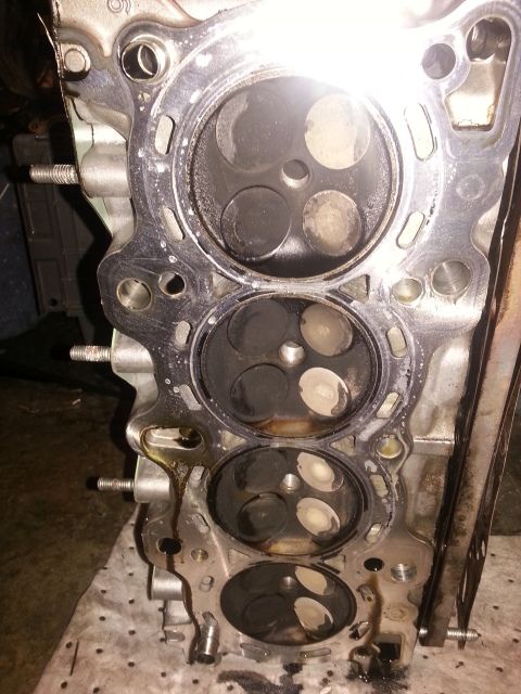

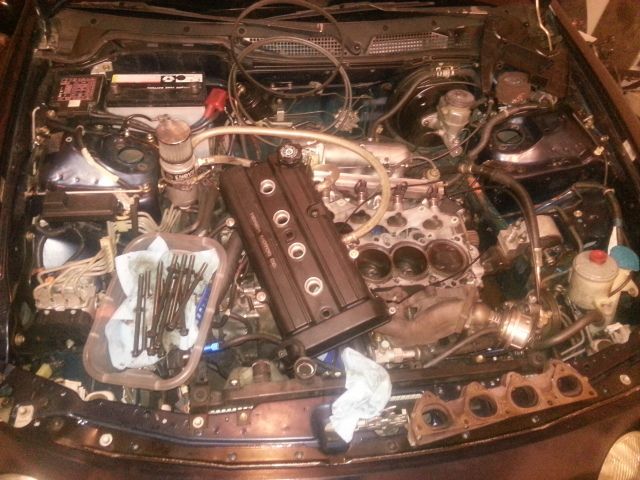

i pulled the head:

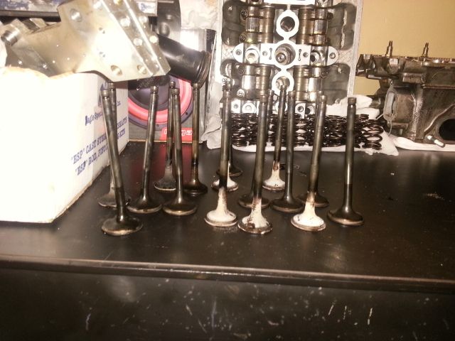

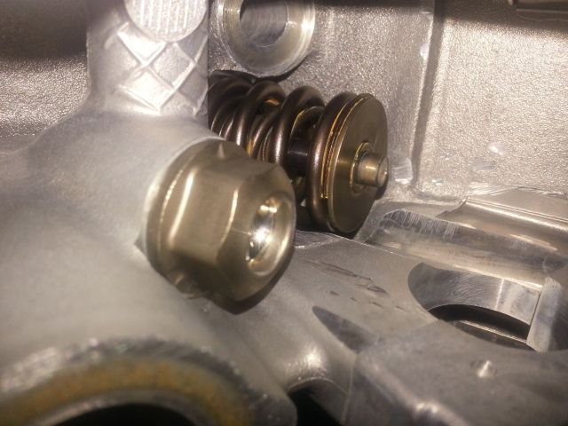

pulled my BC valve springs.... WHAT A BITCH!. way more difficult when there has been valve contact. just pounds the locks into the retainers.
i think i have a couple bent valves...  ::)

Are the valve guides and seats ok with those bent valves?  :?: :?: :?:
i only took a quick look, but the guides didnt look cracked.... but i wont be using that head, i have a fresh one.

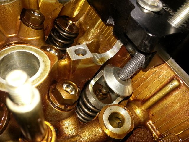

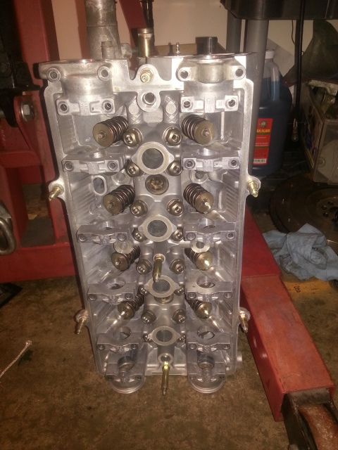

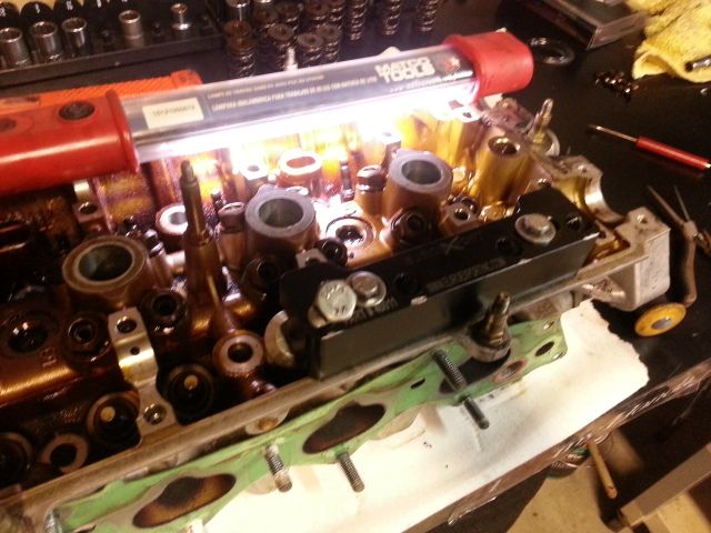

i swiped a head from buddy a while back. got it cleaned in parts washer and shit. swapped the springs in it finally this weekend...  CANT FIND THE FUCKIN CAPS!... so i stole a different head from his pile of shit, swapped all the springs again, cleaned it all up.
so this tool is pretty cool. suggest it for anyone.... hell ill sell this one, dont want to do this shit anymore lol.
all cleaned up, and Brian Crower springs installed.
sad mess.

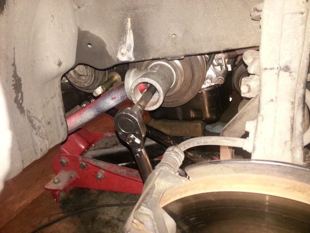

i ever show off my crank pulley tool?

i think its a keeper. you can usually find something online for cheap.
Fuck I think orilly sells it for dirt. I know they rent it for free.
I remove the crank bolt with a 900ft-lbs impact that I paid 99$ brand new. Best fucking tool I've ever bought.
Crank bolts and axle nut and a joke to remove now.
There I found the link: https://buytools.ca/eng/1-2-inch-impact-wrench-900-foot-lbs-bw2860-2566.html
No heat and no pain. And you cannot forget your ratchet on the bolt while starting the engine... Ask me how I know...
