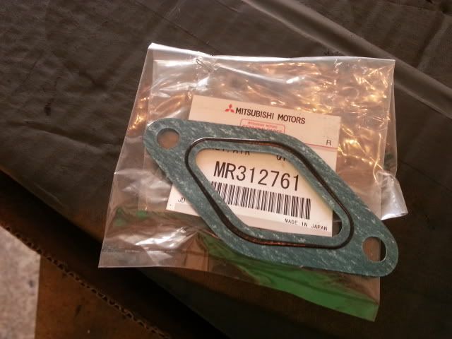

i found that gasket btw
if anyone needs the part number

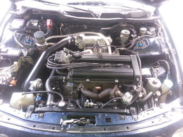

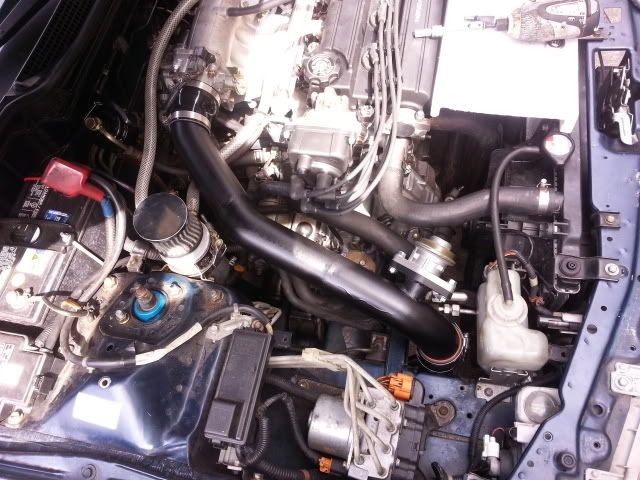

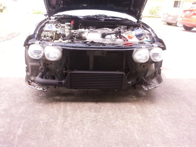

always hard to get a picture of a flat black anything. lol.  O0
chargepipe is still a little wet. i like the way it turned out though. i thought i was gonna have to get ghetto with some cuts to get it where i wanted, but turned out pretty easy.
not the first choice for BOV placement either. but wanted to make sure i had hood clearance.

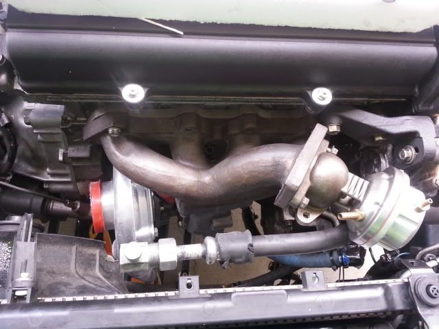

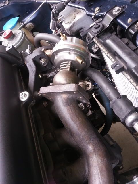

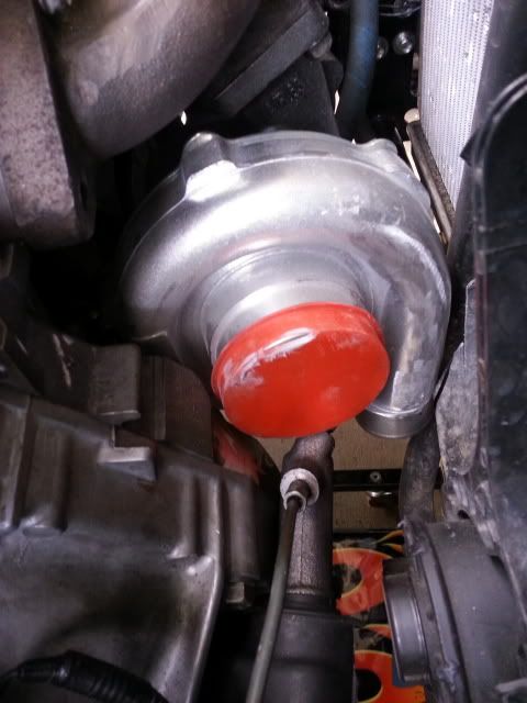

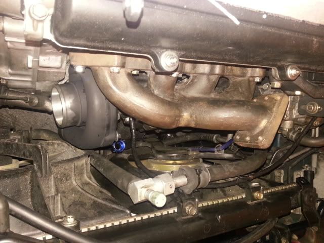

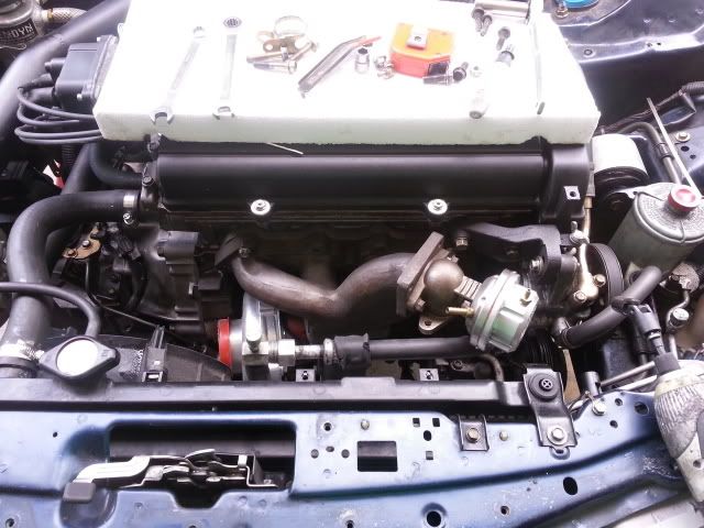

first fitting of turbo shit on the car.

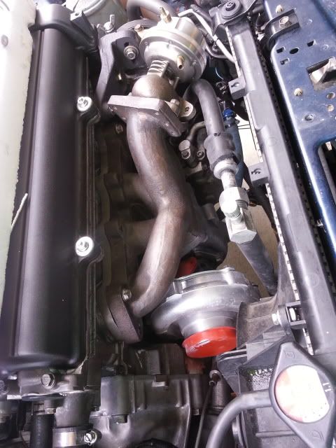

oh yeah. so i havent posted this shit yet.

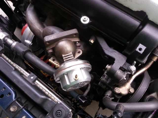

manifold: $50 from a buddy. he said he got it clearance sale from XS Engineering? idk. whatever. its a cast manifold for T3 turbo and tial 35/38 and tial 40 it looks like?
turbo: $217 GSP 57trim wannabe strait from china... i took the angle grinder to it and removed the GSP/tags/etc off it the best i could. i picked this turbo cuz it measured slightly larger than the one that was on the EK.... oh and of course  :Jew:
wastegate: $50  :Jew: Turbonetics Evolution 35/38mm... buddy had this thing around forever, finally talked him into donating it to my project lol. i guess they started making these after they realized how shitty the deltacreepers where and how nice the TiAL units are... so this is the "evolution"?.... ok, shit was cheap, i would have run a delta creep if thats what he had...  ::)  this is suppose to be legit tho.

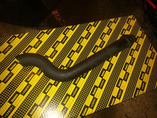

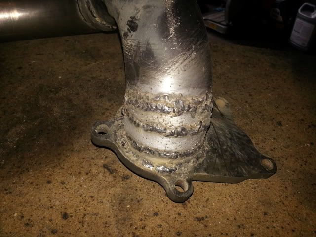

then i stopped taking pics. i got some decent downpipe fab done. got it pretty figured how i want it to go. gonna clear the AC compressor and shit.

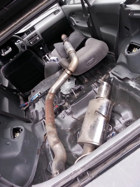

EH2 Civic has a tailgate, therefor its a truck... and with it being a truck it will haul parts, including full exhausts...
 :mexi:

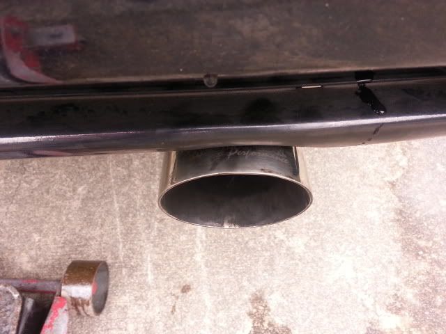

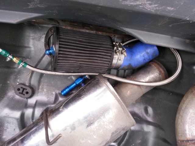

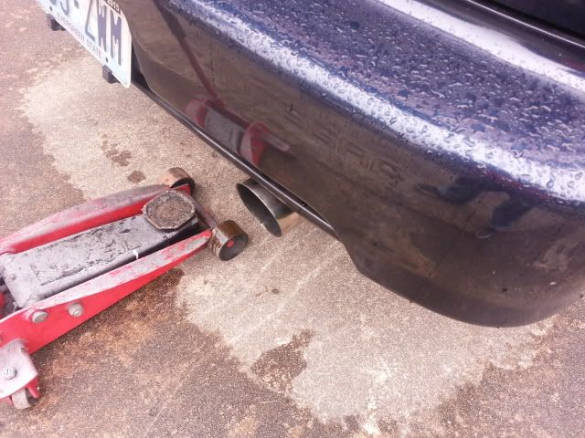

so full 3" exhaust with little cat, big resonator. and V-banded Magnaflow muffler. Hallman MBC, and a couple other random misc shit i swiped while i was at it.
put the exhaust on...well i tired. looks like the fucker is about 3" too long. so yeah. ill have to shorten it eventually, dont really give a shit at the moment. ill drive it like that.
more coming soon. now that i have my exhaust and oil drain for turbo i can finish my downpipe, make a dumptube, clean all this shit and final install....hopefully... lol.

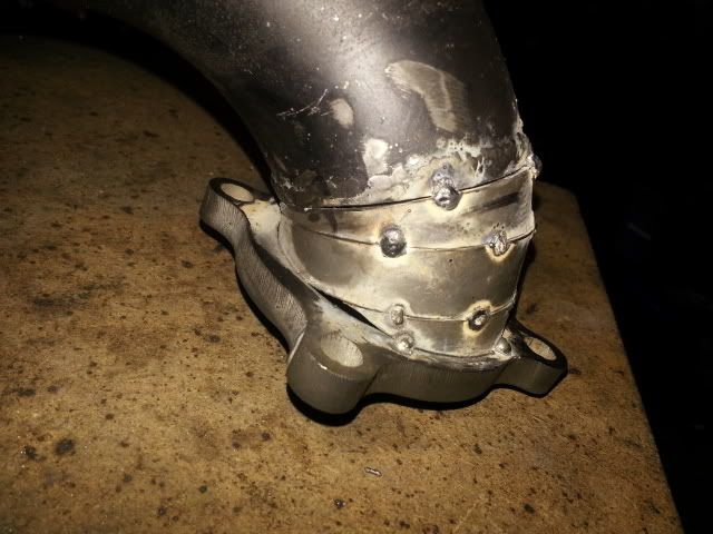

wasnt gonna touch the muffler, but the exhaust kinda needed it to be solid and not change direction everytime i tried to hook a downpipe to it.
whitey bends!
fluxed up  O0

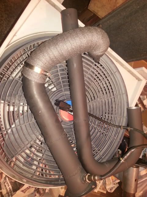

the hotside charge pipe. and the downpipe finished up, painted, and exhaust wrapped.
oh yeah, decided to paint the compressor housing. why and look, the stock AC fan tucked right in there just fine. so sweet.
thats all the pics. so yeah, final assembly is in progress.

well shit didnt go back together as well or as fast as i thought it should. had some interference issues. everything seemed to fit money individually, but when you put them all together, shits in the way  ::) ::) ::)
oh...
this turned out to be a pain in my ass.

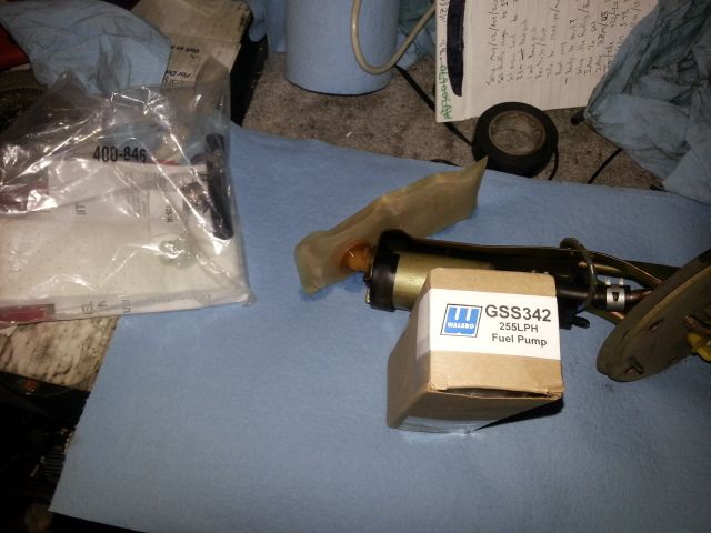

then re-wired the fuel pump

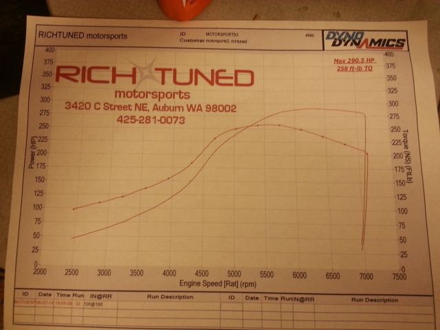

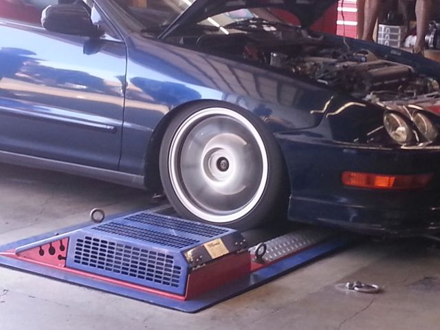

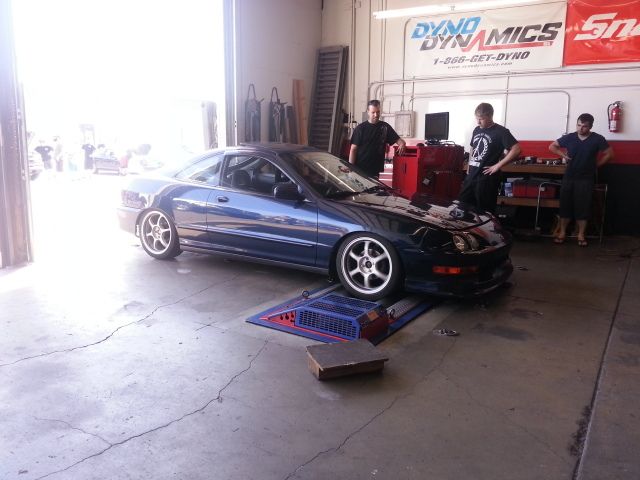

RHMT DYNO DAY 2014  O0
290whp 258ft tq @ 13psi...  ;DDD ;DDD
oh yeah there is forsure more in it. hell i was planning on 15psi or so, but after the first pull in the 11psi range, the power was there, so for once i decided to be conservative on power (still a fair amount). Dave said the timing map was solid, no ping, not even after he tried. so its time to beat the piss out of it and enjoy...

all dyno pulls look the same. think i only took the first short pull vid.
So how did it drive home? You rape on it? Sou did pretty clean when it had the twin tuners inside of it.
actually i hit traffic so i just kinda putted along... with the AC on  :-*
when i came into town i snuck in the back/long way and ripped threw the woods some. she gets up and MOVES.
