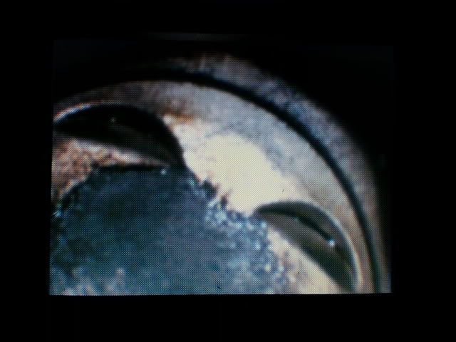

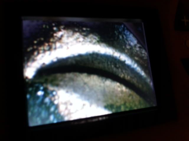

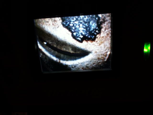

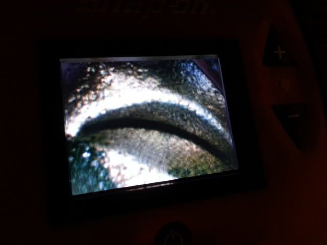

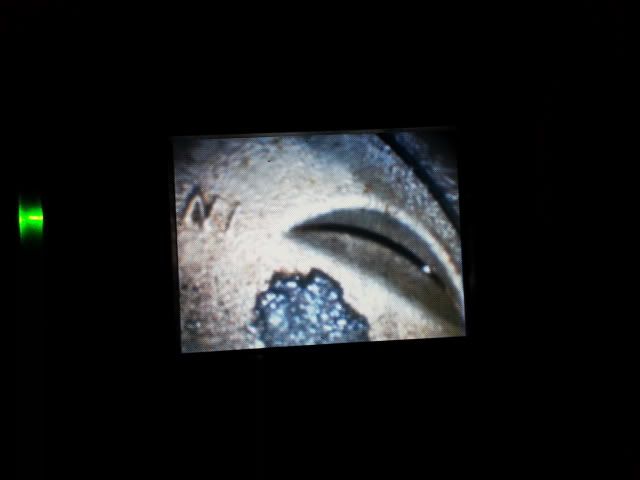

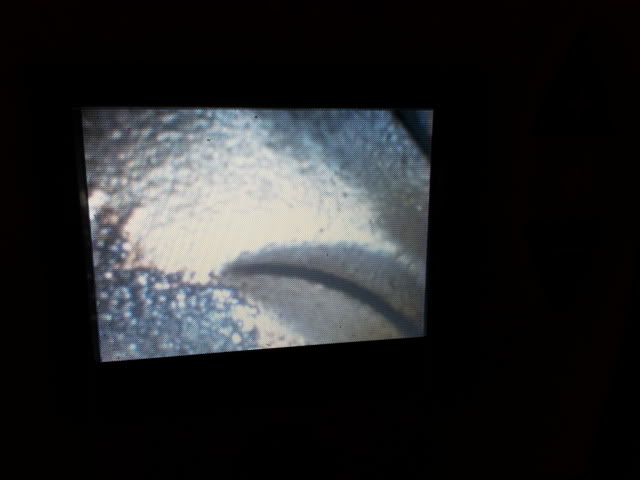

borescope pics in just random order. most are of 1/4 holes...
what you think!??!?!

looks like you don't use Chevron with techron gas, it's supposed to clean deposits from your engine.
looks like normal to me, what exactly are we looking for?
i use cheveron or shell gas only...

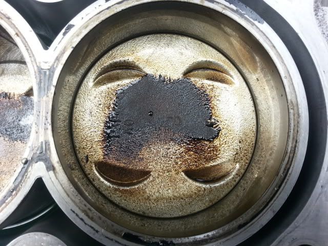

piston to valve contact... wanna know if i should be pulling the head or not.
Honda valves bend so fucking easy, pistons could look mint and you could have 16 bent valves. You really need to get your hands on a leak down tester.
n/a mike
  • Mr. Hotpocket
  • Posts: 1784
http://www.harborfreight.com/cylinder-leak-down-tester-94190.html
What makes you think you have piston to valve contact?
What size is that cam you have in, didn't think the non vtec motors were interference motors
I would guess the timing belt skipping is more of his concern for bent valves.

and last I heard the non vtak motors didn't have piston to valve clearance issues.
I know he has cams in the motor, but I don't know if they would cause clearance issues
It wouldn't be the first non interference motor I have had bend valves lol.
honda says that all honda motors are interference.

Honda says a lot of false statements
Usually when the head stalls out from momentum its not at full lift on the lobe, so when its all said and done the bottom end can still rotate without bending anything.  On engines with pinner dick cams like Y7's and F22A/B etc...
I've had ls motors come out fine, and I have a pile of bent valves from others
Leak down test like mike was explaining in the beach house. I know you said you don't have compressed air, do you have a comp tester? This is rhmt, make an adaptor from a schrader valve to the hose on your comp tester, go to sheetz or somewhere they have a free tire pump and do that shit?
Don't know if it would work but I've done weirder shit.
but when the cams were 90 degrees out... That changes shit
yeah. exhaust cam was right at home pointing dead noon, intake cam was 3 o'clock.   :-\

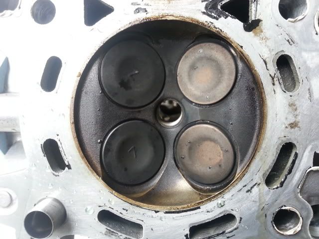

pics look legit? im gonna call/text around while at work, see if i can find a core p75 head for cheap to rob some valves from. think im just gonna sackup and do it for piece of mind at this point...

looks like im picking up another head for 40bucks from a buddy. so im gonna rip this head off, pull the valvesprings out and swap them into the new head and throw it on... but heagaskets locally are felpro and about $64 vs Mizumo/evergreen gasket that is $19shipped but will take 2-3 days...  :-\  thinking about reusing it, but not sure i wanna do that when putting a different head back on.

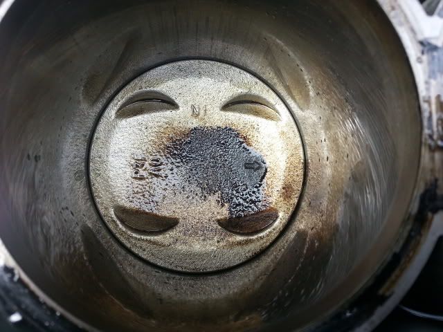

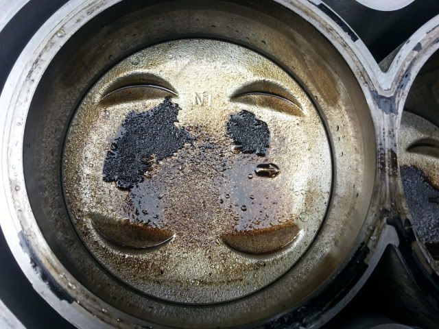

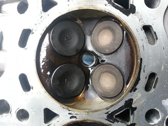

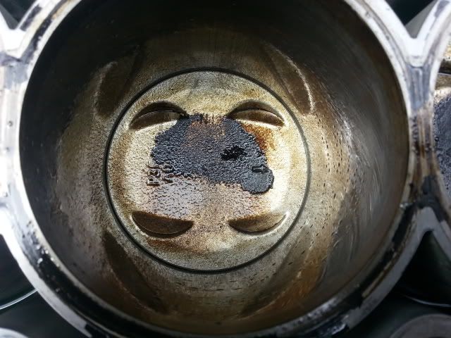

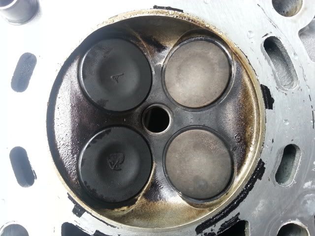

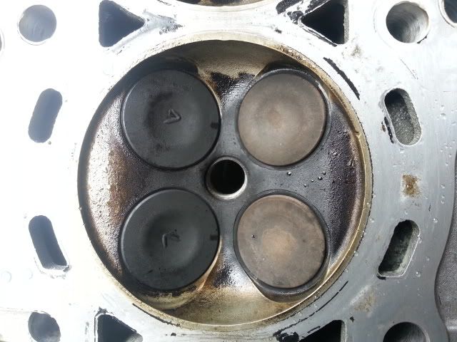

SO? WTF? am i wrong in seeing that this shit looks fine?>!?!?!

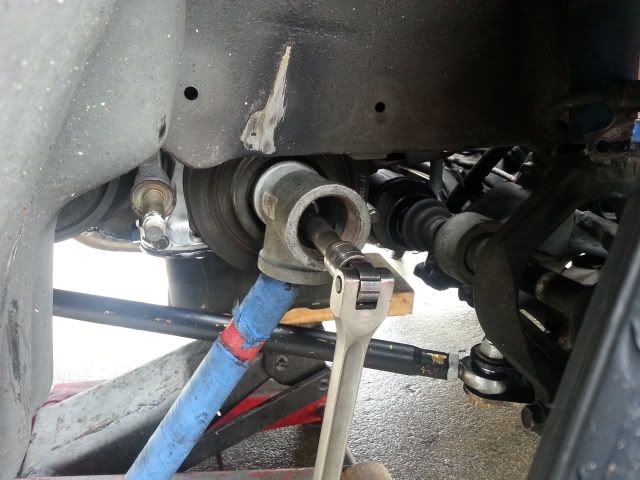

thats how i remove a crank pulley  O0

Looks fine to me... cant see any marks anywhere...
Re: turbohf DC4 Integra build.... CARNAGE PICS ON PAGE 4....?
« Reply #112 on: April 20, 2014, 05:45:44 PM »
yeah. my thoughts.....
now what?

more pics of that crank pulley removal tool
I have the real deal, but wouldn't mind a backup
So what did I miss? you wake up on easter and decide to pull the head?
Why did you pull the head off, the borescope pics looked ok to me
ill get some more pics later. its kinda stuck in the pulley lol.
reminds me of the first time I attempted to remove the bitch pin in the shift linkage during an engine swap.
Used a phillips screwdriver. fucker got stuck so I had to pull the engine out with the linkage still attached. Never did get the screwdriver out of the bitch pin

yup done that.
this just has a tight fit. and i want to tighten the pulley later. so i left it in... but now thinking about it. fuck. probably want to put the pulley on without the covers. watch it run before i torque the pulley...
