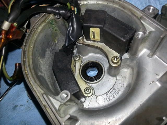

sounds like something is loose and rattling around in your distributor until it gets jammed in something and snapped those tangs?
IDK I'd open it up and check it out or just swap a new one on.
shit. good call. makes since. but I just drove it 24miles to work. then lunch and back... kinda scares me but hope it solves the noise... I'll update ya...
Re: turbohf DC4 Integra build.... swap is in!!!...boost soon! :D
« Reply #61 on: April 14, 2014, 06:04:53 PM »
I've never seen it break those tabs and nothing else, but I've seen it take out sensors or pickups before.
especially in the chinamen knock off distributors where the screws back out if they're loose, or the head pops off cause they're tight.
I'm curious what caused it as well though

yeah. unless the bearing seizes or something gets stuck in there it should break those off... I would think.

nothing hanging out in there...  all parts accounted for. no shaft play. spins freely. looks OEM inside other than the coil.
still sounds like shit. gonna drive home. let it cool down. try to adjust the valves again. still wouldnt account for distributor failure.

Ive had the same thing happen to me. Ended up being a bad bearing in the in the dizzy. But not felt fine.

Mine was the bearing in the dizzy.  I didn't think I could pull it out. So I got a new dizzy from acuraoemparts.com for $112

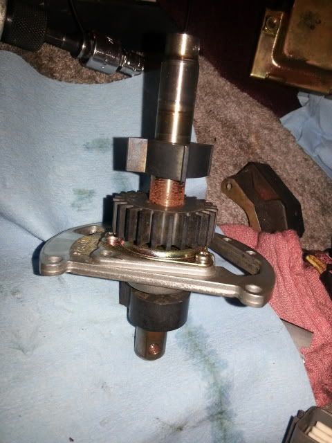

you can pull it all apart. well all the way down to the piece i swapped. i gave up on the last one i tried. you can replace the seal in it too. hell, the one that went into the CRX i replaced the TDC sensor  :-*

I thought the bearings were pressed in.
definitely would help to hear the sound. timing belt tight?
possible slapping and caused the dizzy tabs to break off
« Reply #71 on: April 15, 2014, 01:20:19 AM »
bearing is in the aluminum piece held in with some screws you cant get to cuz the wheel is in the way...
thats the seal at the bottom.
timing belt is tight. i had it super tight, but backed it down. maybe ill pull hte covers tomorrow and watch it run.

« Reply #72 on: April 15, 2014, 01:23:30 AM »
I always wondered how you got the screws out to replace the bearing. Is the wheel pressed on?
« Reply #73 on: April 15, 2014, 01:31:31 AM »
looks like it.
i have a whole box full of this shit. not sure there is even a complete distributor in there. lol. one i built for the EK im not even sure exists in a parts catalog, but worked. :noel:
