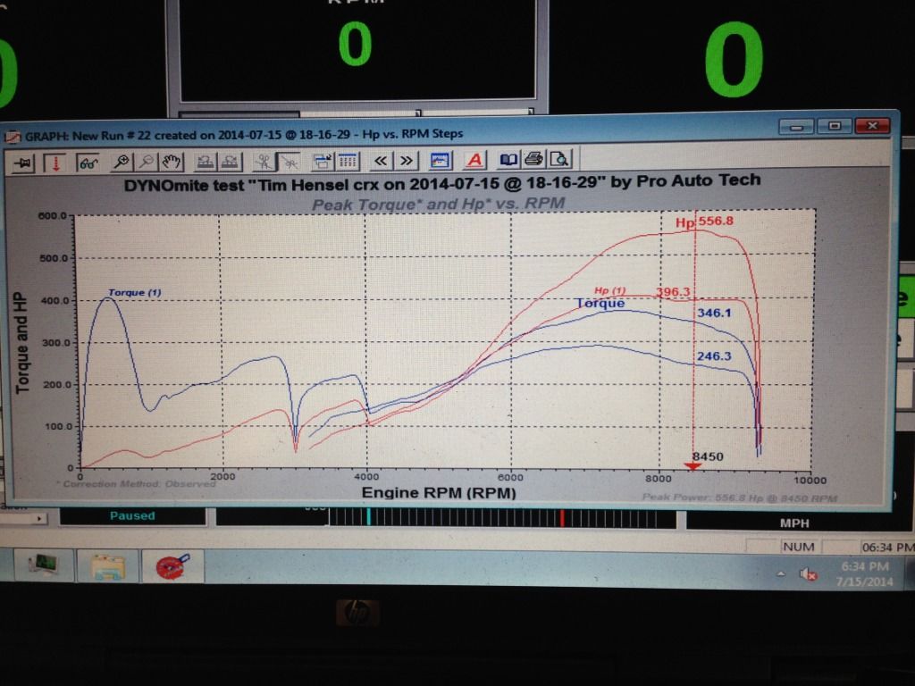

Was fucking with it on the Dyno all evening yesterday. Thought we got the last of the stupid shit worked out but kept hitting a rev limit around 7k.
Thought it was the msd causing interference. Still not 100% confident it isn't that as well.
It got late but it seems vtec is coming in late if at all and dropping out sometimes
Hydraulically and wiring vtec is good, it's either grounding issues or my rywire harness is messed up
Watching the datalogs the Ecu sometimes will comand vtec randomly late like 7k instead of 5? All checks disabled in ectune. Its weird. Then it will stay on one run, only stay on a second the next.
Did make 406 at around 10-11 psi without adding much timing.
Didn't scatter passing 10k on the pulls we did get in

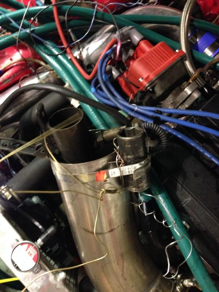

Fucker moves some air.  had to rig up the wideband mount that broke and kept blowing out.
This is about how the whole car looks at this point with all the hacking we've had to do with last minute fixes/changes on the dyno.

« Reply #87 on: August 29, 2014, 10:02:29 AM »
yeah a vband to the backdoor intercooler.
only two couplers one leaving the ic and one at the throttlebody
