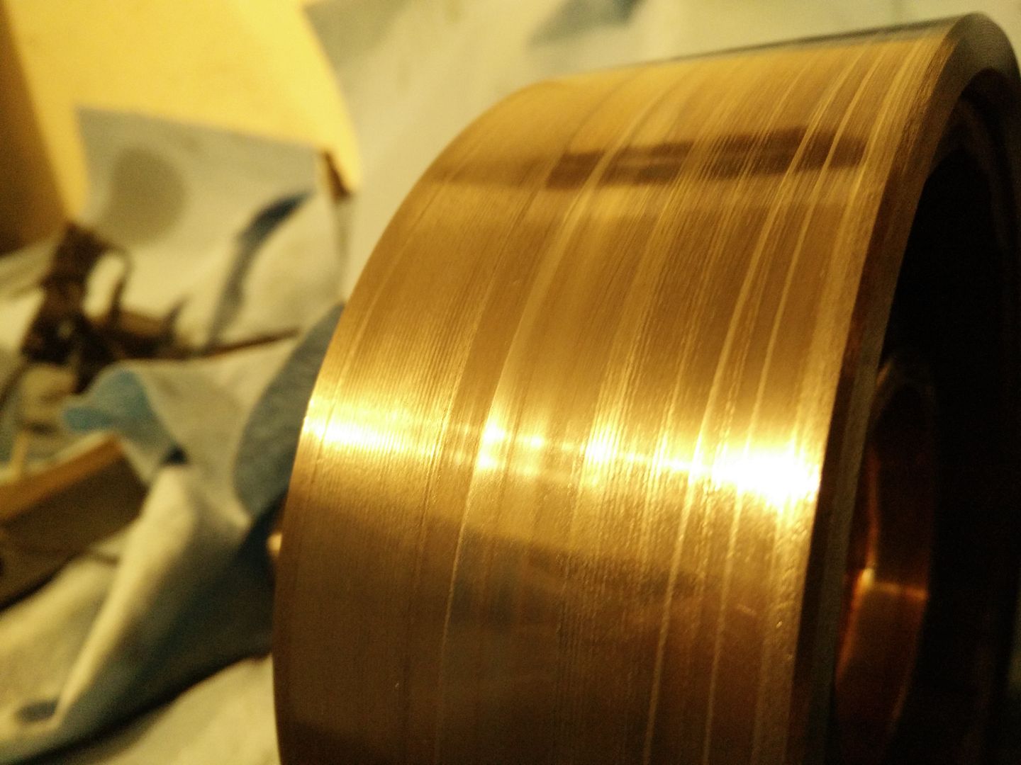

Re: 1966 Chevy Nova mordor project... aluminum LS6/TH400...
« Reply #272 on: March 14, 2016, 09:03:07 PM »

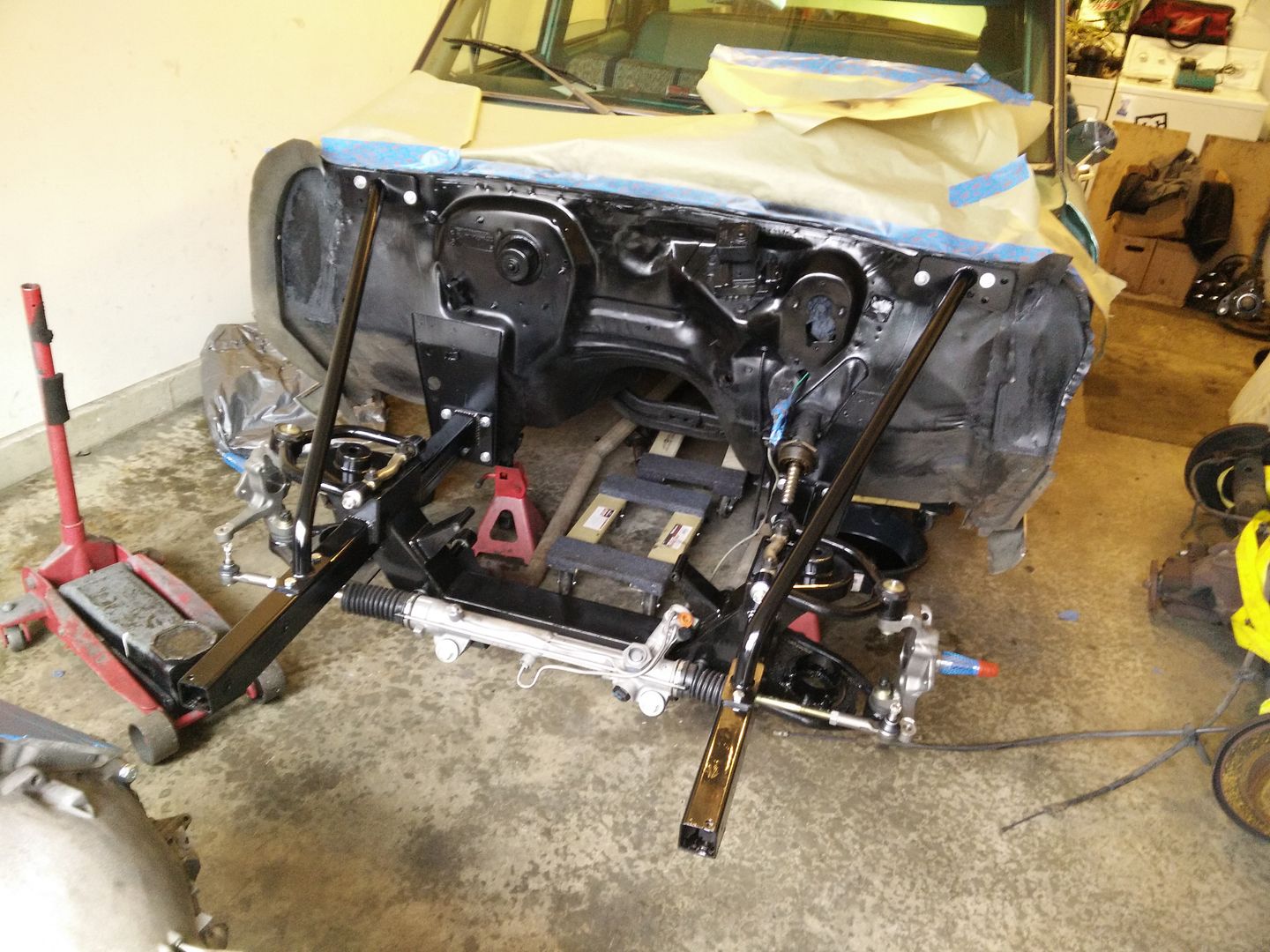

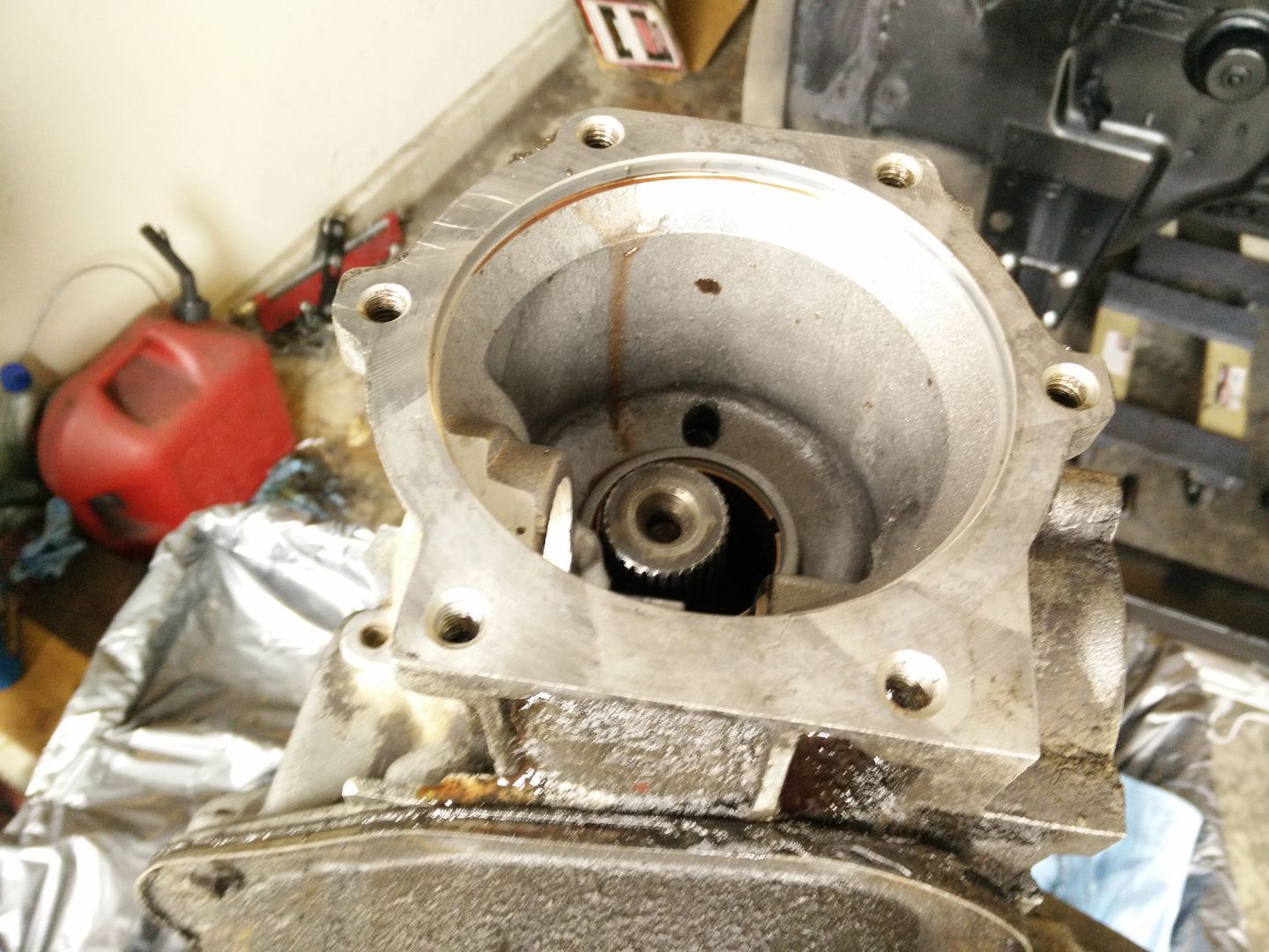

fuck you direct drive drum...or whatever one that is... i win.

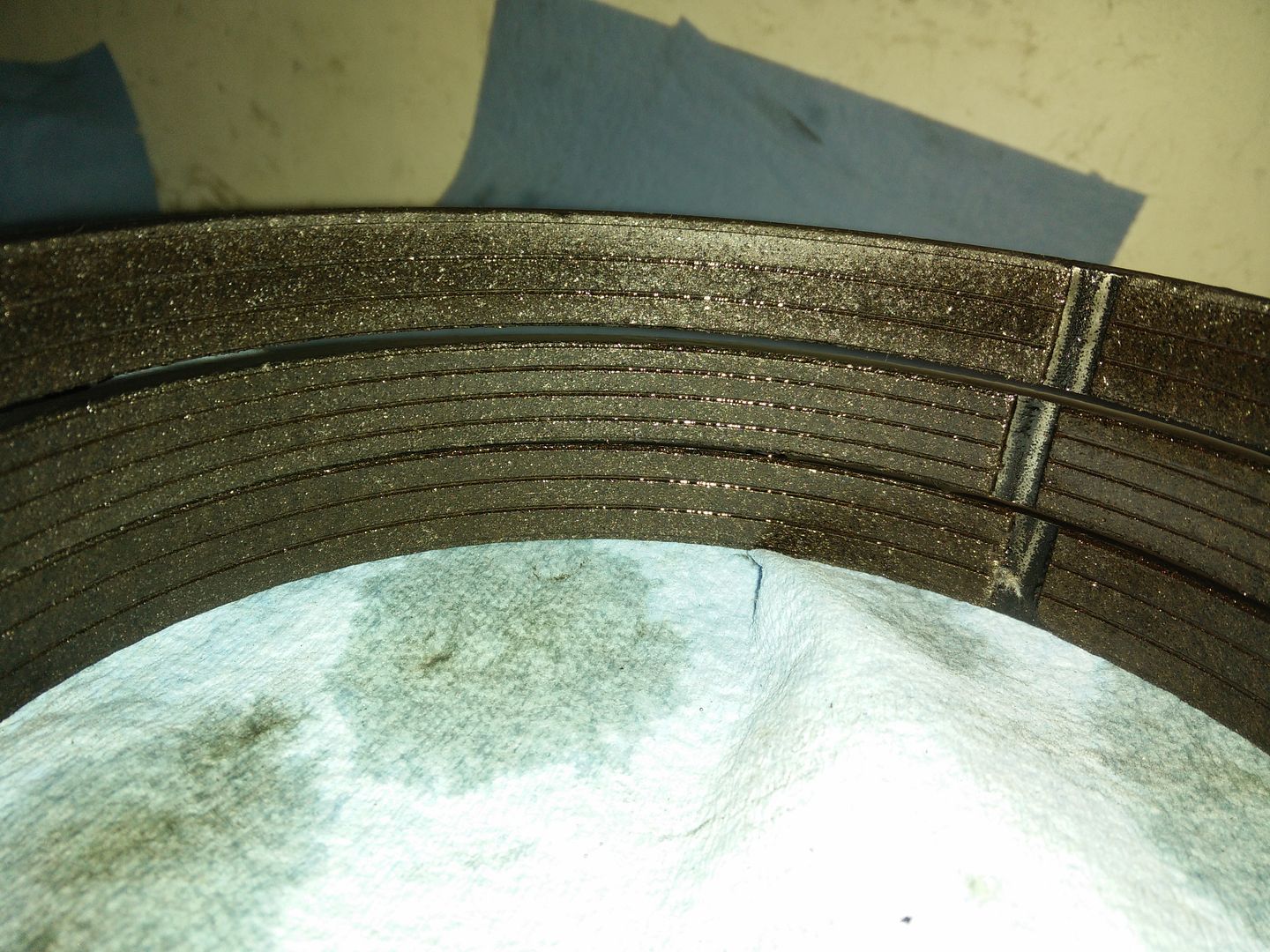

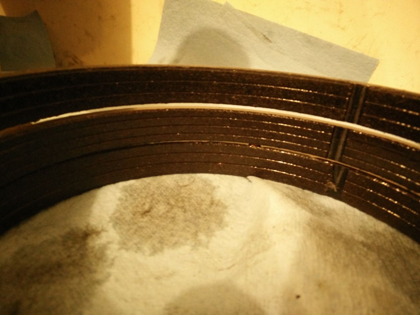

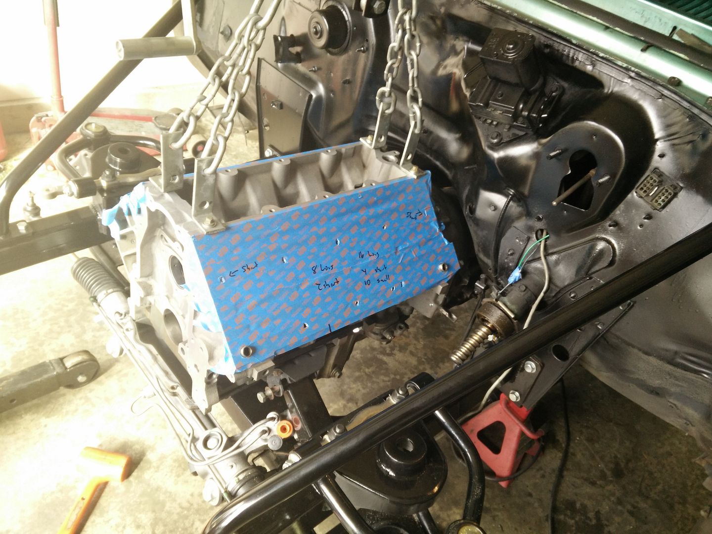

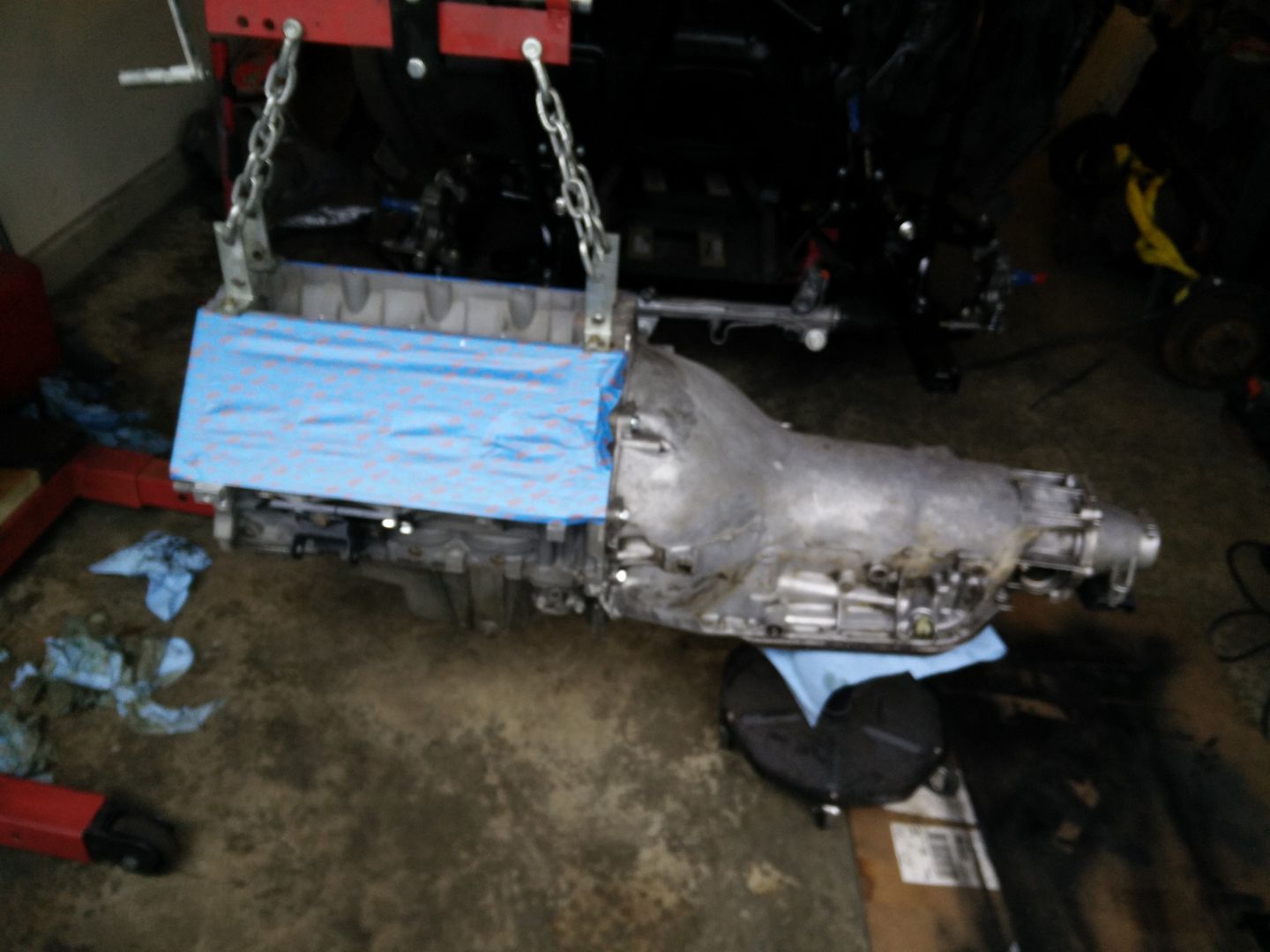

i stuck it up on end, supported with 4x4. and have her a couple good whacks with my orange mallet. so with the help of gravity (its always there to help) and hard surface it fell out.
couple shots of each as its hard to picture.
that shit ok? clean, lube, reinsert?  :noel:
empty block, and empty trans. even at that my hoist seems to be struggling...piece of shit.
front end/suspension crap going together nicely. probably how its going to look for a little bit. need to figure out brakes before the rest gets put together.

Shit it's a th400. If it ain't burnt, slammed her back together!!! Talking with Jake, he pretty much said you could almost throw just about anything in there with the dual feed mod and it will hold power.
« Reply #274 on: March 15, 2016, 12:07:02 AM »

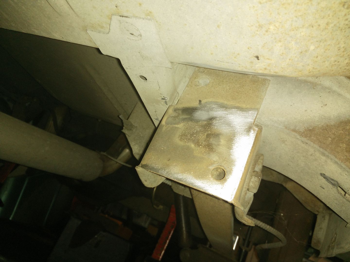

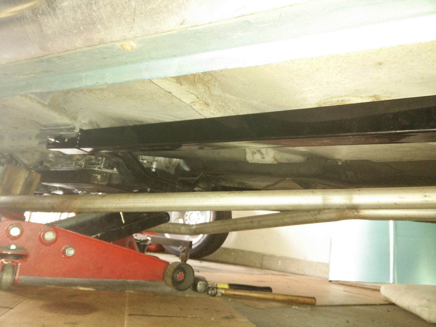

right, dual feed mod. i still want/need to do that. i want the manual 1-2 and auto 3rd. probably going to fuck with the governor after watching a couple videos also.
also. not sure what your talking about with the crossmemeber. doesnt look like it will be close to wide enough to weld to connectors. gonna have to get creative i think.
also. i found tons of people saying that the Competition Engineering bolt in subframe connectors do or dont interfere with the brake cables. they do. and the floor. no big deal as i dont give a shit about either really. so i removed/hacked out the brake cables (long story, but i dont like the factory one, plus the explorer rear end) and ill throw a jack under the connector till it fits  O0  it really just needs a nudge. most do this.
« Reply #275 on: March 15, 2016, 12:48:45 AM »
That's why I went with the weld in conectors. They fit 100x better.
« Reply #276 on: March 15, 2016, 01:04:00 AM »
for some reason i was thinking these would work better for me. dont remember why exactly. maybe its just cuz its square tube. the floor/cables thing doesnt bother me at all.
« Reply #277 on: March 15, 2016, 01:13:59 AM »
I just didn't want to have to bash in my floor. And I'm jewelry and these were like $150 shipped.

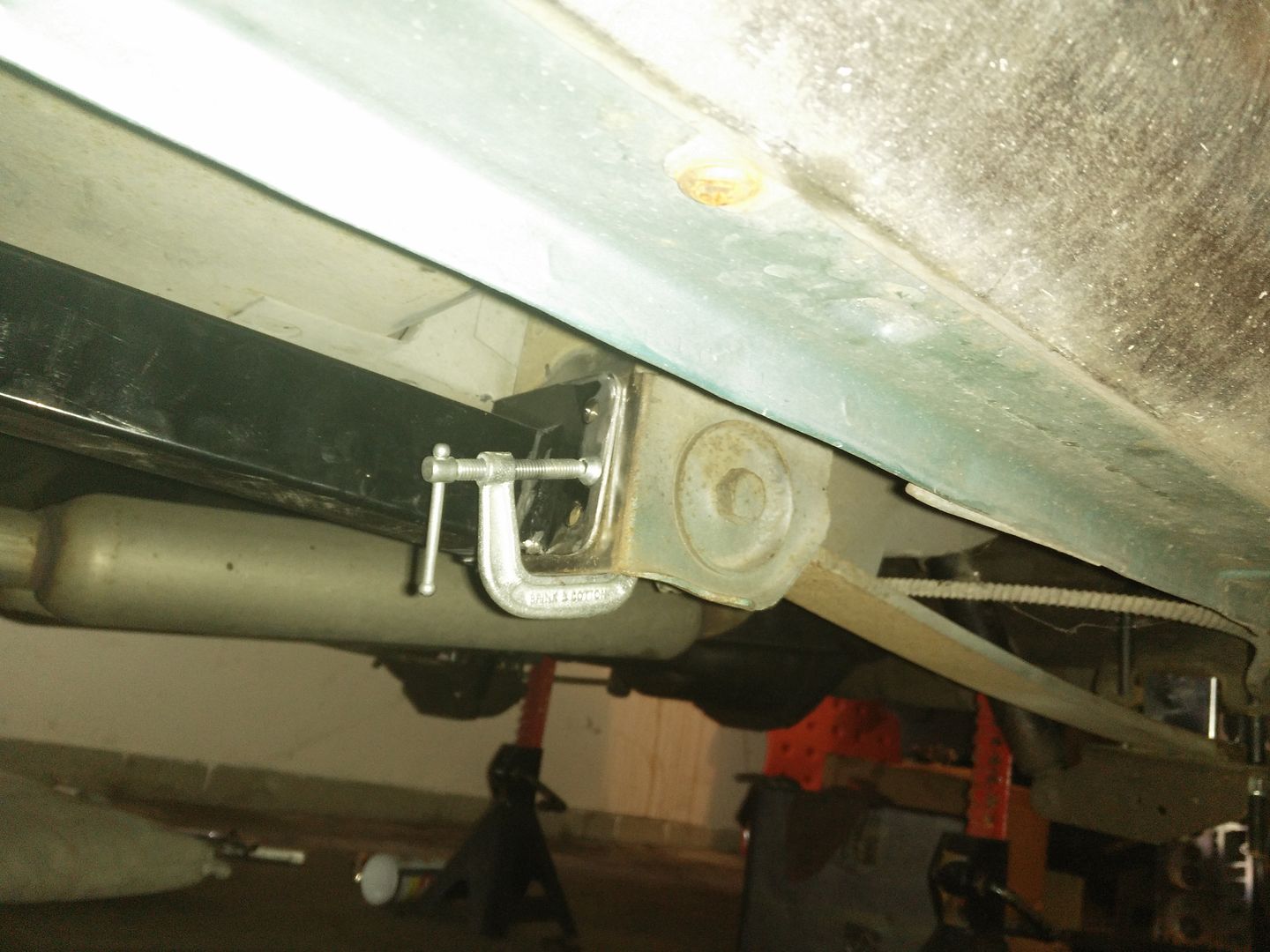

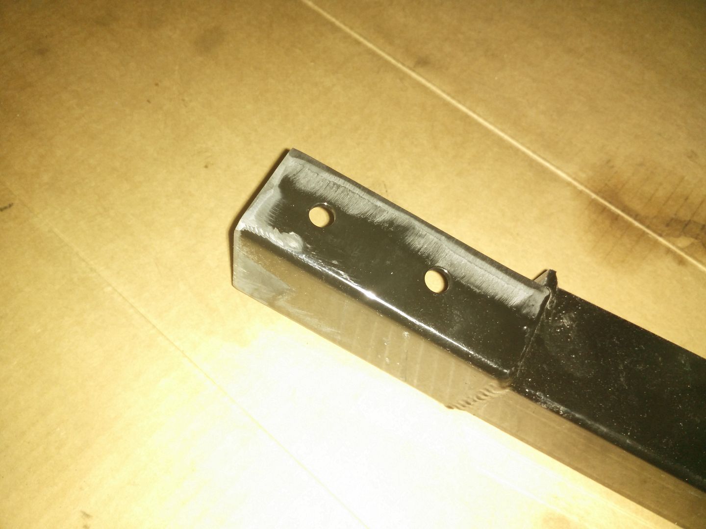

UPDATE...WORK IN PROGRESS... :noel:

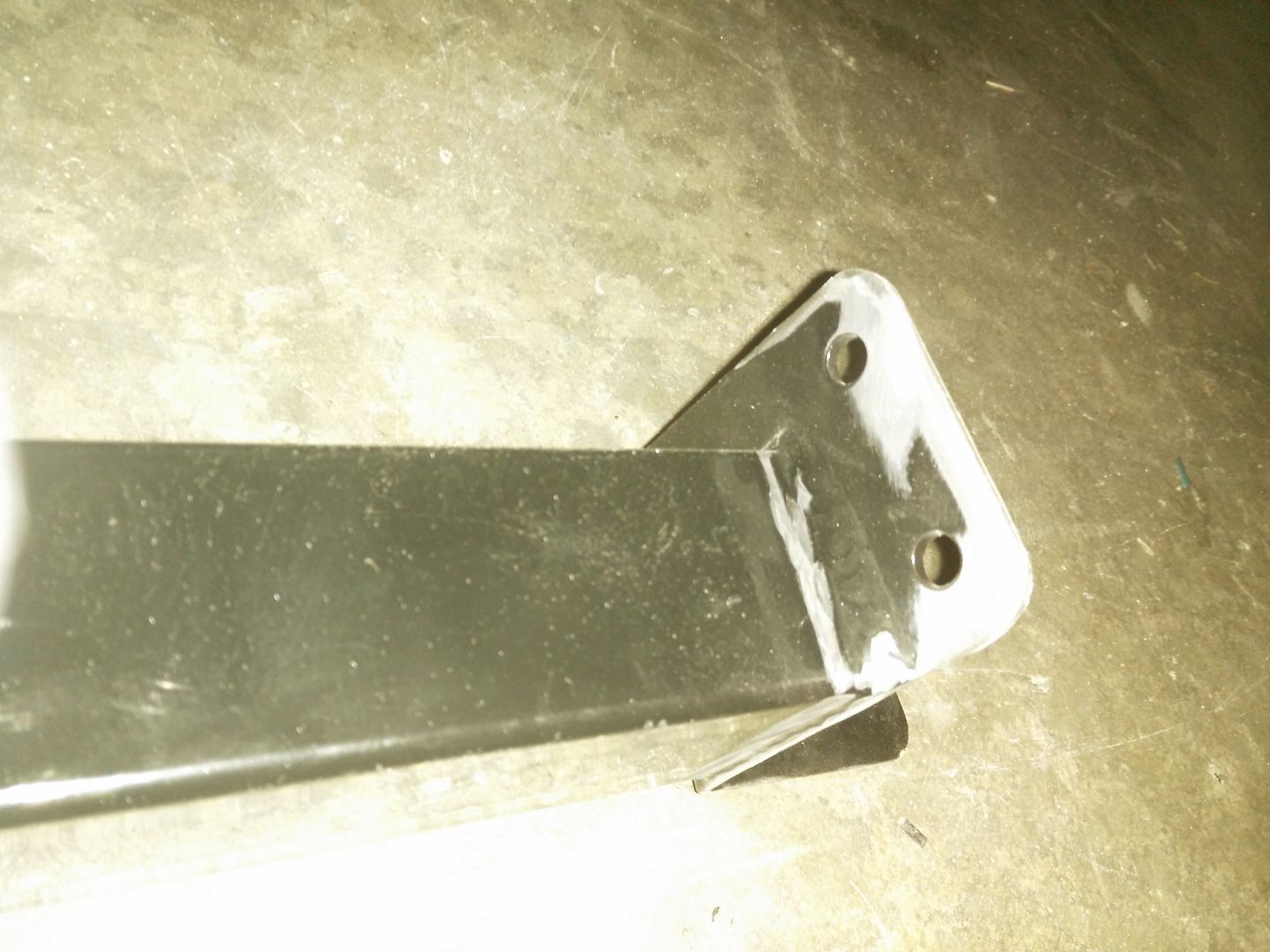

INSTRUCTIONS! big thing these days with all the china parts that dont include shit....
but no pictures, so i tossed them (ikea ftw)  ::)
if you remember these are "BOLT IN" connectors. instructions and internet say to weld them anyway if you can. and i can. plus nothing more fun than welding under a car, right?
prepped to fuse metal together in about those areas lol.
instructions say to use your 13/32 drill bit... fuck i suck at fractions, but i think i found it...
 O0 :mexi: :Jew:
that clamp is just about fuckin useless i know. i hit the other side with big hammer, worked mint. this is just a solid test run. not welding in just yet, as i plan to weld my trans crossmember tabs to this. also why i only bothered with just the one front bolt, and the nut on the front of the spring. just needs to hold in place for now.

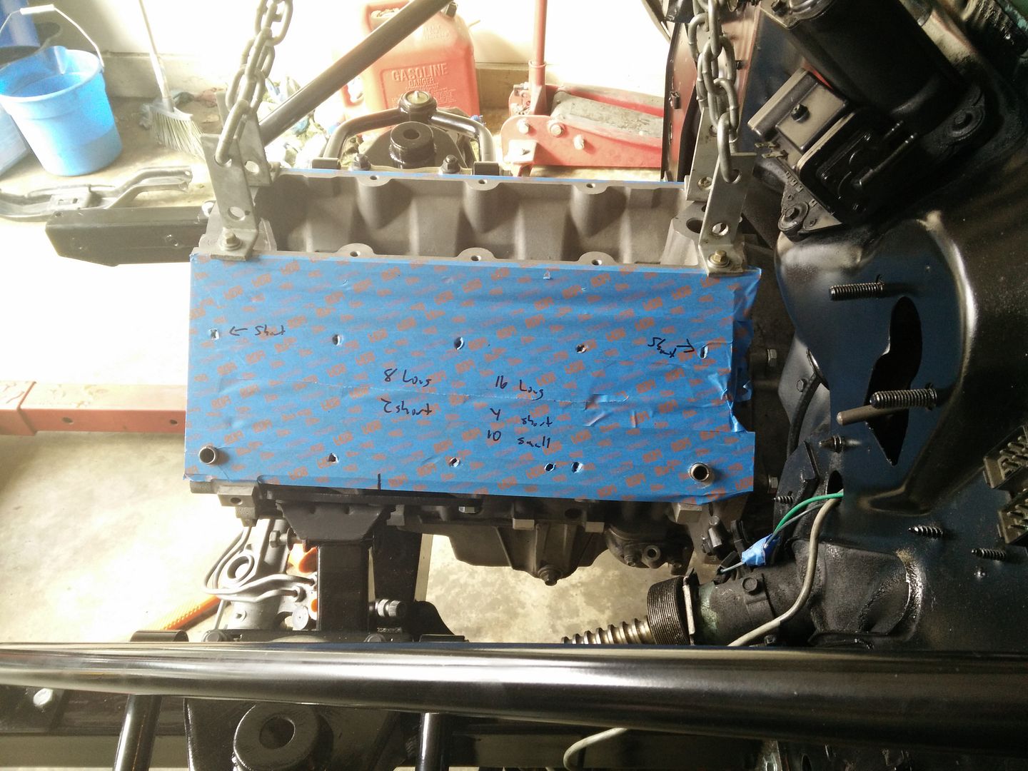

NOT DONE... i got more...

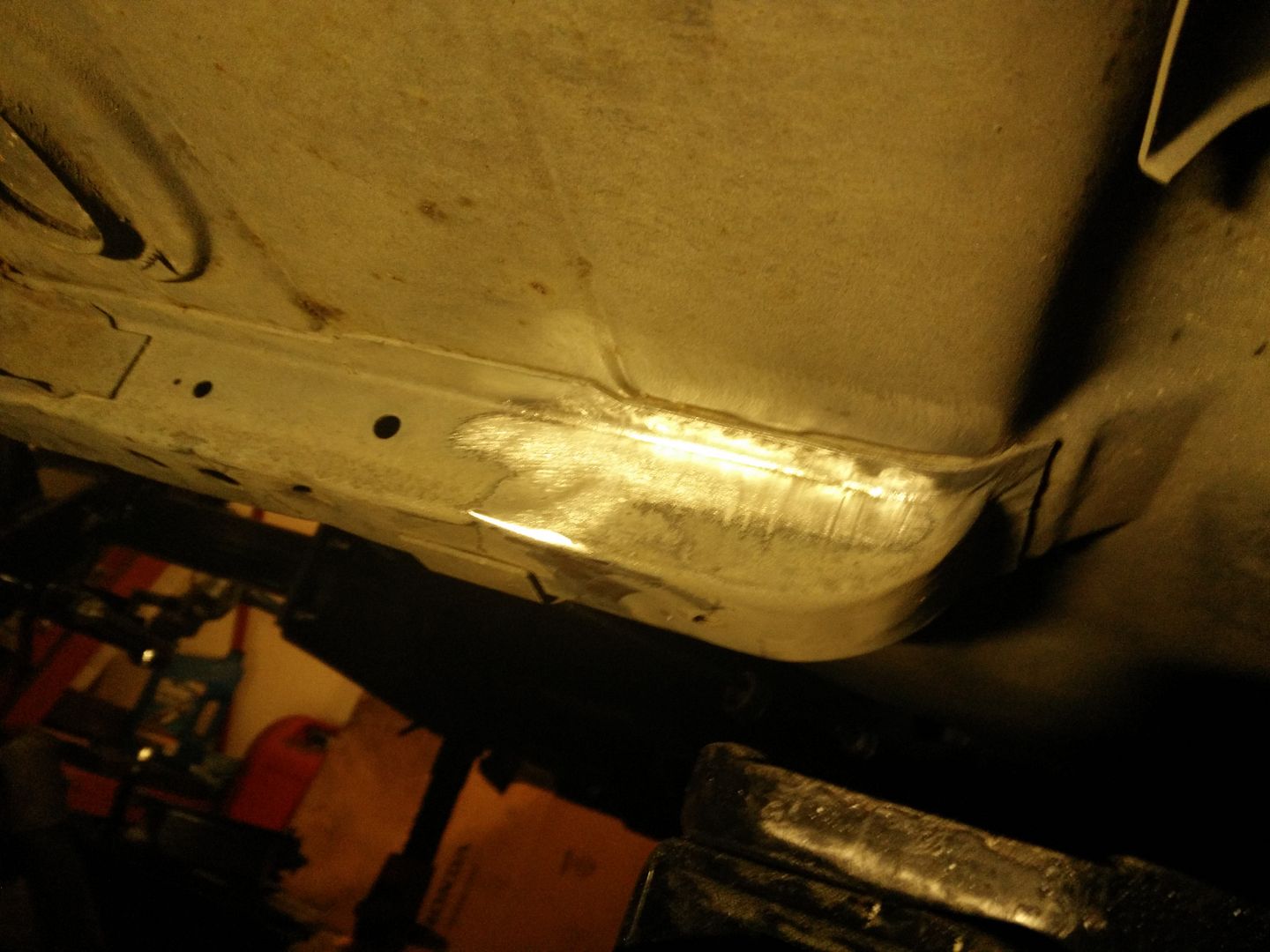

i measured several times my mounts on my chassis to the firewall. and guesstimated that i need/wanted/guessed that 14" from the bell housing to my mounts would be good. well... there is an oil pan on the bottom of the motor that felt differently lol, by like 1/4".... so did some magic with the mounts (swapped sides) and got like 1".
sure it wont be super fun to pull that drivers head if needed, but it will be doable.

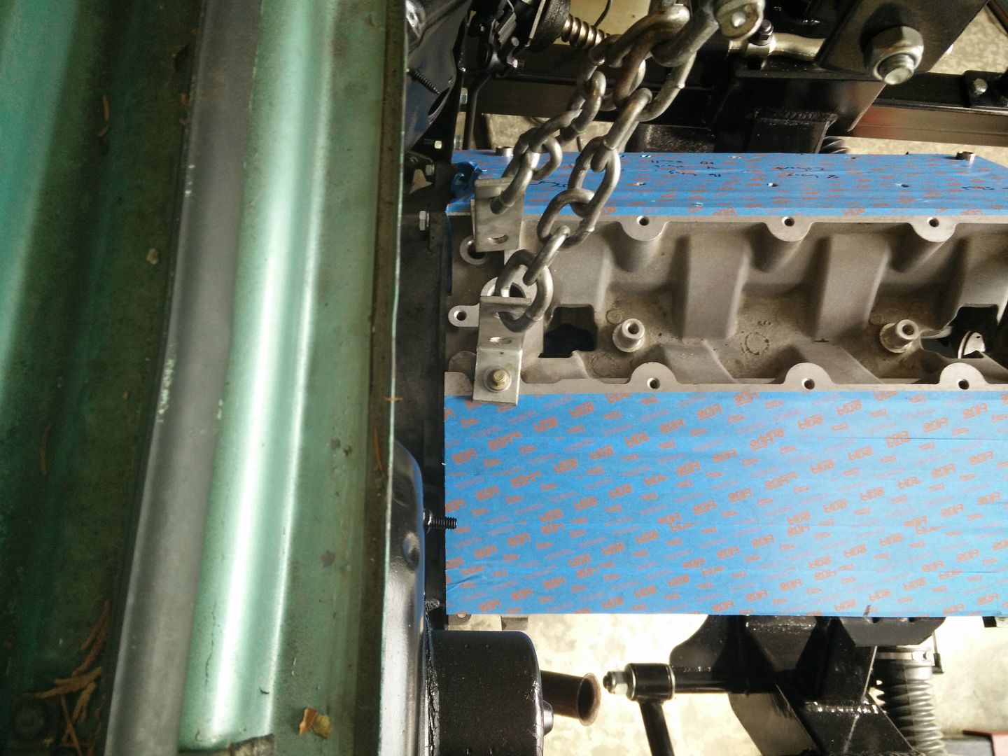

i beat the shit out of the floor/tunnel to clear the TH400, and well im out of shape and took its toll on me quick. i found a better way to mark it i think, so ill give her a couple more hits later. only spot that needed a message is where the tailhousing bolts on. basically the bolts are hitting the floor. also not sure how high i need/want to get her up in the tunnel? i bolted the trans cross in place and was aiming for it to bottom out on the floor boards.
OH, btw...

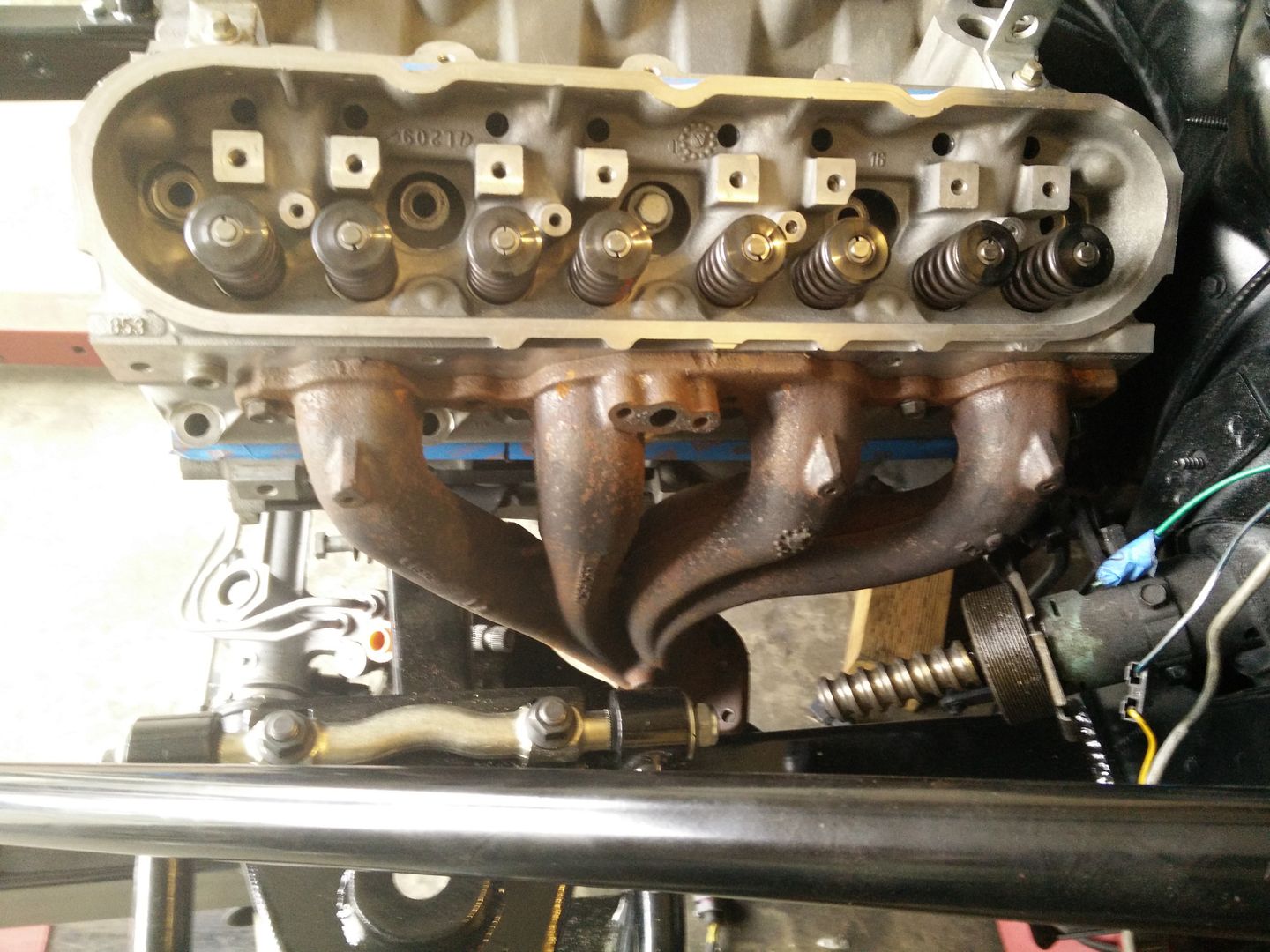

thats a 01-02 Z06 manifold bolted perfectly fine (no studs on bottom) into the nova..... also notice i have no steering shaft, thats good, cuz it doesnt have a chance of fitting... :(  good thing i didnt pay for them, guess ill post them for sale. and buy some shitty headers that will fit horribly.
to recap. there is an aluminum LS6 bolted into my Nova, its a good day.

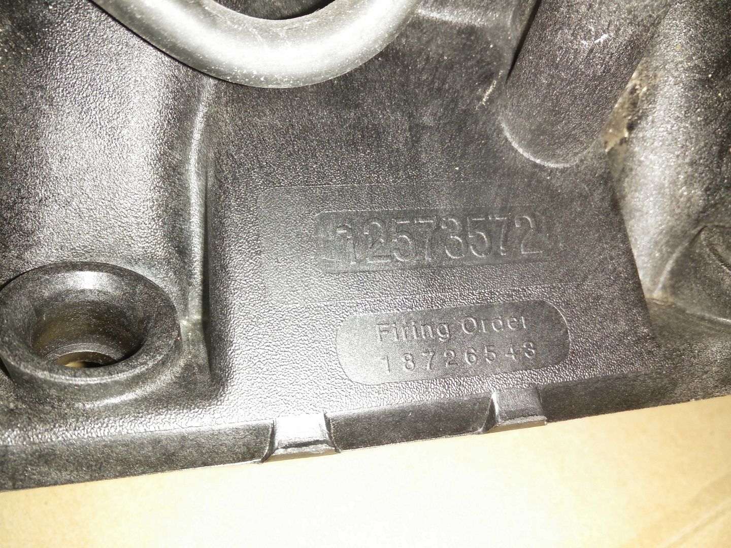

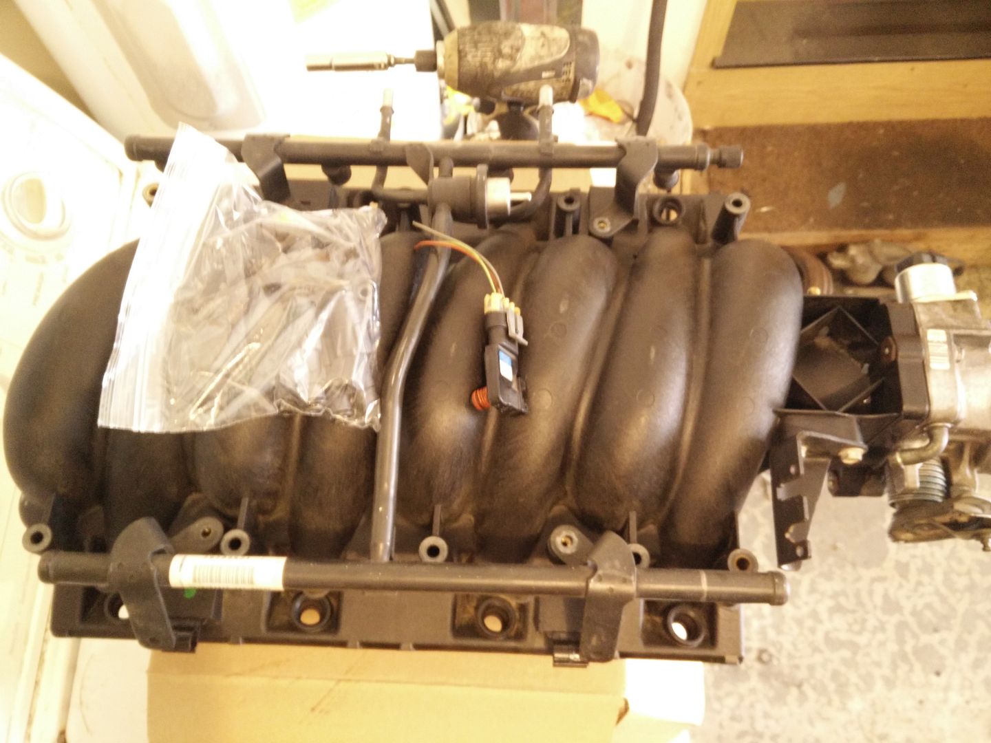

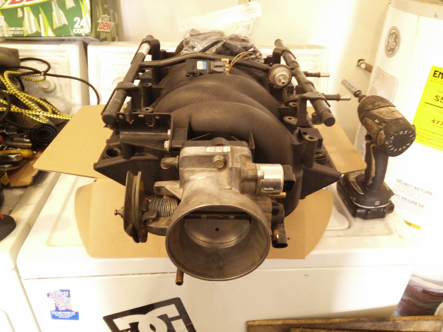

forgot i never posted these...
part number when i looked it up showed that its the correct manifold for my LS6 Z06 motor. i guess # is different if its not for a vette. anyway i said i wasnt going to buy one, kinda an impulse buy i guess. seen it, wasnt a bad deal, bought it. whatever.
LS6 manifold
LS6/30lbs injectors (or maybe 50lbs Delphi's)
return style fuel rail
cable throttle body that i forgot to run numbers on
all the hardware/bolts and a MAP sensor
 :Jew:

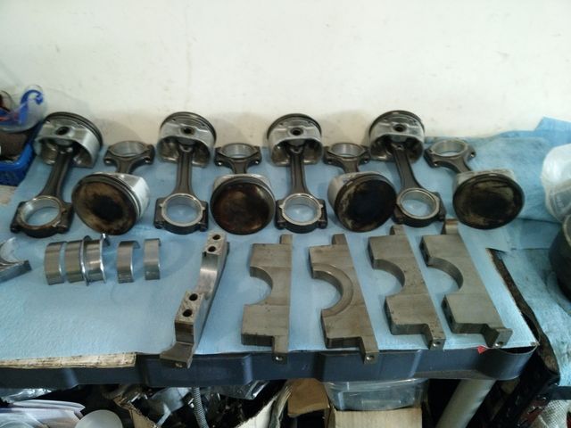

« Reply #295 on: May 23, 2016, 12:40:28 AM »

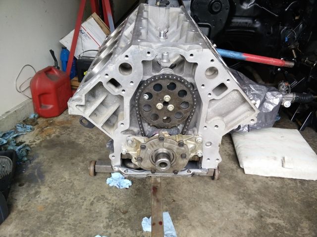

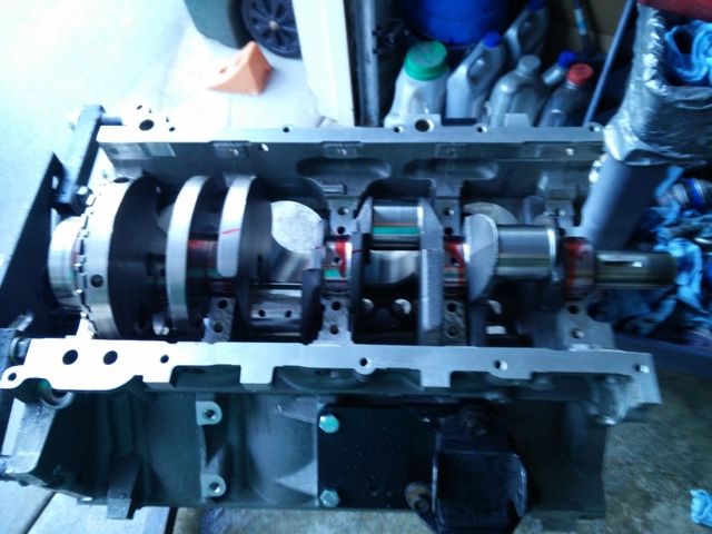

WORK...  :noel:

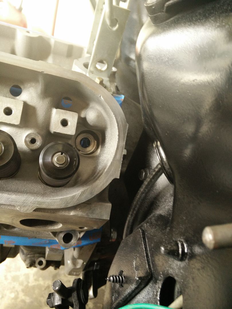

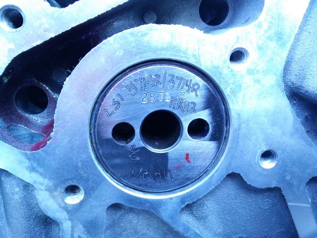

my back hurts, but wanted to put in some work... actually now that i write this, it feels better. probably because i have been standing and its not tweeked from sitting... anyway.
honestly i dont know much of anything about this cam. lol. i did a quick search and found some numbers, sent them to a buddy, he said it would work. lol. it was free. so whatever.
it was installed in this LS6 before. dont remember if he said it was on the NA or supercharged setup.

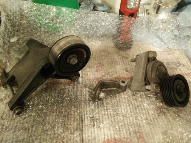

oh, and i bought this:
was $60 shipped. not bad i guess. still need to figure out (and find) a power steering pump/bracket/etc, and go to junkyard to grab an alternator. i think i can use a 4.3L alt?
stay tuned, there might be more progress...might lol.

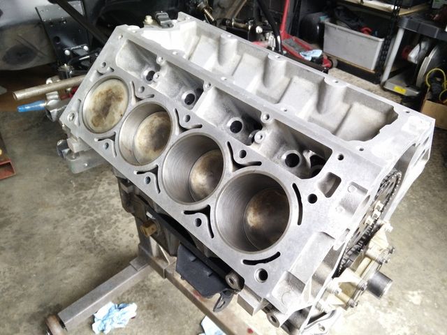

« Reply #296 on: May 23, 2016, 08:07:00 PM »

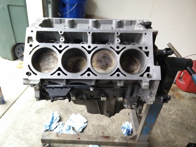

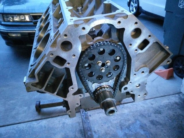

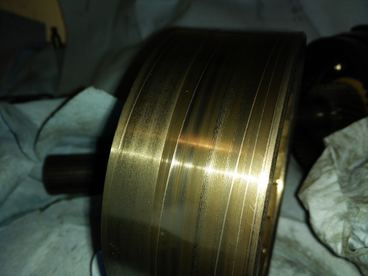

filed/gapped the rings. upper to .60mm and lower to .65mm. like .023/.025"... most all my tools are metric.
rods/mains are whatever they are. i dont check them. engine spins = win.  :-*
oh same note. i torqued the rods to 35 and mains to 60.  :mexi:
all these parts seem to have been cleaned, then put away halfass. they all are dusty/dirty. thankfully most of them are rust free. makes cleanup quicker. but most this crap took lots of brake cleaner, water, towels, etc to get ready for assembly.
so, lots of cleaning and filing of rings. over that shit.
need to order:
3 head bolts (have new set, just missing 3 for some reason)
2 headgaskets
front cover gasket? mine seems to be missing, swore i had one. maybe gave it away with LS1?

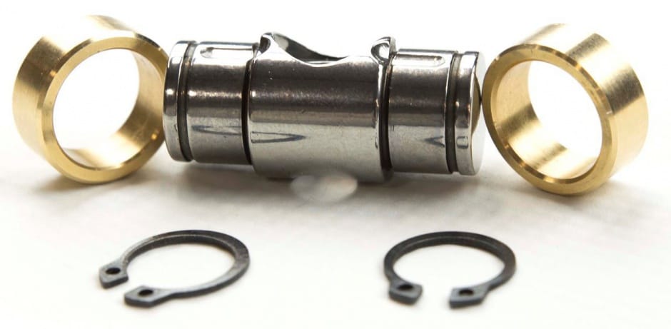

crank pulley bolt
torrington upgrade (needleless/bushing style)
water pump gaskets
plastic oil passage plug thing i broke.
 :Jew:

Summit trunnion upgrades......FTW!!!!
« Reply #299 on: May 24, 2016, 03:28:12 PM »
if im doing it, im not putting needle bearings back in.
and really in my searching all i find is broken comp bearings, not stock ones. so not even sure i should bother. but for $160 its almost worth my piece of mind. also matt commented that he only does springs and has never had a failure.
