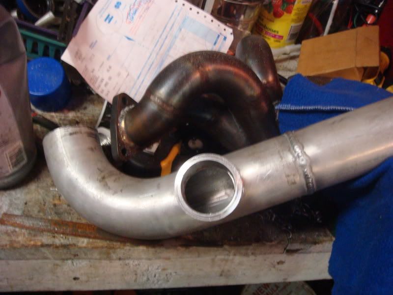

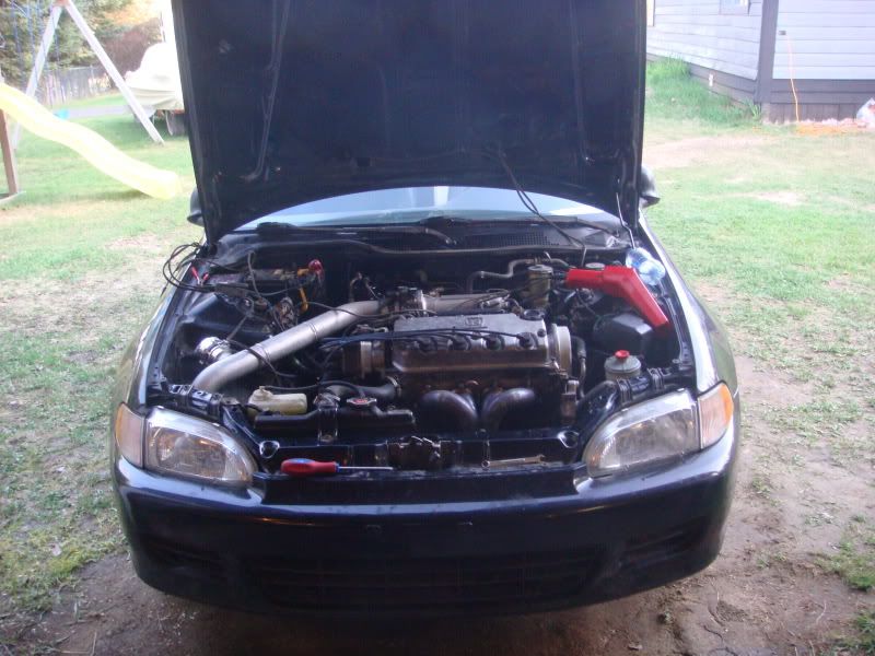

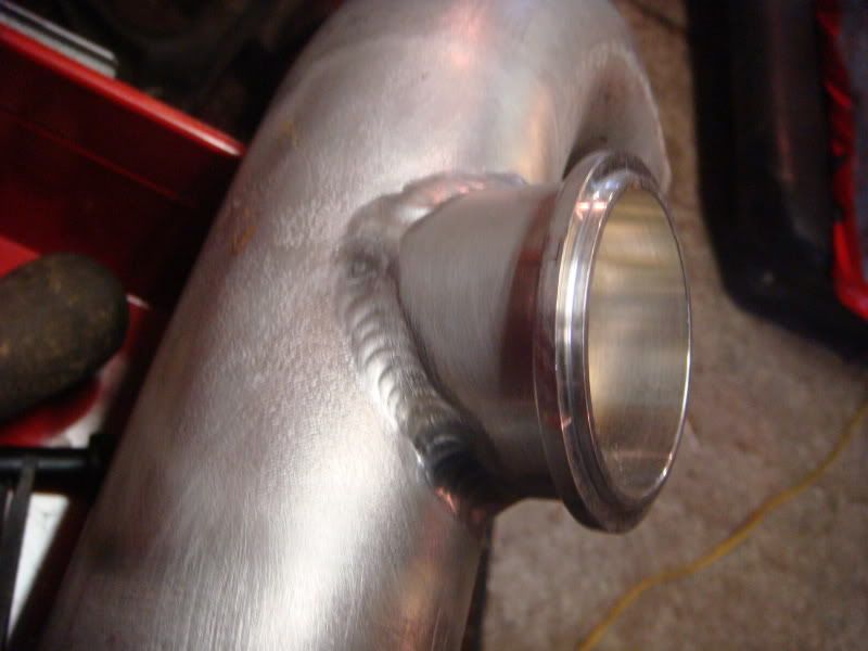

Some new pics, basically cleanup and install pics.  Charge pipe welding courtesy of dvst8r
