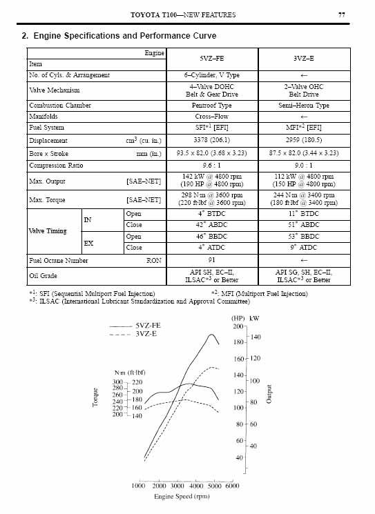

I think we can both agree that the 5vzfe is def the best cost/power for this swap of the toyota options.  Its really an awesome motor whose limitations are really just in the cams.  Bolt to many diff transmissions and millions of parts trucks laying around.

I vote 5vz-fe. They are a good motor. The one in my truck has 210,000 on it.
The cams produce good low end torque. I bet if you had a quick spooling turbo it would produce nasty low end torque.

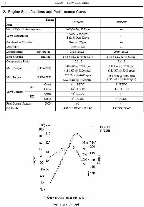

I've heard 3vz cams make a nice combo on the 5vz-fe. More mid-range power.
I'm not entirely sure if the motor will bolt in or not.
« Last Edit: August 10, 2009, 07:44:34 PM by E-b0la »
Toysrme
  • Posts: 250
Re: Jz swap into 92 toyota pickup
« Reply #23 on: August 11, 2009, 04:20:19 AM »

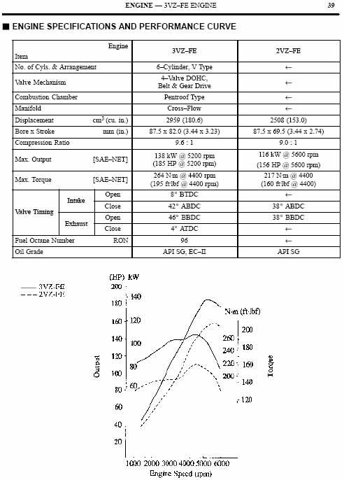

erd on the cams. 5vz-fe falls on its fucking face instantly. 3vz-fe's rev out
can't swap 3vz-fe cams into a 5vz-fe. i forget why, but the truck guys were looking into it years and years back & noone could ever get it done.
5vz would be the easyest swap because its the most knonw
