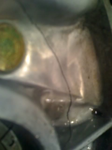

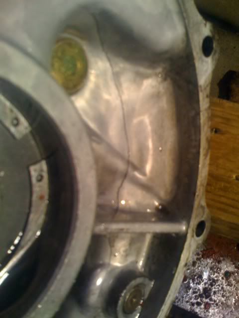

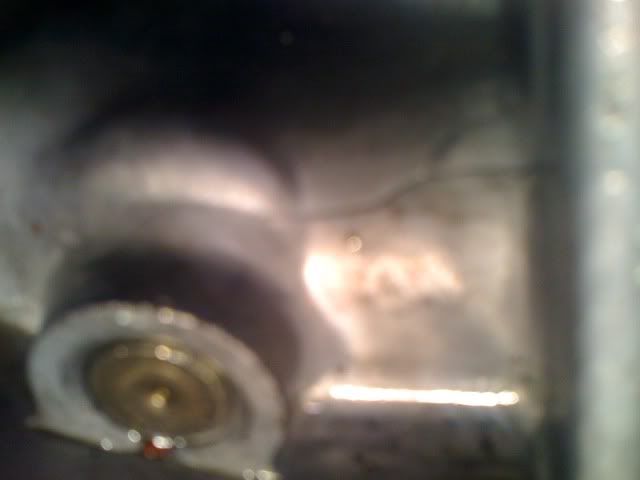

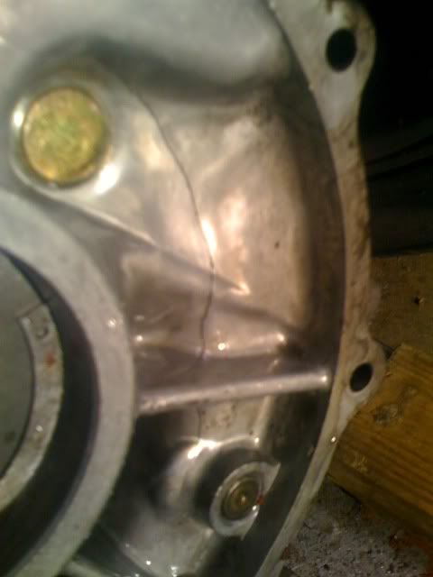

so i'm putting my hydro gsr tranny back together and i have a slight crack on the case, ill post a pic

how do i go about fixing it?

PICS

I suggest taking it to a machine shop after you have it hot tanked. let then groove into it with a die grinder and re tig it from the outside. NOT FROM THE INSIDE

cast is very tough to weld correctly

aluminum sweats out oil if oil has been present. Most welders cant do cast correctly.

hit the crack with a torch for a few mins that should burn off most of the oil, then rinse with acetone/alcohol/brake cleaner something that cuts oil.

If you heat if up and clean it a few cycles then weld it while its hot you should be ok. But putting filler in somewhere that has already cracked do to stress is not the answer.

grind along the crack SLIGHTLY, hit with torch SLIGHTLY, drill 2 small holes at either end of the crack and tig it.  Tranny cases are tricky ask me how I know....

Yeah be carefull if you torch it, heat can change the properties of the aluminum pretty easily. Damn. I wouldnt jb weld it, i'll bet that thing opens up when there's a heavy load on it. I'm supprised it didnt come apart.
