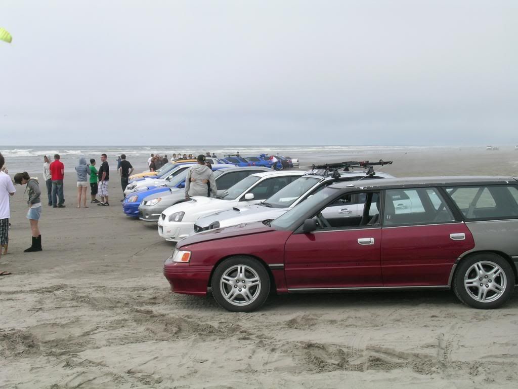

« Reply #12 on: September 28, 2009, 10:18:59 PM »
Shittiest looking car of the bunch. l like it. How did you manage to blow a piston ?
