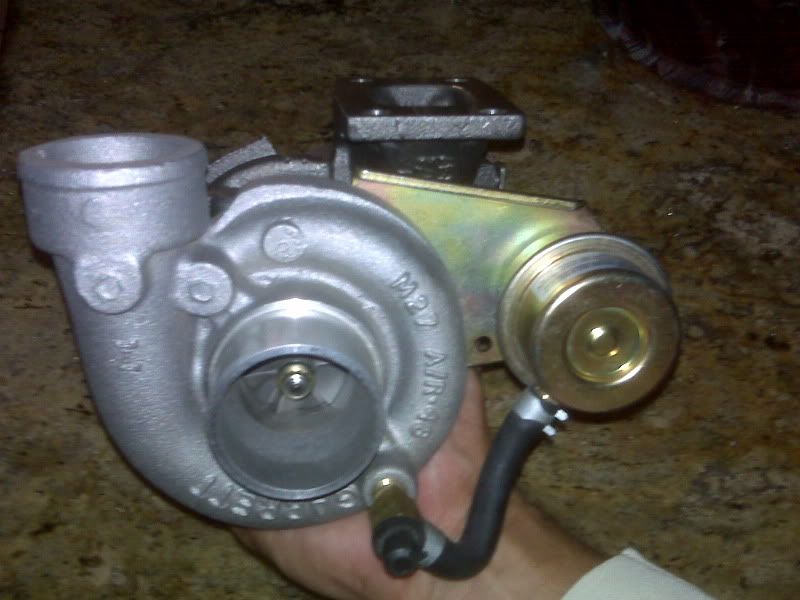

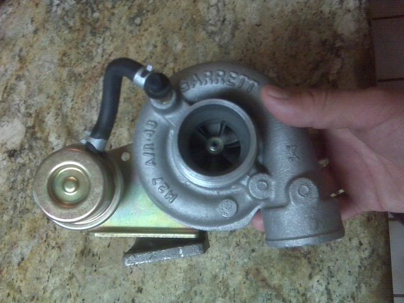

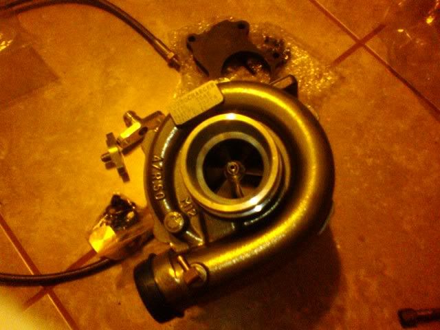

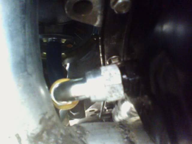

OK so that old Nissan turbo was leaking oil from the turbine side probably due to a worn shaft piston ring.  I needed another turbo but didn't want to spend to much and still needed to keep a/c and ps. I had some bad luck buying old turbos so I went for a CHING CHONG MIAOW!

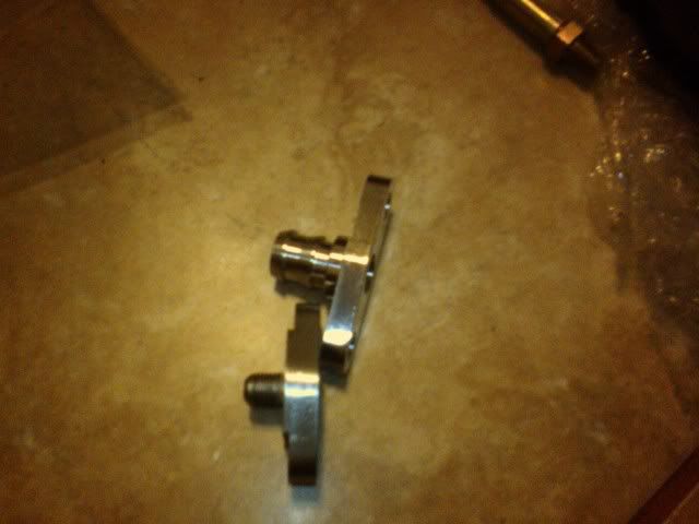

The turbo was being sold for 135 but had an option to make an offer so I offered 130 and it was excepted. It came with an oil supply line and restrictor and for six dollars more you can get an oil return fitting with it. When I received the turbo I was very surprised to find something else in the box, and no it wasn't little grains of rice. It was a 1/2 in downpipe flange!

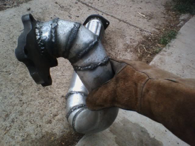

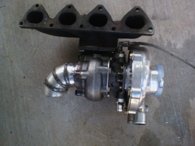

I made this downpipe with my new (to me) lincoln weld-pack hd 100

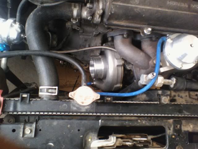

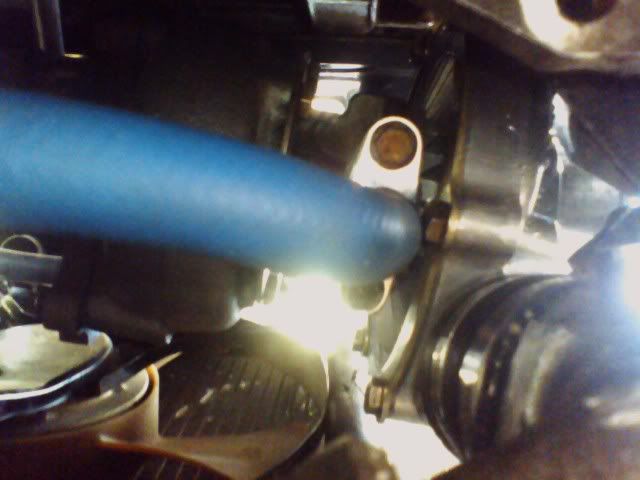

I then went down to parkers and spent about $50 bucks to complete my oil return line I got an aluminum bulkhead fitting assembly, a -10an 90 and one foot of blue hose. I used some hondabond on the bulkhead and really cranked down on it so it wont leak.

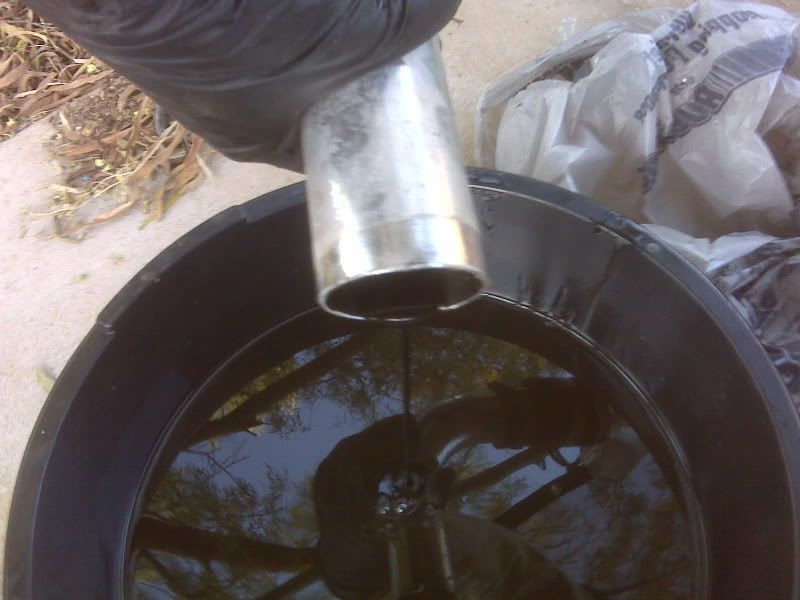

This thing ran fine for the first 10k miles boosting every day.  Just a few days ago the car started to make a little noise at idle.  I'm not sure if I was starving it for oil or what since my dipstick broke in two.  So I changed the oil and the oil return line.  The car then started to smoke like crazy and hasn't stopped.

Tubo's done LOL

Chinese oil filter?

I've gotten "freshly rebuilt" turbo's from blaast that put that much oil in the chargepipes with a .060 restrictor and perfect drain, after less than 3,000 miles.

I'm not sure what your asking? That obviously my charge pipe!

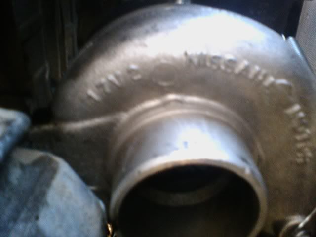

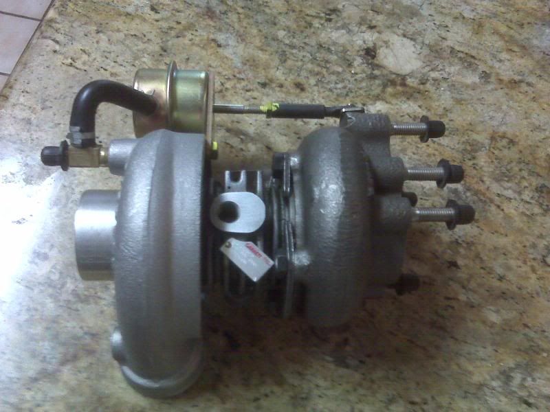

I just got this from a friend.  This turbo has been to war and back, literally!
It was ordered for a land rover back in Iraq but never got put on.  This turbo is very small and is a Tbo2 I believe.  I'll probably us it on my d16z6.
