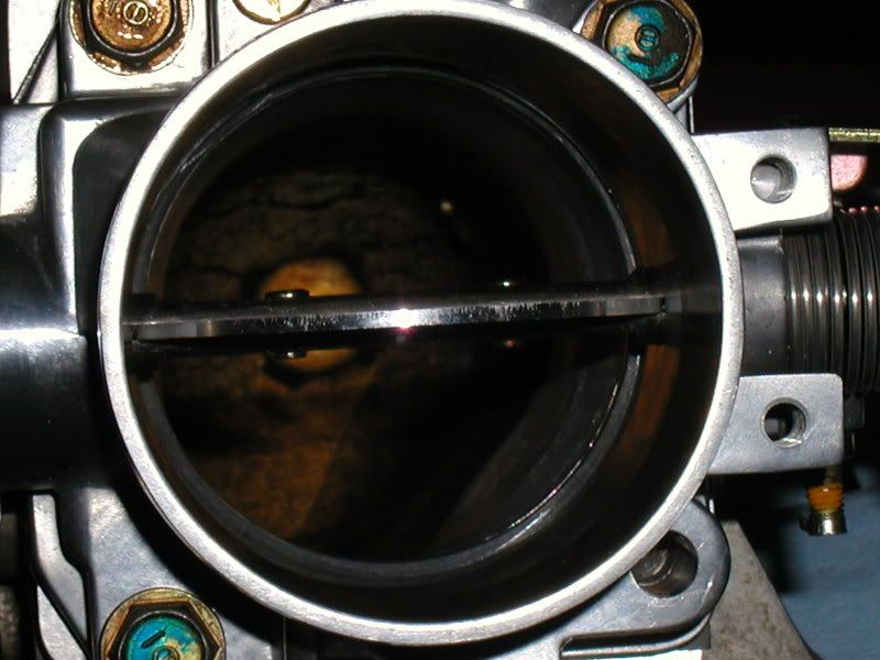

how much is that TB and spacer combo?
Re: 350 or Bust - Love me some D
« Reply #33 on: March 26, 2009, 06:22:18 PM »
pm Chris M.  I traded a cat and cash for it so i don't remember how much I paid for it
« Reply #34 on: March 26, 2009, 07:05:10 PM »
70mm throttle body=145
spacer=45

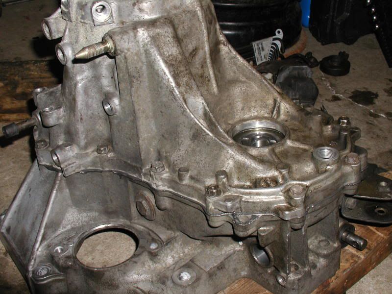

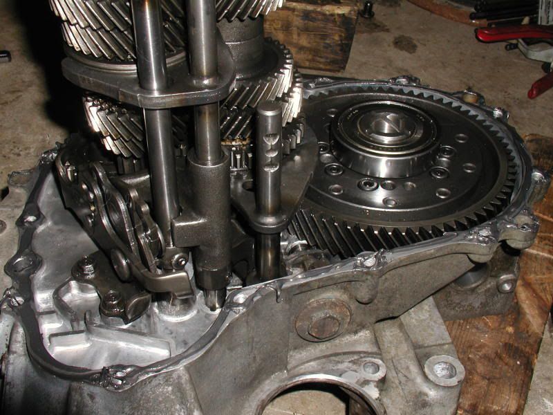

Steel shift forks

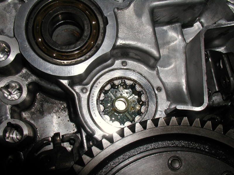

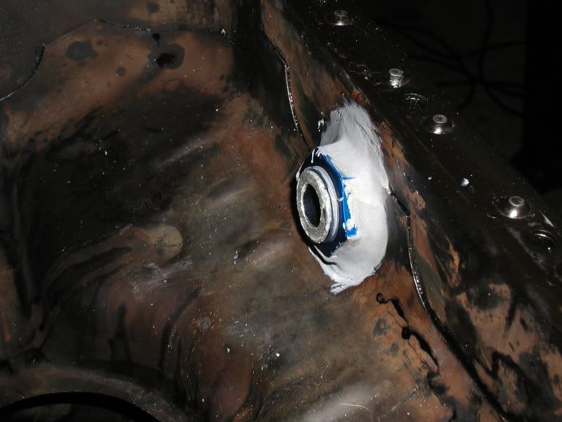

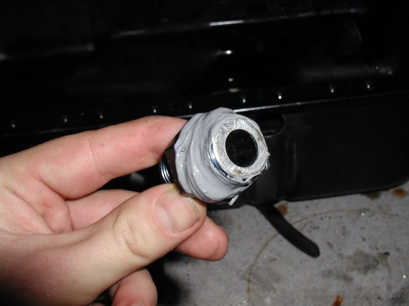

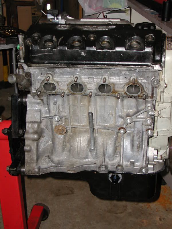

I had it apart once more to install the magnet.  Then got to do it again when I remembered the two dowells.  Now I'm freaking out cause I can't remember if I installed the interlock guide bolt.  It wasn't in my box of bolts for the transmission so I'm guessing I did
Oil drain hole lined up.  I'm planning on using the HY 35 and a full or mini-ram horn

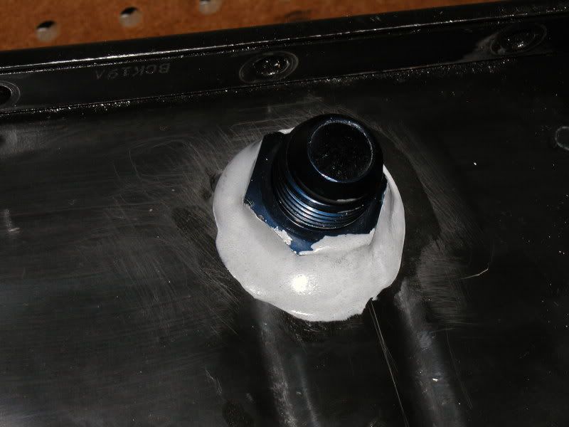

JB Weld plus -10
Outside
Inside
Installed.  I'm using a -10 cap to plug the hole while I brake it in N/A.  This way I don't have to take the pan off and on again later down the road

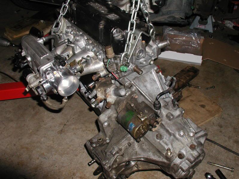

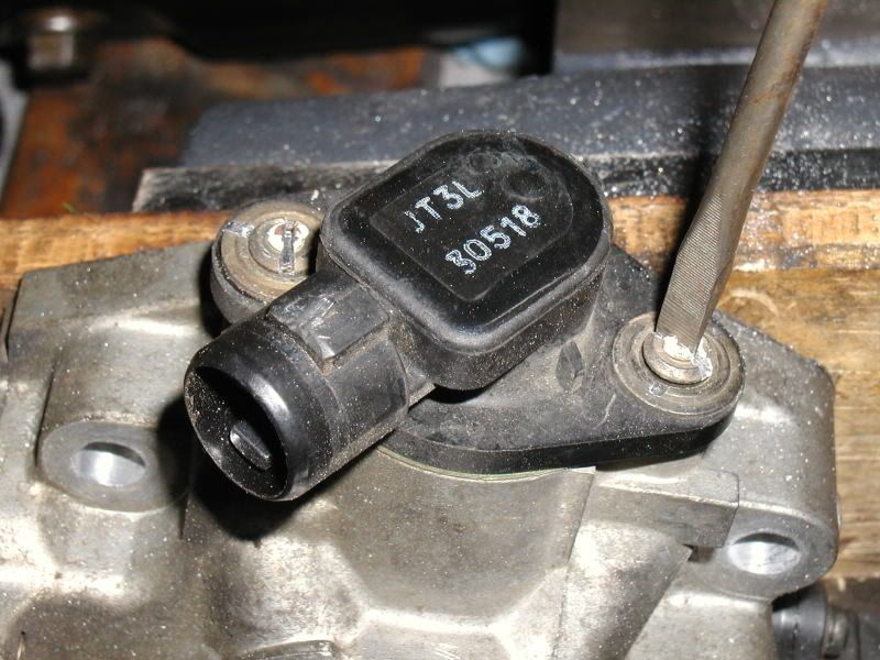

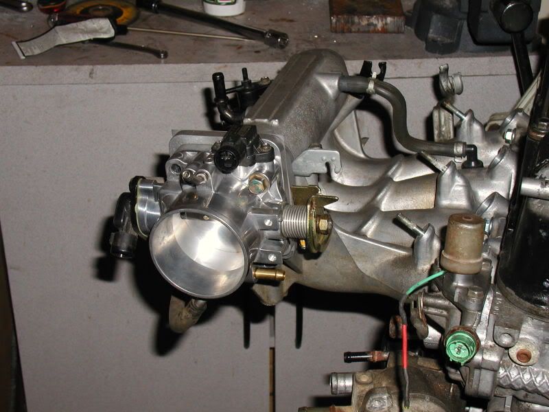

Answer to every n00b's favorite question, "How do I get the TPS off?"
Final shot of the TB and spacer with gaskets installed
Intake mostly ready

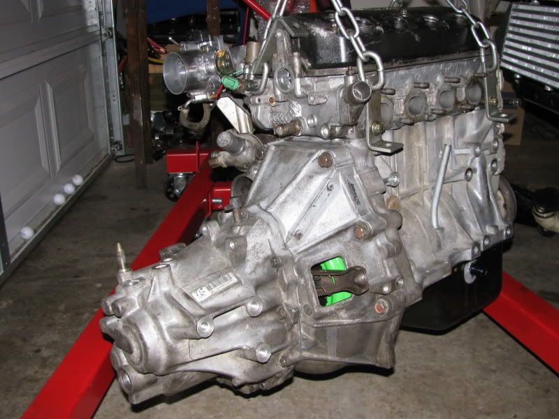

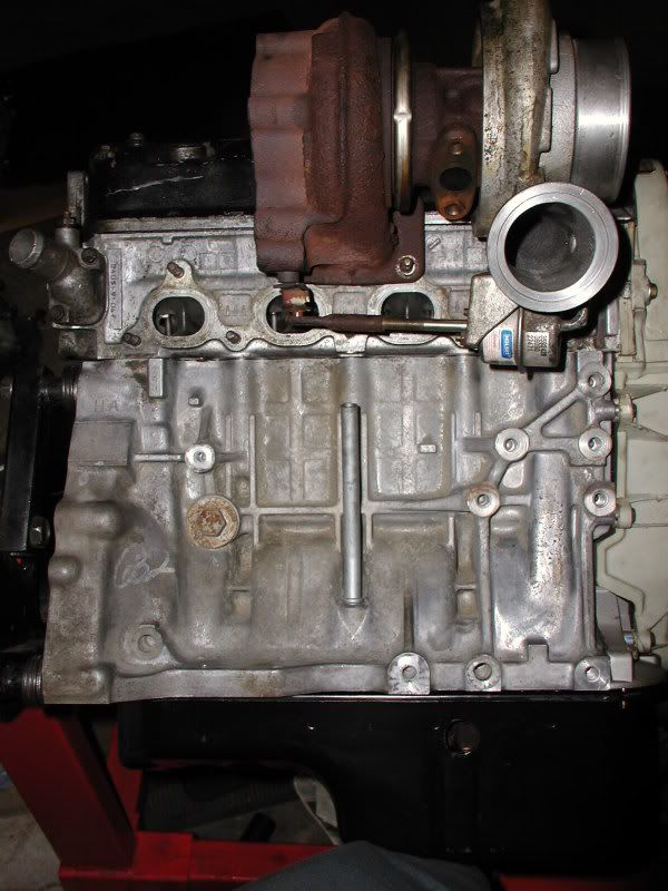

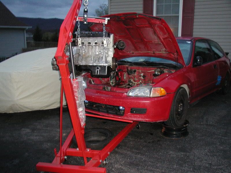

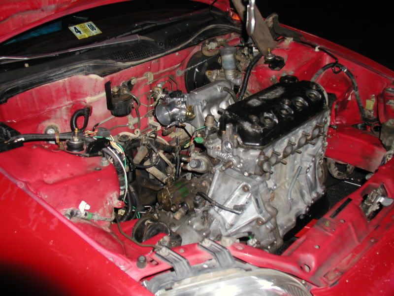

Transmission and engine making love.  I'll post pictures later of the clutch flywheel and pp
Feeding the hatch some drivetrain
Got it installed with two mounts before it started raining.  No A/C means tons of room for a turbo

use silcone gasket maker on the throttle body/spacer
« Reply #43 on: March 30, 2009, 09:45:26 AM »
I just cut one out of some gasket material I bought, then used sand paper to match it to the inside of everything.  It worked well and I drilled out the hole for whatever it is that sucks air.

nice write up with pics of the TB setup.
know anyone with a flow bench? I'm curious how the individual runners are affected by having the TB opening that much bigger and so close to the 1st runner.  Either way intake looks great man good job.
« Reply #47 on: March 31, 2009, 07:09:07 PM »
No I sure don't, and I'm worried too that it will increase air to that one cylinder and possibly run lean.  I can adjust that just for safety sake in crome and add like 5% to that cyl.

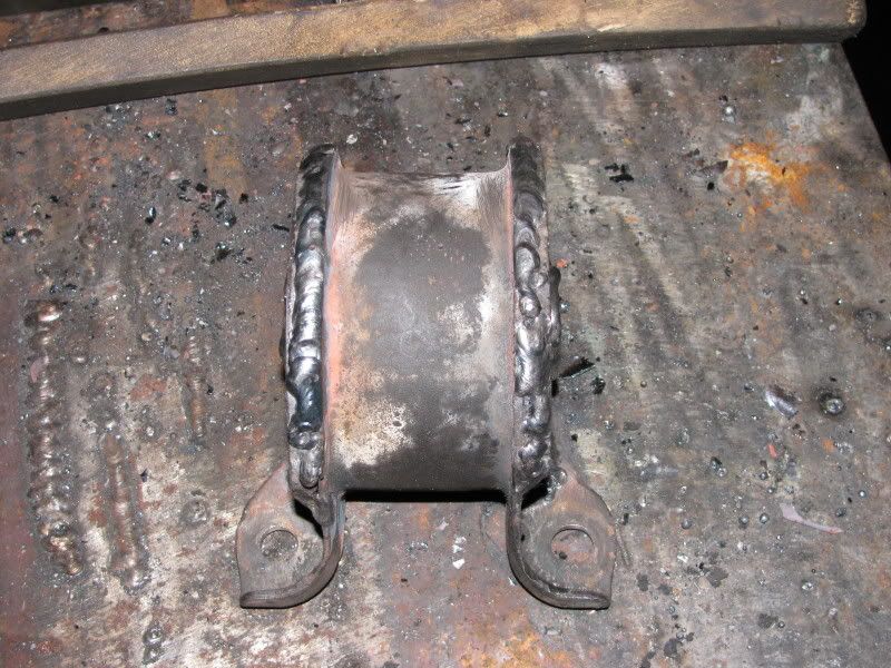

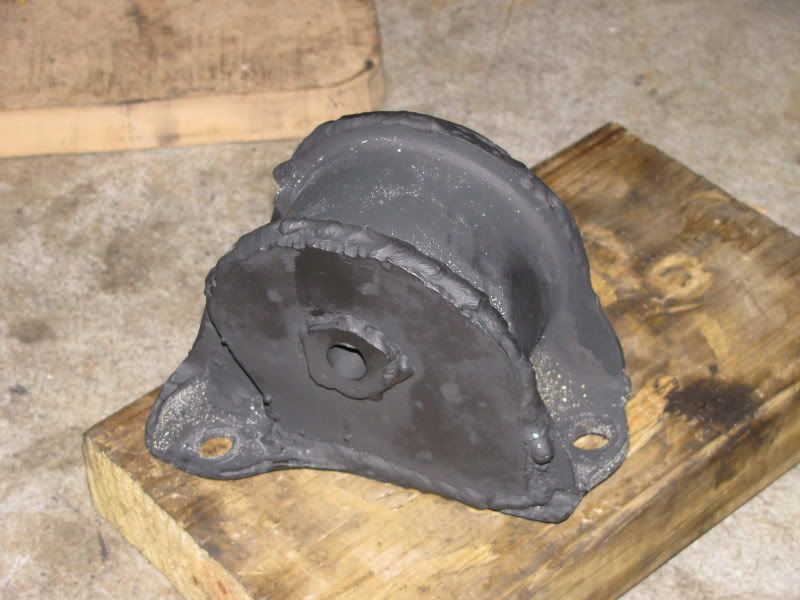

I'm taking a break so here's a few pictures

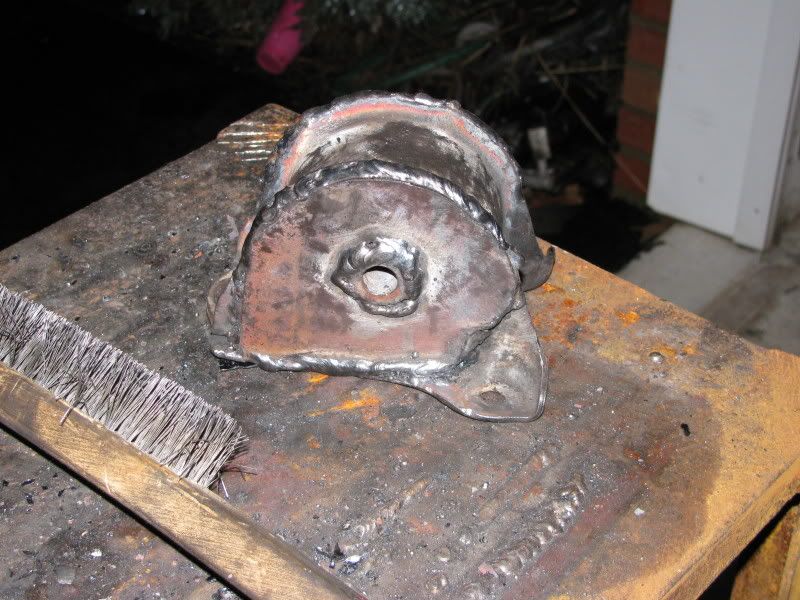

RHMT style solid mount, the rest will be matching soon, I just did this one up before I dropped in the motor cause it's the hardest to get to
Left room for the bolts

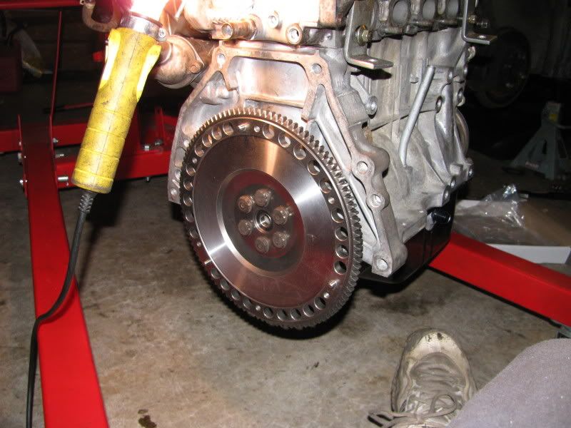

Flat black, FTW

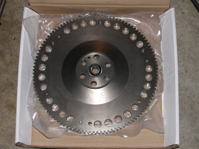

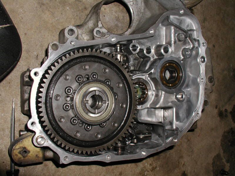

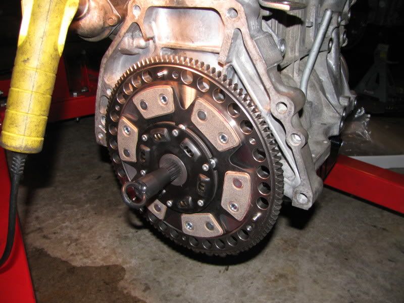

LSD Motorsport's light weight flywheel

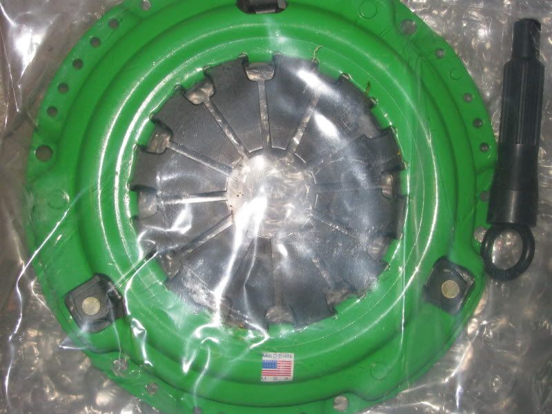

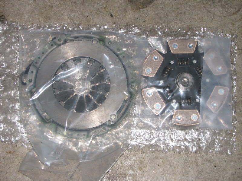

6 puck sprung dragger clutch and 300+ ft-lbs pressure plate

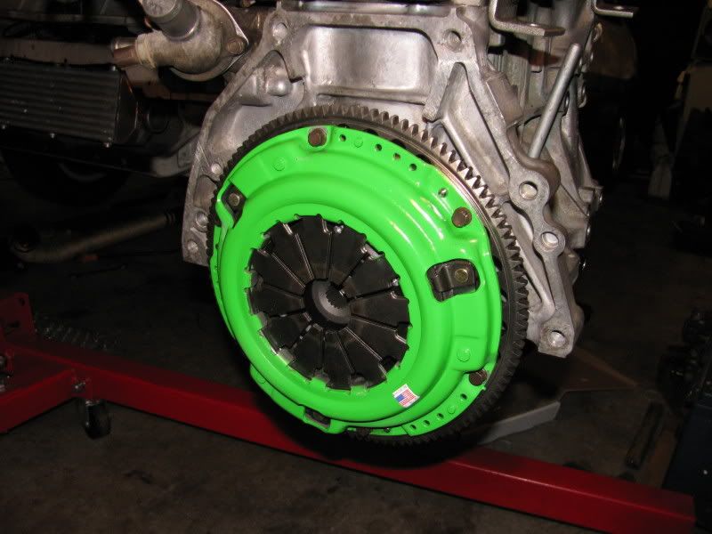

Green ain't my favorite color
The first fresh clutch I've installed on a Honda
And I've done about 4 of them total
Let me just say
It doesn't slip much at all.  Grabs like a freaking champ
That is all for now.  Boke an axle at the strip Friday night, but the OBX is still holding strong

I purchased that same TB, still havent installed it. Was going to buy a new intake mani first but maybe i'll just go and do it. I dont have a spacer though, whats the reason for the spacer?? And how do you control the idle? theres obiously no way the iacv will work without the ports there.
Lol...Fags
« Reply #56 on: April 22, 2009, 09:36:03 PM »
The hole in the spacer is for the iacv notice them in the pictures. There is an ungodly amount of these running around with no problems with the size hole in the spacer. Spacer is needed for oem Honda manifolds that dont have enough material in the plenum before you port into the iacv port. It is tapered and the iacv port is centered

Keeping it gangsta with the mount. rHMT at it's best.
Spanish-rice
  • Posts: 877
« Reply #58 on: April 24, 2009, 11:36:41 AM »
that mount is fucking baller. that looks noisy ha.
« Reply #59 on: April 27, 2009, 10:36:52 AM »
its the only solid mount i have currently installed, and it vibrates the interior like all hell.  but this is my 'race'car, not a daily driver by any means
