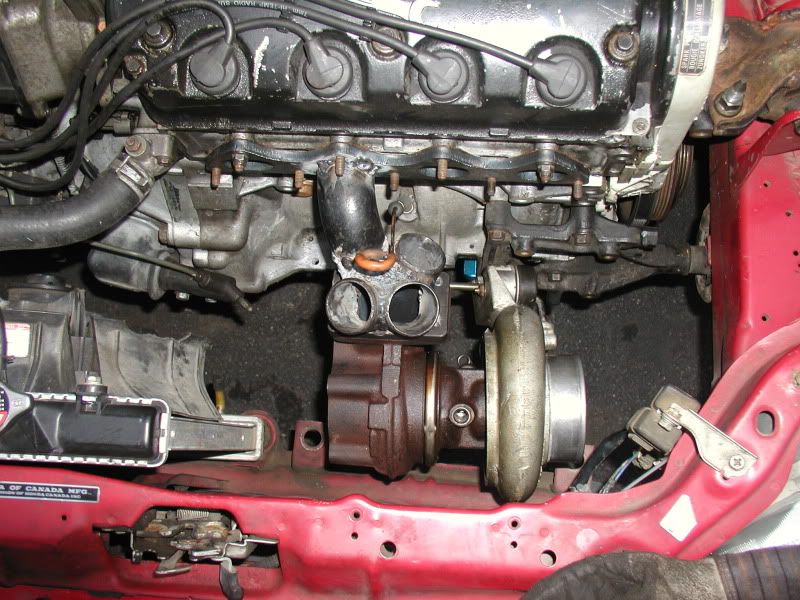

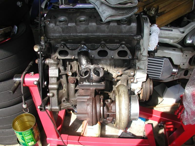

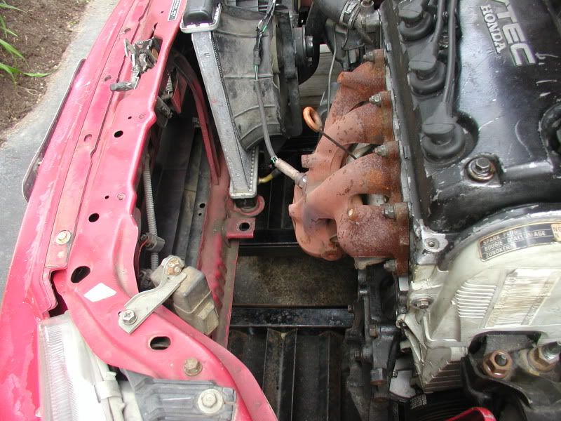

Here's where she sits.  About 700 mi on the engine
Plenty of room for maybe a top mount?  I haven't decided on what turbo manifold I'm going to make.  The oil pan is already tapped to have the drain in the middle
The one solid mount I have finished and installed.  I still need a pass side tranny mount for an EG for cheap.  Don't care what shape it's in as long the 'shell' is intact.  Window weld or whatever is fine, its getting my rHMT treatment

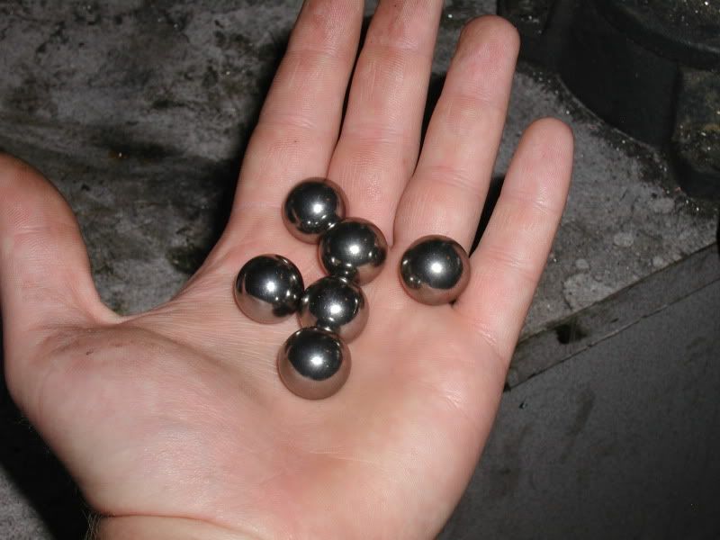

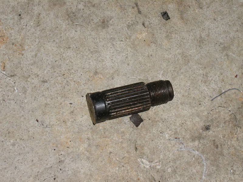

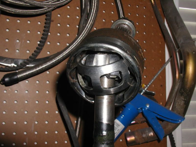

So anyway, I've got an axle that the outboard CV joint lost the retaining clip that holds the end on the stick.  It tore the boot, but other than that it was in good shape.  I want to save it and Honduhs service manual just says, "Do not attempt to dissasemble."  Well tough shit, cause it kinda dissassembeled itself.  I want to put it back together and I can't figure out how the hell it goes.  I afro engineered the snap ring.  I grinded it down and now it's a C clip that I just drove on the end with a punch.  The problem is that these bearings
wont' go into the end
without the actual stick not being there.  I can get 3 in but after that I can't figure out how to get it to do shit.  Then when you put the bearings in before you put the end on the stick, you can't get to the C clip to snap it on the end
Anyone ever rebuilt an outboard CV joint?  I'm at a loss, any help would be appreciated

just by a new axle it is cheaper usually like $50 to 75 after your old turned in as a core. ;D
most of the people I know keep an extra axle or two handy when they go drag racing. :yes:

Iv had a few apart, I cant remember the trick tho. It only goes in one way, I think it just takes time playing with it.

most times in my experience, once it goes back together indexed differently it will vibrate at high speeds due to the balancing job being done in one position and your assembly in another. Sometimes they take out bearings and seals in transmissions. be careful if you do get it together  ;D
Re: 350 or Bust - Love me some D NEED SOME AXLE HELP
« Reply #66 on: May 15, 2009, 10:15:17 AM »
interesteing.  the car has been on auto-x and drag strip duty only so I don't think it would be a huge deal.

toyota 4wd front axle rebuild = your answer on how to do honda axle rebuild same shit
Yea, don't own a 'yota.  But I did manage to get the axle back together with the help of a die grinder.  The bearings should stay in there, but it will definatley be for backup only.

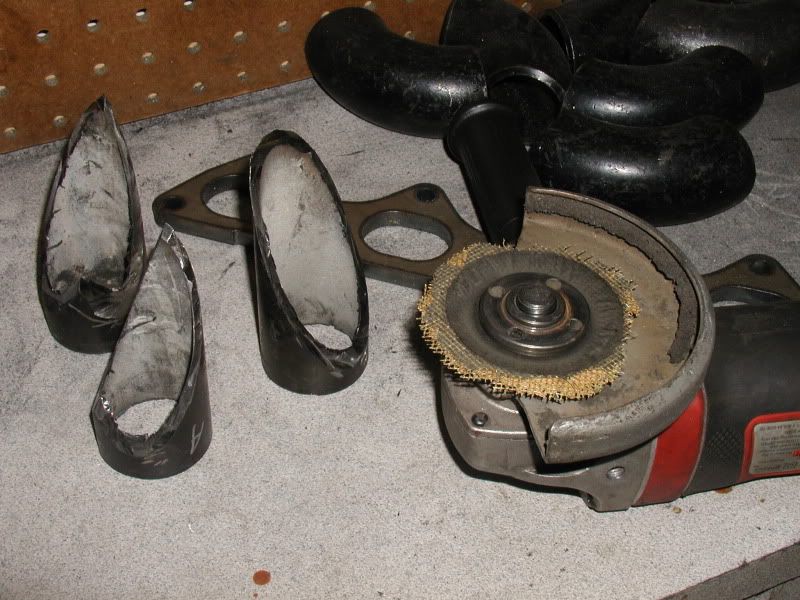

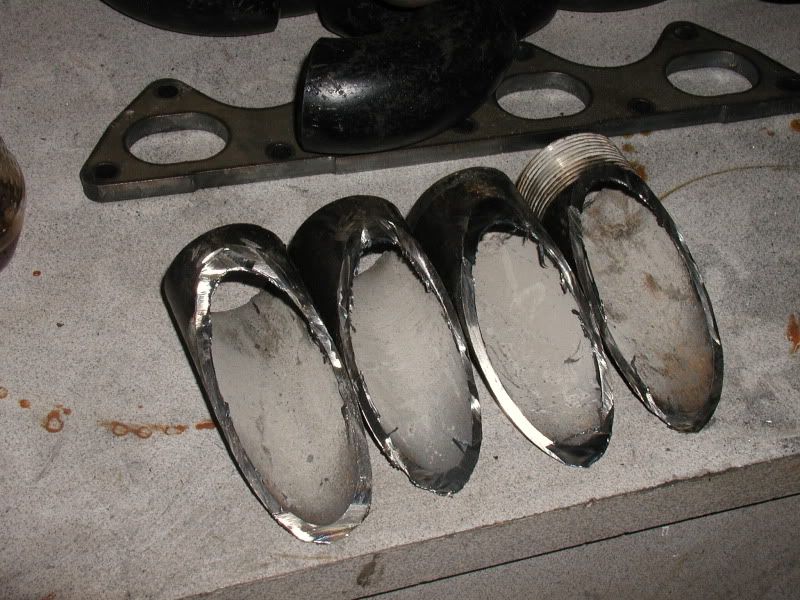

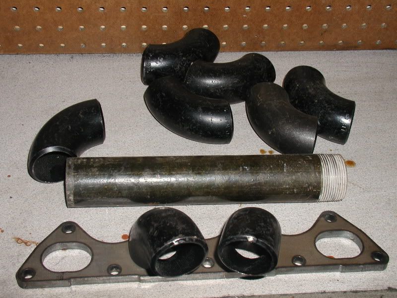

After failing the inspection this morning, I decided to start on my exhaust manifold.
Raw materials
Band saw and jig
First cut
Eyeballing the second cut
Then the blade broke on the band saw
I don't have any more thin discs so I'm headed to True Value to pick up a couple more.  Also need a little more sch 40 pipe to make the 1 and 4 runners.  Hopefully will get a little more done today or tomorrow.

nice band saw, what did they fail on the car?
Re: 350 or Bust - Love me some D sarted the manifold
« Reply #75 on: June 05, 2009, 05:36:40 PM »
driver's side window crank was 'missing' in the floor of the pass side, blower motor is not working, and I didn't fool them with the resonator looks like a cat trick

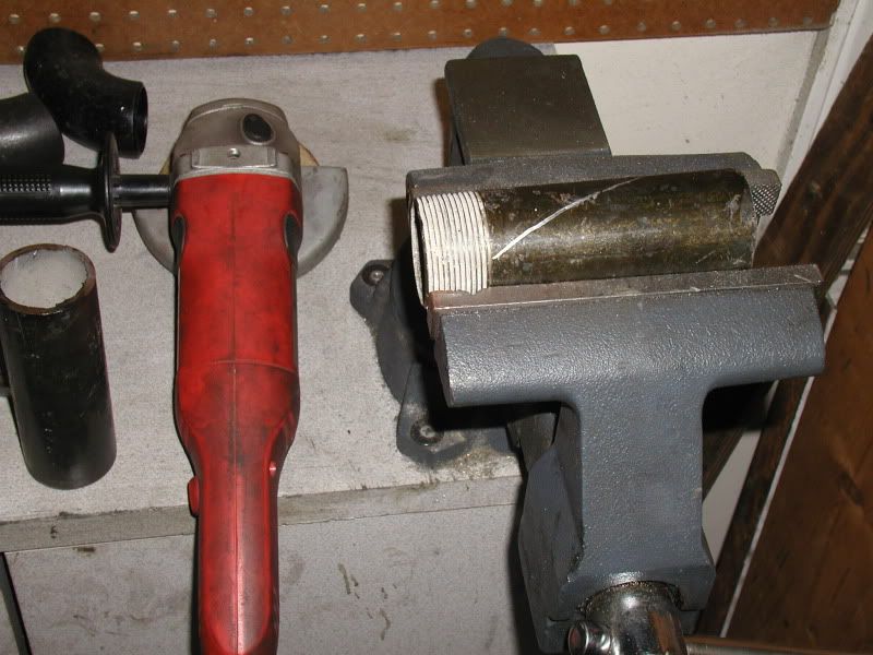

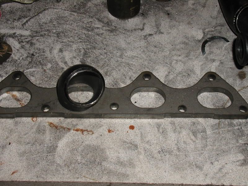

« Reply #77 on: June 14, 2009, 12:03:10 AM »
Got the second cut done and tacked
Fits like a glove.....

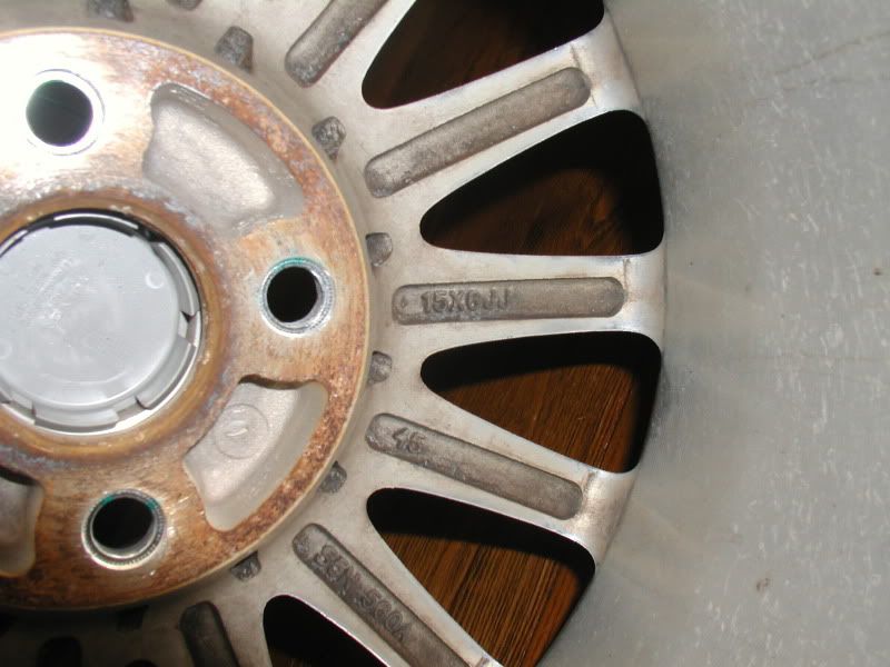

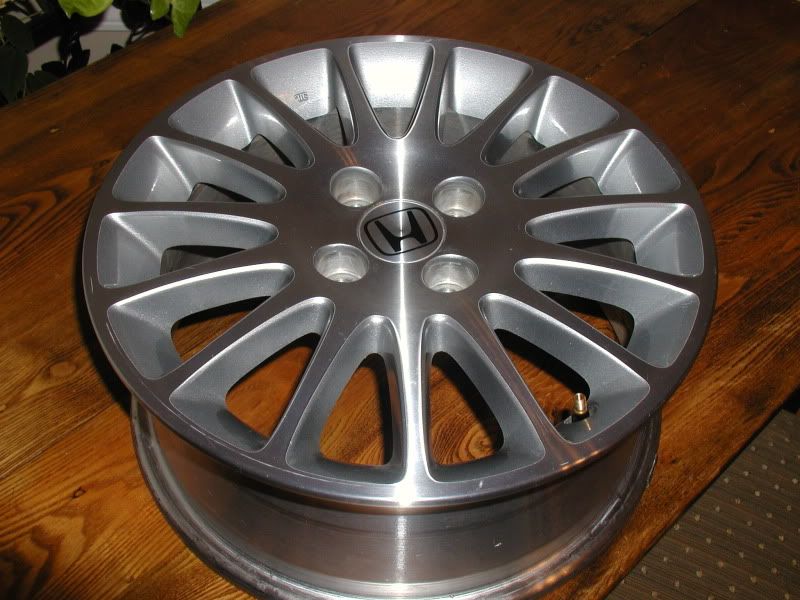

Picked up some new wheels
Not sure about the off set and how well they will fit but I love this style

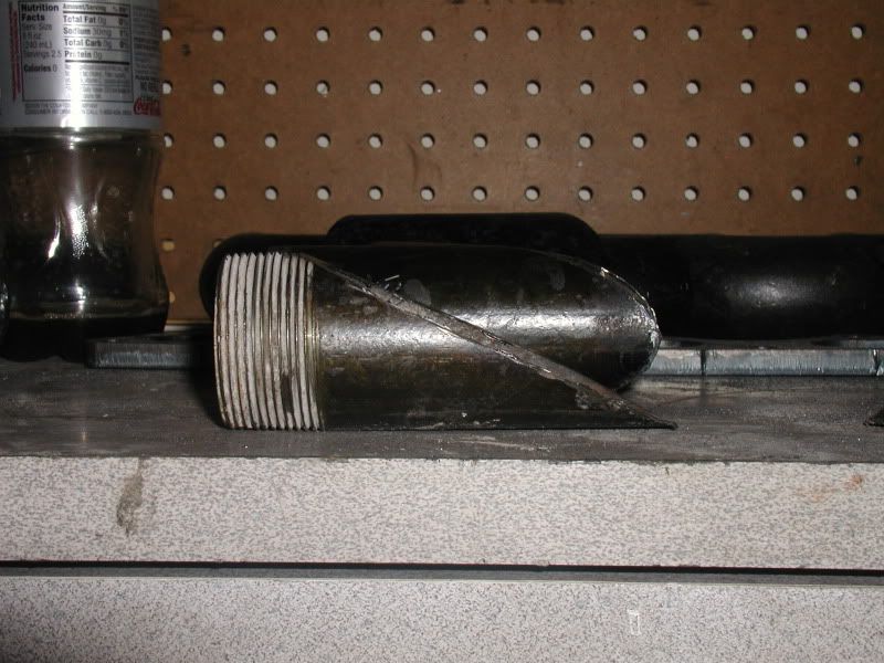

btw wtf are u using the threaded end of that pipe on your clollector.   thats not a good idea.
« Reply #79 on: June 15, 2009, 05:40:51 PM »
he's using an angle grinder to make a collector and your worried about the threaded part being at the collector.

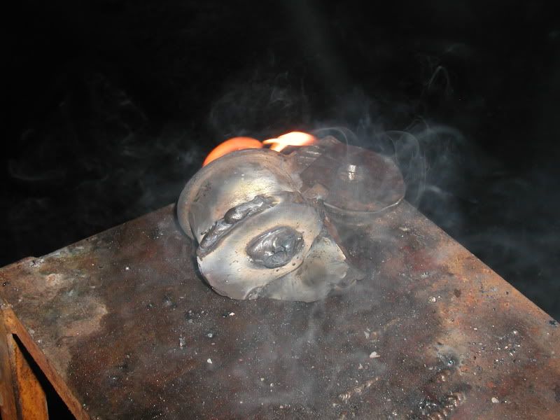

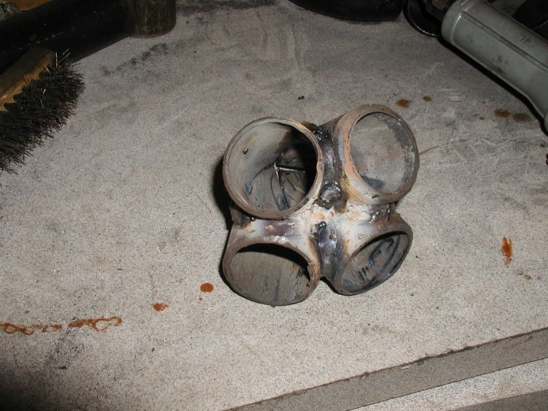

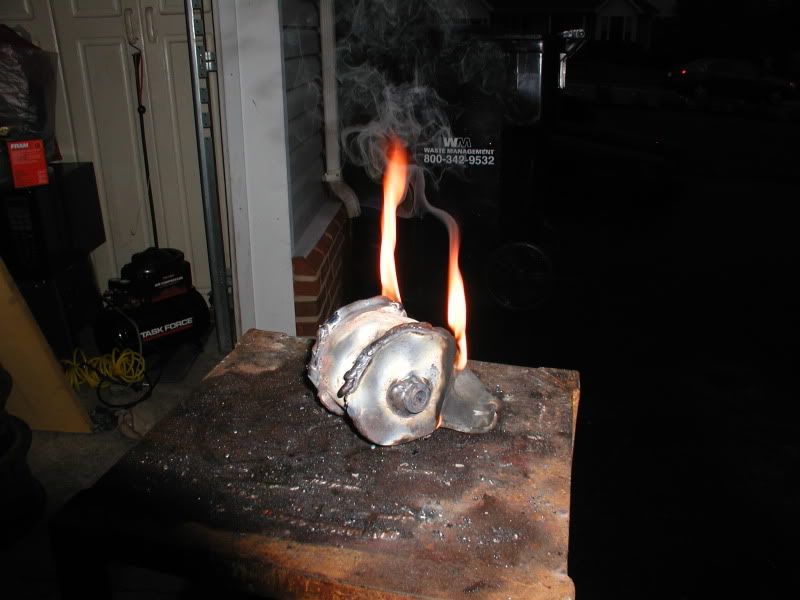

Collector almost finished.  Probably will hit it with the chipping hammer and a wire brush to see if I need to go over anything again
1/8" 6013 @ 95 amps FTW

That shit is pro right there.  Rocking straight up farmer rod to get that shit done.   Thats motherfucking RHMT right there O0
« Reply #82 on: June 16, 2009, 01:28:45 PM »
it'll look like ass once you chip that slag off

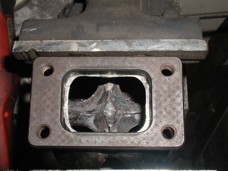

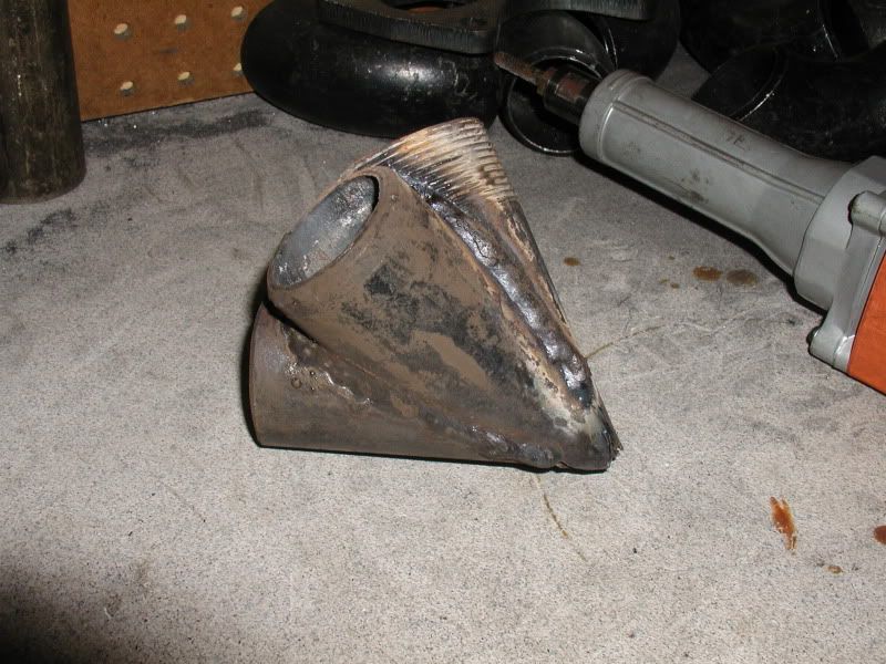

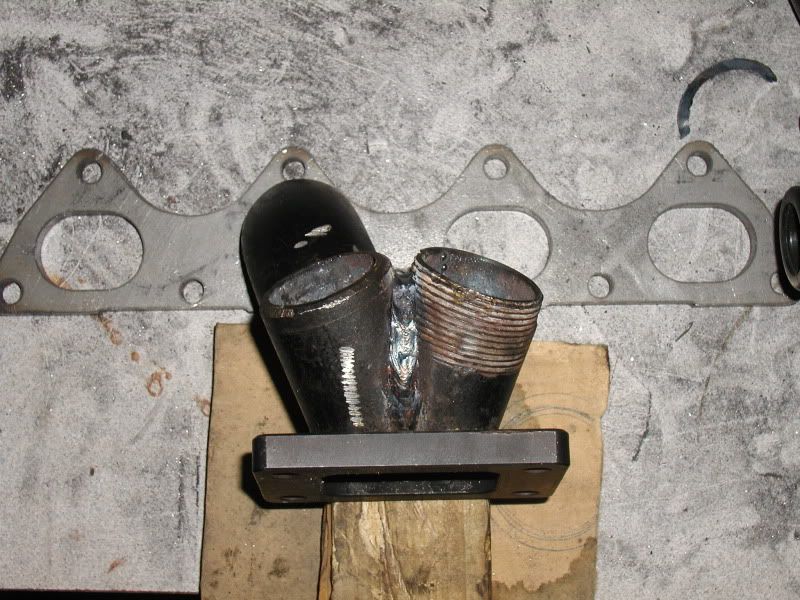

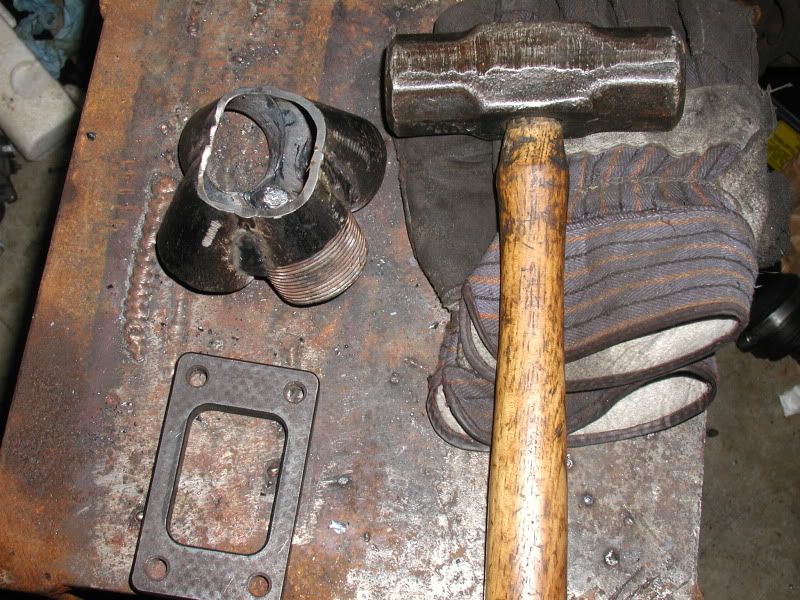

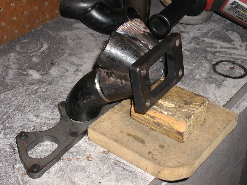

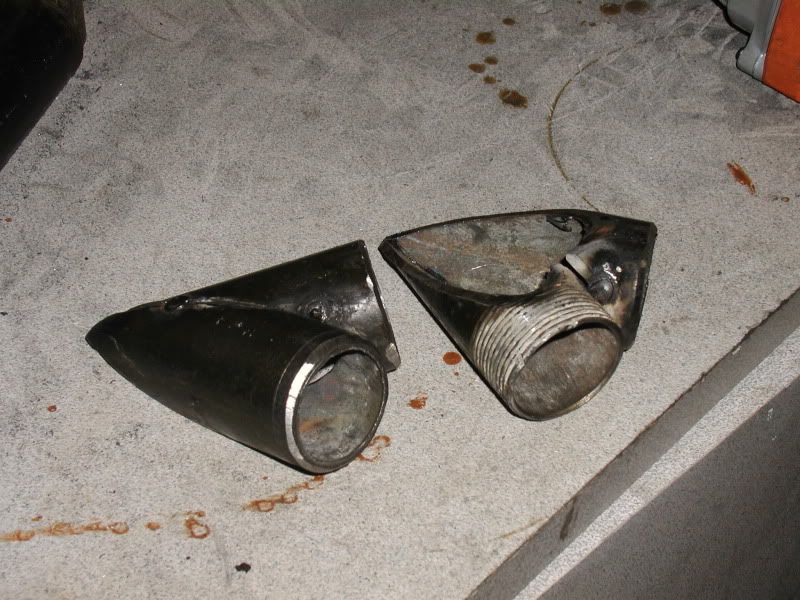

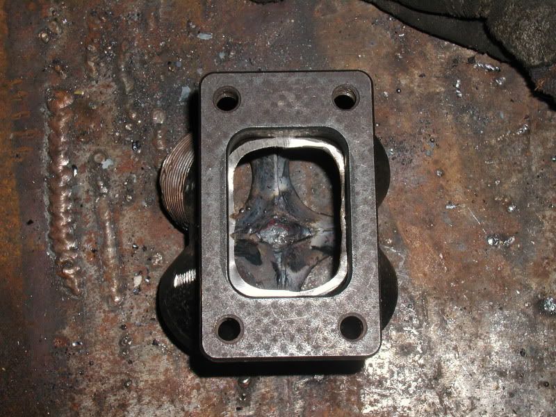

Had an hour of free time today.  Here's the collector cut, and 'smashed' flat on one side to fit the T3 flange
Test fit before I cleaned up the edges
You can see where I hit the point of the inside of the collector just to clean it up a little.  I'm going to go back and clean it up real good with some more die grinder action and a few sand paper rolls
The plan is to tack weld one runner, collector, and both flanges together, then try a test fit
Then once I'm happy with fitment and clearances, finish making the other runners
Any tips on what order to finish weld everything up?

dude why did u use the threaded part of the nipple u clearly bought from home depot.  the metal is significantly thinner where its ben threaded/    anyways weld the two inner runners firts then the two outers.
Ghetto_D
  • Posts: 2283
« Reply #86 on: July 01, 2009, 06:49:20 PM »
i am going to agree with mr hotrex. on that one. Weld the two inner ones first, especially if your using a mig.
At the time I started the manifold, the piece of pipe was the only straight I had.  It came from work, a cement plant, and I know the metal is thinner, I've already thougth about having to turn the amps down when welding to that runner.  It won't be an issue and it will still probably turn out better than some of your manifolds from the past.
Thanks for the tips on what to weld first, I was planning on just tacking the first runner, collector and flange together and then do a test fit.  If it all checks out, then I'm going to fully weld said parts, and then start on the collector for the number 2, then fully weld that, then finish with the outter two runners.

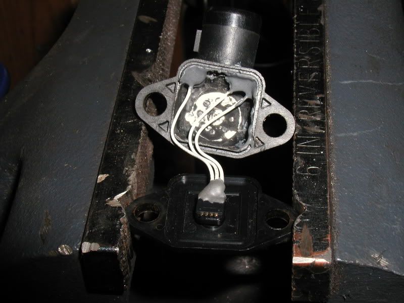

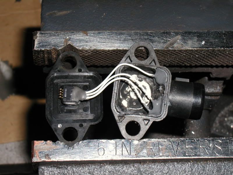

On a side note, yesterday I did the freescale 3 bar map sensor in stock housing, and it isn't turning out too well.  Car won't idle or even rev past 2500.  No cels with the proper map sensor selected in Crome, but still won't run right.  I'm horrible at soldering, so I'm betting I cooked the sensor.  I've go a buddy that is going to come do another one I have laying around tonight that actually knows what he's doing with an iron.
« Reply #88 on: July 08, 2009, 02:10:59 PM »
Thank goodness for friends that are electrical engineers.  Big thanks to Red Chris for helping me with the 4bar freescale install.  Car runs just fine when you don't cook the sensor.

Pics of the 4bar install
JB Weld doesn't conduct electricity.  Case was filled with RTV sealant and let to dry overnight clamped together

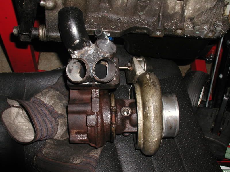

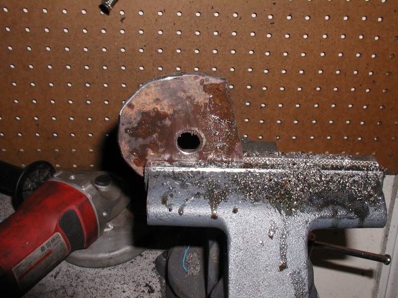

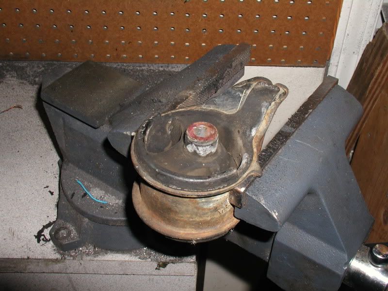

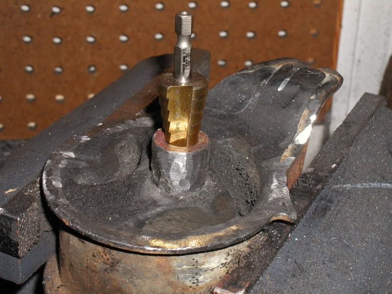

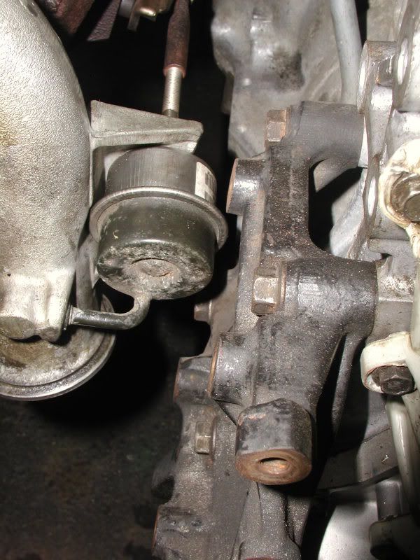

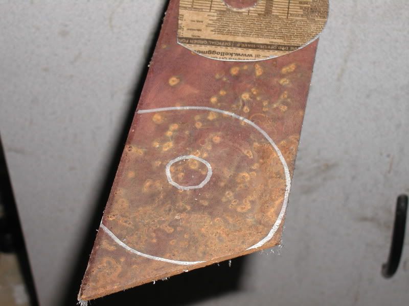

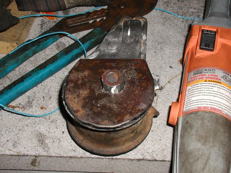

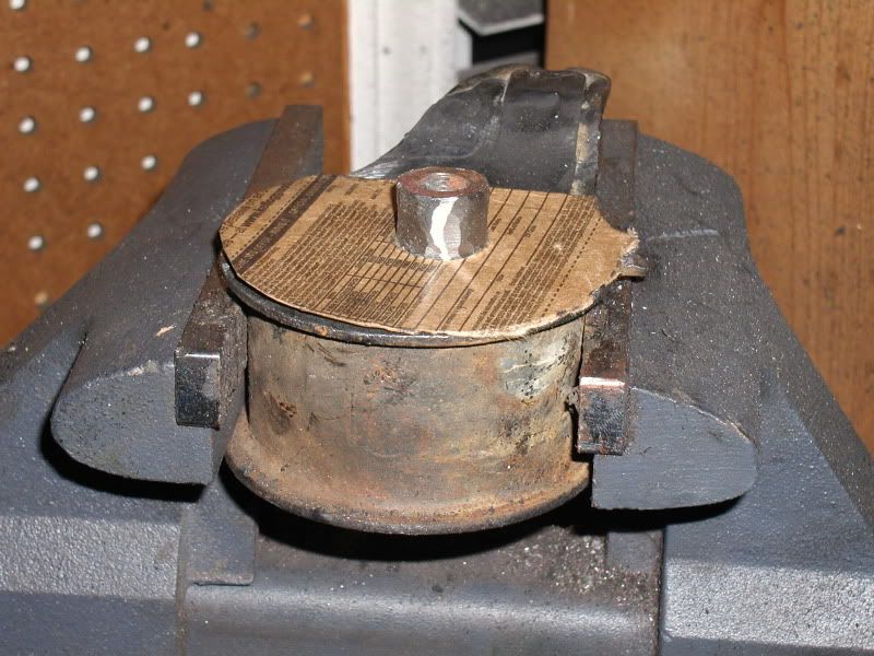

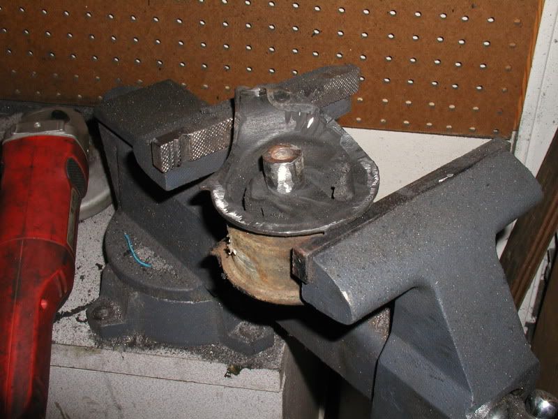

Some other work I got done recently.  Stock driver's side mount
Grind some rubber off
Make a template
Some junk flat stock I had laying around
Harbor Freight stepped drill bit.  I think I paid 9 bucks for 3 of them.  Well worth it, these things are awesome
Cut out and drilled
Drill bit wasn't big enough so had to enlarge the hole with the die grinder
One side done
Both sides done

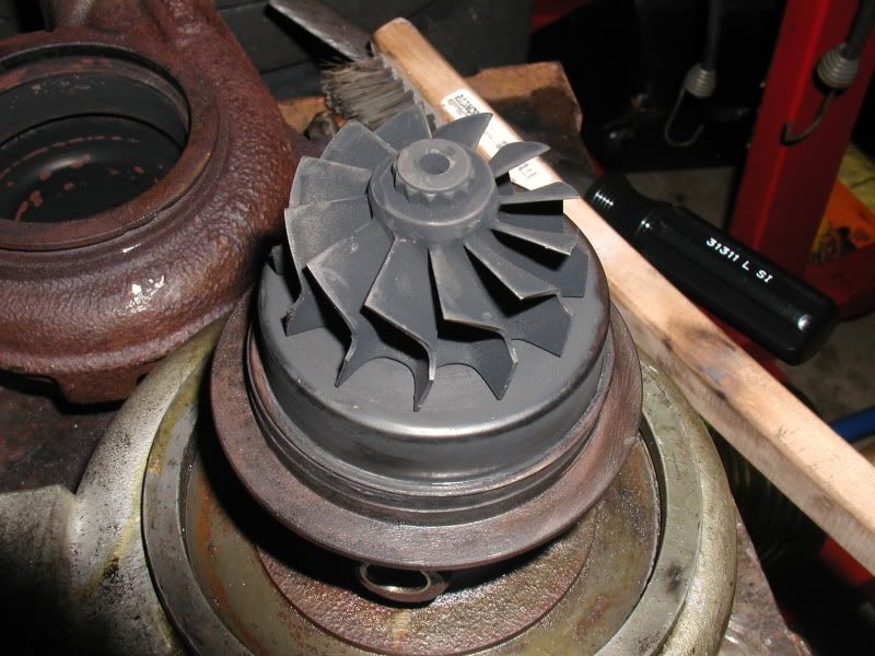

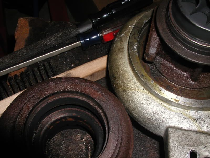

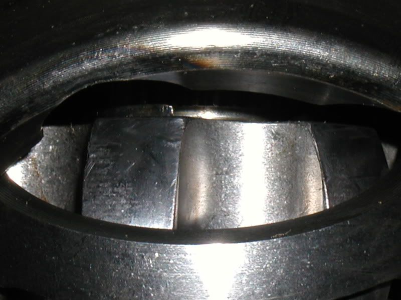

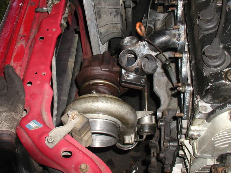

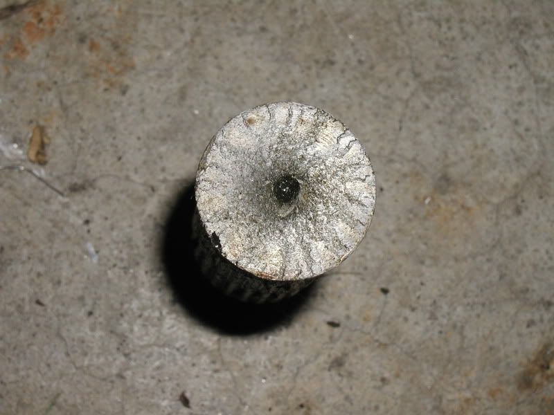

Turbo tore apart to clock
Both the turbine and compressor housing are pinned.  Now they both are not
Small hairline crack in the waste gate port.  I don't think it will be a problem
One runner on

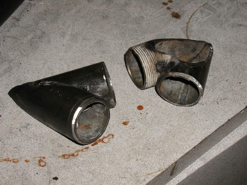

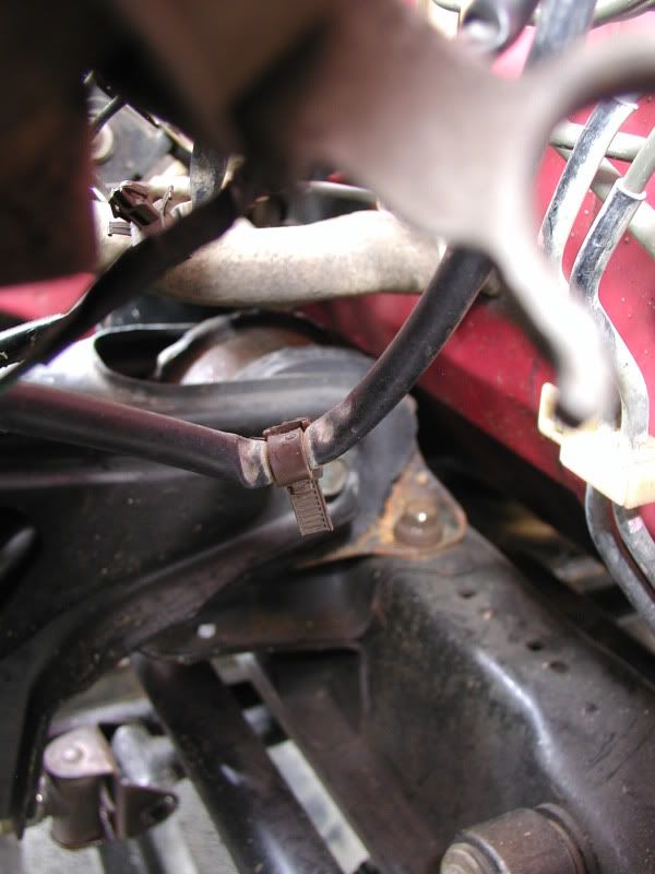

Took some test fitting, and sacraficing an elbow, but it looks pretty good
In car fit test.  Down pipe shouldn't bee to bad to fab up
Still plenty of room
The only tight spot.  Looks like a HX-35 would fitt too.  I'll double check before final install
Thats it for now.  Will weld up that runner and get started on the others soon.
