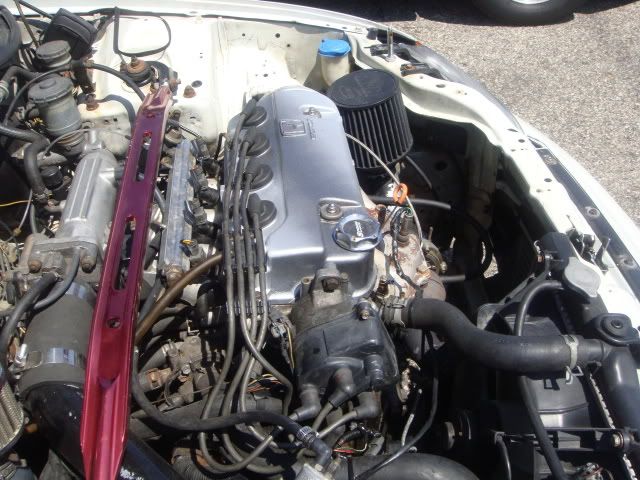

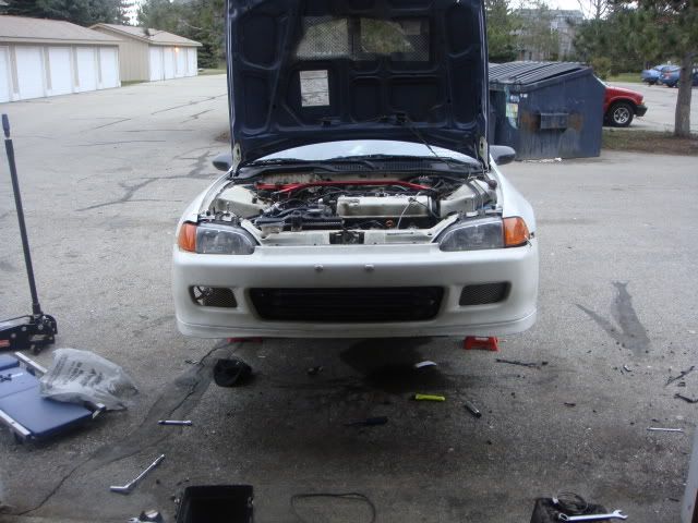

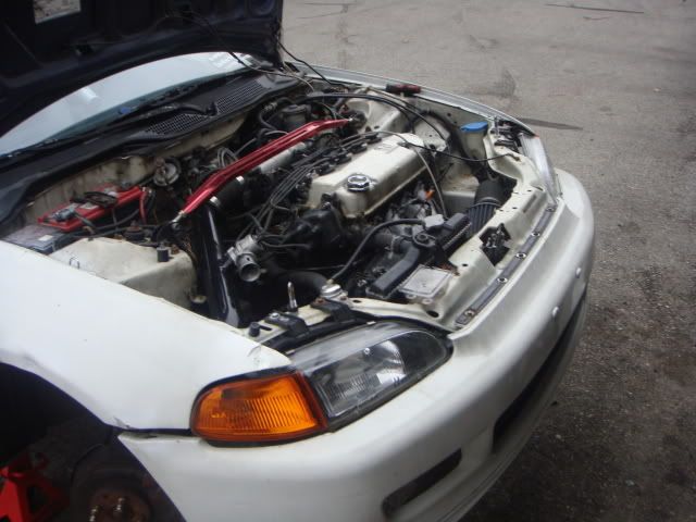

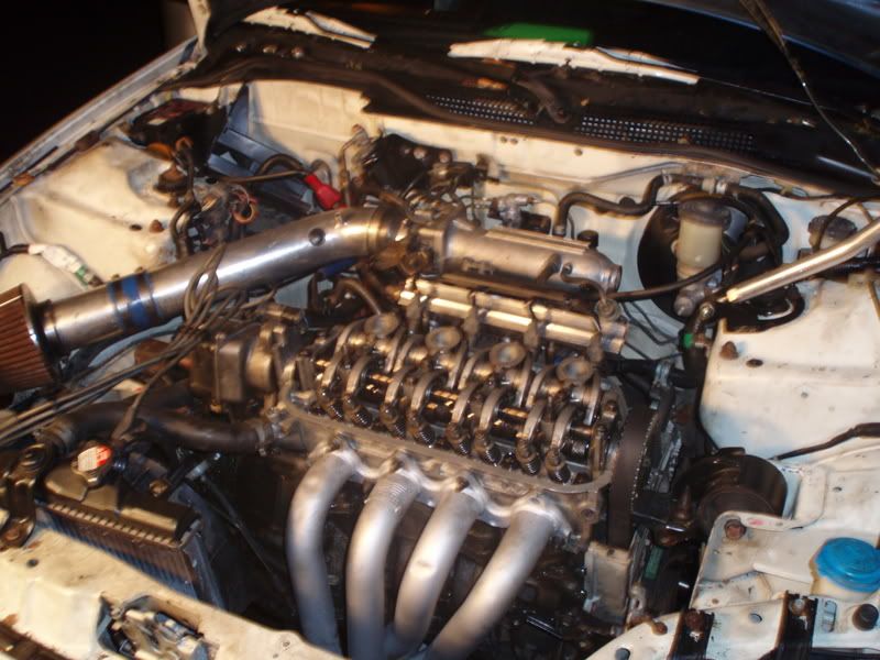

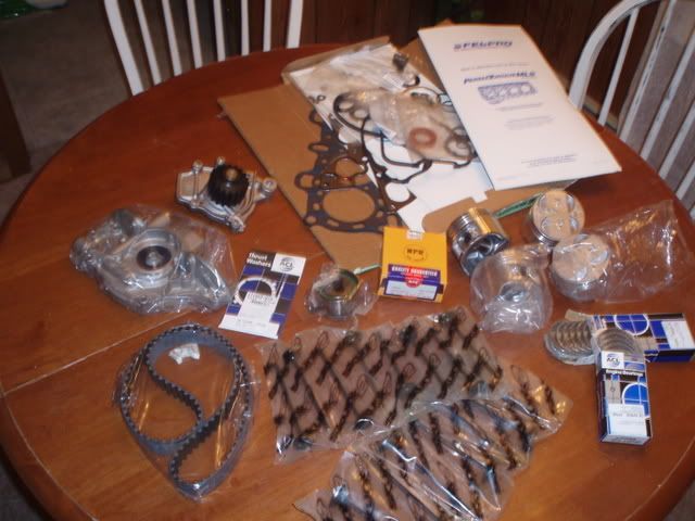

well i have almost all my parts for a turbo build so i figured i'd start a build thread. i have a new computer so i dont have to many older pics but i'll try to start at the begining.
in nov. 07 i bought a cx hatchie with a wonderful d15b8 in it, soon after purchase i started noticing the temp going up and some funny idol problems. i had a spare b7 head lying around so i figured i do a head swap and get 30 extra ponies. well turns out there are three snapped head bolts, to top it off the easy out snapped off in the block doing the last hole. thats when that block got stripped down for spare parts and went to the trash can.

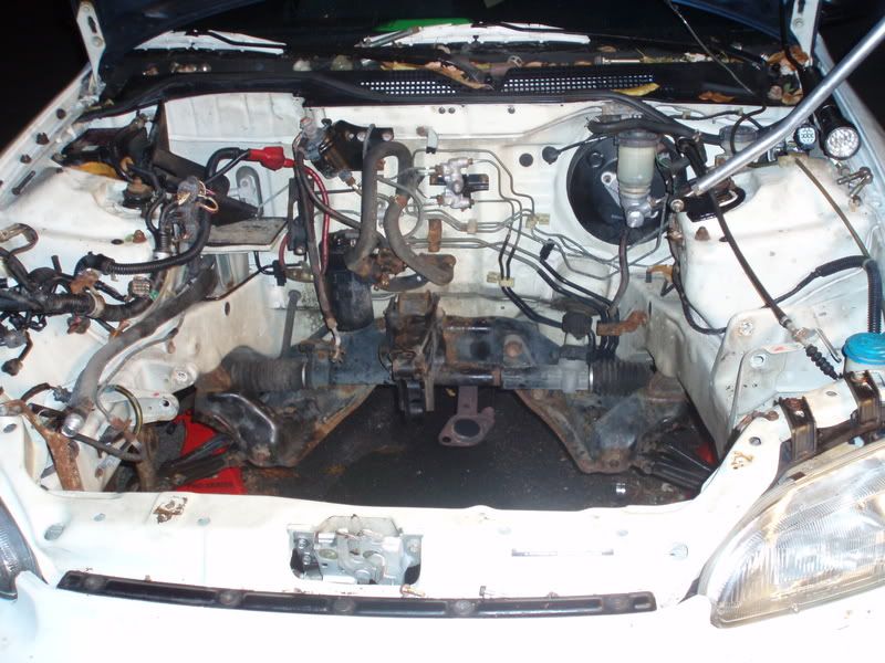

so i took my perfectly good 4dr and ripped its heart out
^^^^^my buddy matt has helped me out alot w/ this project.
then put it in the hatch

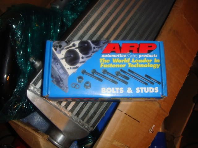

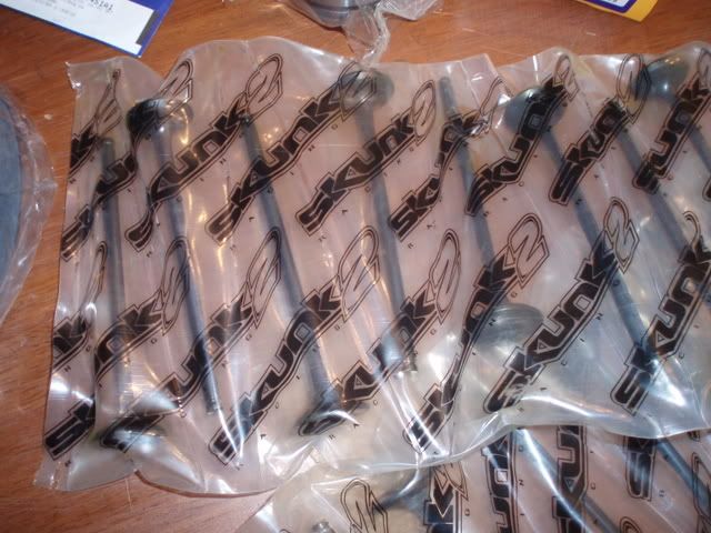

some goodies for the new motor

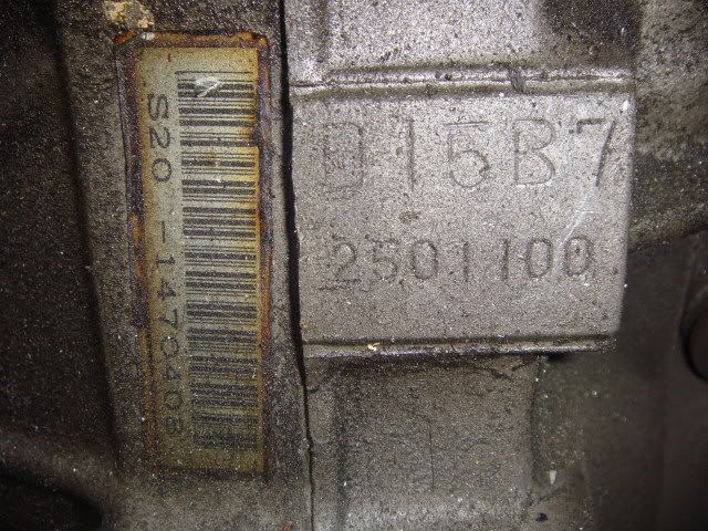

also at autozone i noticed that the code for d16z6 and d15b7 valves were the same. so in place of the old worn out ones in the d15 got a skunk2 upgrade(exhaust side fit intake didnt, so all new oem's went on the intake side or it may have been the other way around not sure)

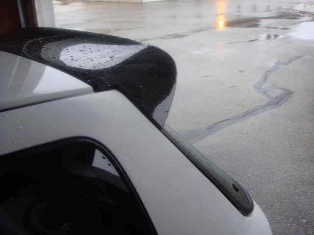

carbon fiber duckbill

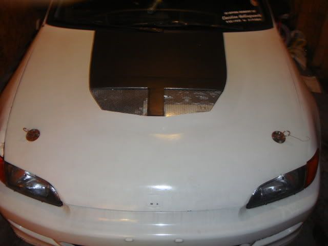

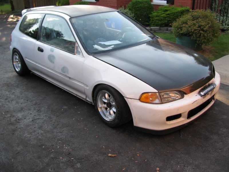

custom evo style hood ( yeah i made that, not bad for a days work)

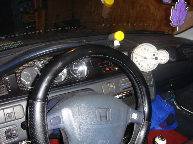

5" autometer monster tach
2 5/8s water temp gauge
carbon fiber block off plate w/ autometer boost and oil pressure gauges
carbon fiber gauge cluster
rear strut bar
red l.e.d's in gauge cluster(looks nice)

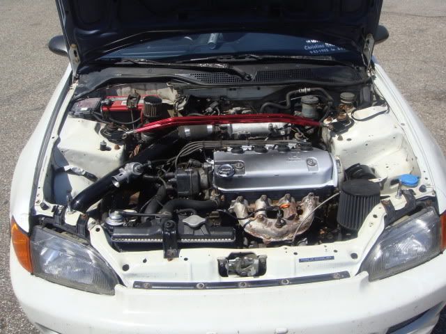

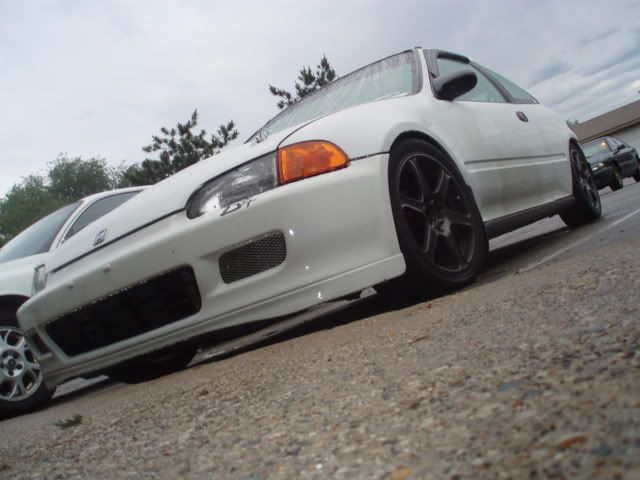

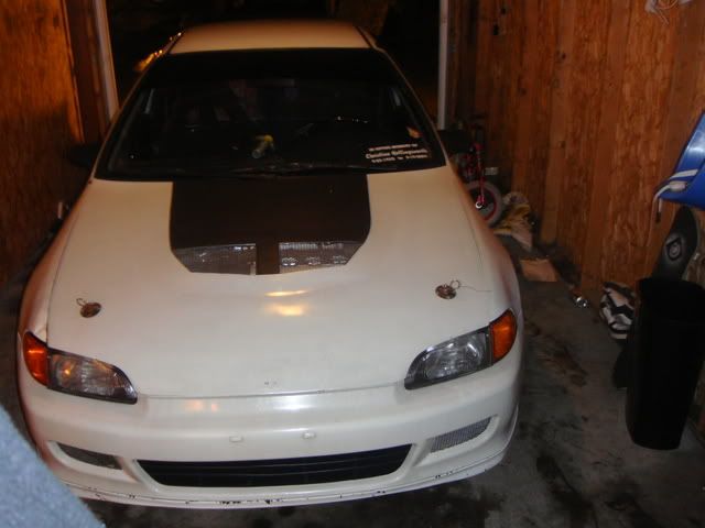

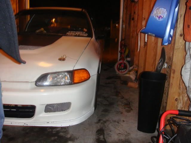

this is from this morning
as soon as it warms up i gonna respray the whole car white cuz it looks like ish right now as well as a new pass fender
next spring or maybe later this year i was thinking i may go with a fiji blue pearl with bronze rims, bronze engine bay and interier

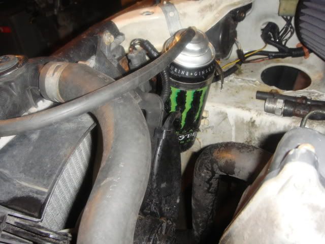

best over flow bottle ever....well second best swapping to a rockstar suger free here soon

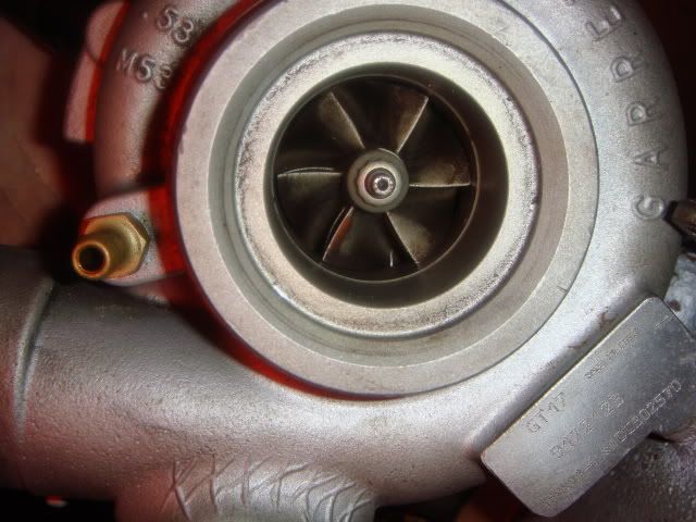

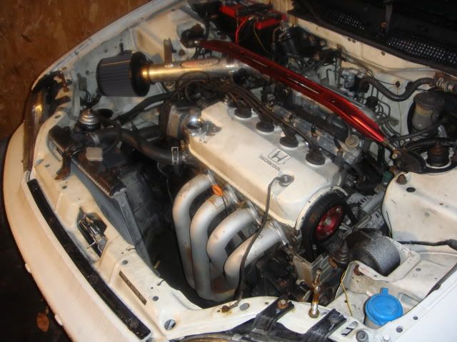

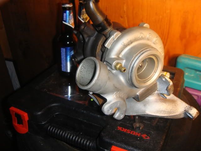

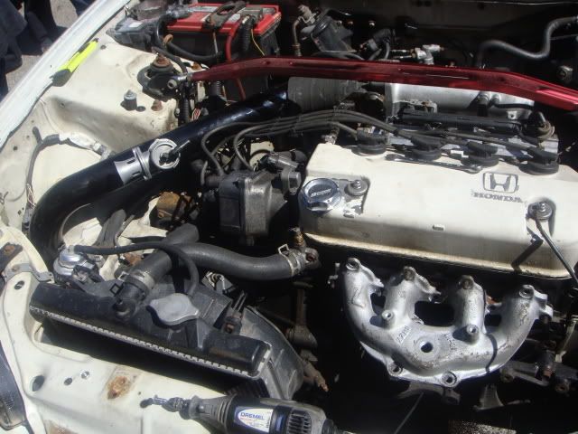

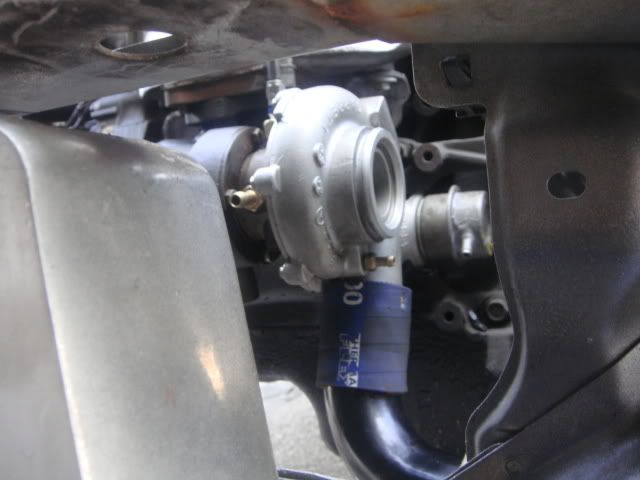

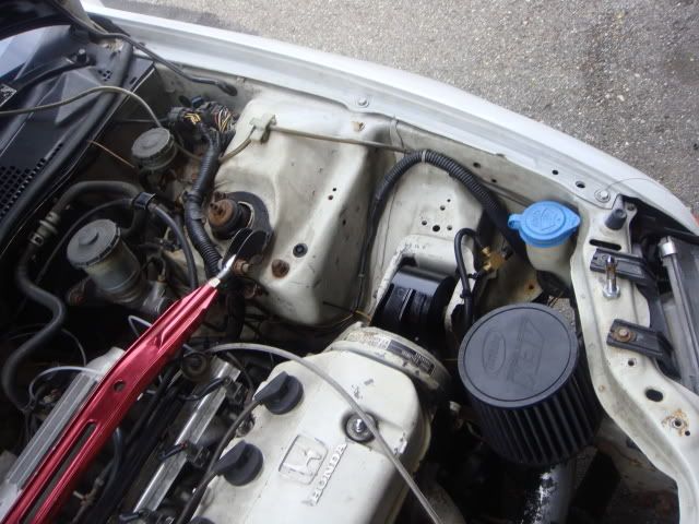

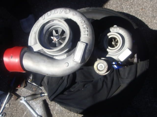

now here is the turbo goodies

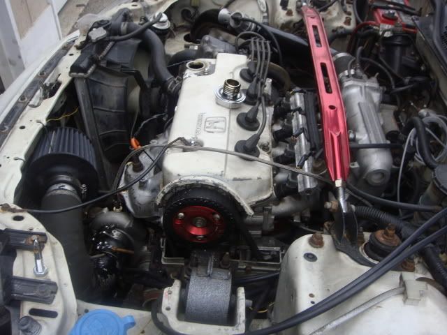

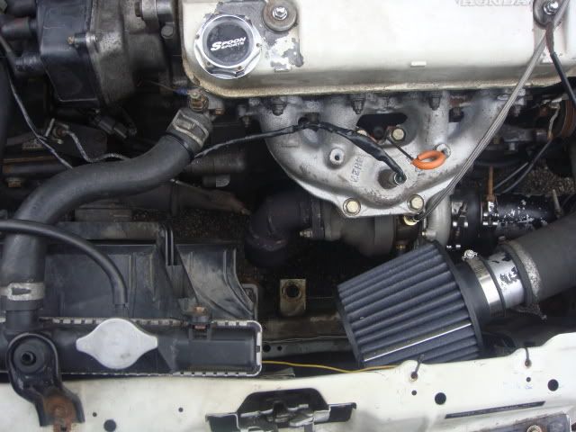

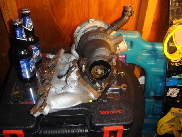

hf maniw/ adapter plate and garrett gt-17 turbo

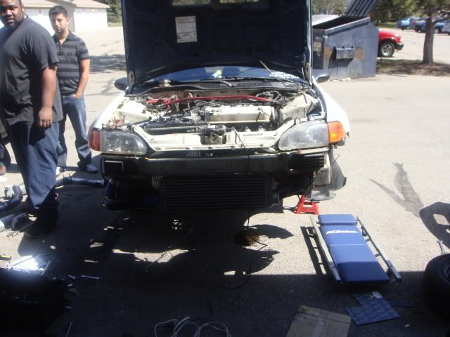

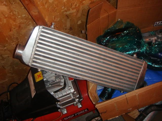

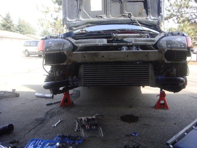

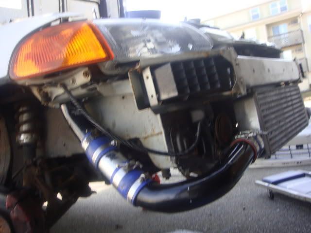

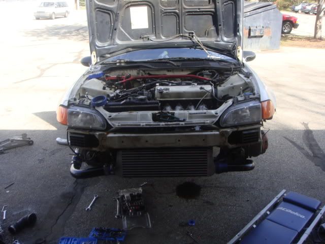

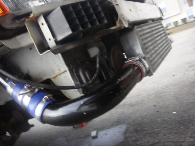

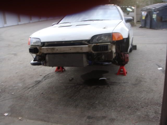

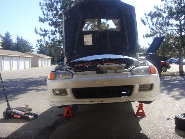

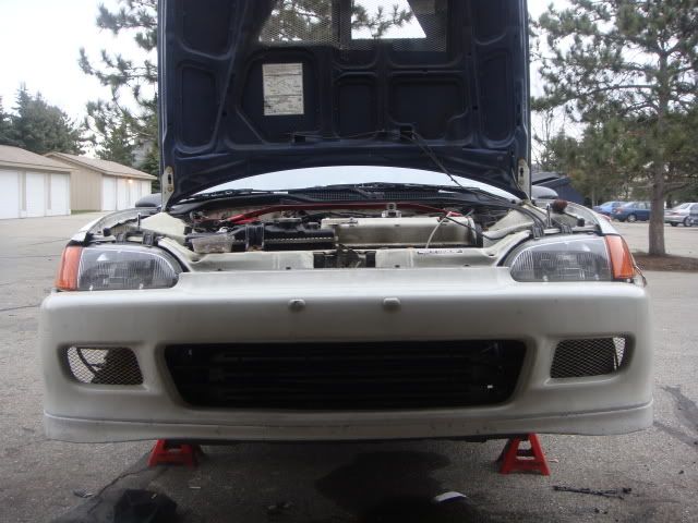

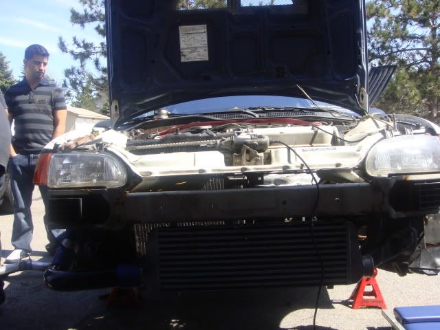

front mount intercooler

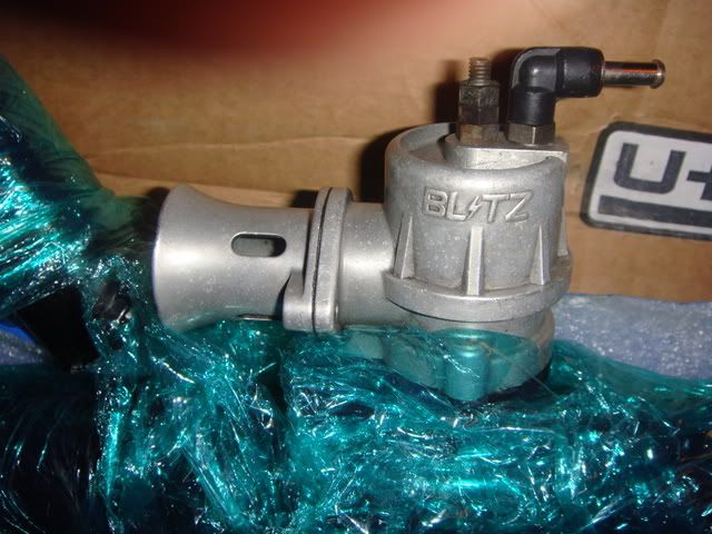

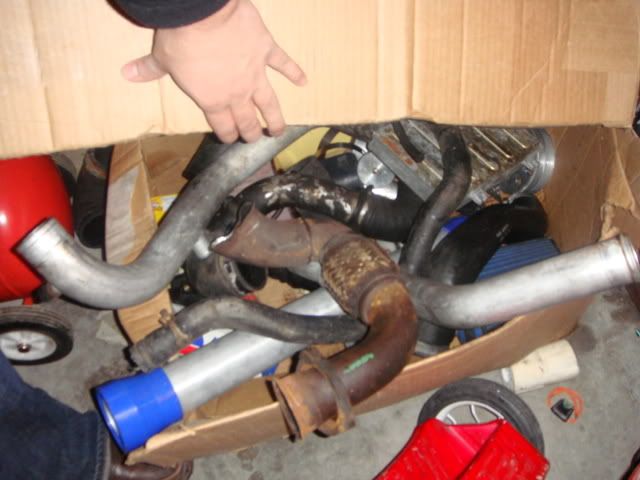

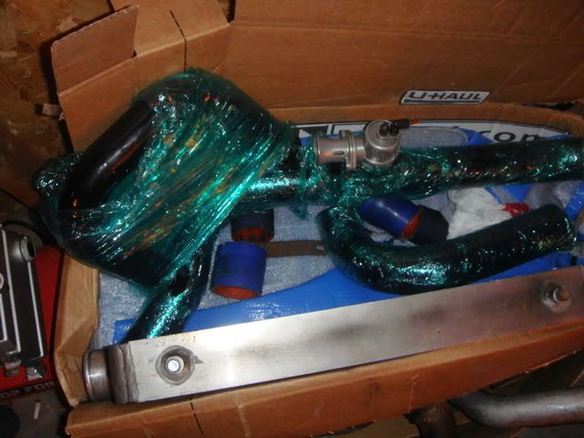

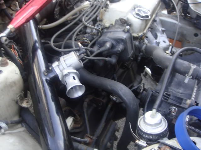

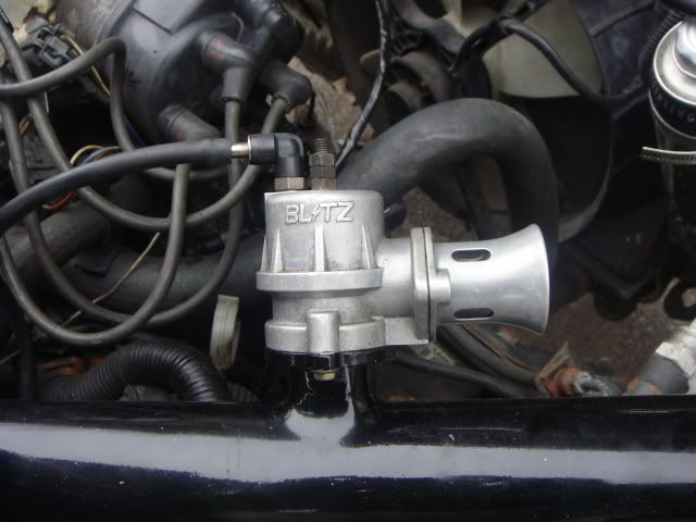

blitz bov and custom black mandrel bent piping(turbo to ic is 2" and ic to tb is 2.5")
stock gt-17 down pipe and a bunch of random ic pipes and couplers off stock volvos, sabbs and what ever else i saw boosted at the junk yard

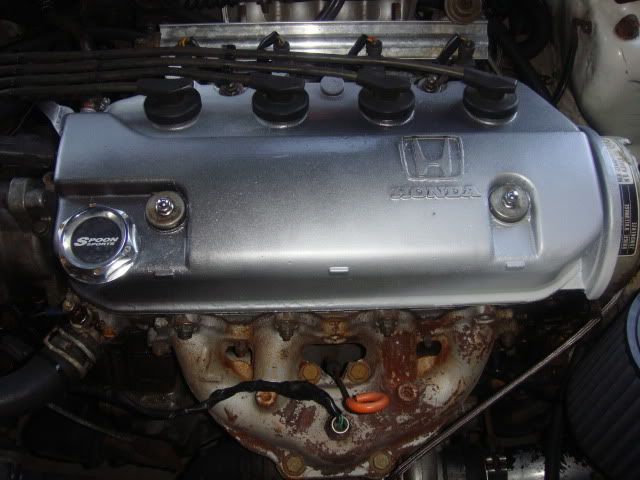

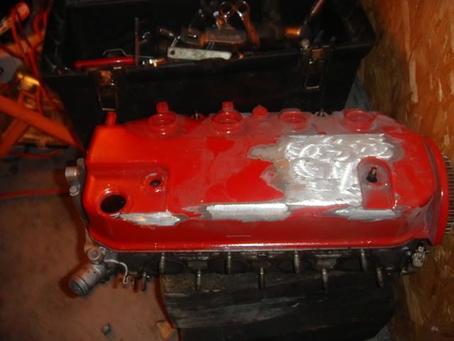

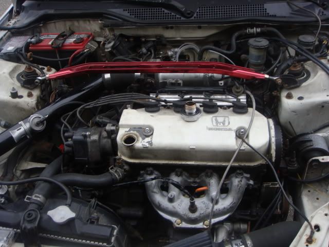

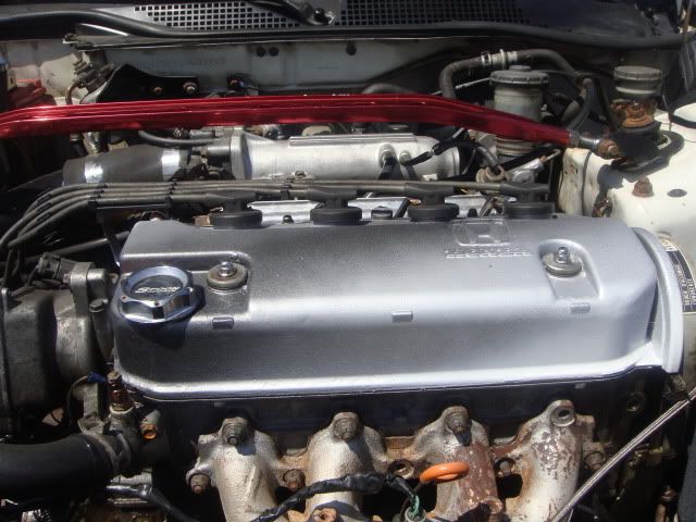

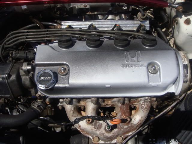

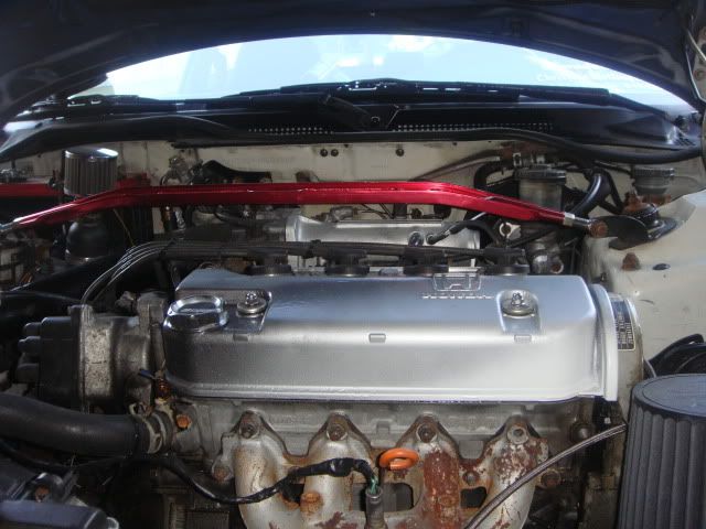

shaving my valve cover

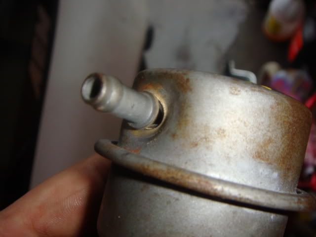

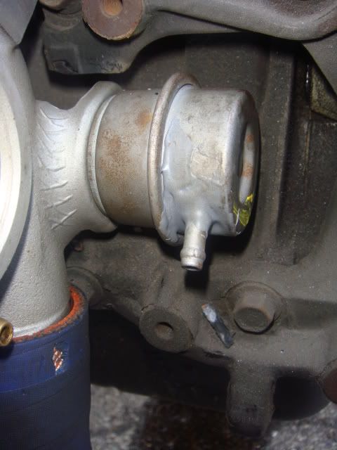

this sucks ass....now i gotta track down a new wastegate or buy one off ebay for $60

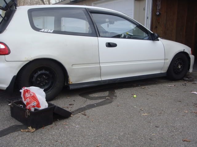

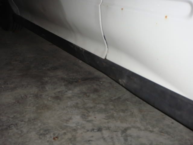

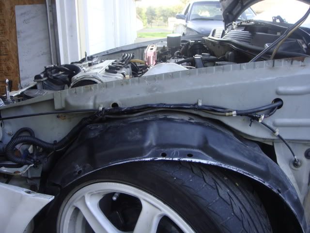

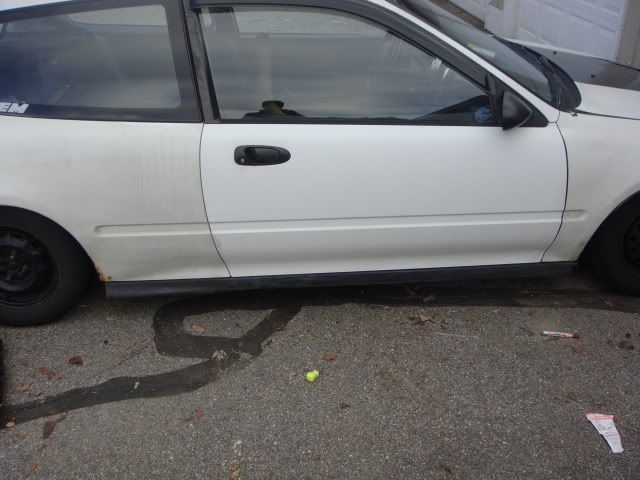

ek side skirts
installed

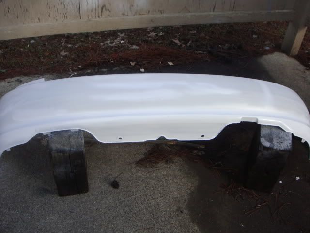

heres the bumper, sanded it, then sprayed a little white i had lying around on the spots where the paint had flacked a bit. i forgot to get a pic of the finished product i'll do that tonight

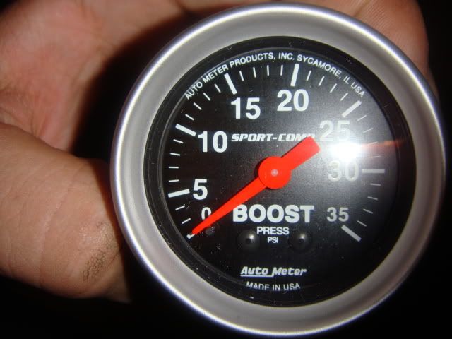

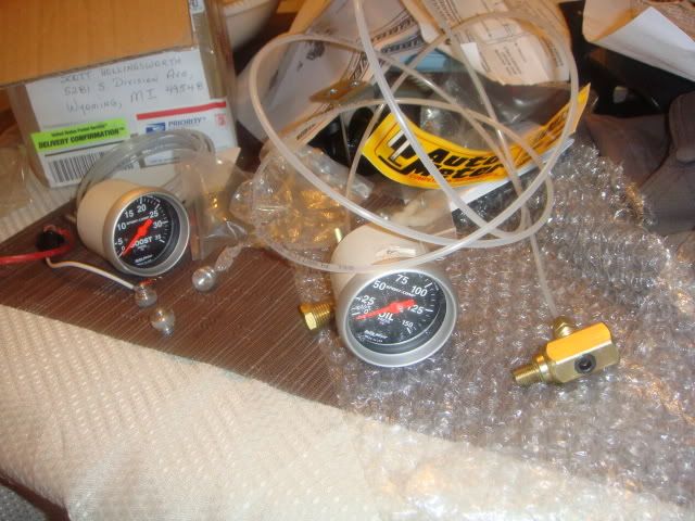

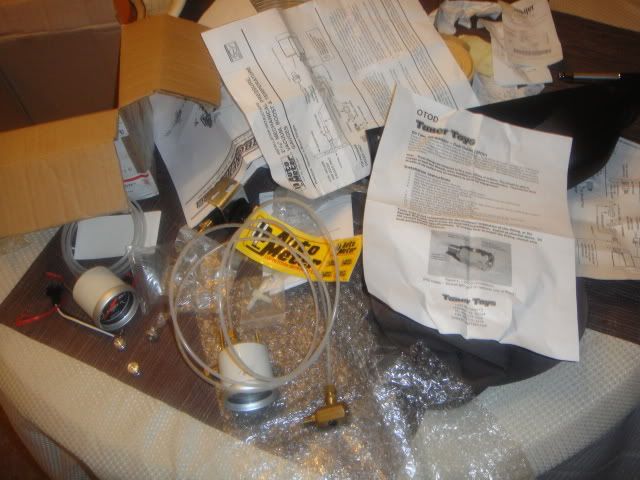

pics of new parts as promised.....

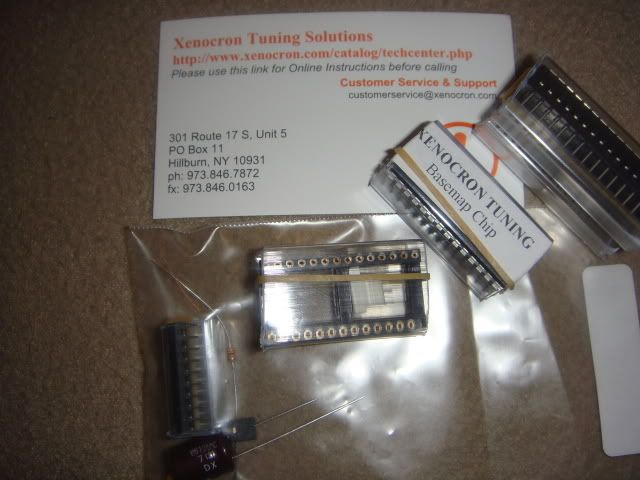

xenocrone base map and chipping kit

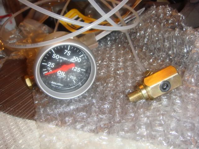

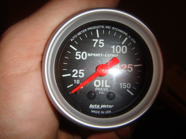

autometer sport comp boost gauge
autometer sport comp oil pressure gauge

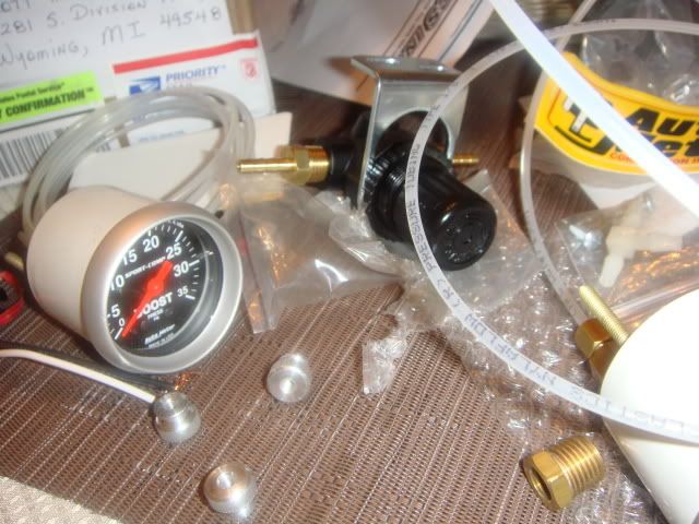

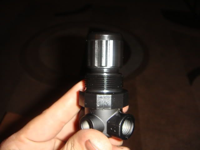

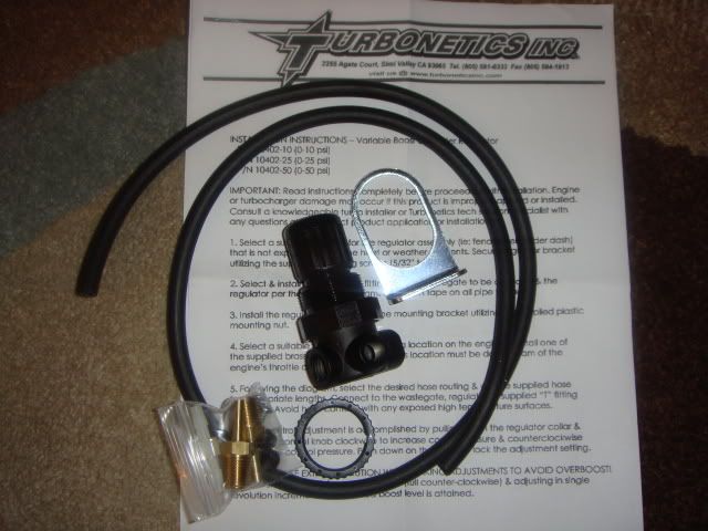

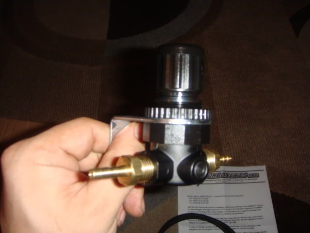

boost controler

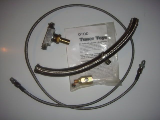

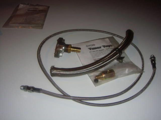

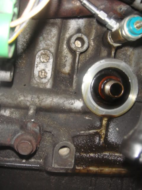

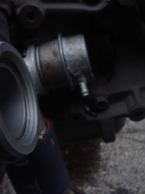

just need to measure the turbo oil feed and drain connections on the turbo so i can order a kit from greg and it'll be ready for install
scottdh20
  • Posts: 26
Re: scottdh20's project turbo d15b7

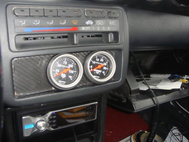

« Reply #4 on: November 09, 2009, 09:48:29 AM »

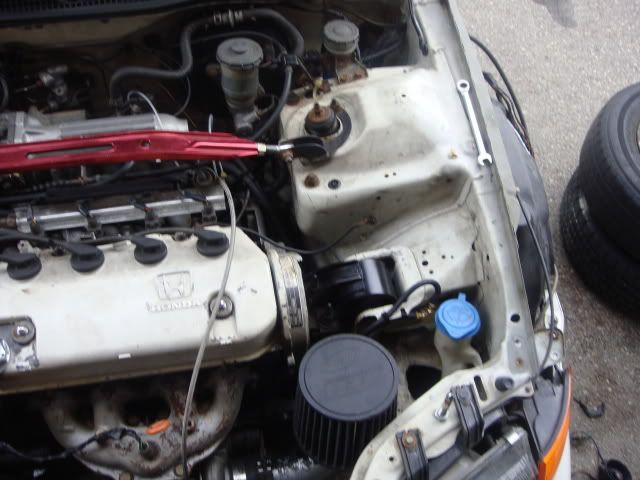

was going to go with a go-autoworks oil line kit but ended up getting a used one on another forum dirt cheap

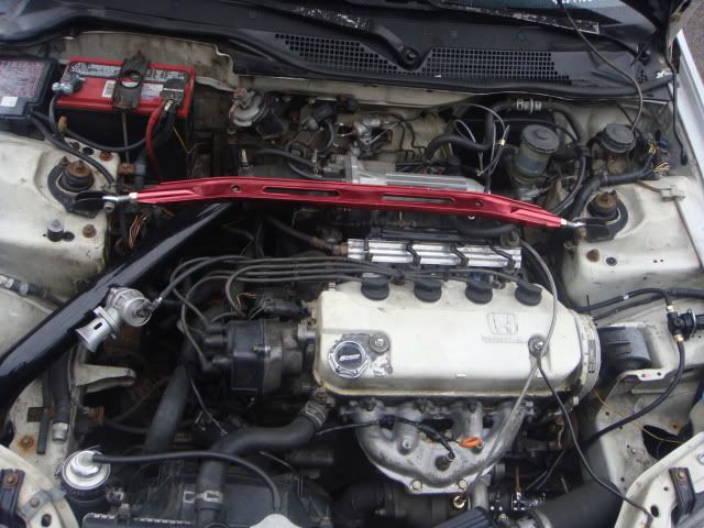

just hooking all the lines up for the boost and oil press gauges:

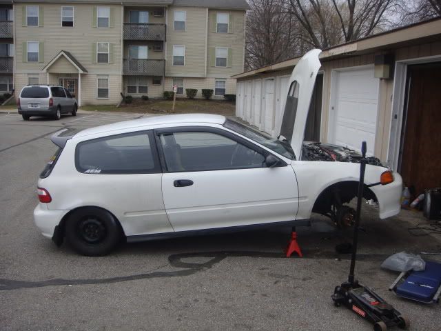

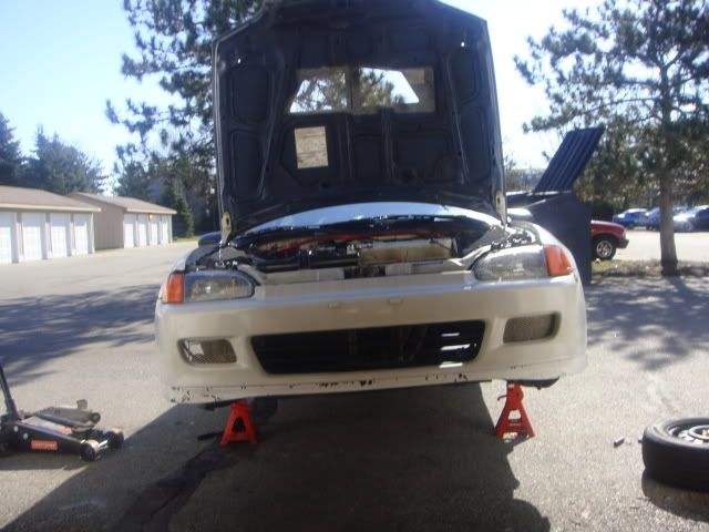

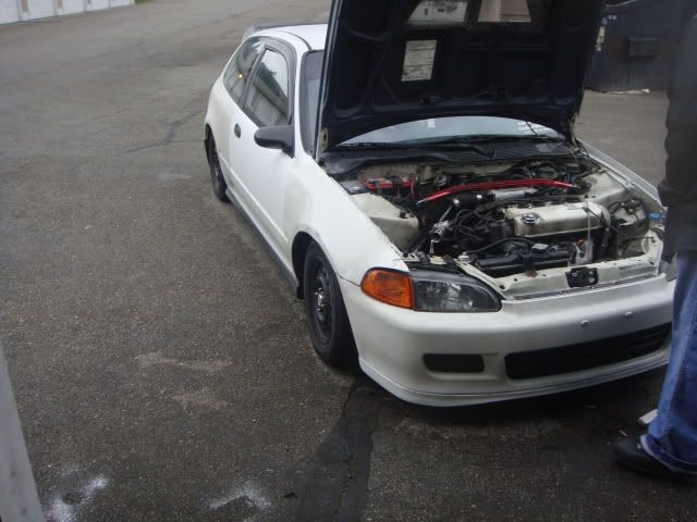

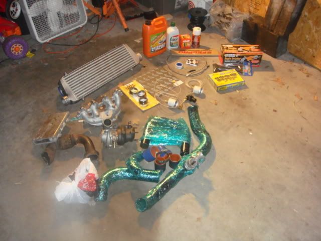

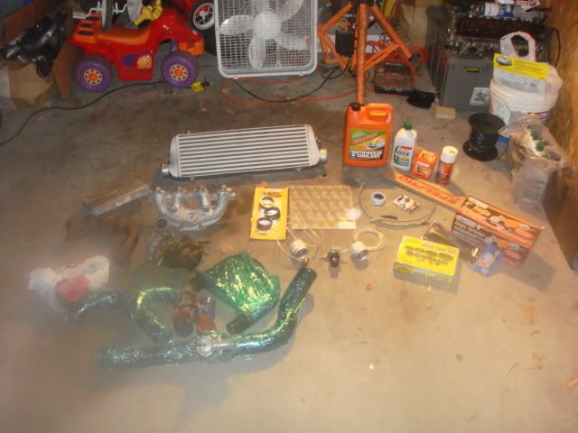

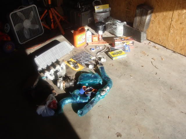

parts pile set up for install:
now lets have some fun, temps in the mid 50's and sunny as hell:

« Reply #6 on: November 09, 2009, 09:49:49 AM »

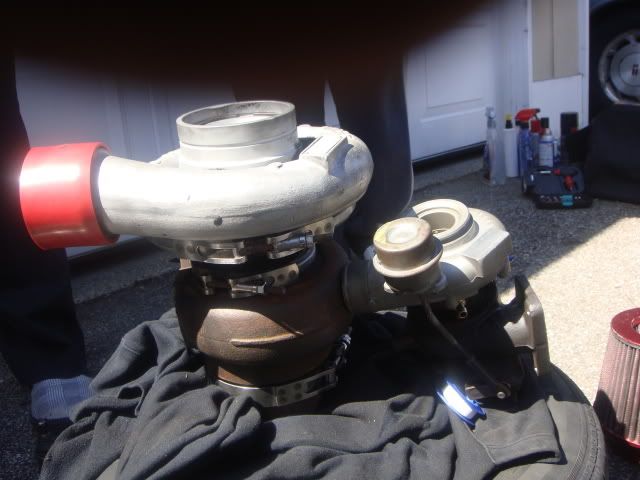

buddy that came over decided to show me what a "real" turbo looks like.....lol he's looking for 9's this year in a maxima

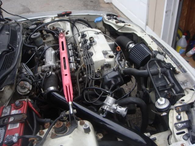

tuner toys block fitting

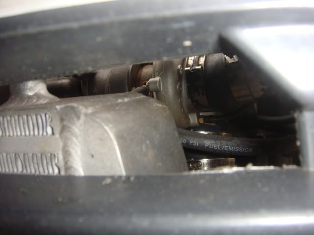

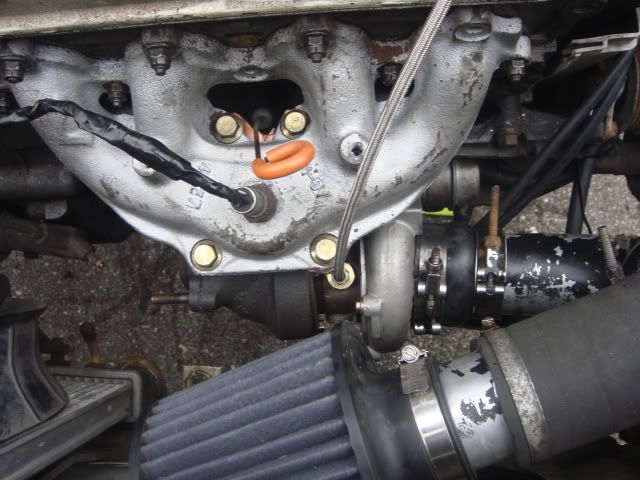

im a genius, i had to turn my turbo around cuz it wouldnt fit......then it still wouldnt fit...damn it......oh ::lightbulb:: i notched out the mount, fits like a glove

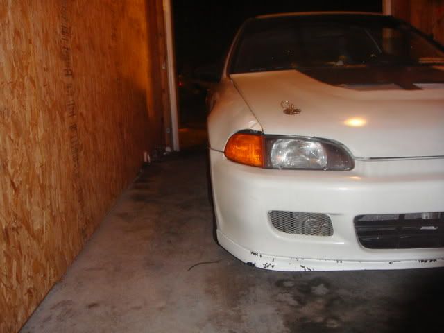

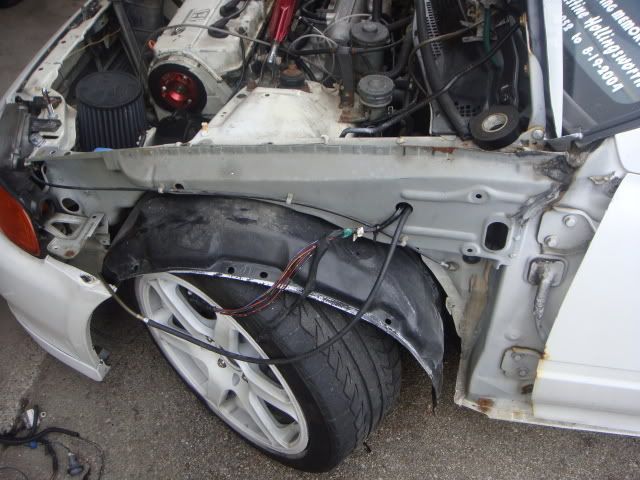

yawn....oh good morning

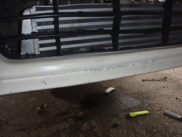

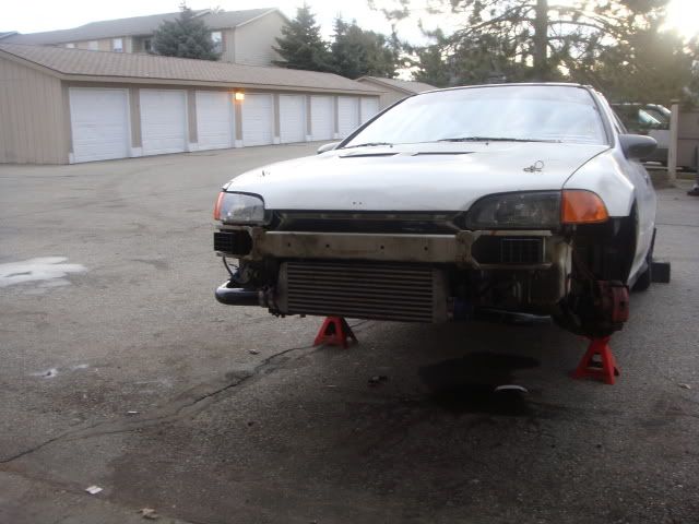

time to try to fit the bumper....uh oh doesnt fit, good thing i bought a cut off wheel

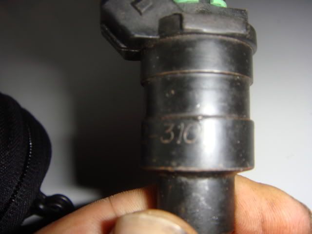

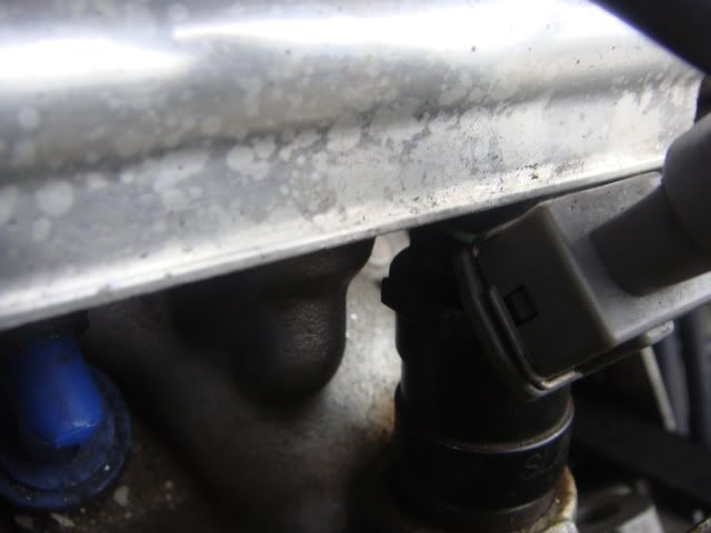

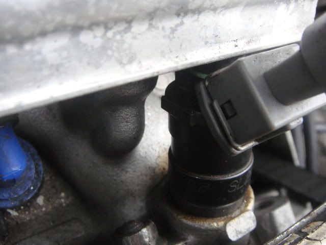

i see you:
rc 310's
blitz bov oh how sexy you sound

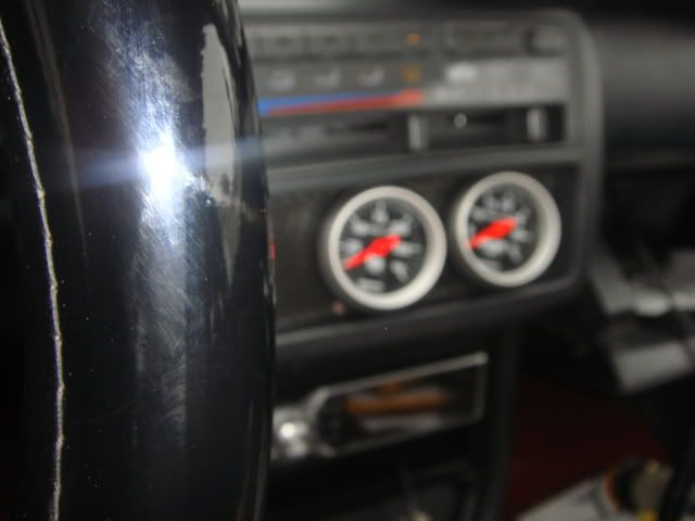

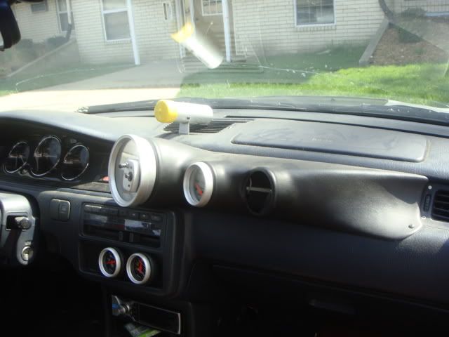

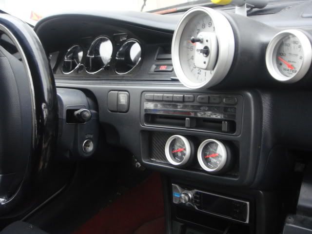

gauges
scottdh20

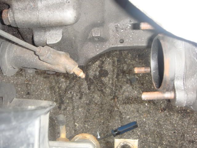

uh oh more problems......damn bleeder valve
$50 bucks later thats fixed

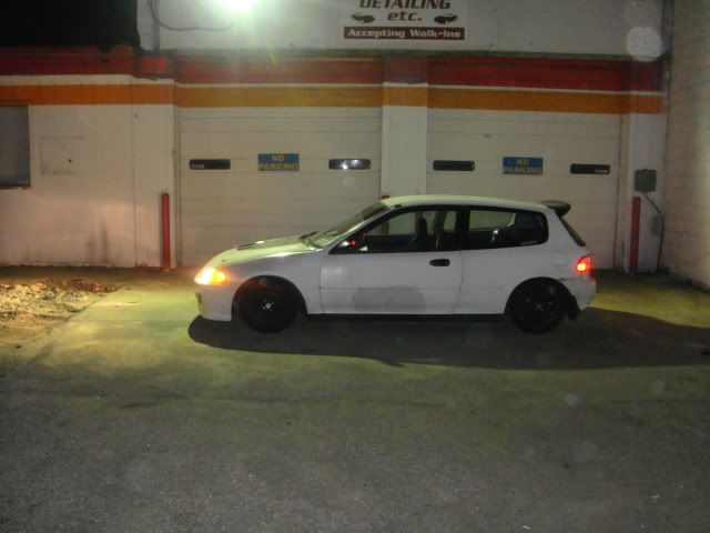

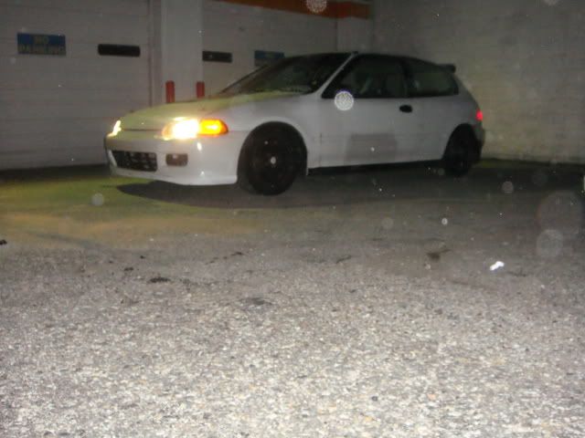

sorry it took so long, i kept forgetting to bring my camera to work.....but here they are!!
my old rims w/ new front tires + pimpin white paint job

« Reply #14 on: November 09, 2009, 09:55:44 AM »

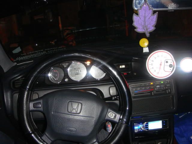

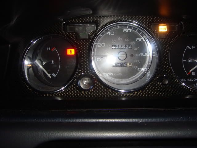

gauges

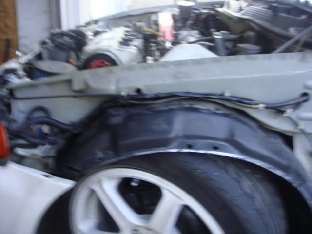

started a little mild tuck job. i haven't done the other side yet, but it looks better
before
during

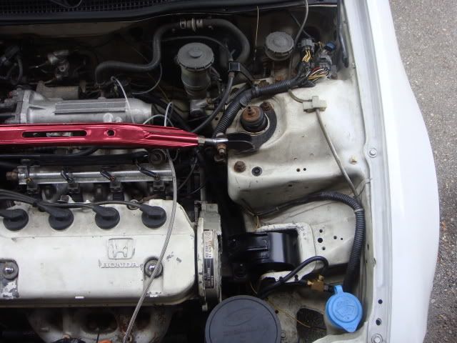

thank you, non-vtec FTW, i mean vtec is amazing in N/A apps but if its turbo'd notec is the way to go.

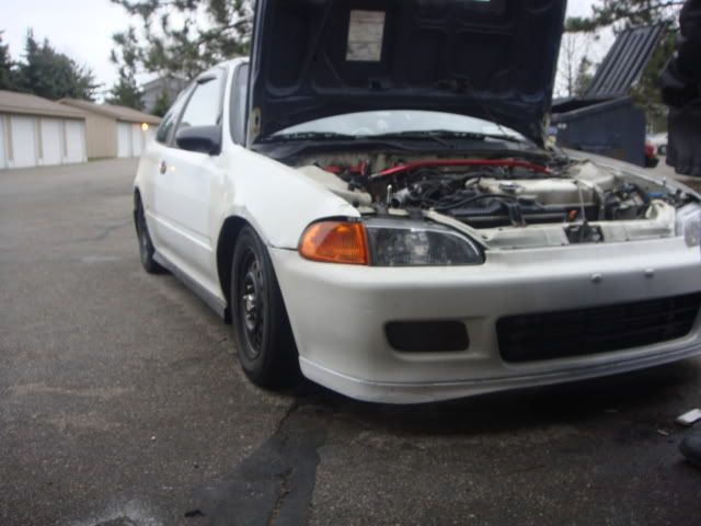

small update, cleand up the bay a little w/ some engine brite degreaser and re spayed my back-up valve cover while i wait for my other one i shaved to get back from being sand blasted.

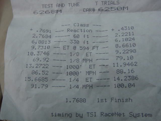

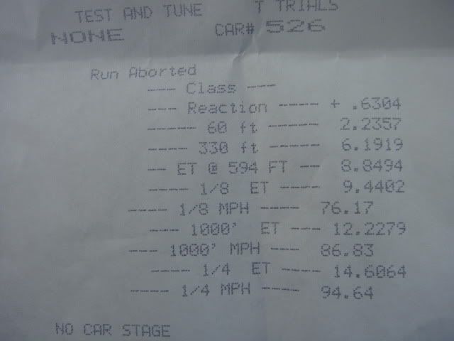

so i hit my goal of mid 14's, but was dissaponted because my traps revieled i had quite a bit more, easy mid to low 13's with slicks and si tranny . so next time hopefully will be with slicks
camera died right befor the 14.5 pass but here is the 14.6

went to the track, well it sucked to say the least... it was like 45* out and it was misting out here and there. they said they preped the track in the morning and then they didnt go over it again the whole day...they said its to late in the season to be going over the track ever couple hours.....the first 60ft were ok but at about the 60ft mark the track got slick.....
i'll have some vids up later today or tomorrow....
either way i got like a 14.3 @ 96-98mph somewhere in there but with a 1.92 60ft...........because 1st gear it would rip, shift to second and as the rpms start climbing the tires just break loose? but i guess alot of people had the same problem with the track being prepped very well until the 60ft marker, then it just got slick as hell.
i guess it was ok cuz i forgot a helmet and if i ran 13.999 or faster they would have kicked me out......i hope that there will be a decent day before the season ends

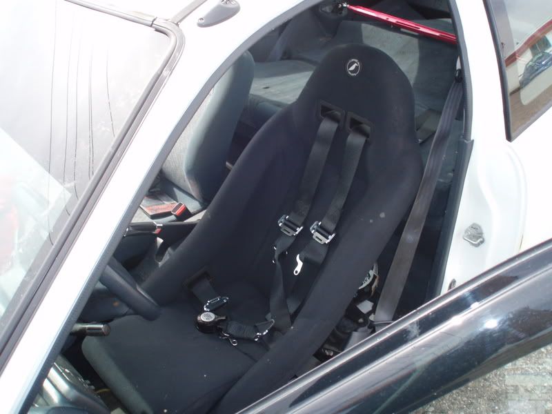

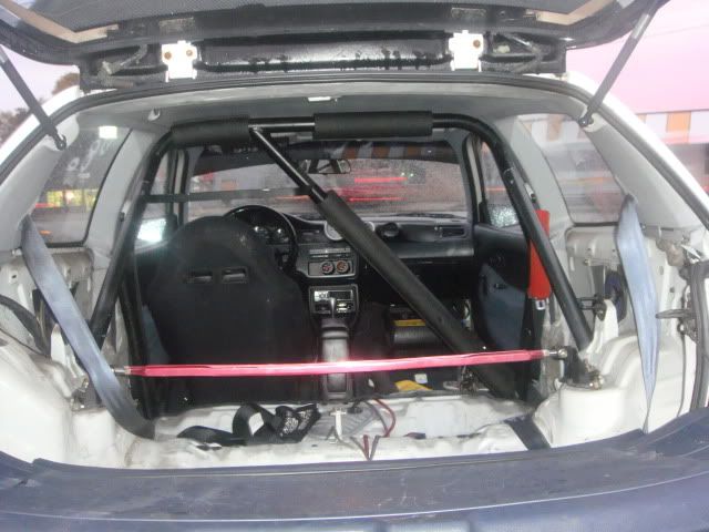

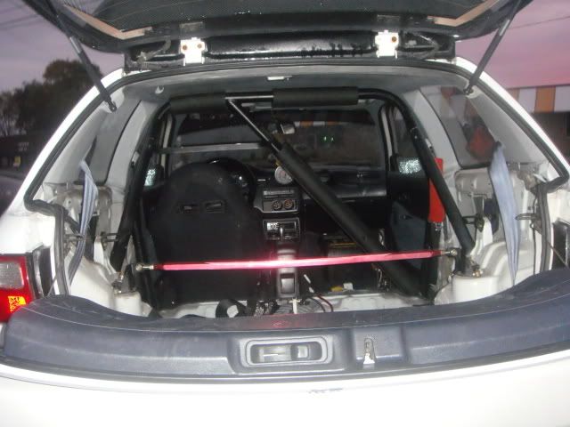

look what i just got.....

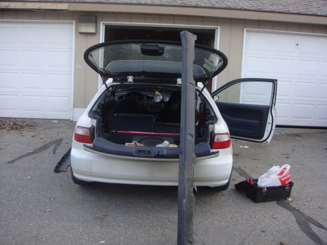

autopower 4pt bolt in cage. still needs to be installed, i just put it in to test fitment, got it used on a local forum dirt cheap. im going to have a harness bar welded in sometime this winter or early spring

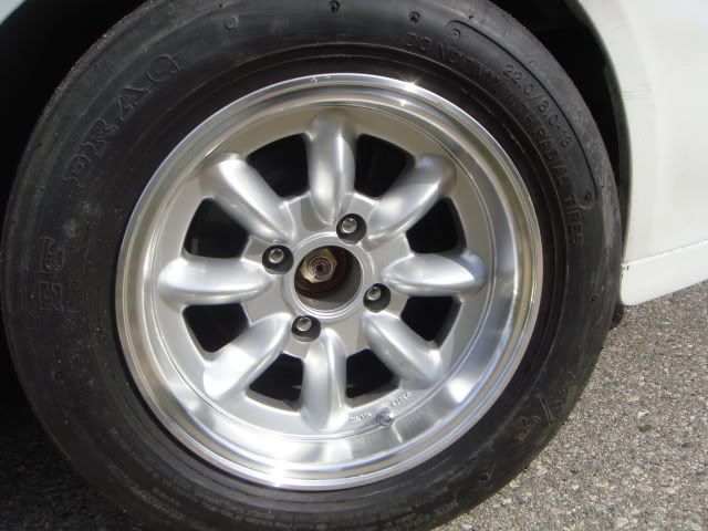

Rota RB's FTW
Get bigger injectors.
yeah i got 13x8 w/ 22x8x13 mt slicks for the track, they are sexy for sure.

Bolt in roll bars are more likely to end your life then save it. I don't care if they are used in a million builds, there is a reason no sanctioning body anywhere in the world approves their use.

Needs porn, more injector, less xenocron and that man size turbo is an hx52 UrbanIndian runs one.

« Reply #28 on: November 09, 2009, 08:30:52 PM »
i ran a 14.0 on a stock 199k miles z6 on 10 psi  but good start iguess.

5 pics and 1 vid would have done fine.  roll cage and slicks on a 14 second car?
