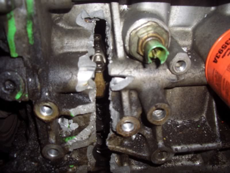

Re: New PIC on page 3. Something i should of noticed.. Doh...
« Reply #70 on: March 17, 2009, 12:35:17 AM »
im pretty sure that this cant be the problem, but i never switched this out from the old motor to the new.  I totally overlooked it.  I believe this is only the water temp sensor.   The plug is just hanging out there not ever hooked up.  I dont think this would cause my problems.  Please correct me if i am wrong..
BoostForLife
« Reply #71 on: March 17, 2009, 02:38:19 AM »
I believe it would cause problem because your ecu will be flooding your motor with the extra fuel that was meant to compensate for cold temps. Once motor is fully warm is runs much more effiecient and needs a lot less fuel to run good.
BTW: Does the temp gauge work normal? If it does I would think the sensor is fine but try another one anyways.

« Reply #72 on: March 17, 2009, 02:46:07 AM »
thats the thing..  the sensor is still on the stock block which i didnt transfer to the new one.
the temp gauge seems to work fine.....  i think im going to transfer this to eliminate this as a problem
« Reply #73 on: March 17, 2009, 02:53:04 AM »
I think that the temp gauge has it's own sensor on the tranny side of the head. The 1 wire sensor, so it would have nothing to do with your car running like shit and your gauge will work fine by itself.
definitely try another ECT sensor because that's what the ecu looks for to know temp to fuel output. I'm surprised you're not getting a CEL  at all.

« Reply #74 on: March 17, 2009, 08:39:14 AM »
temp gauge is one wire sensor on the side of the head(looks like head phone jack)
that is your coolant temp gauge for the ecu or fan controle
« Reply #75 on: March 17, 2009, 11:15:53 AM »
let me install this sensor onto the new block and see how it is... shoot.  no cels though
« Reply #76 on: March 17, 2009, 12:16:15 PM »
That looks like the switch for the fan control. The temp sensor for the ecu is on the side of the head and it has a plug on it just like the IAT and IACV. Two wires should be going to it and it should be located in the same general area of the one wire temp sender for the temp gauge.
