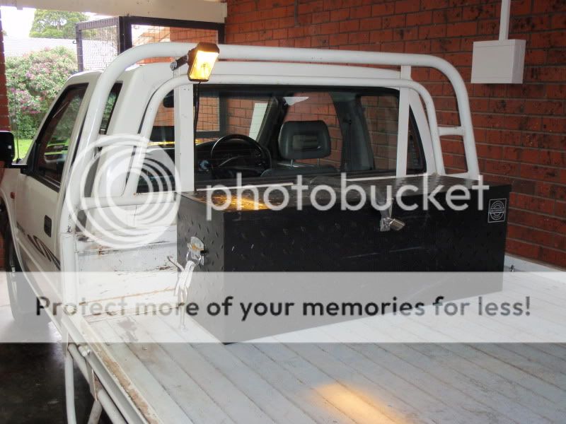

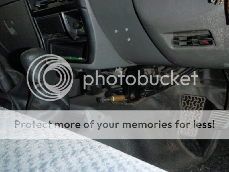

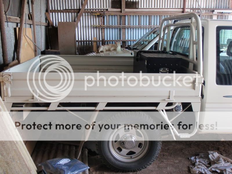

Update:

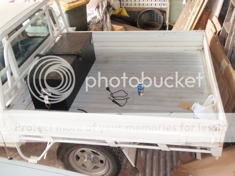

canopy off, toolbox on (cool cat is cool)  8)

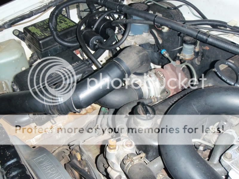

in cabin mbc  :noel:

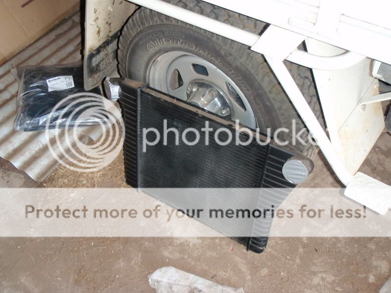

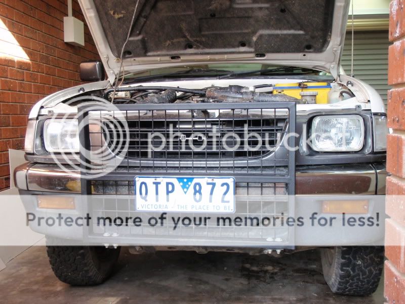

old volvo fmic i was going to use, but was too tall. i was too pussy to cut up my car too much  :-\

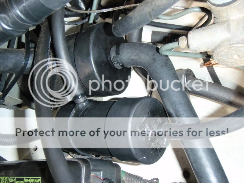

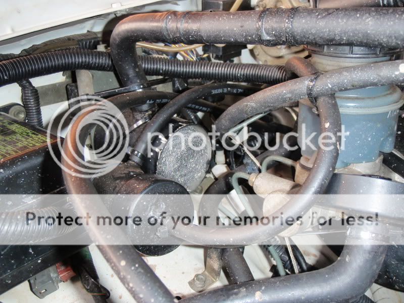

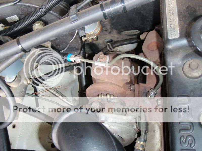

mani tapped for drive pressure gauge. 1/8 npt to 1/4 compression fitting, then 1/4 tube to 1/4 push on barb.
had big dramas with the gauge jumping and buzzing, caused by pulsing pressure signal.
RHMT style solution found: pulse damper
2" pvc pipe and caps, 1/8th bsp to 1/4 hose barb fittings, packed tight with stainless steel wool (aka kitchen scouring pads), plumber's silicone sealer, my favourite flat black paint.  it works very well, gauge needle only mooves smoothly, no pulsing  :)

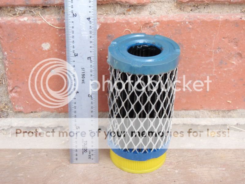

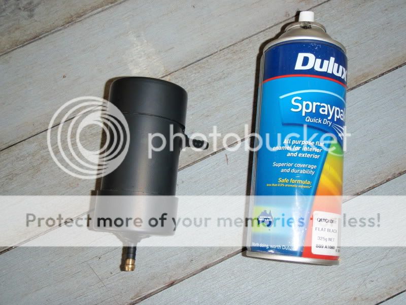

mounted next to the homemade catchcan, which has a lawnmower air filter in it, airbox draws on the crankcase through the filter, removing oil etc. works sweet.

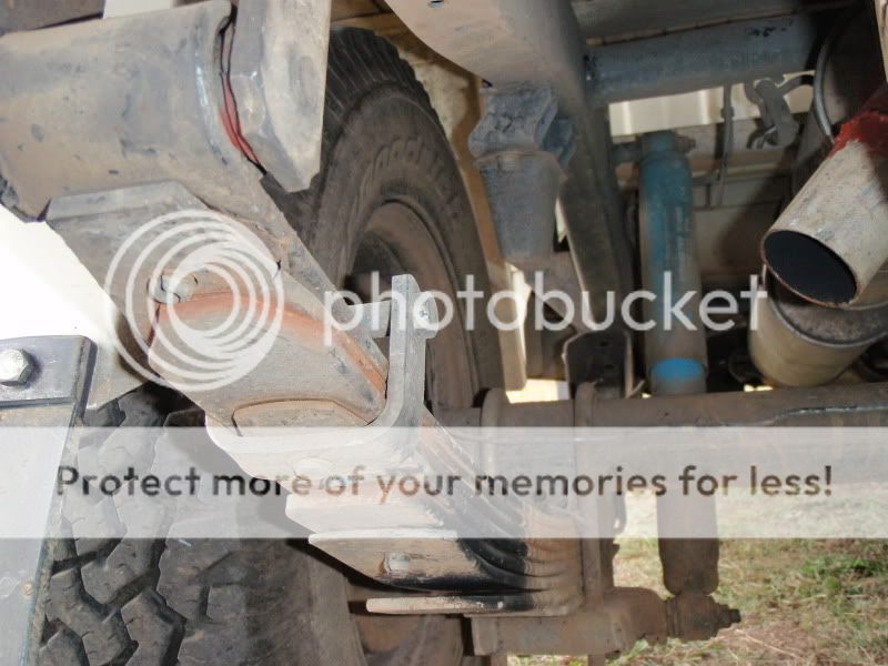

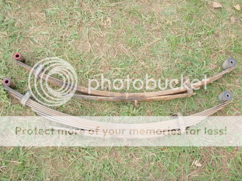

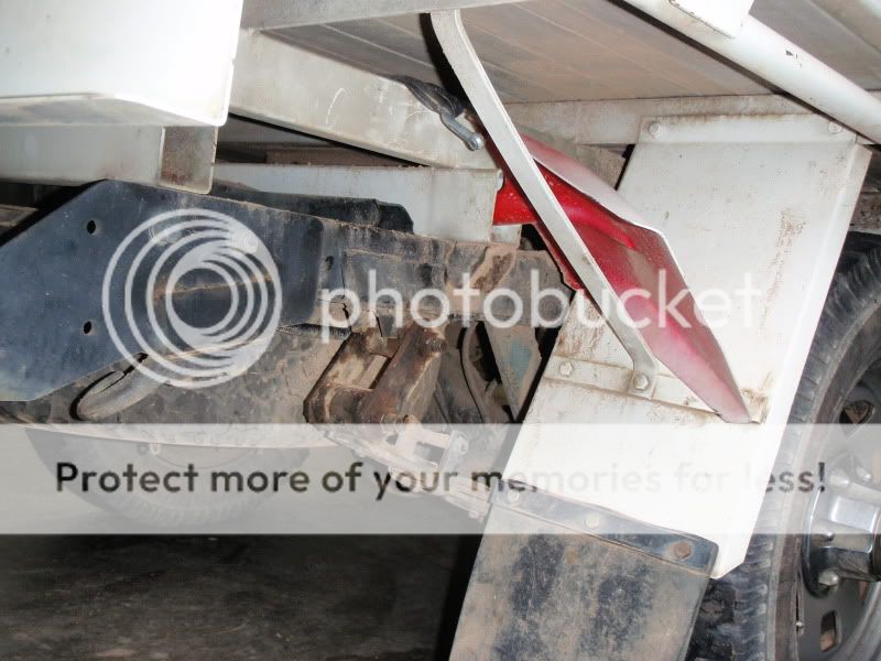

also this ute came with suuper heavy rear leaf springs. stock they have 4 leafs (1 ton payload) this one had 10 leafs, good for 2.5 ton ++++. rides terribly rough and bouncy in the back, and zero traction because it lifts the inside wheel in corners.
so........
little brother and i ripped spring packs out and made up new combinations of leaves. stock top 3 leafs (curved and thin), then only one bottom load leaf (flat and very thick)  with new centre bolts too.
rides like a dream, for a truck.
arse end sits down on the load leaf with the trailer on and is quite saggy but excellent traction.
more tomorrow.

utes are so much cooler than what we get for trucks in the states.
Re: Build thread: Isuzu Rodeo turbo diesel
« Reply #39 on: April 18, 2010, 12:31:38 PM »
I love those truck tub boxes, way more useful than a pickup box. Where is your egt probe?
rprznt
  • Posts: 488
« Reply #40 on: April 18, 2010, 07:23:21 PM »
i really hate the pickups, my other brother has one, it has wheel arch humps, so very much reduced capacity, useless for carrying shit.
like this riced out shitpile for example  :mexi:
my tray is strong but super heavy which really keeps the weight on the back end to get traction lol. its made from 3x3" box steel and 2" angle irons underneath. fits 7 mountain bikes standing up, side by side. useful!

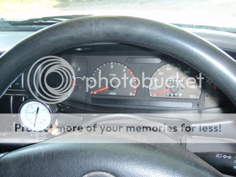

egt probe is in the ex mani directly under the drive pressure bung, pointing straight up. it hides behind the turbo oil drain line. ebay cdm special $60  :D

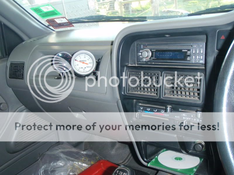

interior plus egt and boost gauges etc
drive pressure, velcrod to the dash  O0

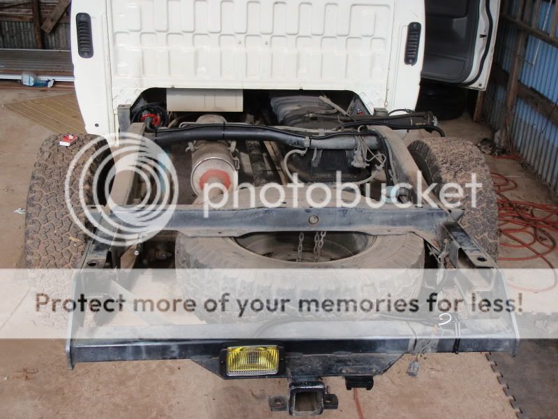

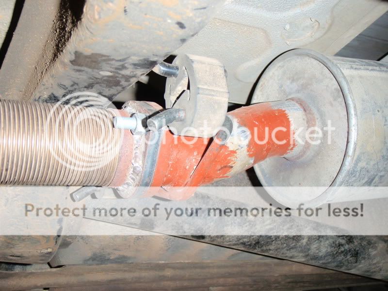

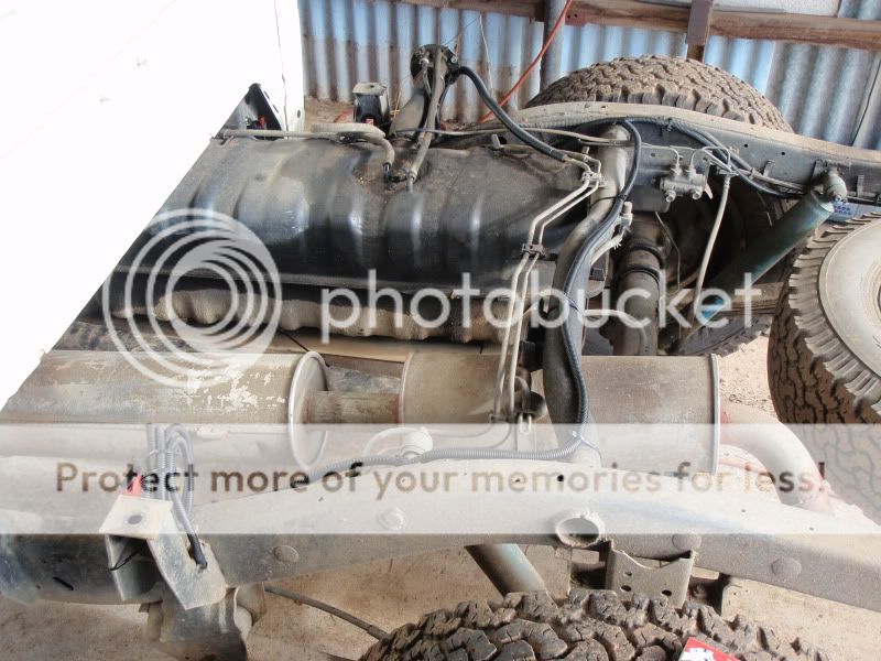

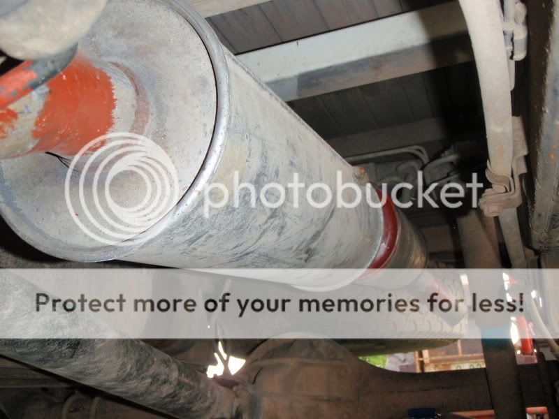

homemade 2.5" exhaust, 2 junkyard mufflers too. red anti rust paint
did work today....

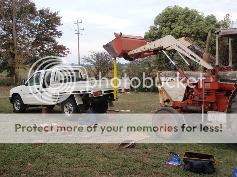

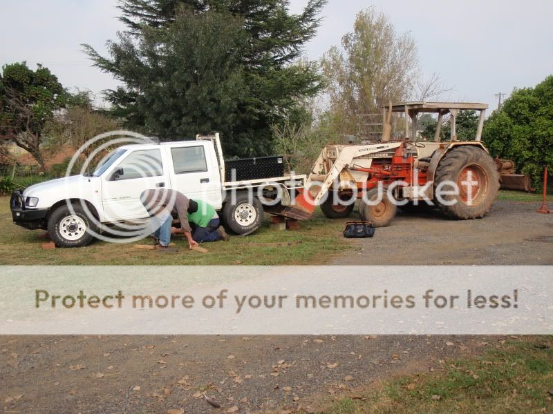

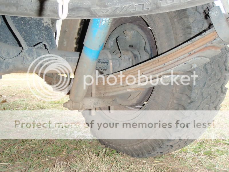

heavy springs before removal
new spring packs made up, extra leaves rmoved
but Dan how you you lift up the heavy ute????
like this!
doing my brother's ute, lifted it up with the top lip of the bucket
doing mine
hard work undoing rusted u-bolts, shit job.
cheers  8)

it seems i took out too many springs   :-X and the arse end sits really low now, in a couple of days and some 50kms it settled down quite a bit.
easy to fix, ill put back in the thickest spring i removed, which is from the middle of the spring pack and is quite curved.
another few hours work but at least then it will sit level.

I like the look, since your pulling your leaves apart again, I would look for some graphite paint, it lets the leaves move easier on top of each other, and makes for a better ride.
« Reply #46 on: April 19, 2010, 05:55:21 PM »
less squeaks too

they are both fibreglass packed straight through type mufflers, like big resonators, 2.5" all the way.
the lining is perforated steel pipe, no baffles or restriction there .......
i severely hate loud droning exhausts and cop attention, so love 2 mufflers.
i drove it open dp and i wanted to commit suicide with the noise  :-X

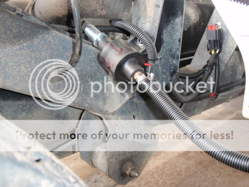

« Reply #50 on: April 21, 2010, 08:37:22 AM »

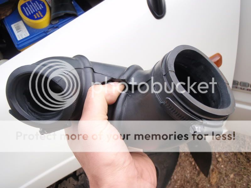

drove it yesterday, and blew a hole in a charge pipe coupler, double angle elbow right off the compressor
running manly boost too  :evil:
got busy today and made a steel replacement, 2" off the elbow to 2.5" exhaust pipe.

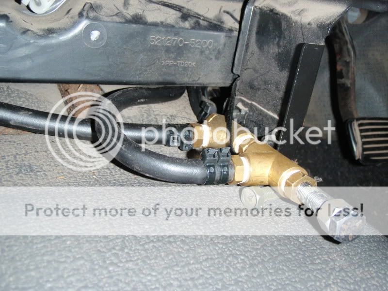

fitted very well, ill use hair spray and some tough hose clamps to prevent blowing off again....
final fitting in enginebay

yep, when i get the lift pump done, and figure out how to keep couplers on grrrrrrrr   >:(
French faggots like Teg2Boo would pour out straight likker because they  don'#39#39t deserve it.
I'#39#39m out rockclimbing / snowboarding / hiking / mtb racing. Be back soon...
« Reply #53 on: April 21, 2010, 04:51:56 PM »
Looking good, time to give the pump the screws.
http://www.realhomemadeturbo.com/forum/index.php?topic=651.msg151646#msg151646
A couple pics down is a good solution for that.

« Reply #54 on: April 21, 2010, 08:39:54 PM »
:D
thats outstanding, will do right now, even have fencing pliars because i live on the farm !

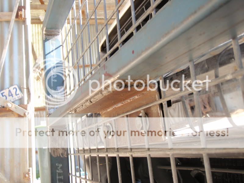

Hey nogs, update time....
just finished a steel bumper for the ute, protect the rad from sticks, rocks and kangaroos when i'm up in the bush.
25 x 50 x 3mm rectangular steel tubing and some 40 x 3mm gal mesh. flat black rustguard primer and paint
mounting to stock chrome bumper and at bottom to stock bashplate
added electric fuel pump, to lift fuel from the tank. its a posiflow 65 gph model. relay and fuse mounted to chassis, covered in thick grease keep water out.

after only 1000km of driving the filter in my catchcan looked like this....
no good, so i binned it and stuffed can with steel wool   O0

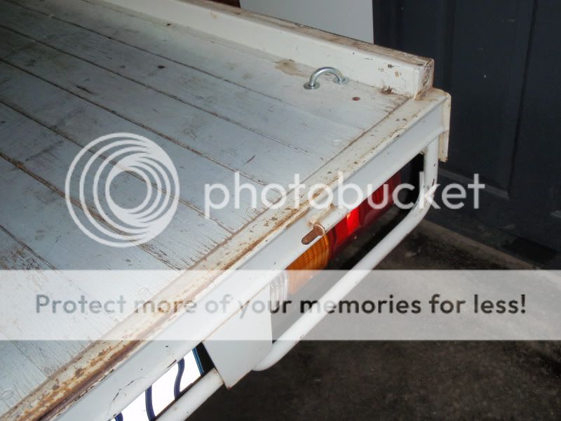

added a rear tray light, handy for camping etc
4 tie down points on tray
snow shovel fits nicely into one of the crossmembers of the tray, painted with red stripes so i dont lose it in snow  :P
retained by a stretched bike tube and cheap D shackle.

very minor update:
just finished a 2" tray lift. bits of 50 x 50 x 3mm shs with m12 x 75mm grade 8 bolts straight through. now my suspension can fully compress on each side with out the tire hitting the tray  :-X)
did the front upper ball joint flip which is popular in this model. 20ish mm more down travel for nothing (limited by shock and brake line length)
got most of my pos camber back after cranking up the torsion bars up in the front about 35mm... doesnt scrub tires so im happy.

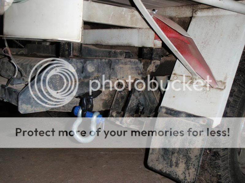

added rear recovery point. (ignore the shackle)
a bit of 10mm plate with a 19mm hole for a lifting chain connector to go through, 10mm grade 80 connector. 2 x m10 grade 8 bolts with nyloc nuts and washers to hold it on. def wont break  :noel:
homemade extended shackles.
1.5" lift in the rear with benefit of better drive shaft angle too. 12 x 50mm plate with 2 x m18 x 130mm grade 8 bolts with spring washers. also wont break.
also got really bogged at the snow, bottomed out on the bashplate and diff  >:( took 1/2 hour to dig out by myself haha.
