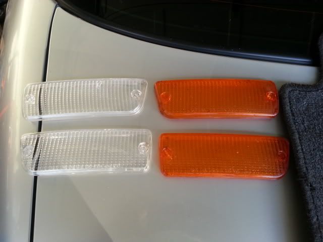

so this 1993 Galant (or Ford F250 if you wanna believe that shit) had clear bumper lights? no argument, just snagged up the passenger lens to match mine.
so there they both are... not sure which i actually like better?? i swapped the clear ones back on the car tho. thats the way its suppose to be...

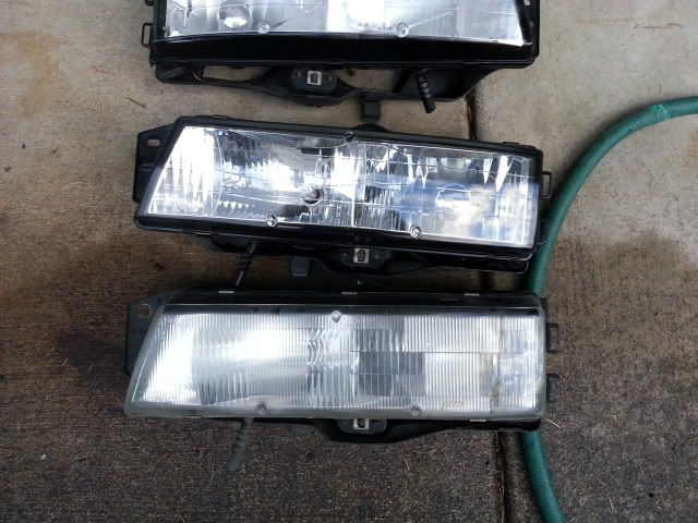

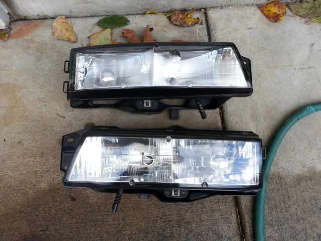

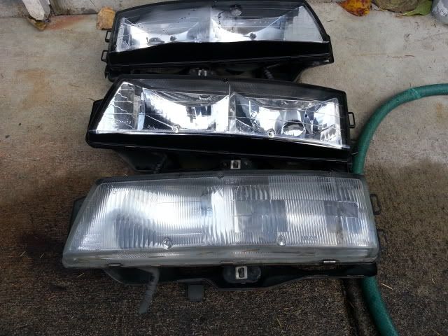

1993 Galant headlights.... this was after some clean up. and re-painting the outsides of the glass black (its done like that OEM, both my old ones, and these where mostly chipped off).
my OG housing is on the bottom to get an idea of the difference. top one has some moisture in it from me washing them. also has a tiny pinhole. should be fine. almost none of the chrome is pealing, which seems to be a issue with these.
so i put the clear lenses back on, and swapped the 1993 headlights on... wasnt that easy. had to swap an adjuster after putting it all in of course, cuz someone had stripped it. but got them all adjusted and work great. no pics of them installed cuz it got dark.

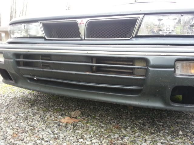

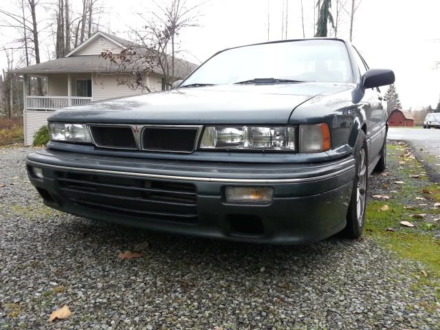

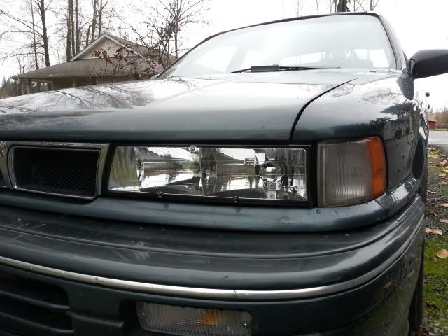

took some pics of the lights installed....and the car.
oh yeah. i bought some Suspension Techniques lowering springs (for EVO8/9) like a couple months ago. finally installed them (just the rears, might cut the fronts up later). evened the car up.
really gotta look to see the intercooler back there.
guess the pics didnt come out so well...  ::)  maybe ill drive it to work and wash it, take some better pics.

Car looks good but there is almost no air flow through the fmic.
Re: 1991 Galant VR-4....forged 2.4L, 272s, FPRed, 25psi, AWD, etc, etc...
« Reply #95 on: November 11, 2013, 12:10:09 PM »
I was thinking the same thing.  You know the air flow temp?
« Reply #96 on: November 11, 2013, 01:20:56 PM »
For low speed this could be an issue for heat soak.
At Highway speeds I see no issue.
m of air = density of air * area of intercooler face* velocity of incoming air
m=p*a*v
m1 = m2 and p1 = p2 then area and velocities are what is need to change.
a1 * v1 = a2* v2
If a1 < a2 then v1 > v2
Where v2 is equal to an ideal speed at which you can transfer away from intercooler, usually less <70mph or 102ft/sec (if my memory serves me right) and varies a little on the intercooler design.
Also if the bumper is very tight against the intercooler, by the looks of it then than should help to force the oncoming through the intercooler and not around.  :noel:
« Reply #97 on: November 11, 2013, 01:28:15 PM »
it logs 75°…all he time. lol. its clamped or someshit. something stupid with the MAF setup.
I really don't want to cut out the grill. think it looks like shit when people do it... but I do wonder if you can cut out the black plastic blockers without it looking shitty?? don't think I have seen or maybe noticed anyone do that.
I have no problem hacking the hole center of the beam/absorber out tho.
« Reply #98 on: November 11, 2013, 01:37:52 PM »
actually. I'm gonna say its got decent flow.
there is 3.5" of intercooler there. then 4-5" air gap behind that before the useless AC condenser. then OEM style koyo radiator. that radiator will go from 200° at a stop to 176° with the quickness. and pinned its self there the hole drive to work this morning.
if thr radiator is getting that kind of temp drop, im gonna assume the intercooler 6-8" in front of that has good flow?

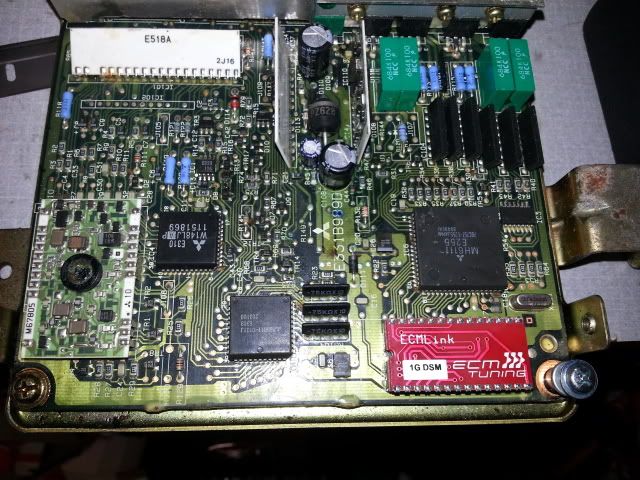

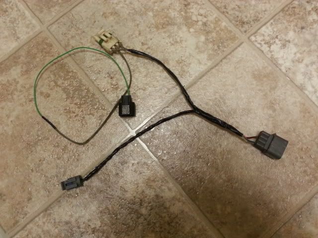

sent my DSMLink v2.5? for upgrade to ECMLink v3
bought ECMLink GM MAF cable (for native support, so i can throw this homo translator thing away)

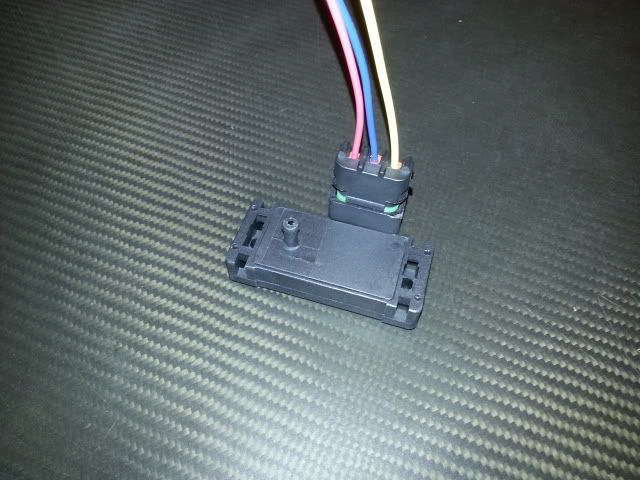

4bar map sensor (cuz its a MAF car and cant log a MAP it doesnt have, probably dont *need* this)

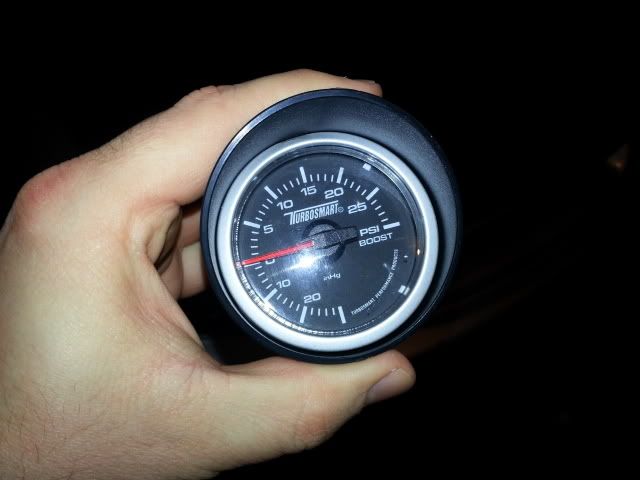

new 30/30 boost gauge (#3 btw). current one doesnt seem trustworthy lol.
oh and a valvecover gasket. gonna shave and/or paint my cover
hopefully get some tuning in this weekend...
fuck need boost leak tester.
« Reply #106 on: November 25, 2013, 10:27:01 PM »
ok, bought some stuff for the G.
sent my v2.5 in to upgrade to v3. hope its worth it.
tough install. think ill be useless the rest of the weekend...
right here should be a pic of a ECM MAF cable... but there is no cable. its backordered on ECM's site, so i ordered it from a retailer that showed in stock...yeah they dropship from ECM.   :evil:
bought another boost gauge
Turbosmart 30/30...
bought a 4bar MAP to log boost also. oh yeah, but no cable to wire it in with   :evil:

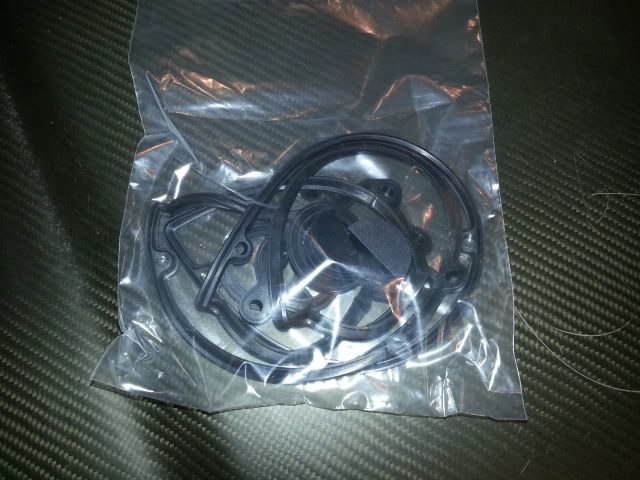

another valvecover gasket. put new one on when i did the swap, think its got a little leak. planning on pulling the valvecover to possibly shave it, but repaint it forsure. will post pics of how it turns out. just need to get off my lazy ass to do it. (its cold out)
tomorrow ill probably throw the ECU back in, and see if i can get her fired off.

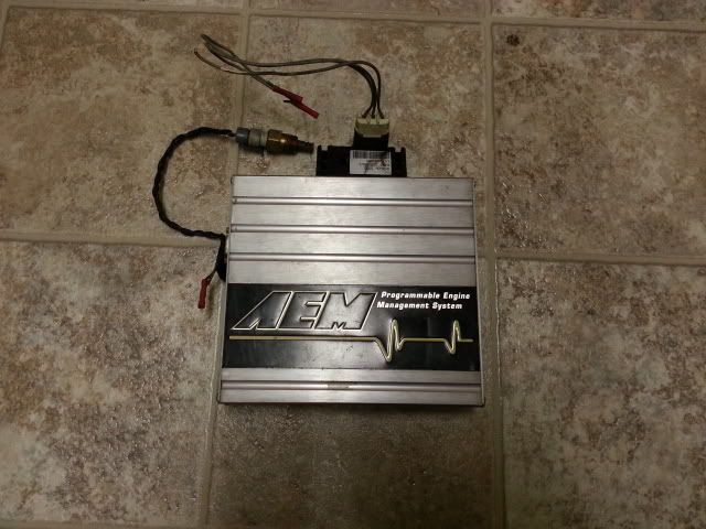

oh, what you know...
shit doesnt work.
uninstalled/installed drivers a dozen times. installed software from disc, and website. etc.etc... too fuckin cold outside to be sitting in my not running ass car fuckin with laptop...
WTB:  AEM BOX FOR THIS FUCKER....

ok, so i said FUCK THAT DSM/ECMLINK SHIT, last week or so... started looking for something else...
after some posts/texts/searching i found somethings.
$550 w/sensors... <~ehh, im too jew for that
$400 w/o sensors... <~ehh, almost jew enough (i have sensors)
wait...
ahh... $350 w/sensors... happy~> :Jew:
yup, bought myself an AEM EMS box..again.  for those that dont know/remember i had one in the CRX. so i have tuned on this before. and my good DSM/EVO buddy has tuned many before also. plan on getting this mostly dialed myself like the CRX, then finish it up with a pro, get dynoed, etc.
as you see it came with GM MAP (think its a 3bar) and IAT both with plugs... also came with some boost solenoids? idk. dont really care about those. thought he said it was coming with a harness, guess i misunderstood.
so i whipped up a speed density harness. its made to plug into the OEM MAF plug (power/ground/IAT) and timing jumper (map signal is there for AEM).
havent tested it cuz its fuckin cold as ballz outside. like my car was already frosted over at 6pm when i got home.
still havent decided if im going to use the 3 or 4 bar sensor. on pump ill probably be capping out at 25psi +/-... but if and probably when i fill this fucker full of some E85 and some 1450cc injectors ill probably be taking it to 35psi...
oh, on this turbo it looks like 25psi will get you ~450whp, 35psi is 550whp.... guess we will see  :noel:
 :Jew:
« Reply #112 on: December 05, 2013, 10:10:51 AM »
Sounds to me like a cheap holsut will make you more power!
Did you try texting JD for the ecmlink?
« Reply #113 on: December 05, 2013, 10:49:44 AM »
turbo i have is fine. it fits. and will make plenty of power. holsets require even more than standard dsm boost levels to make awesome power. and dont fit for shit.
im over the ecmlink. mental energy is not something im waisting any more of on that shit. ive moved on.

pinned my harness wrong lol... quick swap got results....
but it shows -13psi, and IAT of 127*...its 27* according to my ECT... so might need to look at something?
so that means?? IT FUCKIN CONNECTED  ;DDD ::)  did it instantly without fuss also. well other than AEM's redownloading of tune everytime, you get use to it. so yeah. coolant temp checked out (fuck its cold outside), and i rolled threw the throttle a couple times. felt good. gave the key a roll, but with the MAP showing -13psi its not gonna start, battery didnt seem happy...or maybe its the frozen 20w50 thats pissing off the starter?

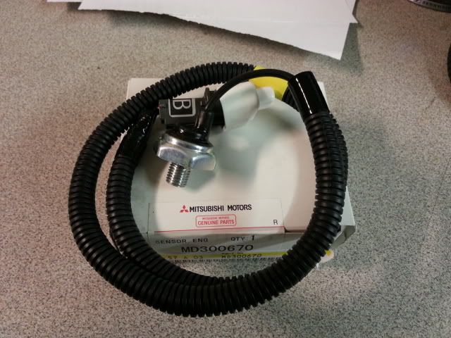

the AEM box likes the 2g knock sensor better than the old ass 1g style. so fuckit. bought one from mitsu.
JD hooked me up with an EVO map that had the same/similar injectors, cams, turbo... so I hacked up my base with those numbers for fuel and a stroker 2.3 DSM for timing. hope/should work just fine. I need to put coolant in the car, which requires me remember to get some. then I'll give it a try.
