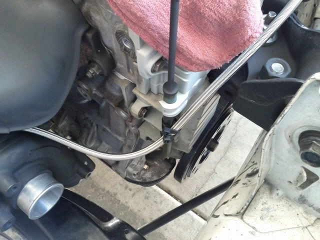

the fittings for the wastegate not working? Tap them for npt
i only used the one on the side, and it threaded fine... i did use real TiAL hardware tho, had some kickin around in the bottom of the toolbox.
Re: turbohf ~ never ending CRX project...
« Reply #91 on: May 10, 2012, 01:33:13 AM »

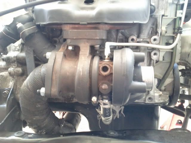

i just re-read what i wrote... the OIL FITTING into the top of the turbo is gayness. i ordered a banjo bolt to -3AN fitting, from what i was told i needed. and this shit isnt gonna work.

i have a -3an line going to my DSM/MHI 14b/TD05 turbo with no fitting  to connect it to...
that would be the big problem. the other being that im still not done, and this has never ran before, no tune, etc. it WILL run soon. just need to figure this shit out.

I ment do you know what thead pitch size you need?
« Reply #95 on: May 10, 2012, 10:00:37 AM »
m12x1.25

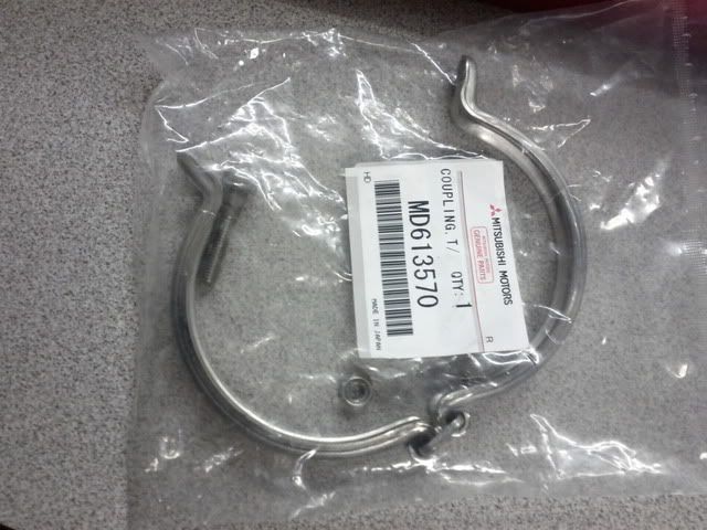

ran into an issue with the galant. crx lost a part... ended up having to order from dealer...
OEM parts!
...err... wrong OEM lol.

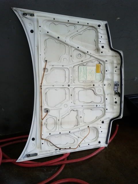

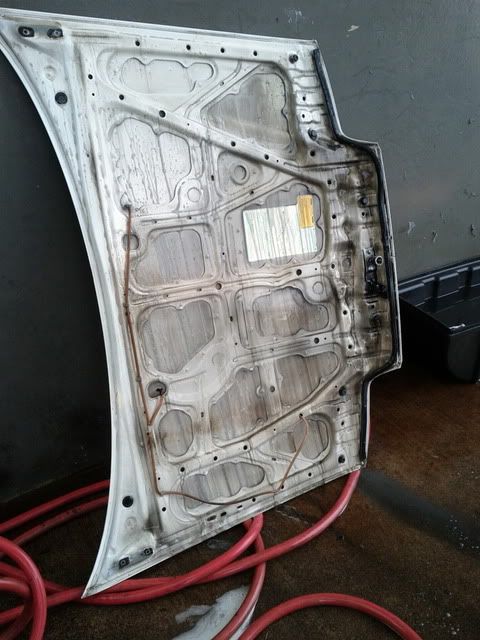

found a CRX (civic hatch anyway) hood in white...
pics just of the under side apparently. was DIRTY/GREASY as shit. exterior is rough... need to finish cleaning, maybe a claybar/etc see where im at. but im gonna need some paint for front/rear bumpers anyway. so no big deal. looks to be OEM and its straight.

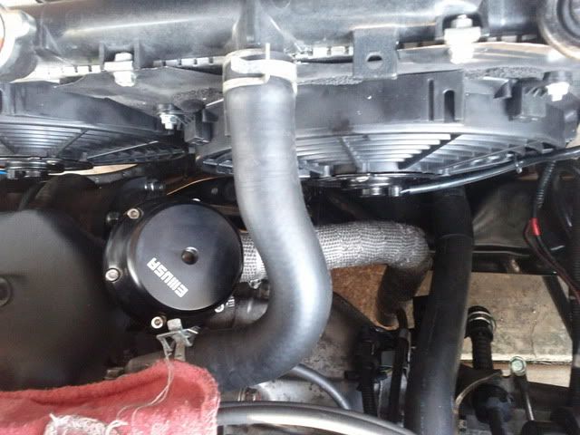

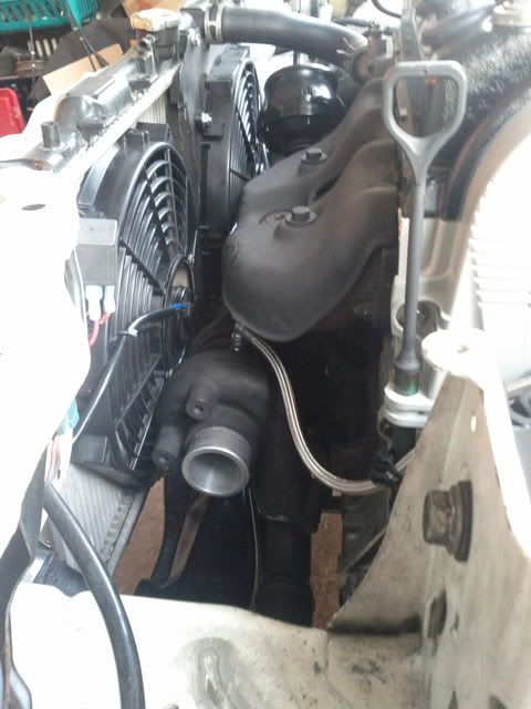

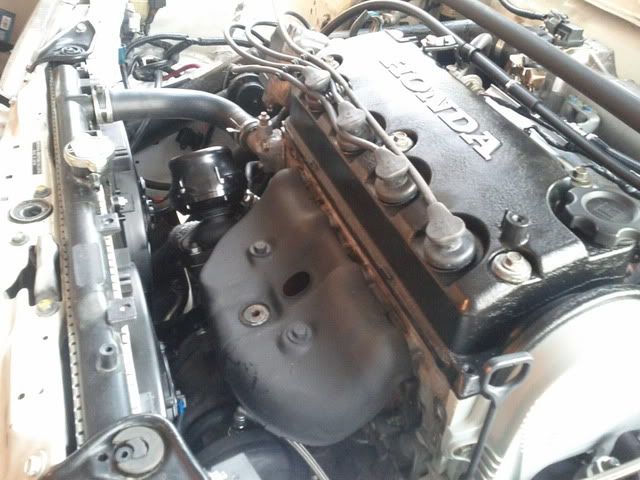

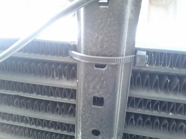

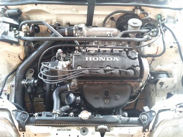

ok. just an assload of pics. so probably just little commentary, you should get the hit. just automotive porn really...
i just like that dump...

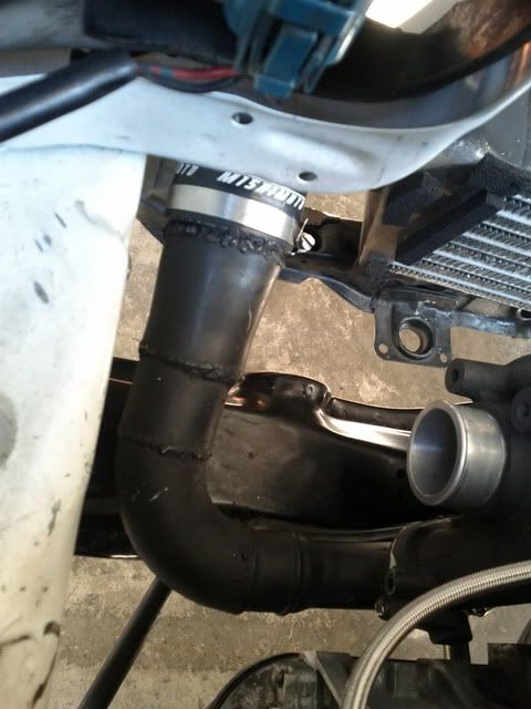

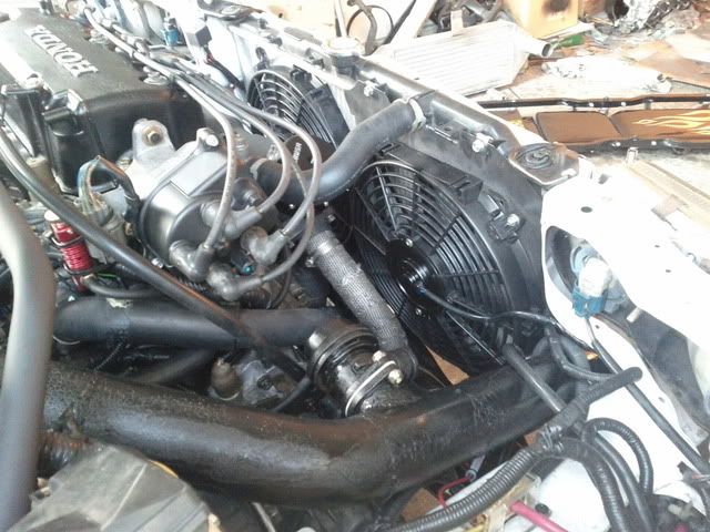

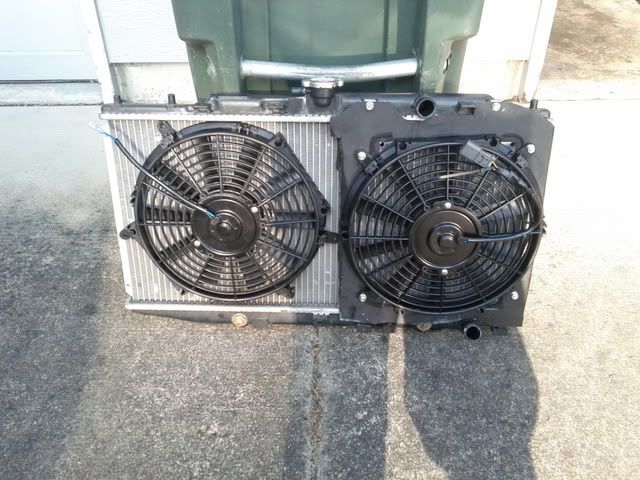

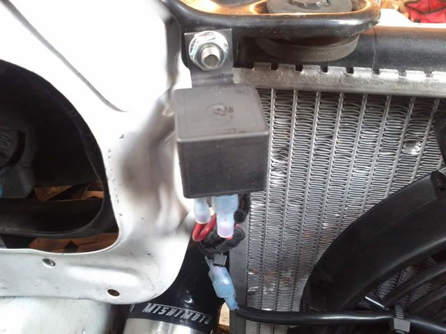

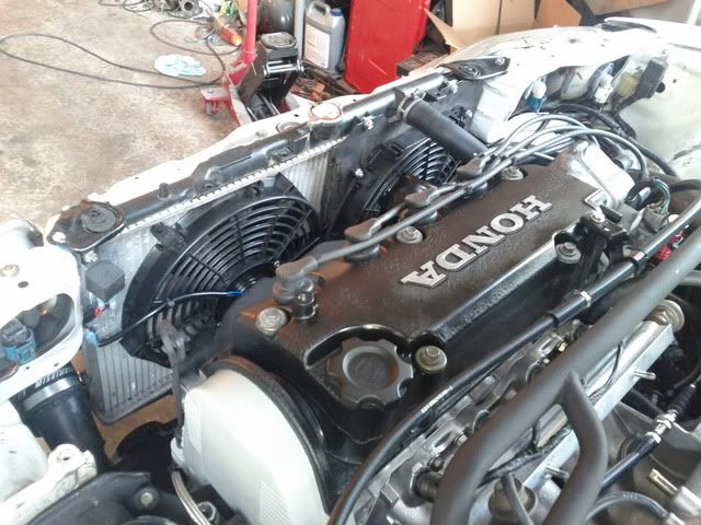

you might think i was hell bent on getting both the fans i bought to fit. sure i tried. but really it was close enough to begin with. so i gave it a little more effort to get it to work. obviously i could run a shroud on the passenger size as i had plenty of room. drivers side i had none. but just a nut hair of clearance (ok like 3-4mm). hopefully i dont have that much movement with the filled mounts.
wired up this relay. so the second fan will have direct power off the battery with a negative trigger off the other fan. hope it works lol.
oh yeah if you have been following my thread, i never did post that i got new OEM Honda wires/cap/rotor (96-97 tune kit/update thing) and some BKR7Es gapped down, dont know what to, but down and to the same for all 4 LOL. looked like .020"
your computer handle that shit? lol...

Fucken eh! Looks clean man. I like. I live how much room there is jb the bay when its just a d series.
« Reply #102 on: May 27, 2012, 12:00:47 PM »
thanks. there is just a little more room, but it deff helps.

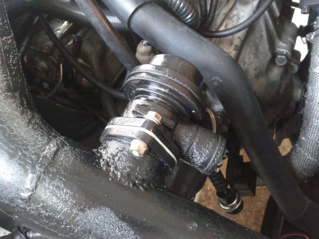

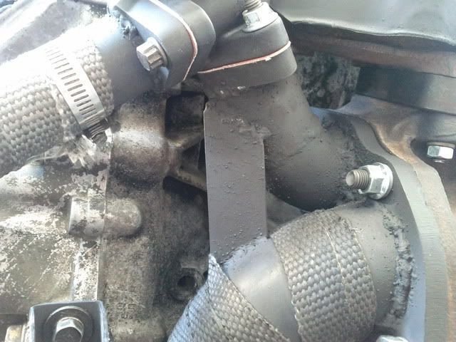

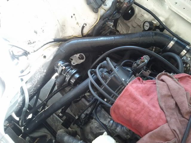

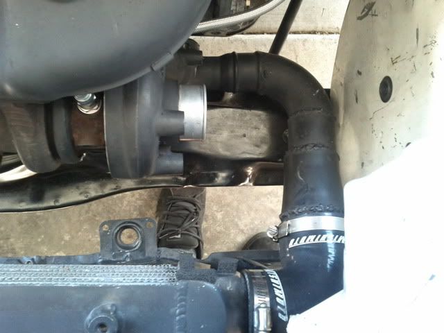

btw. i think the wrinkle black chargepipe/bov looks like shit. valve cover looks good. ehh  :-\
« Reply #103 on: May 27, 2012, 12:39:40 PM »
Do work!
« Reply #104 on: May 27, 2012, 01:09:18 PM »
Not a huge fan of the wrinkle black on the charge pipes. I don't even care for flat black because it looks like chockboard paint. I have stock in the low gloss black....lol I think I have like 4 cans in the garage. Shit was in sale so u got a case.

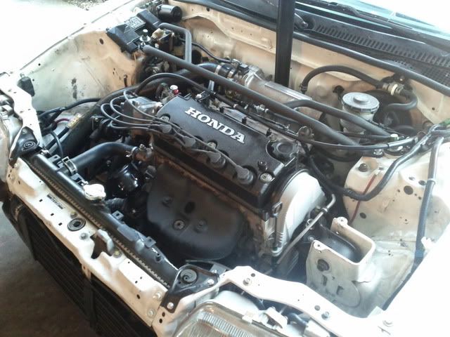

ok so today id say i just about finished final assembly. full of fluids. i got all my shizzle wired up.

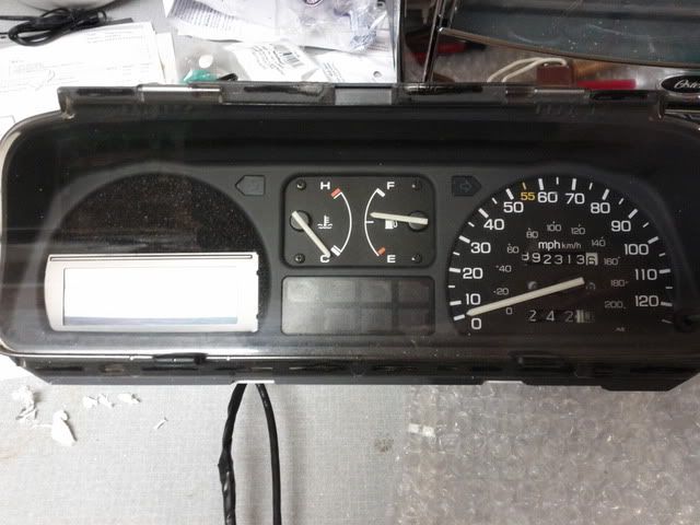

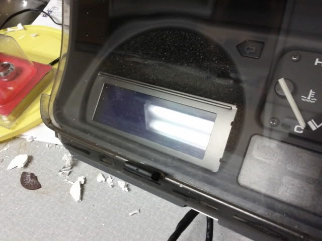

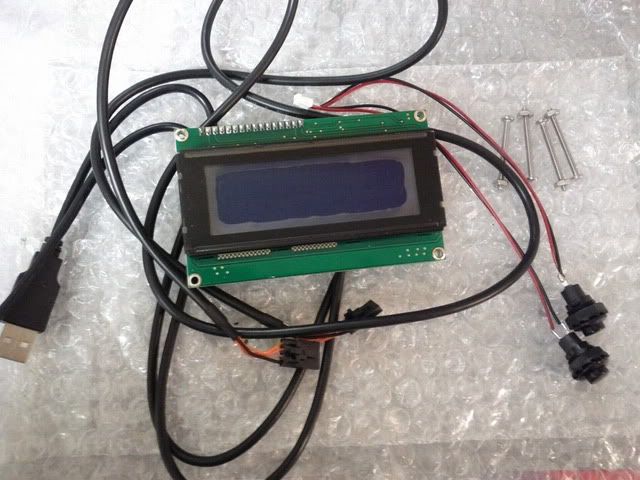

HRTuning/Neptune TunerView II. http://www.hrtuning.com/pages/category/tunerview2-smdash
looks like a pretty badass setup. and i always have issues with gauges. i dont like them, i dont want to mount them, i dont want them in my car. and i dont want to buy them  :Jew:
this shows me what the ECU reads (not some crap ass aftermarket gauge), and has the ability to show me all of them. plus you can feed it wideband, and a couple other sensors you can setup (oil pressure?oil temp? or whatever you want)... whatever, read there page.
bogus part is that xenofag seems to be the only retailer... so buy direct? nope, just sends the money to him anyway. appeared to be drop shipped tho.
i bought that shit weeks ago. started hacking up my cluster to mount it in there. just didnt fit where i wanted it. so made a quick change. id say it looks pretty good.
setup comes with 2 buttons to move threw the pages, clear CEL, etc. mounted them in a large knockout panel to the right of the steering wheel.
ill try to remember to get pics of it mounted later
i had to extend the wires cuz they where way the fuck to short to use for anything but right next to it.

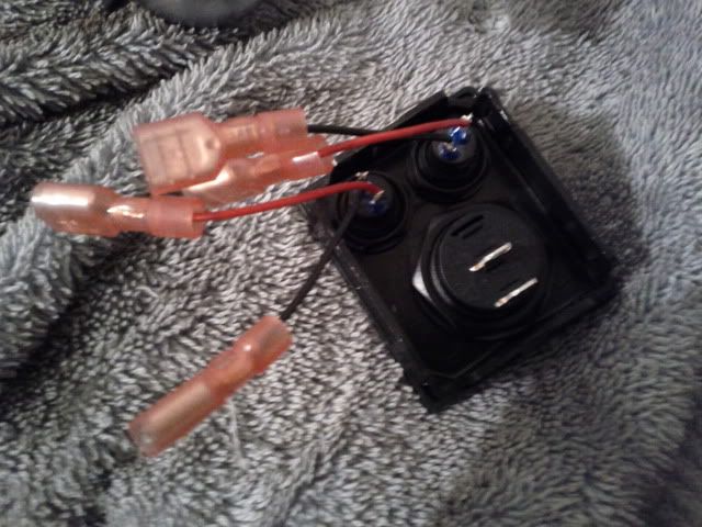

the other thing is a switch for the radiator fans. its an override. bypass' the fan switch, and grounds the circuit.
ill try to take pics...or fuck maybe a video of that shit workin.

« Reply #106 on: May 28, 2012, 09:37:51 AM »
That worked out pretty sick, does that work the with stock form ecu, or do you have to run hondata/neptune/moates demon?
Ps it looks like your cluster reads 892,000 miles..  shits gangster

« Reply #107 on: May 28, 2012, 10:37:53 AM »
Does it have a shift light? Digital reading is nowhere as pleasing to the human eye as a sweeping needle. I want to get an rd1 for my car.
« Reply #108 on: May 28, 2012, 10:56:42 AM »
[/quote
I agree that I don't like the digital tach. But then again, I know when to shift, its when I hit my rev limiter, then I shift...lol I don't think it does shift light though. But you could always set that to your cel light. Or even use your cel to trip a bright ass led.
« Reply #109 on: May 28, 2012, 01:28:09 PM »
thanks.
no, yes, it need to be chipped with pretty much any obd1 honda program. even works on krpo.
yes, my cluster does read 892+k miles  :Jew:
idk. i will be using the CEL shift light in crome. i donlt like the digital tack, numbers or sweep. nor do i really use the stock one. not a big loss. i probablynwould have got an rd1 if i knew i would have put it in the tach location.
[/quote
im actually thinking of doing a couple led's in the cluster backlighting off the CEL... maybe another day...

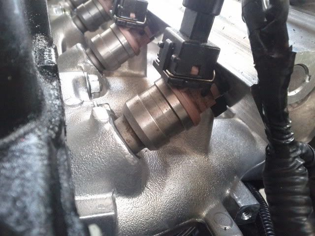

EVO 560cc pink tops.
« Reply #117 on: June 03, 2012, 02:41:19 AM »
Carb cleaner? Fuck that, throw some starting fluid in and let her rip! Stock injectors?
i dont have starting fluid. shits missing. remember lighting a fire with it, then it was missing lol.
Throw some stock ones in for the first start up. Try and make 1 move at a time. That way your not trying to trouble shoot so many things.
« Reply #118 on: June 03, 2012, 02:49:07 AM »
im not swapping injectors around.
i dont have any other good injectors
these 560s work. i have used them before. they where in my ITR/B20, and my friends 1g. ran fine in mine and hers.
may i am trying to use is a JD map for RC550s, 2.5motorola, Y8, etc. only changes i really made where to work better with a quicker spooling turbo, and smooth out higher boost timings... no fuel changes made yet.

err... yup it runs. lol.  ::)

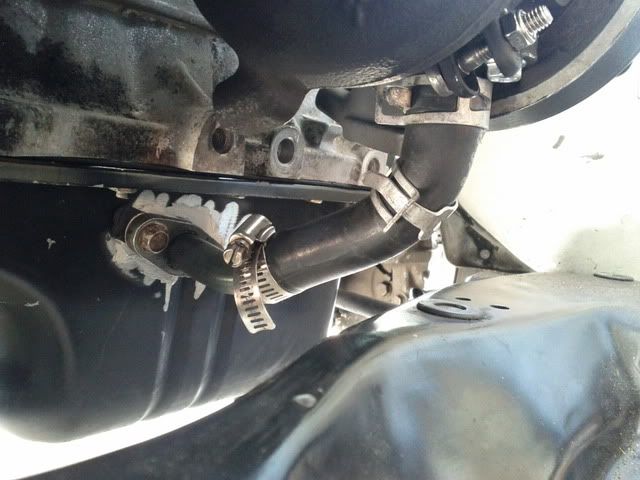

sounds good, sounds solid. she rattles around a little till it warned up. then the injectors where louder. warmed up fully. BOTH fans kicked on solid by themselves.

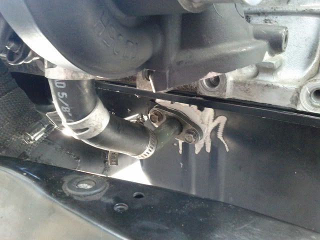

then noticed the oil drain leaking oil...cuz well, thats what DSM's do. its a DSM turbo/drain...soo? yup.
luckly hondabond fixes shit like that. so covered it in hondabond...now i cant touch it till tomorrow. oops.
