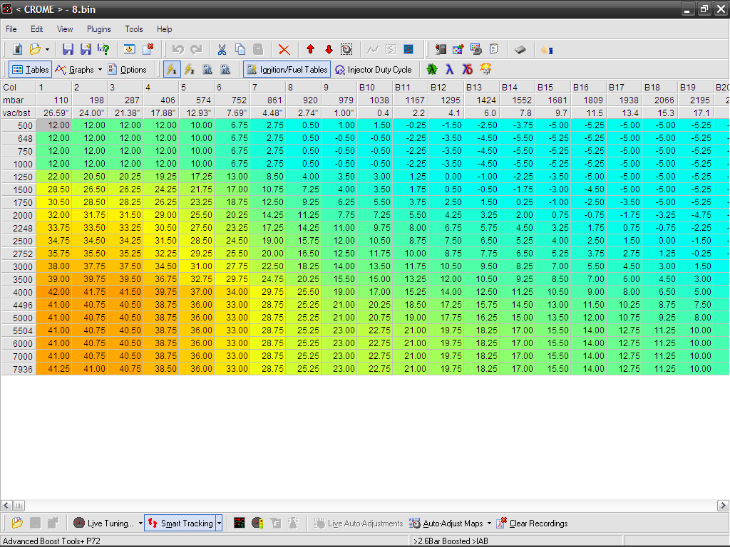

Needs way more timing.
timing scares me...more than fuel. ill work slowly on that later i guess. dial the fuel. or wait for dave/dyno...
Re: turbohf ~ never ending CRX project...
« Reply #160 on: December 09, 2012, 02:51:52 AM »
with how small your turbo is I bet you could push 15-18* timing and be just fine. You did set you base timing on your dizzy b4 you did any tuning right?
« Reply #161 on: December 09, 2012, 08:14:26 AM »
Yea, on that setup I would start with double the timing. With plug readings I bet you would end up around 20°. Too little timing and too much fuel can be as bad as too little fuel and too much timing.

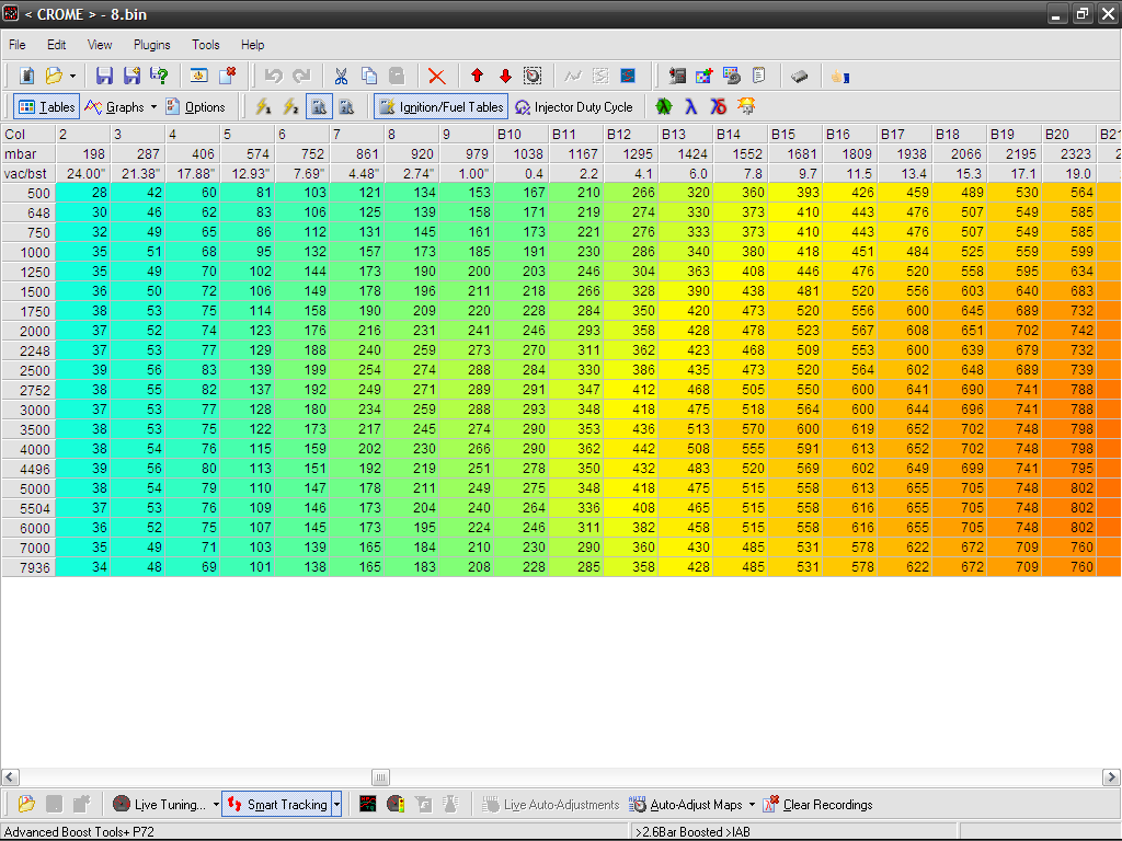

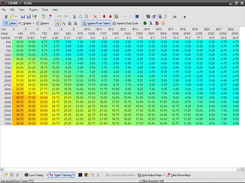

ill post up my maps here in a little bit then for you guys to look at.
« Reply #163 on: December 09, 2012, 02:17:58 PM »
fuel
timing
D16Y8 longblock with 9:1 (180psi) SRP pistons that have been deburred, eagle rods, Z6 IM, P72 TB, evo560 injectors, stock FPR, 2.5bar motorola map. HF mani + 14b turbo (currently 10-11psi, will be going higher). smaller intercooler.
stock head, stock cam, stock ports.

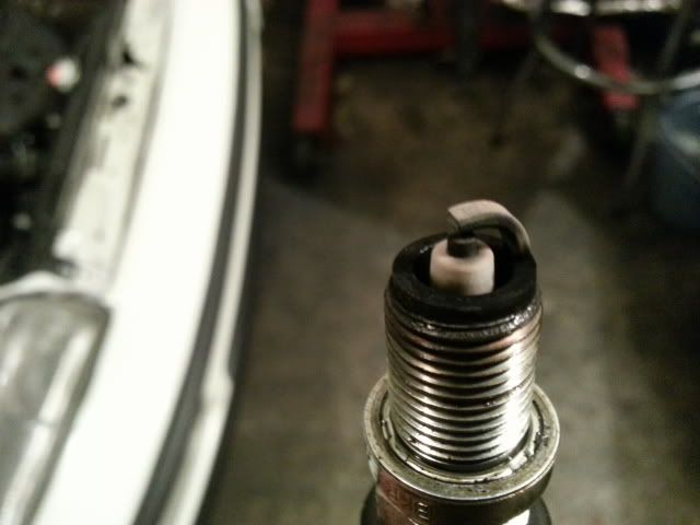

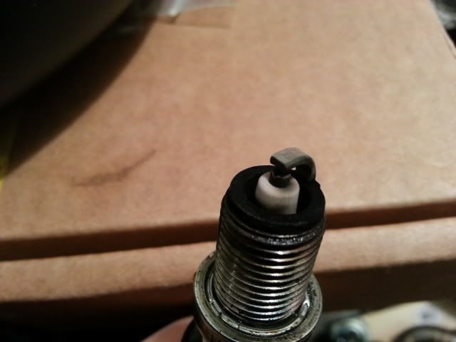

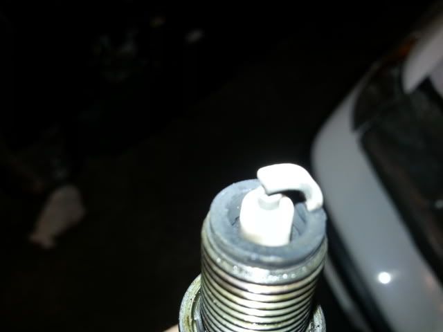

Post a pic of the plugs. I'm sure it wants more than that
« Reply #165 on: December 09, 2012, 07:45:18 PM »
#3 plug

Are those plugs 7's?
« Reply #167 on: December 09, 2012, 08:53:40 PM »
« Reply #168 on: December 09, 2012, 08:55:53 PM »
Probably is not the correct answer....lol
« Reply #169 on: December 09, 2012, 09:21:20 PM »
i know. but i had tightend the plug back down then thought to myself "what plugs are those?"
im pretty sure those are BKRE7's gapped at 28-32ish
« Reply #170 on: December 09, 2012, 10:01:01 PM »
More timing for sure.

Gap those plugs down  :noel:
« Reply #172 on: December 10, 2012, 01:15:14 AM »
I don't think he needs to gap them down when he said they are at .028-.032
« Reply #173 on: December 10, 2012, 09:16:41 AM »
Gap sounds fine. He said it pulled hard. No need to have tiny gaps if the spark will jump a bigger one.
« Reply #174 on: December 10, 2012, 06:56:33 PM »
.018 for gap, at least thats were im at, or was it .015
Looks like it needs more timing+ boost before gap though.
« Reply #175 on: December 10, 2012, 09:10:06 PM »
I usually start around .025". I like to run the biggest gap that won't miss under boost. Makes idle/part throttle better
« Reply #176 on: December 10, 2012, 10:36:43 PM »
from what i have read, thats what im going with also. run the biggest gap you can get away with.

so my high cam fuel maps look fucked? all the same numbers in each column? getting higher as boost goes up. but 2d not really 3d like the low cams...if i make sense.
and on the log from getting lunch today i tipped in hard 3rd, builds boost QUICK, then BAM revlimiter, cough/fart, lol... broke tires loose on a slightly damn road. but was fun. log looks ok. hitting 10s quick, then back to 11.8s or so right before the limiter. happen do quick, not sure how useable that is? but when im fallowing it single cell on the fuel map, when it crosses over into vtec, it is highlighting cells at like 8300rpms? the RPM shows at 4003 or something on the info screen on the right......so wtf?
