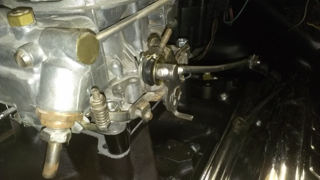

So exhaust is bolted on, throttle linkage hooked up...nog style with a welder and a screw and some Honda vlave cover grommets. Tore the alternator apart to fi d out its totally shot, so ill be getting a new one tomorrow. Hei dizzy in and coil power wire re done, new vacuum can on the dizzy too,  Tires aired up, seat bolted in, interior all vacuumed out. A few other small things but they aren't on the list anymore.

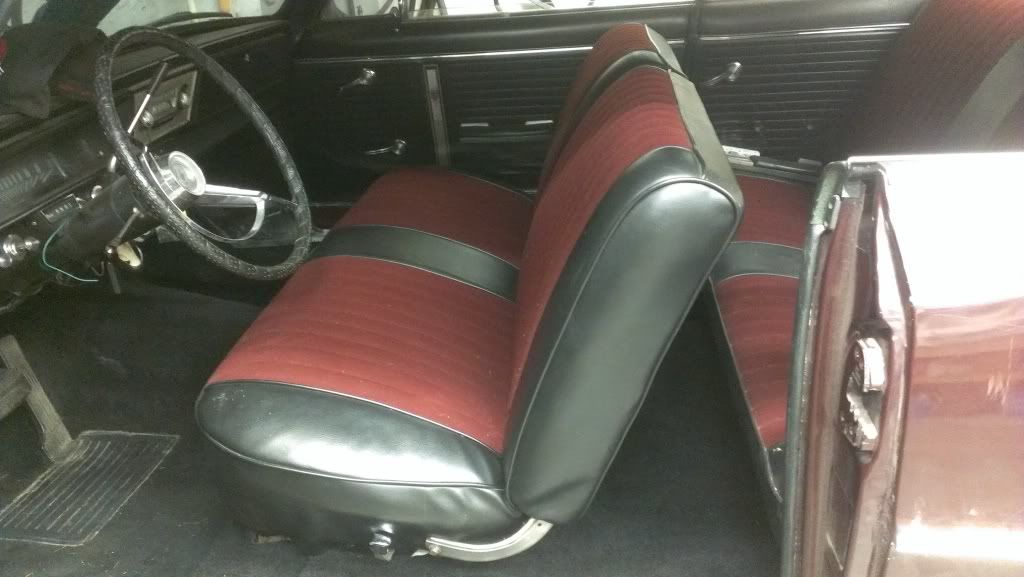

The interior is pretty damn nice

Yeah, my uncle had the seats recovered like 2 weeks b4 he passed away in 1986. Shit, the front seat wasn't even bolted in until last night. Needs door panels, and the rear seat shelf cover, sail panels, and a factory dash pad. But other than that its pretty much all there.

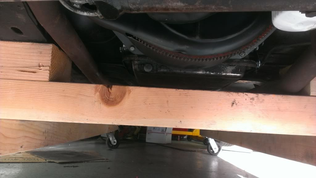

Next problem, went to bolt my new starter in tonight, It looks like I have a 168 tooth 14" flex plate. My new starter is for the 153 tooth 12.75" flex plate. Not a big deal, just swap starters right? But for the fact that I don't have a torque convertor cover that fits over the 14" flex plate. So good luck trying to find one of those covers...... So now I'm stuck with looking through all my parts to see if I have a 153 tooth flex plate, and pulling the transmission and swapping flex plates.

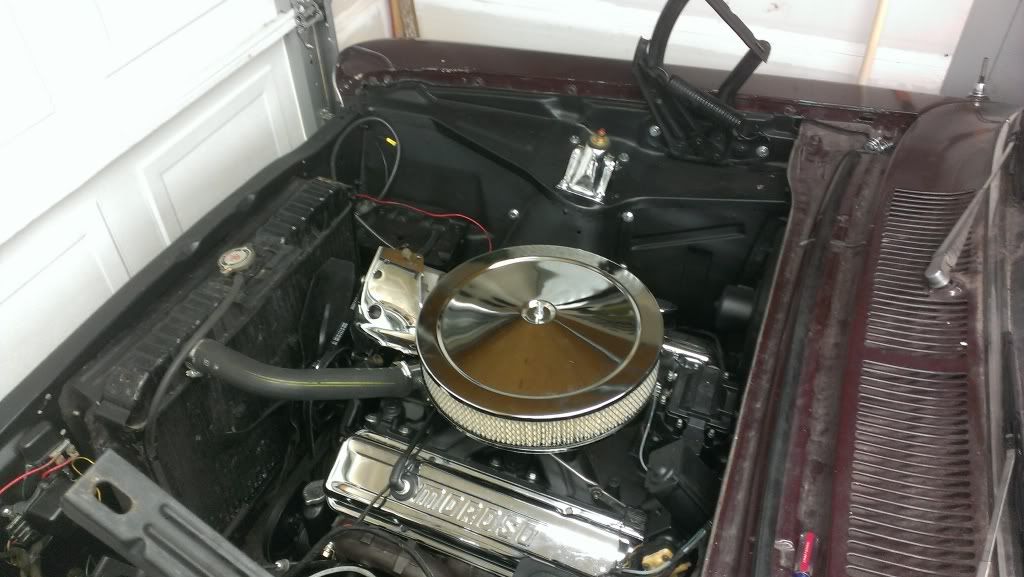

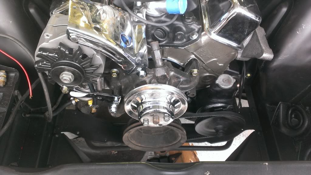

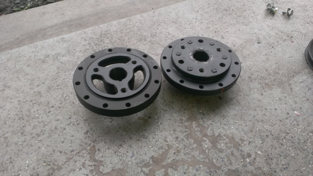

So I received my corvette style ram horn manifolds yesterday. Bolted them up and the fucking alt bracked doesn't fit it. So Im fucking fed up with it, and decided to go to the wrecking yard today to see how all the old chevs had there's mounted. Since all my parts are left overs that I didnt tear apart. All of the chevys had there alt mounted on the pass side. Opposite of what the nova has. So I went home and dug through my parts bin. Seems I had the parts all along to mount it on the pass side. Had to go to the long style water pump instead of the short style. (short style doesnt have any mounting holes for alt brackets) I also had to buy a different harmonic balancer to bolt the other larger pullys on. I had a long water pump in the trunk of the car. So after all this fighting with it. I have the shit mounted up.
here it is all mocked up to see if it would even fit. Its just mocked up on the old harmonic balancer.
new one on left, had to get a new one because the one on the right has rivets that go through it and the pulleys for the long water pump were different and wouldn't bolt up to it.
So I bolted it all up, and figured before I clean and paint it, I better test fit it all.
looks like its gonna work. So Im gonna pull the radiator and fan out tomorrow and paint and clean them up and put it back in for final mounting.
Not much left to do. If all goes well Im gonna try and fire it up this weekend.

So the only thing I'm still kinda baffled on is setting up my vaccum advance on my dizzy. I belive I want to set the vaccum to be post throttle blade but I don't have a vac port on this carb post throttle plate. Only after...
Re: ~~~~~~~~~~1966 RAT CITY RED ROCKET!!!~~~~~~~~~~~
« Reply #195 on: April 10, 2013, 11:39:09 AM »
Yes, must be after the throttle plates. How is there no port on the carb?

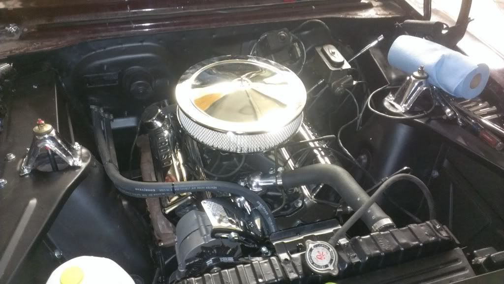

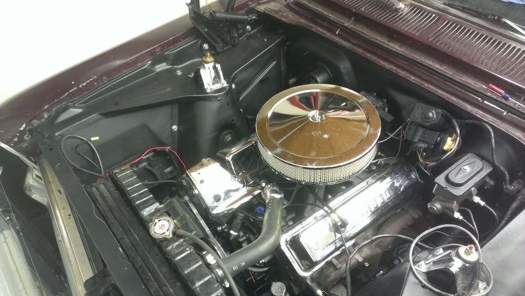

So I got the radiator and pulley painted up, alternator mounted up in final spot. Heater hoses done up, radiator filled up, starter mounted, torque converter cover bolted up, pass side exhaust all bolted up. Valve cover breather concted to air cleaner, and a few other little things. Not a whole lot left to do. Gonna try and fire it up Friday.
And the tq cover.....lol well what do u do when your cover don't fit over the large style flex plate? You cut a fucking slot.....

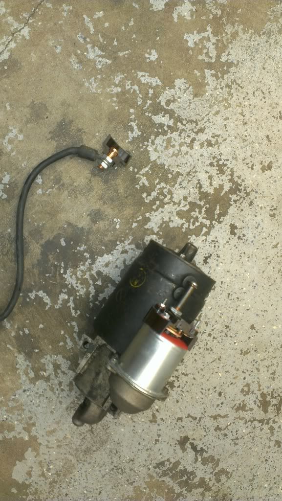

So I went to tighten the starter cable down to my new starter solenoid and the fucker broke in half..... Gay! Already went to the parts store and got a whole new starter. And then I'm just gonna swap the solenoid and take the starter back...lol

I have broke those before lol.

Shit made me mad was about to throw it across the garage but that would have accomplished about nothing. I wanted to turn the motor over last night to make sure it worked. Called it a night at that point. Was already 845 by then.
