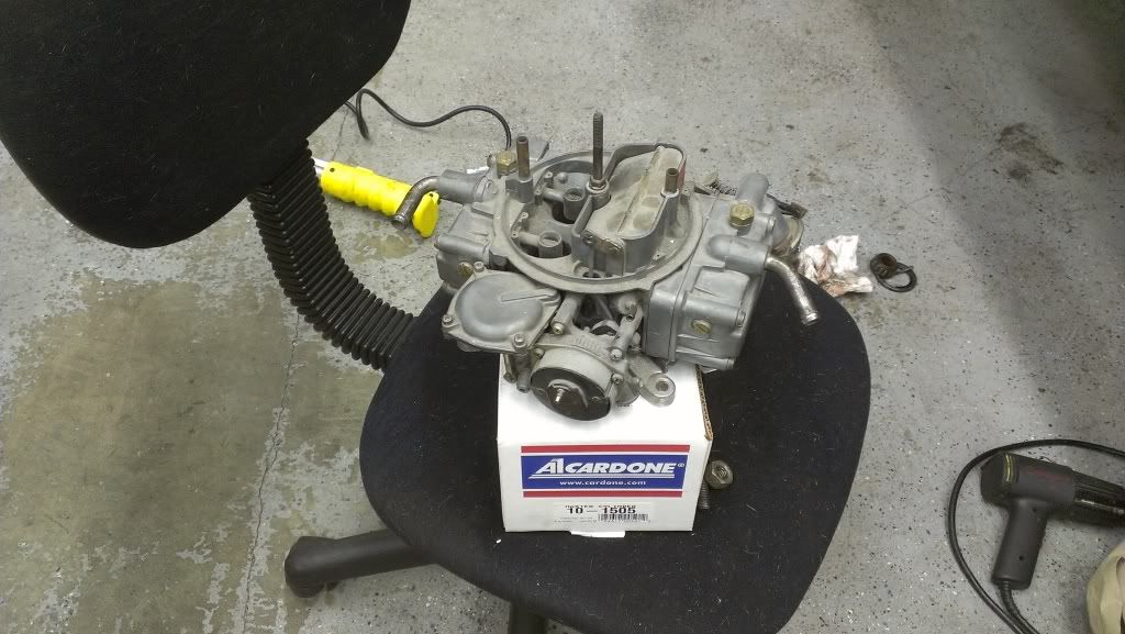

So I scored a holly 650 cfm carb. It will work just fine for now :)

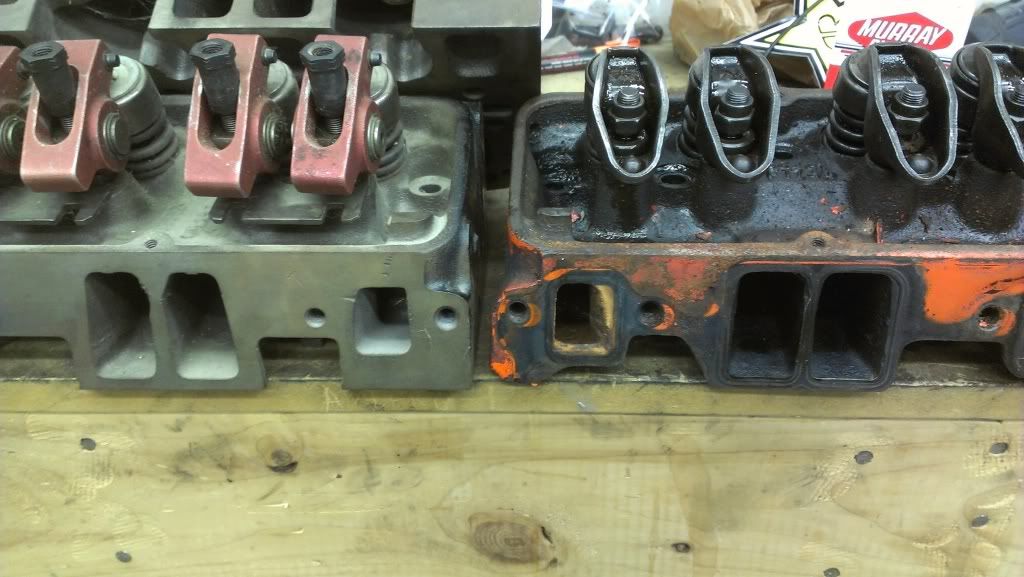

Those intake ports gave me an instant chubby :noel:
Pretty large compared to the stock 190/150 heads next to them.
Looks like there was some water that got in a few cyl while it was stored so I don't know with the block being 60 over is its gonna be saveable once I hone it. I just hope it's not to badly pitted from the rust. Got all 8 cyl soaked in wd40 right now. Gonna tear the gas tank off tomorrow and put the new one in. If all goes well my sending unit will still be ok.

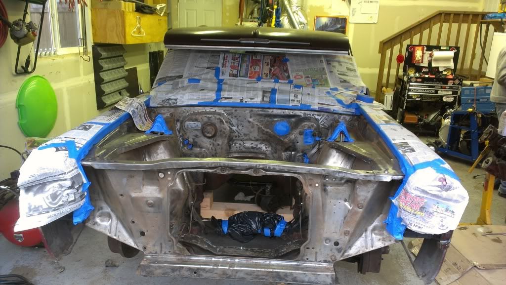

« Reply #66 on: January 28, 2013, 01:32:43 AM »

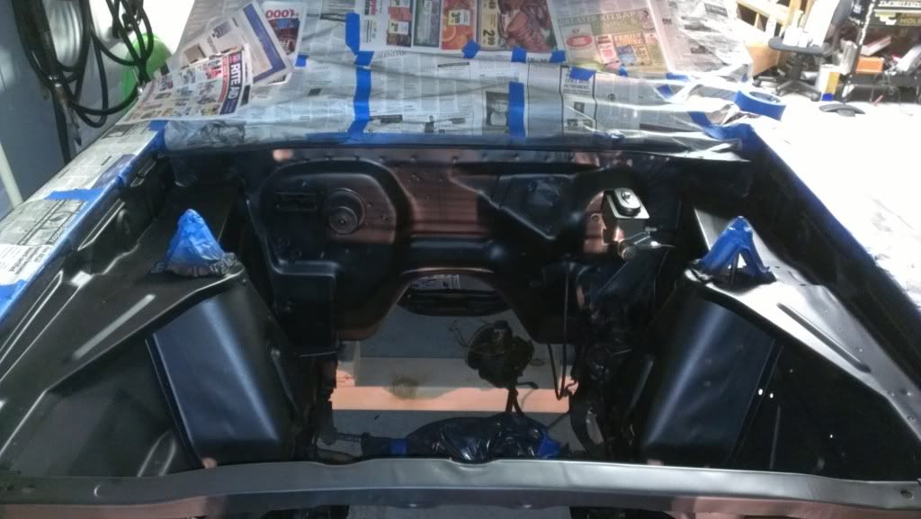

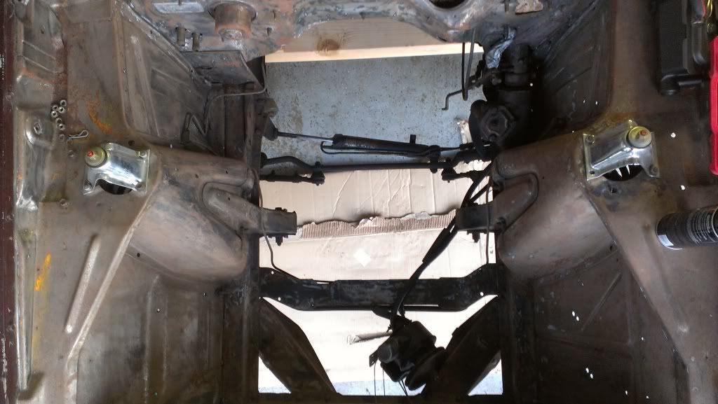

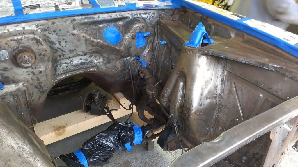

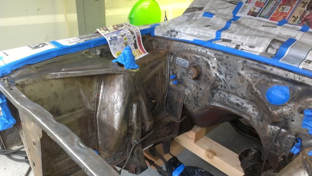

Saved down the engine bay today and got it painted. Also painted the master cyl and got the lined for that all done and bolted in.
I'll get a better pics soon. I also tore the 327 apart today(no pics will get soon) but it freed up and and pulled apart ok. It had a broken ring on the #8 cyl, and other than that it lookes like a stone hone, some bearings, rings and gaskets, and It will be ready to rock. I wish I knew what cam was in this thing because I can't for the life of me find any info on it.

« Reply #67 on: January 28, 2013, 01:43:49 AM »
wow, so simple and yet looks so good.  :noel:

« Reply #76 on: January 28, 2013, 02:25:21 PM »
It turned out pretty good. I was a little nervous about the low gloss black, I always use it on car parts, but never on an engine bay, I was afraid it was gonn look like a chalkboard. But once it dried it looked alright. Was a lot of bomb can painting....lol never bomb canned anything this big. Brother in law has been helping me on this project. Kinda kicks me in the ass when I want to call it a day and pushes me to do more....lol tracking number says that my sending unit oft the fuel gauge will be here today. So I should be able to get the tank in tomorrow. And then bleed the brakes and its ready for me to build the motor and drop it in so I can make the transmission crossmember.

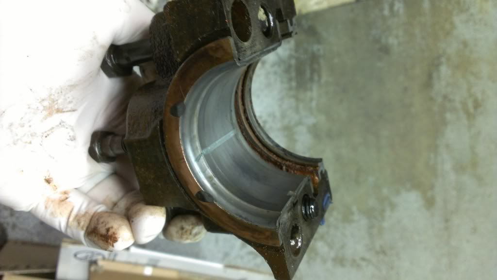

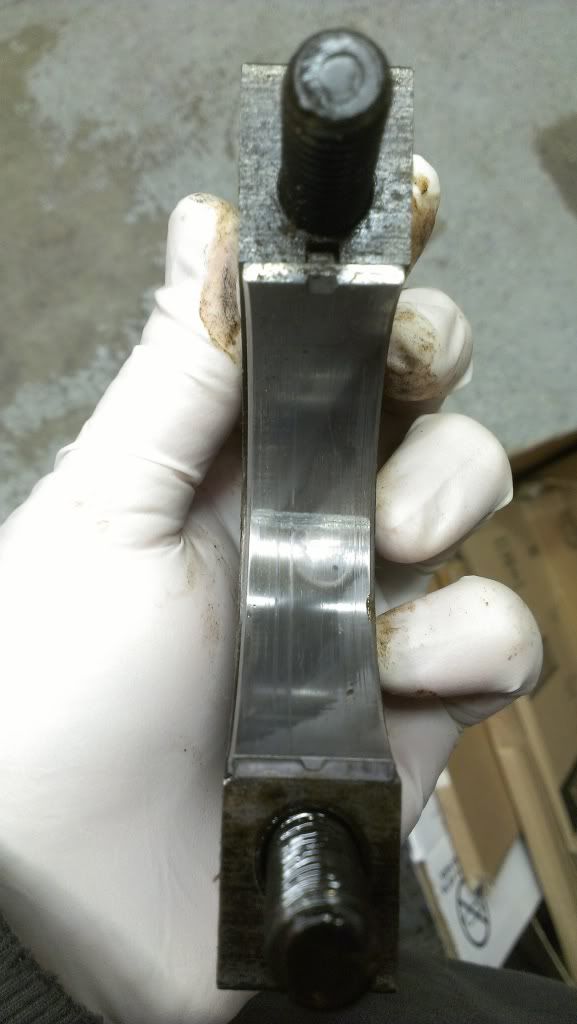

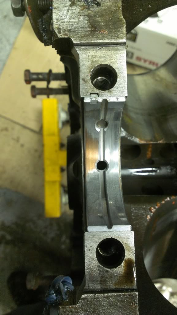

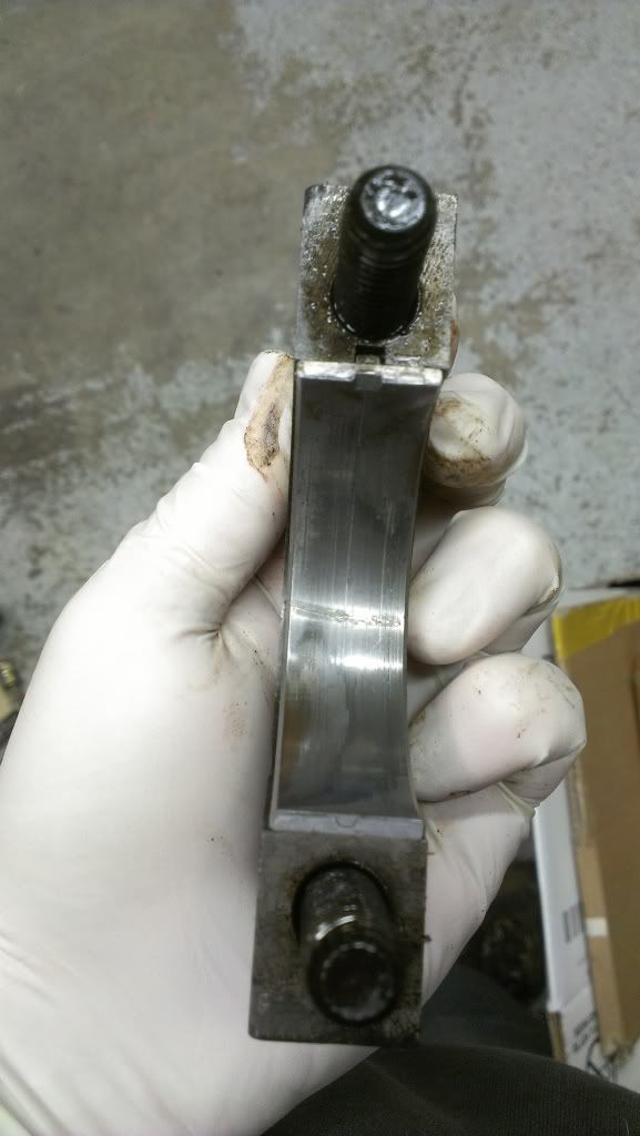

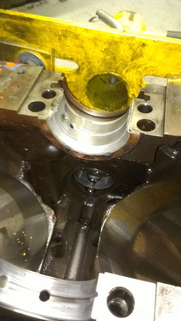

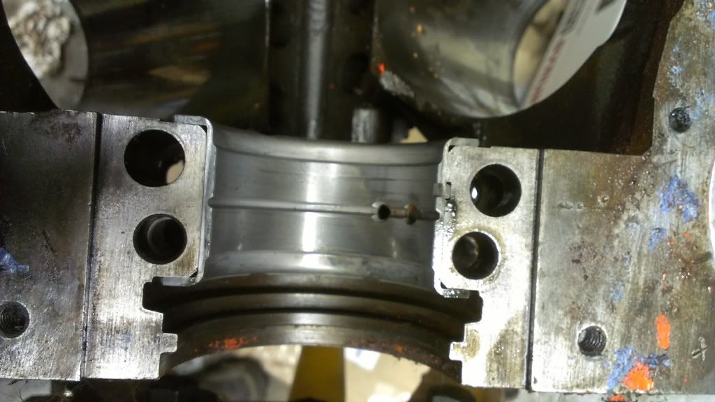

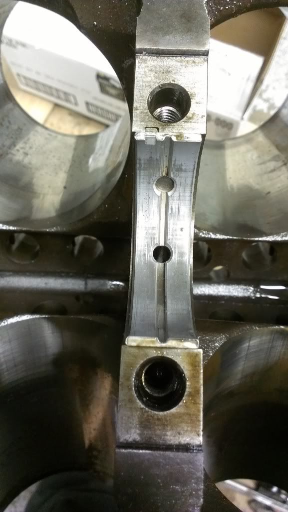

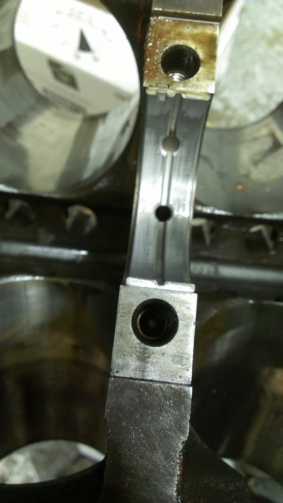

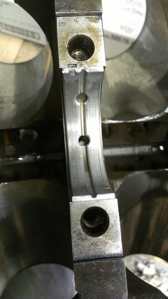

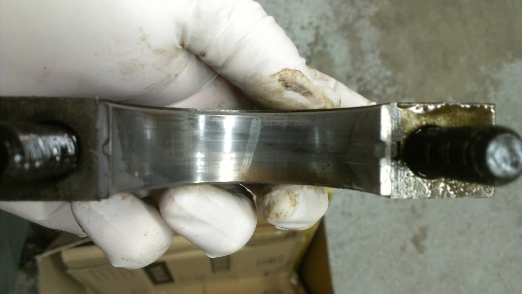

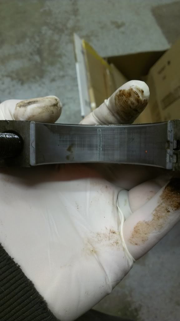

Did a little checking of the main bearing clearances. Platigauges them and they were all between .0018 - .0021. Perfect except for the fact it looks like the #1 main has chewed into the bearing a touch. I know its because someone ran there belts to tight, because its in the center of the block side of the bearing. The #2 has worn through and is just starting to hit copper, but its completely smooth and so is the crank, #3 looks ok, #4 same as #2 just starting to ware into the the copper, but its smooth. #5 looks good, but I wasn't able to check the end play because I didn't have a dial indicator, but I'm gonna snag my step dads tomorrow, and check it. Overall though, the crank looks tits.
here is some pics of what Im talking about
#1
#2
#3
#4
#5

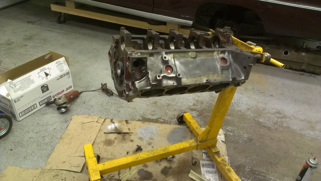

And here is the 327 b4 I used the wire wheel cup on my 4" angle grinder
And after
Tomorrow, Im gonna go grab the a ball hone and hone the shit out of this thing, and then Im gonna hit it with the paint stripper and try and get the rest of the paint off and get it cleaned up and ready for paint, and assembly.
Im kinda on the fence about running those bearings, but they are smooth and fell right into spec.

Bearings are cheap I would just get new ones, would suck to kill the crank over it.
Make sure you do not get the small journal and large journal p/n mixed up.  :noel:
Re: ~~~~~~~~~~1966 RAT CITY RED ROCKET!!!~~~~~~~~~~~
« Reply #81 on: January 30, 2013, 05:41:54 PM »
SBC bearings are dirt cheap.
I'd honestly have the crank double checked for straightness and have the main bores checked for straightness.  Gen1 SBCs are most definitely a blunt tool.

Just gonna order up new mains, and possibly rod bearings. Well see what happens when I check the rod bearings today. But I'm not gonna spend the money to have the crank check for straighteners. Not worth it in my book. This was a running motor, and I'm not trying to spend all my budget on it when I'm gonna just run it for the summer and sell it to fund the lq4 project.

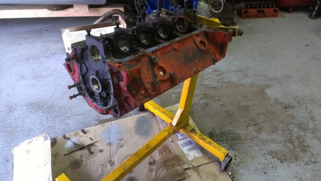

Finish stripping the block of the paint. Also honed the Shit ut of the cyl. The one that had the heavy rust in it cleaned up ok, but its not as smooth as I would like. Fuck it, rings will scrape it smooth.....lol

Nothing like a hard (I DONT GIVE A FUCK) break in to have a smooth running motor :noel:

Well had a great evening working on Shit. I cleaned up the garage and averaged everything and cleared off the work bench. Measured all my bearing thicknesses, and journals. Everything checked out perfect. So I'm back over to saying Fuck it, I'm just gonna run the bearings. So tomorrow goal is todo the final scrub down of the block and put the crank and cam it for the last time. Then start cleaning up all the pistons. And gonna order up rings tonight.

It's your engine so do what you wish. But I would not put #1 bearing back in, it has been a few years since the last time I built a sbc, but it seems to me you can get jobber bearings for like ~$25.
